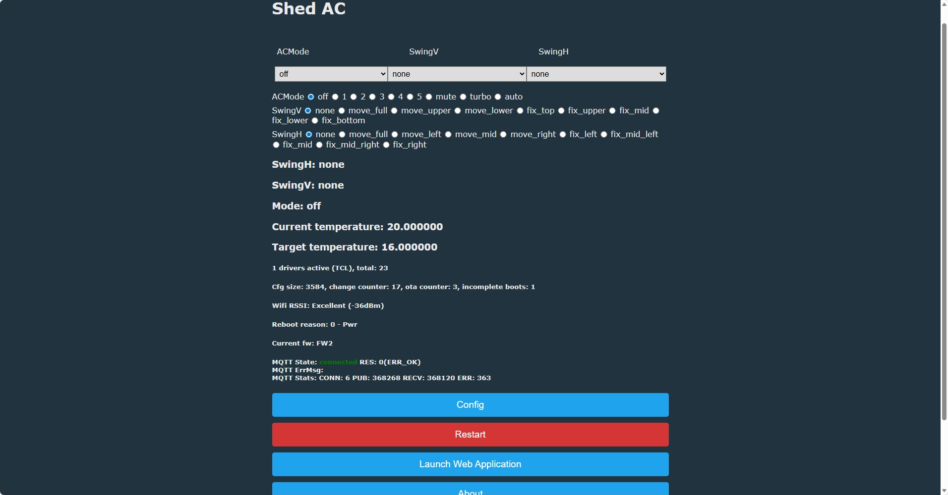

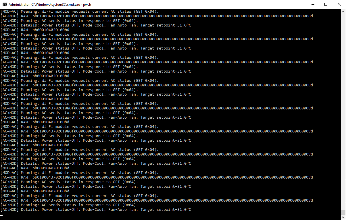

    Mushinronsha
    Hello and first and foremost, thank you for the job well done on OpenBeken, I've been enjoying both the process of converting my IoT devices to OpenBeken, and freeing them from Tuya at the same time. After installing HA yesterday, I went ahead and flashed OpenBeken as well as configured MQTT for the first time for my WBR3 module controlled A/C unit. The reason I'm posting is I noticed that when using the remote control, the smart thermostat entity in HA doesn't update. I can use HA to turn the A/C on when it's off and it properly displays its state change after doing so. In RTL87X0C.local ip, the state of the A/C and its change via remote, are properly reflected. MQTT is also (99% sure, at least I hope so) correctly configured since it says that it's connected. These is the repeating portion I get from the device's log when it's off.
    Info:MQTT:MQTT client in mqtt_incoming_publish_cb topic AirwavePlus/CurrentTemperature/get
    Info:MQTT:MQTT client in mqtt_incoming_publish_cb topic AirwavePlus/TargetTemperature/get
    Info:MQTT:MQTT client in mqtt_incoming_publish_cb topic AirwavePlus/ACMode/get
    Info:MQTT:MQTT client in mqtt_incoming_publish_cb topic AirwavePlus/FANMode/get
    Info:MQTT:MQTT client in mqtt_incoming_publish_cb topic AirwavePlus/Buzzer/get
    Info:MQTT:MQTT client in mqtt_incoming_publish_cb topic AirwavePlus/Display/get
    Info:MQTT:MQTT client in mqtt_incoming_publish_cb topic AirwavePlus/SwingH/get
    Info:MQTT:MQTT client in mqtt_incoming_publish_cb topic AirwavePlus/SwingV/get
    Info:MQTT:Publishing val 26 to AirwavePlus/CurrentTemperature/get retain=0
    Info:MQTT:Publishing val 26 to AirwavePlus/TargetTemperature/get retain=0
    Info:MQTT:Publishing val off to AirwavePlus/ACMode/get retain=0
    Info:MQTT:Publishing val 4 to AirwavePlus/FANMode/get retain=0
    Info:MQTT:Publishing val 1 to AirwavePlus/Buzzer/get retain=0
    Info:MQTT:Publishing val 1 to AirwavePlus/Display/get retain=0
    Info:MQTT:Publishing val fix_mid to AirwavePlus/SwingH/get retain=0
    Info:MQTT:Publishing val fix_mid to AirwavePlus/SwingV/get retain=0
    and this is what I get when it's on:
    Info:MQTT:Publishing val 27 to AirwavePlus/CurrentTemperature/get retain=0
    Info:MQTT:Publishing val auto to AirwavePlus/ACMode/get retain=0
    both of the logs seem OK to me so hence my post asking for help.
    Also, the only active flags are 10,29,37 and 51.
    Again thank you all participating devs for the wonderful endeavor and congrats on the road so far. TIA for your time.

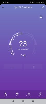

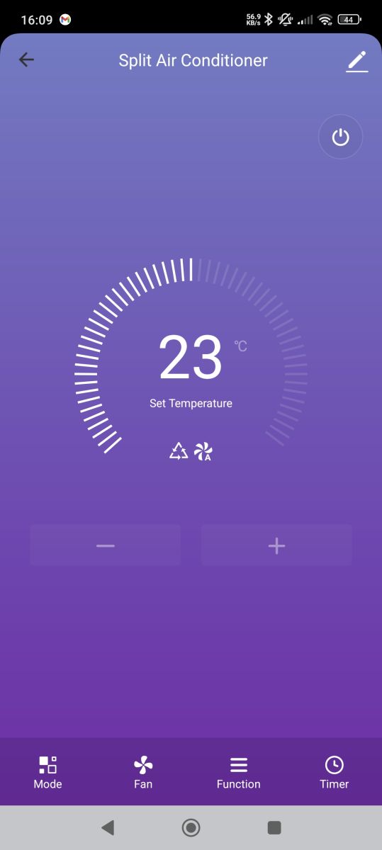

  • #215 21628960
    Mushinronsha
    Sorry for taking so long to reply, I'm in really deep as I didn't check any other modes after flashing WBR3 with OpenBeken's latest version 1.18.145 yesterday. I only tried and used Cooling and Fan Only modes since it's summer here in Greece.
    AbidingOhmsLaw wrote:
    I have not had issue with the remote not setting the HA card
    It might be my mistake phrasing my problem incorrectly, no worries though - let me rephrase and also add some new information:
    The problem I referred to in my previous post is that while it's off and I turn it on using the remote, the off>on state change is not reflected in HA.
    At that point, pressing the MODE button on the remote control to go from
    cooling > heating
    cooling > fan only
    fan only > cooling
    fan only > heating
    heating > cooling
    heating > fan only
    is reflected correctly in HomeAssistant. For reasons unknown, it now behaves correctly and updates HA when turned on using both the remote and OpenBeken's webserver. As far as HomeAssistant is concerned, using the remote to turn the unit off and on as well as switching to Cooling/Heating or Fan only modes work. Auto or Dry modes are not reflected in HomeAssistant, something understandable since I'm not presented with those options in HA - don't know/think they are implemented yet. Also, changing Fan modes (1-5, Mute, Turbo and Auto) appear to be working.
    FWIW, using the remote, I can switch to Drying or Auto mode and that's reflected in OpenBeken's webserver. So all's well that ends well? No, my RTL87X0C doesn't thinks so.
    To reiterate, the problem I spoke of in my first post -change in state from off to on using the remote- probably was some kind of a fluke - I guess it was resolved after I restarted the RTL87X0C module. Interestingly though, this endeavour led me to somethings I can only as bugs in OpenBeken's side.
    OpenBeken's webserver updates correctly when cycling through all 5 different modes using the remote and and the 3 HomeAssistant is capable of setting, namely cooling, fan only and heating. What is wrong then?
    Since I got into the process of finding out what works and what doesn't, I noticed that using the remote and cycling modes to auto or dry, doesn't reflect on HA. I tried to do the same thing from OpenBeken. If I understand it correctly it should be like this (correct me if I'm wrong anywhere)

    Now, for the more interesting part. Buttons Mute and Turbo in OpenBeken turn the unit off.
    Auto It seems that Auto mode - not Fan Auto mode, can be set using the last ACMode button all the way to the right.
    FWIW, as I previously said above, in OpenBeken's UI visible from RTL87X0C.local webserver, cycling modes using the remote works perfectly. Thus I can infer that the problem is in OpenBeken's webserver part. But in any case, the way the UI is right now, having buttons that control the fan speed and the ac mode in the same controller is confusing. IMHO I think it would be prefferable to have 2 modes: AC and Fan, the way it is in HomeAssistant.

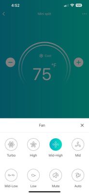

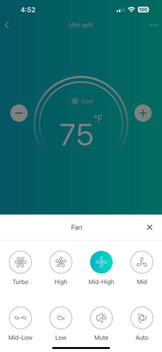

    Fan Modes with Cooling - It's really interesting to correlate "fan modes"
    1 of 5
    Warn:EnergyMeter:Ok we got reply with mode 1, fan 1, turbo 0, mute 0
    Warn:EnergyMeter:fan 01
    Warn:EnergyMeter:mode 01
    Info:MQTT:Publishing val 28 to AirwavePlus/CurrentTemperature/get retain=0
    Info:MQTT:Publishing val cool to AirwavePlus/ACMode/get retain=0
    Info:MQTT:Publishing val 1 to AirwavePlus/FANMode/get retain=0
    Info:MQTT:Publishing val none to AirwavePlus/SwingH/get retain=0
    Info:MQTT:Publishing val none to AirwavePlus/SwingV/get retain=0
    2 of 5
    Warn:EnergyMeter:Ok we got reply with mode 1, fan 4, turbo 0, mute 0
    Warn:EnergyMeter:fan 04
    Info:MQTT:Publishing val 2 to AirwavePlus/FANMode/get retain=0
    3 of 5
    Warn:EnergyMeter:Ok we got reply with mode 1, fan 2, turbo 0, mute 0
    Warn:EnergyMeter:fan 02
    Info:MQTT:Publishing val 3 to AirwavePlus/FANMode/get retain=0
    4 of 5
    Warn:EnergyMeter:Ok we got reply with mode 1, fan 5, turbo 0, mute 0
    Warn:EnergyMeter:fan 05
    5 of 5
    Warn:EnergyMeter:Ok we got reply with mode 1, fan 3, turbo 0, mute 0
    Warn:EnergyMeter:fan 03
    Info:MQTT:Publishing val 5 to AirwavePlus/FANMode/get retain=0
    Turbo
    Warn:EnergyMeter:Ok we got reply with mode 1, fan 3, turbo 1, mute 0
    Info:MQTT:Publishing val turbo to AirwavePlus/FANMode/get retain=0
    Auto
    Warn:EnergyMeter:Ok we got reply with mode 1, fan 0, turbo 0, mute 0
    Warn:EnergyMeter:fan 00
    Info:MQTT:Publishing val auto to AirwavePlus/FANMode/get retain=0
    Mute
    Warn:EnergyMeter:Ok we got reply with mode 1, fan 1, turbo 0, mute 1
    Info:MQTT:Publishing val mute to AirwavePlus/FANMode/get retain=0
    I think something is very wrong with the way OpenBeken displays fanspeeds. I'm here for any further debugging if I can help it.

    vietxtlife
    Posts: 26
    >>21759952 Yes, everything works. Flash the new WBR3 w
    Shed AC control panel with air conditioning settings and system status ith OpenRTL87X0C_1.18.217.bin I still have the original WBR3 with stock firmware aside just in case

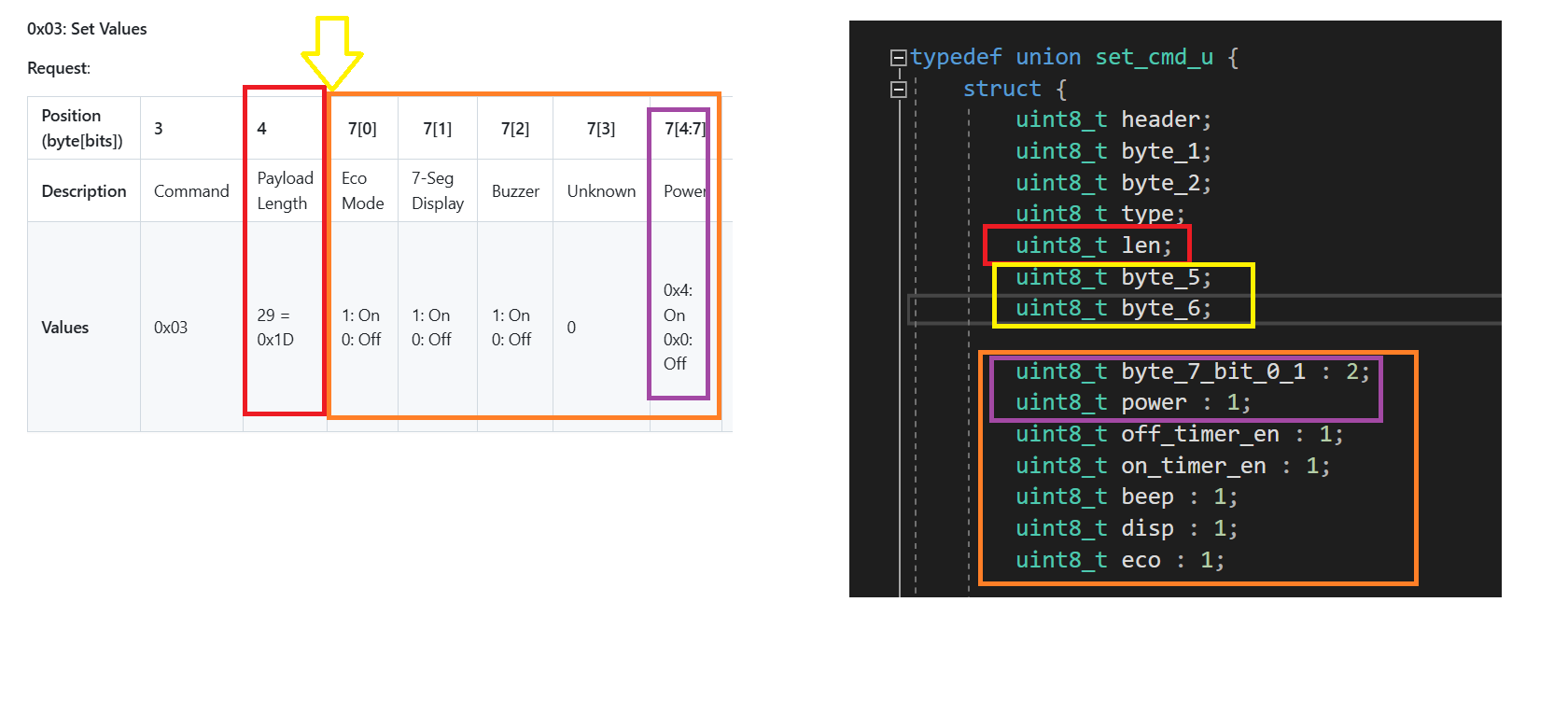

    There are 4 options? Or 5 options?
    I am asking because...
    It says 0x0 is off and 0x04 is On, and if so, what is 0x1, 0x2, and 0x3?
    Would it be possible that 0x1 is L1, 0x2 is L2, and 0x3 is L3 (80%)? And 0x4 is .... idk, L4 - 100%? I do not even what the "L" here means...
    And in our SDK...
    Command byte table with function bits and union structure for value setting
    Those two bits are unnamed. Maybe we should try setting them?

  • Python UART emulator to force Tuya pairing mode
    #236 21760984
    Posts: 5107
    Help: 441
    Rate: 902
    probably no help, but I got GPT to make this Python thing so the Tuya_Align_Della-048-TP-12K1V-22S-1_(schemaID-000001nbrw)_key73j3uh4c3dhqn_u9jjsaluqe1trtxv_TuyaMCU_WBR3_1.1.14.bin dump for this latest Della variant can finish booting and get into pairing mode.
    still, dunno what the real MCU should respond with when sending these GEN options from the Tuya app.
    Code: Python
    Terminal window with repeated communication logs between Wi-Fi module and AC unit
    Does this paired device even look like yours @vietxtlife?
    Air conditioner app screen showing 23°C set temperature
  • #237 21760993

    vietxtlife
    Posts: 26
    >>21760984 Similar but not quite, though I think seeing how much power the unit consumes when each GEN option activates is adequate indicator; what you think? Maybe not precise enough but still an indicator
    GEN options are the limit of how much the mini split will use as the options activate.
    Added after 5 [minutes]:
    Air conditioning control app interface set to 75°F with fan mode on “Mid-High”
