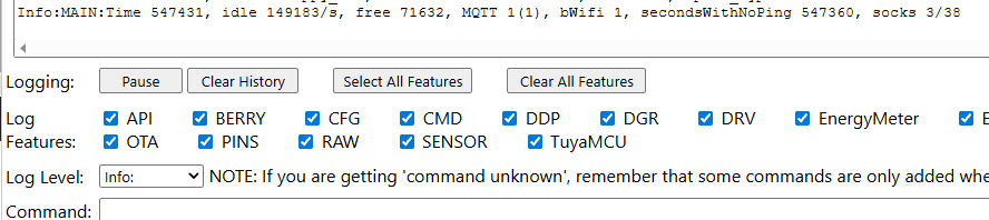

    schema ID e1n87fm8 has not been seen before it seems.
    maybe it's traditional TuyaMCU protocol or some variation of the TCL used in OBK's driver.
    what happens if you startdriver tuyamcu while watching the logs in the web app?
    Screenshot of a web app logging panel with feature checkboxes, including TuyaMCU selected.
    and with tuyaMcu_sendQueryState after starting driver
    a dump from your other ones, if identical, will reveal the situation too

    I changed to tuyamcu and I sent also the command you mentioned, I'm getting this:
    Debug:CMD:cmd [tuyaMcu_sendQueryState]
    Info:CMD:[WebApp Cmd 'tuyaMcu_sendQueryState' Result] OK
    Info:TuyaMCU:Consumed 12 unwanted non-header byte in Tuya MCU buffer
    Info:TuyaMCU:Skipped data (part) F1 87 0A 12 02 FC 41 C1 8A 0A 81 E0
    Info:TuyaMCU:Consumed 7 unwanted non-header byte in Tuya MCU buffer
    Info:TuyaMCU:Skipped data (part) 73 A4 42 1A 4A 92 F2
    Info:TuyaMCU:Skipped data (part) 71 85 0A 1A 02 FE C1 C0 82 02 89 E2
    Info:TuyaMCU:Skipped data (part) 11 A5 C2 1A 4A 92 F2
    This continue in loop between 7 and 12.
    By dump of the others you mean a backup of the actual firmware running on the other 2?
