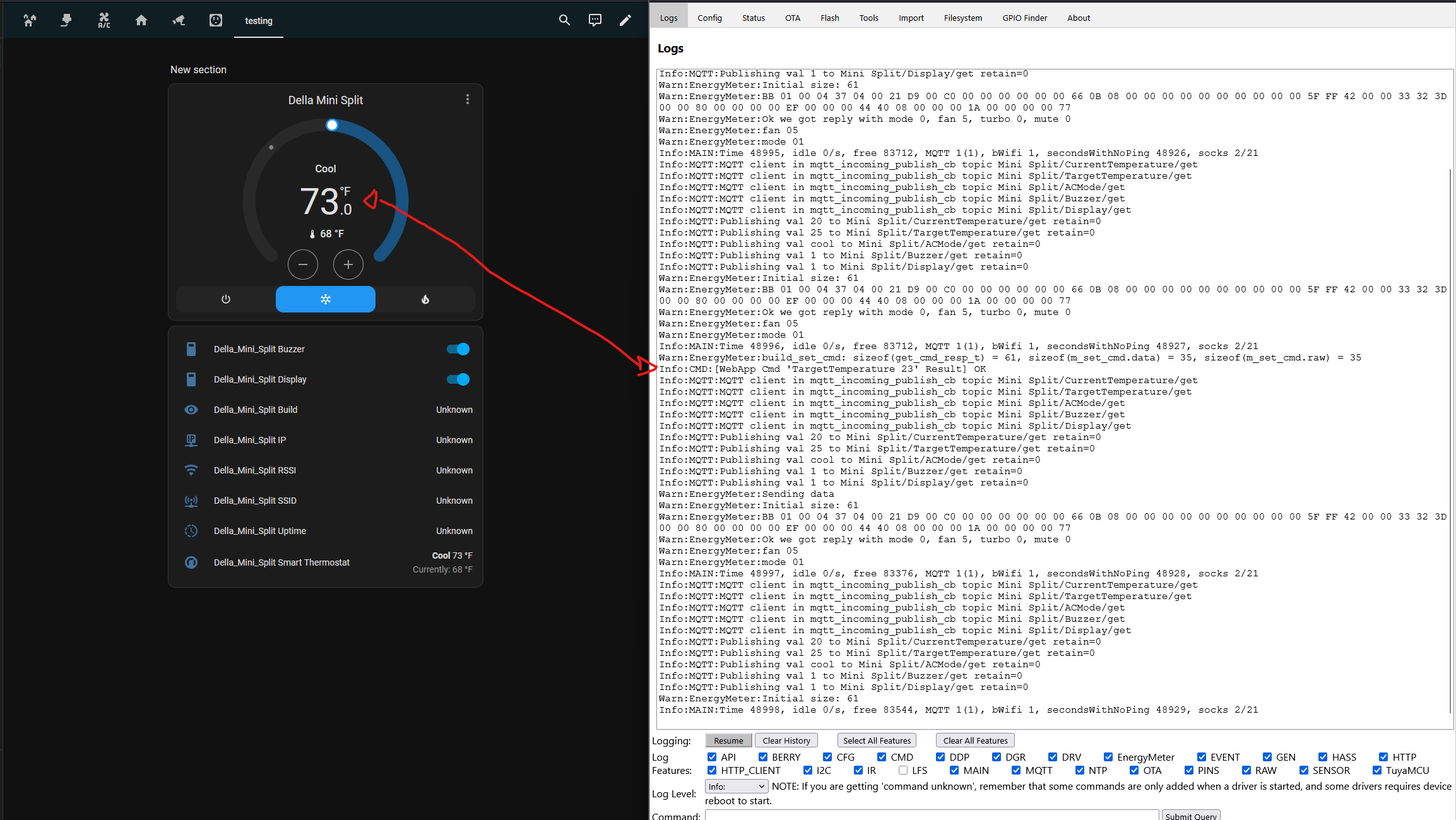

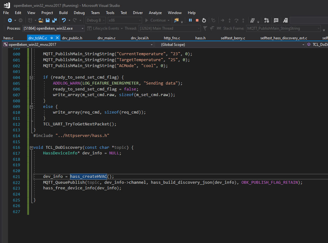

  • #99 21560286
    Posts: 14797
    Rate: 12954
    I'm working on it, not ready:
    Smart thermostat control panel with cooling set to 25°C and current temperature at 23°C.
    Screenshot of Visual Studio with an open C source file, showing a code section related to MQTT and HVAC.
  • #100 21560408
    dressyspider
    Posts: 83
    Rate: 10
    Nice! It looks great so far!

    Posts: 14797
    Rate: 12954
    This version might work more or less after starting driver and doing HASS Discovery:
    https://github.com/openshwprojects/OpenBK7231T_App/pull/1650
    but it just publishes variables every second and does a lot of spam. Still, good enough for initial testing?

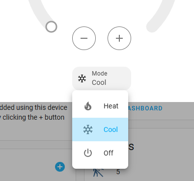

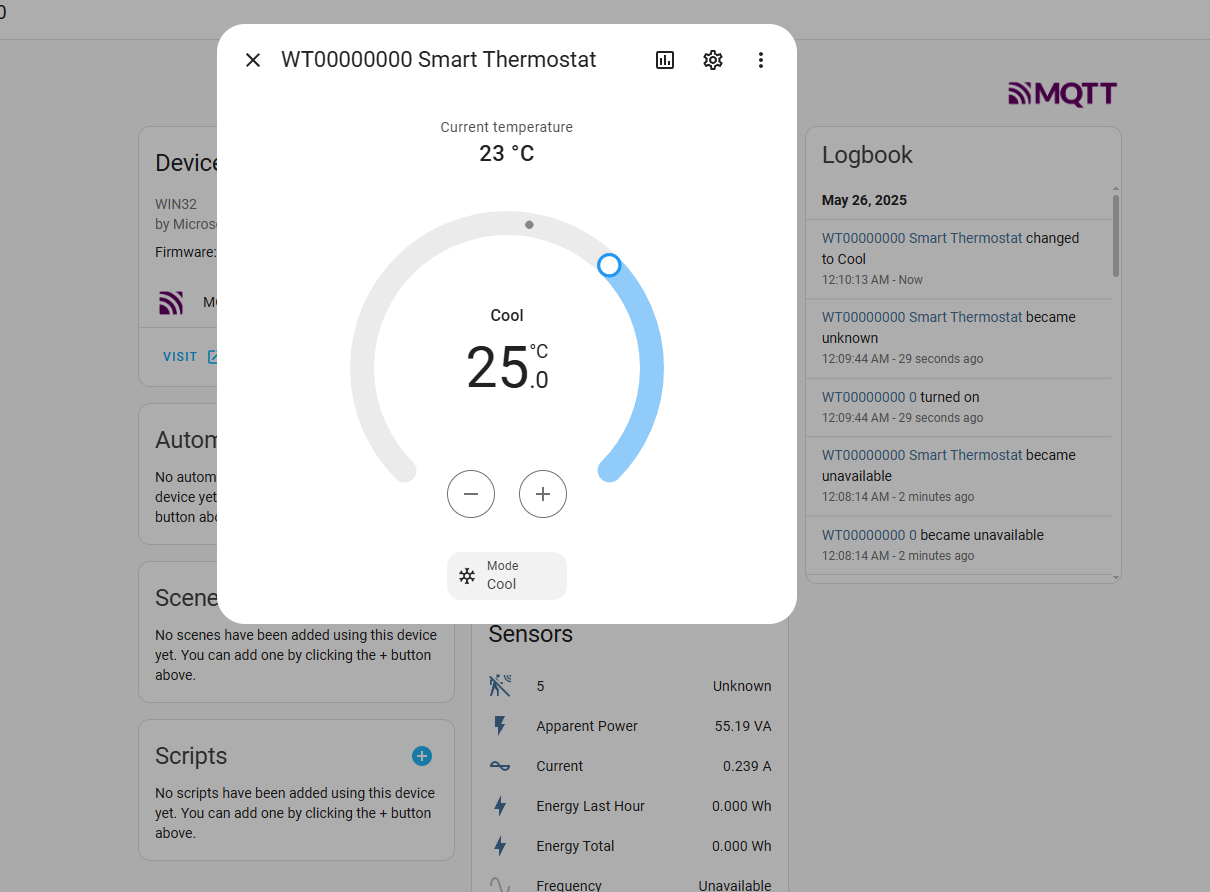

  • HA discovery adds controls but power commands fail

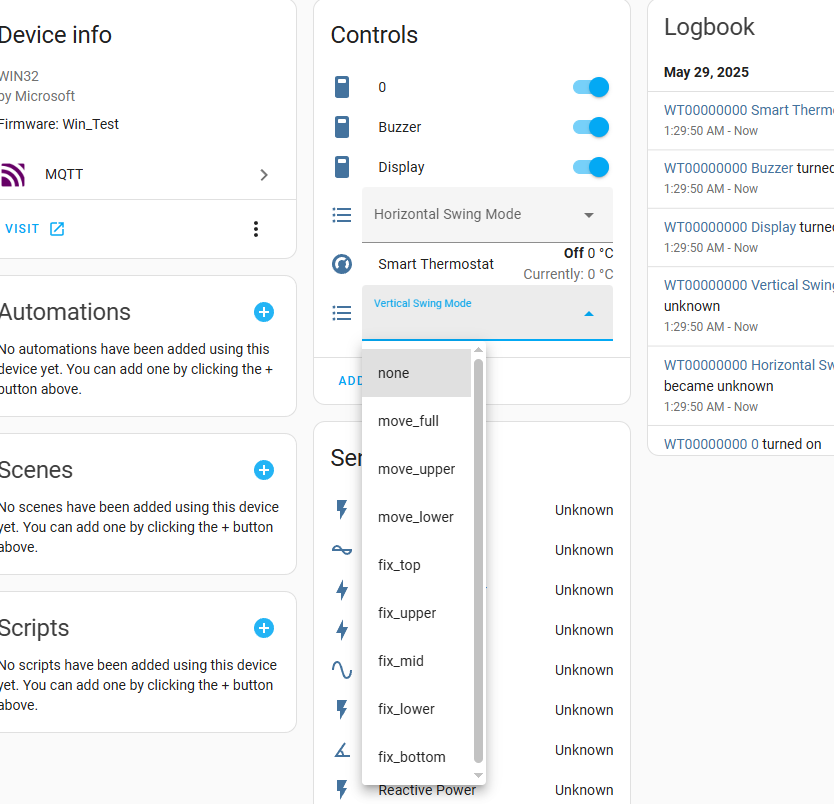

    #104 21561845
    dressyspider
    Posts: 83
    Rate: 10
    After re-running the HA discovery, I am seeing the mini split with some additional controls and info. However, pressing cool or power does not update the mini split. For example, if the mini split is powered off, it will not power on from pressing power from the HA thermostat controls.
    Request for Help – Flashing Della Minisplit WiFi Module (WBR3 on TCWBRCU1)

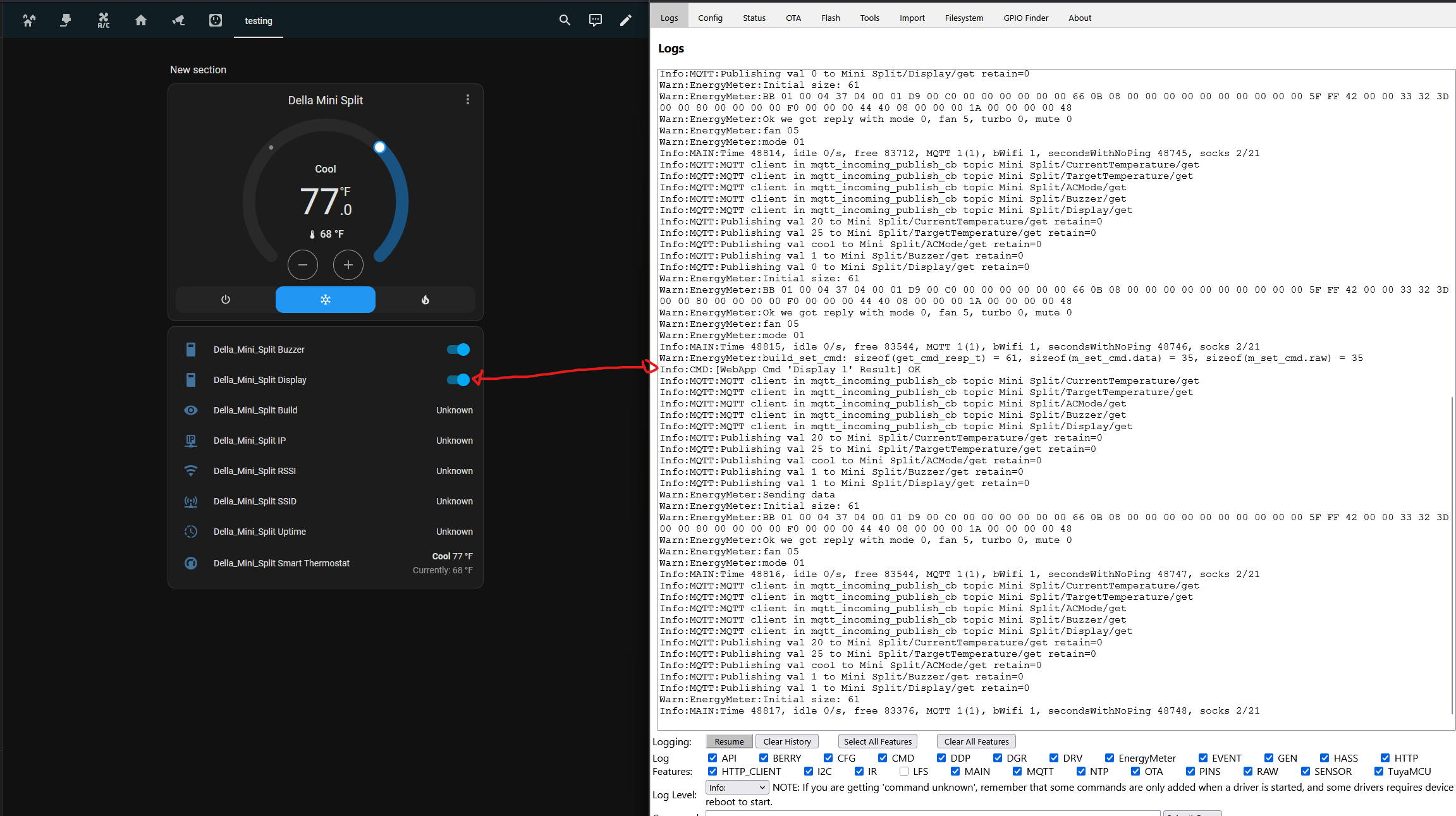

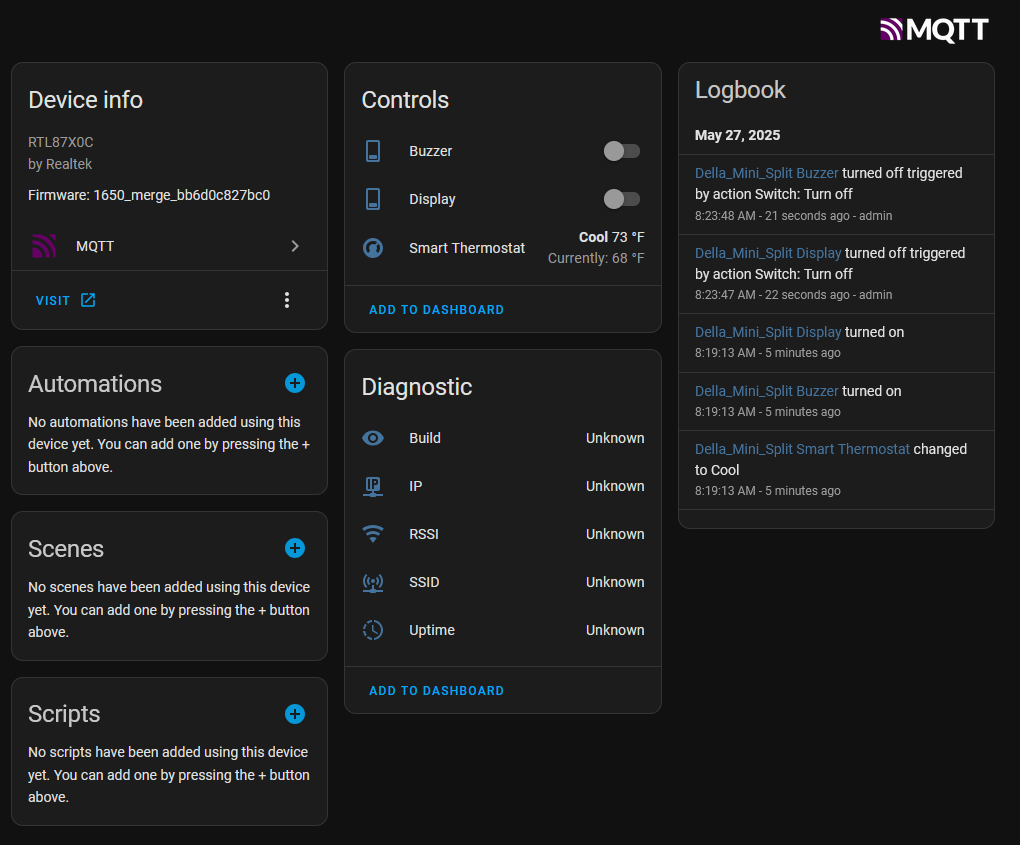

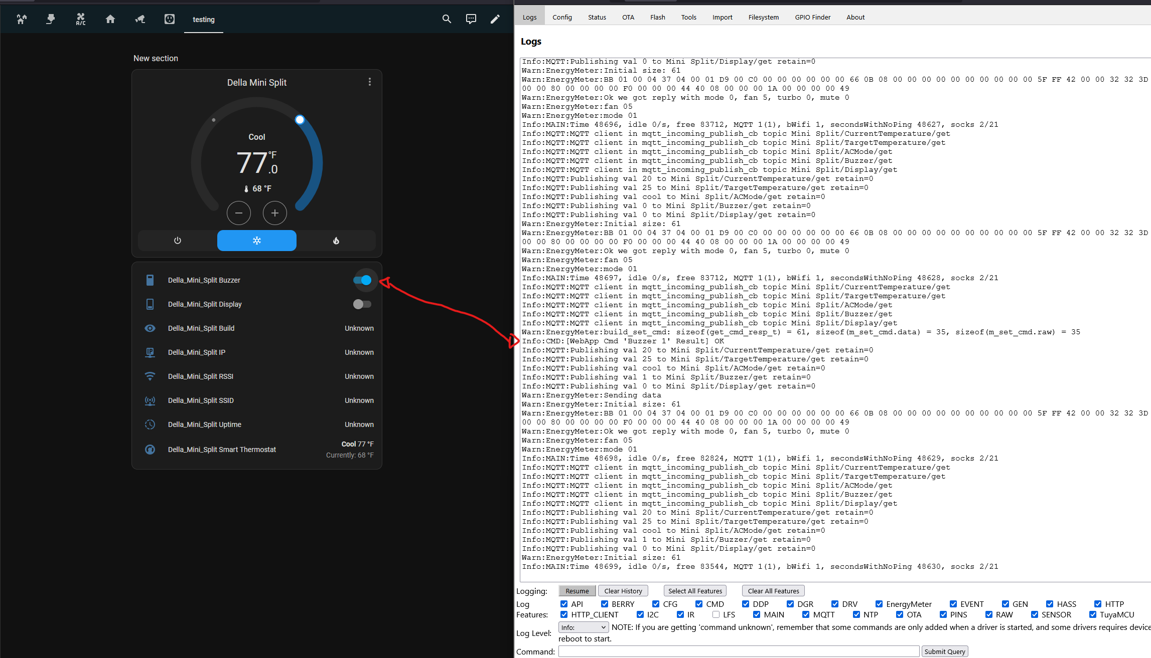

    Can you check if the already mentioned commands for Buzzer and Display, when run on OBK device, cause Home Assistant state to update? Does changing the TargetTemperature in OBK cause HA state to follow OBK?

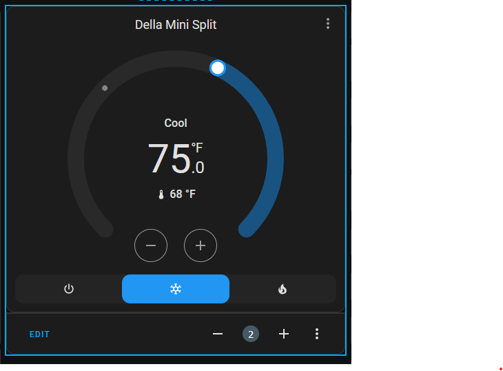

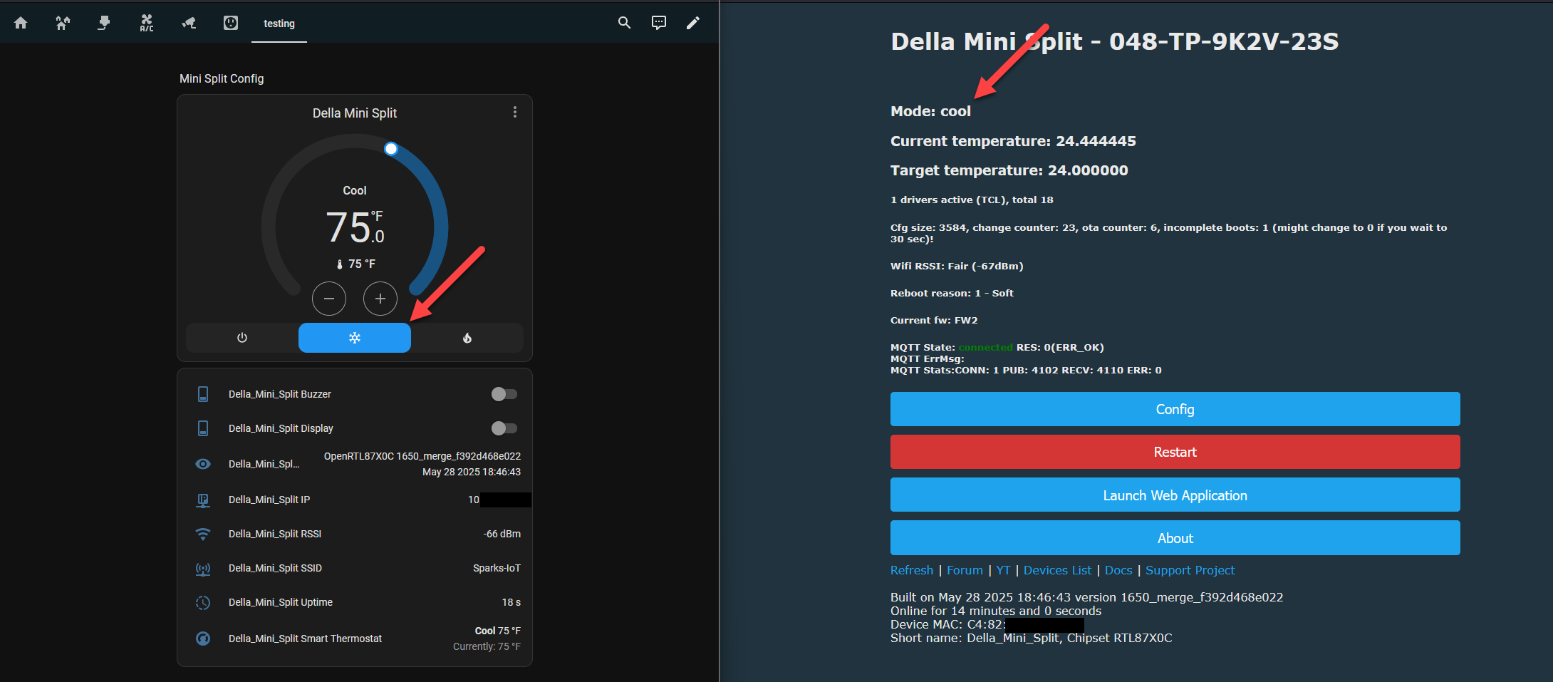

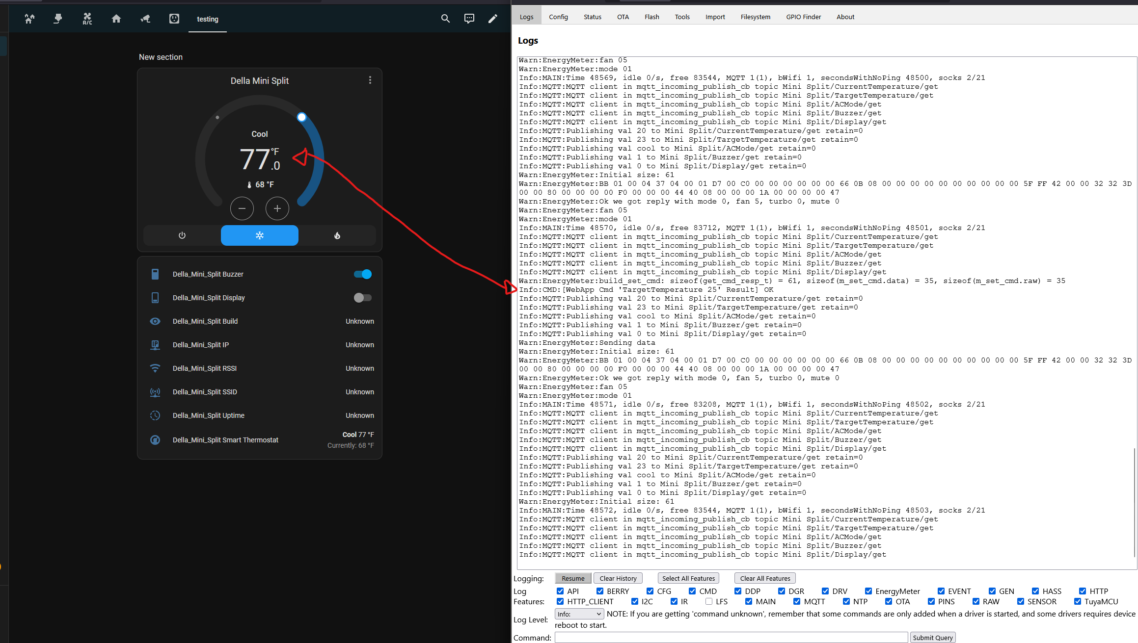

  • Home Assistant state updates but AC mode stays cool
    #106 21561868
    dressyspider
    Posts: 83
    Rate: 10
    When manually setting state via commands, Home Assistant does show the updated state. The Home Assistant dashboard is showing the temperature values in Fahrenheit.
    TargetTemperature 25:
    Screenshot of Home Assistant dashboard showing mini split set to 77°F in cool mode, with system logs on the right.
    Buzzer 1:
    Screenshot of an air conditioner control panel and MQTT driver logs.
    Display 1:
    Air conditioner control panel and system logs connected by a red arrow pointing to the display option.
    TargetTemperature 23:
    Air conditioner control interface and system logs with an arrow indicating a temperature change event.

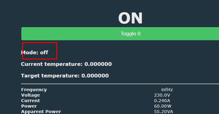

    Edit:
    Running ACMode 0 did not update the Home Assistant dashboard. The mini split still shows "cool" is set.
    Screenshot showing a climate control panel and system logs after pressing the power button.

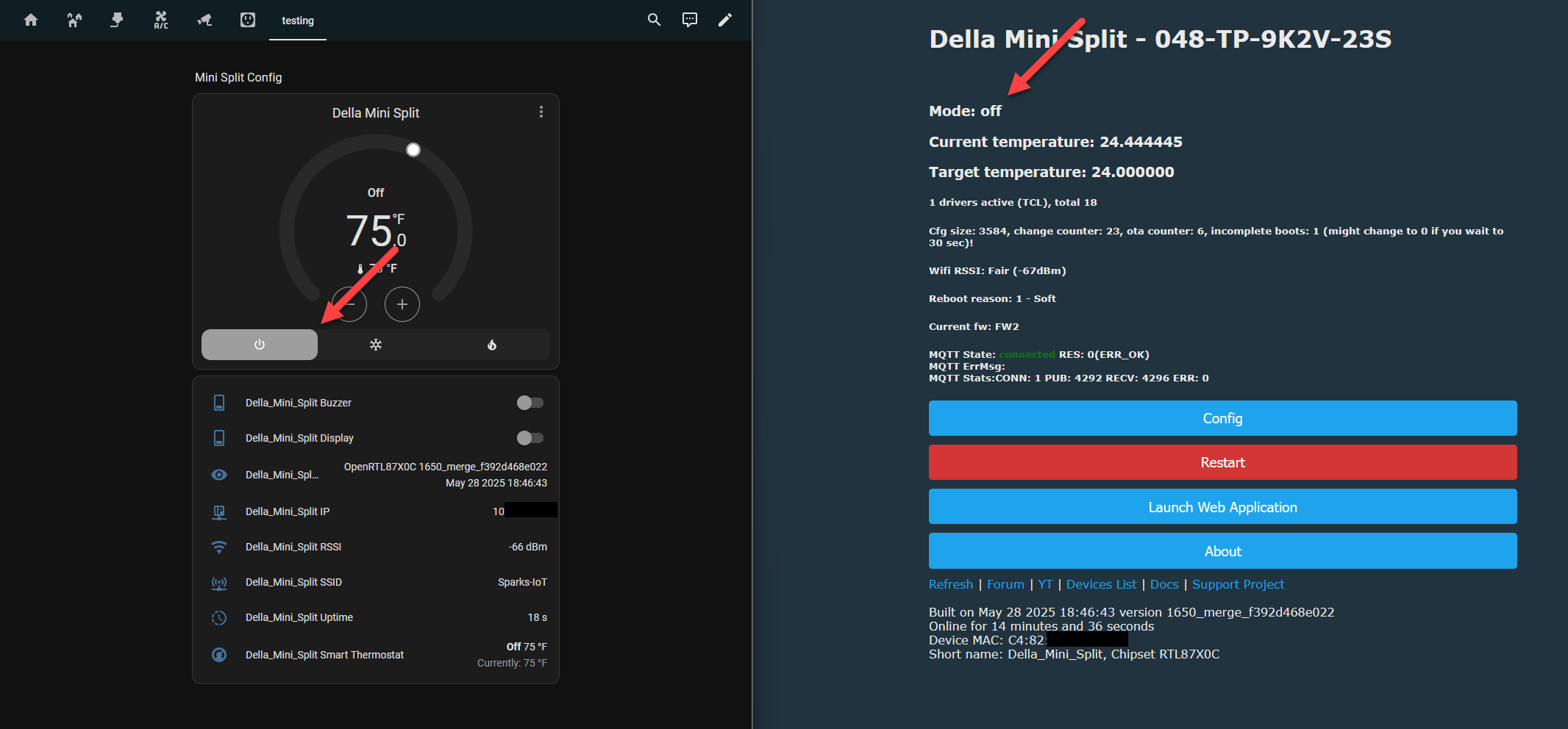

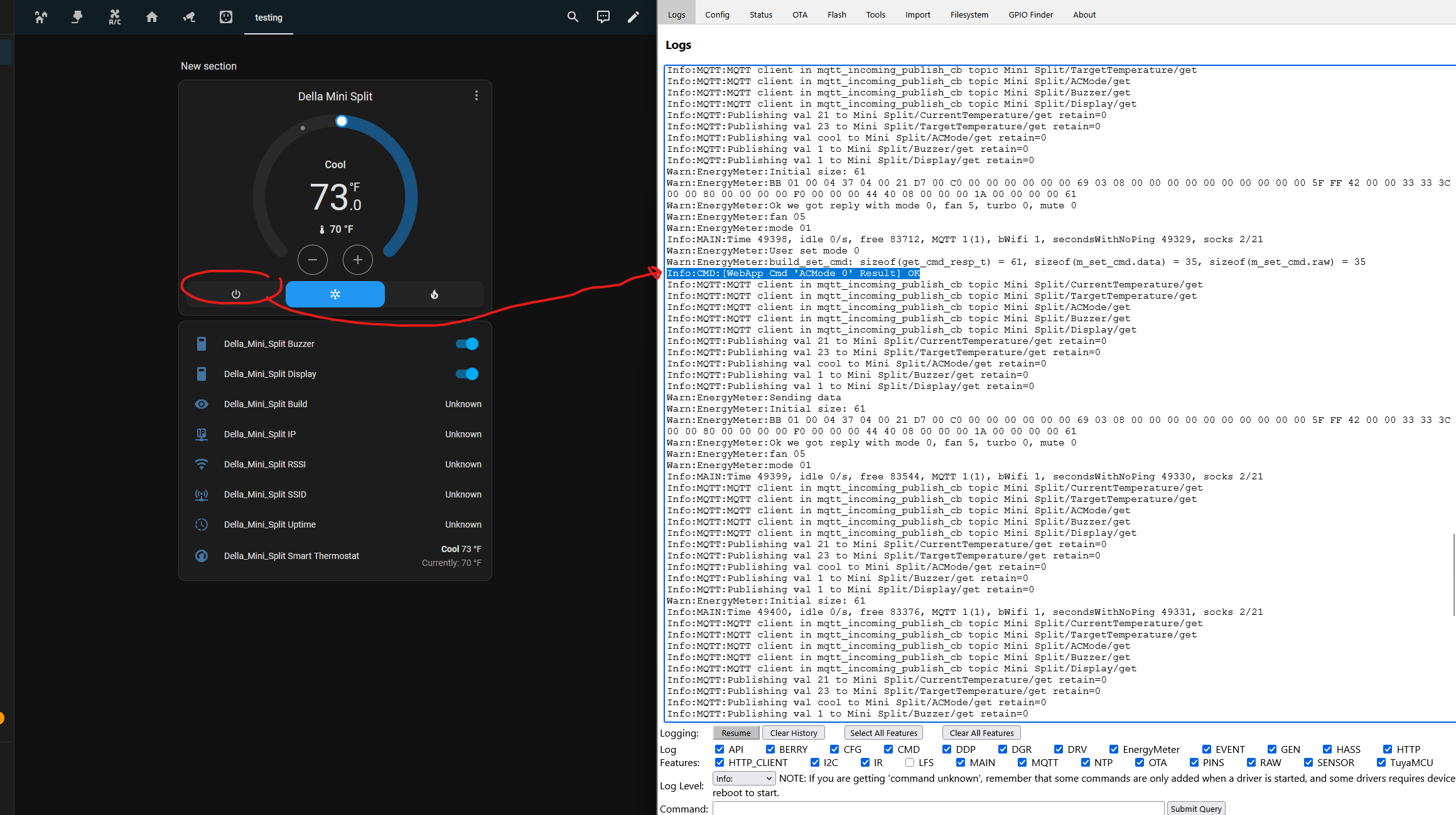

  • #107 21561893
    Posts: 14797
    Rate: 12954
    And toggling Display in HA does not affect OBK/device?
  • Power-on command not working via Home Assistant
    #108 21561917
    dressyspider
    Posts: 83
    Rate: 10
    Display and buzzer both work.
    Powering the device off via home assistant works too.
    The only thing that is not working is powering on via home assistant.
    I’ll pull logs and attached them shortly.

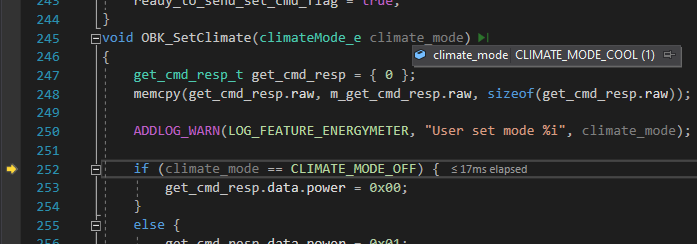

    Edit:
    Added device log and steps taken.
    I powered the mini split on with ACMode 1. Then I went to the Home Assistant dashboard to perform the following:
    - Turn buzzer on
    - Turn display on
    - Set temp to 25C/75F
    - Turn buzzer off
    - Turn display off
    - Turn mini split off

    Warn:EnergyMeter:User set mode 1
    Warn:EnergyMeter:build_set_cmd: sizeof(get_cmd_resp_t) = 61, sizeof(m_set_cmd.data) = 35, sizeof(m_set_cmd.raw) = 35
    Info:CMD:[WebApp Cmd 'ACMode 1' Result] OK

    Info:MQTT:Publishing val 23 to Mini Split/TargetTemperature/get retain=0
    Info:MQTT:Publishing val cool to Mini Split/ACMode/get retain=0
    Info:MQTT:Publishing val 0 to Mini Split/Buzzer/get retain=0
    Info:MQTT:Publishing val 0 to Mini Split/Display/get retain=0
    Warn:EnergyMeter:Initial size: 61
    Info:MAIN:Time 52973, idle 0/s, free 83544, MQTT 1(1), bWifi 1, secondsWithNoPing 52904, socks 2/21
    Info:MQTT:MQTT client in mqtt_incoming_publish_cb topic Mini Split/CurrentTemperature/get
    Info:MQTT:MQTT client in mqtt_incoming_publish_cb topic Mini Split/TargetTemperature/get
    Info:MQTT:MQTT client in mqtt_incoming_publish_cb topic Mini Split/ACMode/get
    Info:MQTT:MQTT client in mqtt_incoming_publish_cb topic Mini Split/Buzzer/get
    Info:MQTT:MQTT client in mqtt_incoming_publish_cb topic Mini Split/Display/get
    Info:MQTT:Publishing val 22 to Mini Split/CurrentTemperature/get retain=0
    Warn:EnergyMeter:BB 01 00 04 37 04 00 11 D7 00 C0 00 00 00 00 00 00 6B 0B 08 00 00 00 00 00 00 00 00 00 00 64 FF 42 00 00 3C 37 3A 00 00 80 00 00 00 00 F0 00 00 00 44 40 08 00 00 00 1A 00 00 00 00 6D
    Warn:EnergyMeter:Ok we got reply with mode 1, fan 5, turbo 0, mute 0
    Warn:EnergyMeter:fan 05
    Warn:EnergyMeter:mode 01
    Info:MAIN:Time 52974, idle 0/s, free 83712, MQTT 1(1), bWifi 1, secondsWithNoPing 52905, socks 2/21
    Info:MAIN:Time 52975, idle 0/s, free 83600, MQTT 1(1), bWifi 1, secondsWithNoPing 52906, socks 2/21
    Info:MQTT:MQTT client in mqtt_incoming_publish_cb topic cmnd/Mini Split/Buzzer
    Info:MQTT:Publishing val 1 to Mini Split/Buzzer/get retain=0
    Warn:EnergyMeter:Sending data
    Info:MAIN:Time 52976, idle 0/s, free 83712, MQTT 1(1), bWifi 1, secondsWithNoPing 52907, socks 2/21
    Info:MAIN:Time 52977, idle 0/s, free 83712, MQTT 1(1), bWifi 1, secondsWithNoPing 52908, socks 2/21
    Warn:EnergyMeter:BB 01 00 04 37 04 00 11 D7 00 C0 00 00 00 00 00 00 6B 0B 88 00 00 00 00 00 00 00 00 00 00 64 FF 42 00 00 3C 37 3A 00 00 80 00 00 00 00 F0 00 00 00 44 40 08 00 00 00 1A 00 00 00 00 ED
    Info:MAIN:Time 52978, idle 0/s, free 83712, MQTT 1(1), bWifi 1, secondsWithNoPing 52909, socks 2/21
    Info:MQTT:MQTT client in mqtt_incoming_publish_cb topic cmnd/Mini Split/Display
    Info:MQTT:Publishing val 1 to Mini Split/Display/get retain=0
    Info:MAIN:Time 52979, idle 0/s, free 83712, MQTT 1(1), bWifi 1, secondsWithNoPing 52910, socks 2/21
    Info:MAIN:Time 52980, idle 0/s, free 83544, MQTT 1(1), bWifi 1, secondsWithNoPing 52911, socks 2/21
    Warn:EnergyMeter:BB 01 00 04 37 04 00 31 D7 00 C0 00 00 00 00 00 00 6B 0B 88 00 00 00 00 00 00 00 00 00 00 64 FF 42 00 69 3C 37 3A 00 00 80 00 00 00 00 F0 00 00 00 44 40 08 00 00 00 1A 00 00 00 00 A4
    Info:MAIN:Time 52981, idle 0/s, free 83712, MQTT 1(1), bWifi 1, secondsWithNoPing 52912, socks 2/21
    Info:MQTT:MQTT client in mqtt_incoming_publish_cb topic cmnd/Mini Split/TargetTemperature
    Info:MAIN:Time 52982, idle 0/s, free 81648, MQTT 1(1), bWifi 1, secondsWithNoPing 52913, socks 3/21
    Info:MAIN:Time 52983, idle 0/s, free 83712, MQTT 1(1), bWifi 1, secondsWithNoPing 52914, socks 2/21
    Info:MAIN:Time 52984, idle 0/s, free 83544, MQTT 1(1), bWifi 1, secondsWithNoPing 52915, socks 2/21
    Info:MAIN:Time 52985, idle 0/s, free 83712, MQTT 1(1), bWifi 1, secondsWithNoPing 52916, socks 2/21
    Info:MQTT:MQTT client in mqtt_incoming_publish_cb topic cmnd/Mini Split/ACMode
    Warn:EnergyMeter:User set mode 0
    Info:MAIN:Time 52986, idle 0/s, free 83544, MQTT 1(1), bWifi 1, secondsWithNoPing 52917, socks 2/21
    This section of log is from when I pressed the "Cool" button in the home assistant dashboard.
    Warn:EnergyMeter:BB 01 00 04 37 04 00 01 D7 00 C0 00 00 00 00 00 00 6B 0B 88 00 00 00 00 00 00 00 00 00 00 64 FF 42 00 00 3C 37 3A 00 00 80 00 00 00 00 F1 00 00 00 44 40 08 00 00 00 1A 00 00 00 00 FC
    Warn:EnergyMeter:Ok we got reply with mode 0, fan 5, turbo 0, mute 0
    Info:MAIN:Time 53302, idle 0/s, free 83880, MQTT 1(1), bWifi 1, secondsWithNoPing 53233, socks 2/21
    Info:MAIN:Time 53303, idle 0/s, free 83712, MQTT 1(1), bWifi 1, secondsWithNoPing 53234, socks 2/21
    Warn:EnergyMeter:BB 01 00 04 37 04 00 01 D7 00 C0 00 00 00 00 00 00 6B 0B 88 00 00 00 00 00 00 00 00 00 00 64 FF 42 00 00 3C 37 3A 00 00 80 00 00 00 00 F0 00 00 00 44 40 08 00 00 00 1A 00 00 00 00 FD
    Info:MAIN:Time 53304, idle 0/s, free 81816, MQTT 1(1), bWifi 1, secondsWithNoPing 53235, socks 3/21

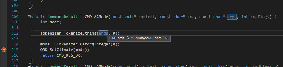

    I see, I just forgot to parse the mode.
    Screenshot of a code editor showing the CMD_ACMode function fragment with the variable 'args' highlighted in Tokenizer_TokenizeString(args, 0).
    Ok, try again, now:
    - AC mode should be on screen:
    A control panel screen showing Mode: off and current device parameters.
    - ACMode command can take also arguments like off, heat, cool, auto, etc
    - changing mode in HA should change OBK:
    Screenshot of a thermostat settings interface showing mode selection: heat, cool, and off options.
    Screenshot showing a fragment of C source code in Visual Studio Code editor.
    - HA should see OBK state (ACMode):
  • #110 21563167
    dressyspider
    Posts: 83
    Rate: 10
    That worked! See below for captures.
    Would it be possible to add the swing positions and fan speed to this dashboard?
    Also, is it possible to allow the OBK logs to show more lines? There is a lot going on and it scrolls fast and clears the older entries.
    ON:
    Della Mini Split air conditioner control panel and device details on two screens, both highlighted in cooling mode.
    OFF:
    Control panel of a Della Mini Split air conditioner and device status screen, both set to off mode.

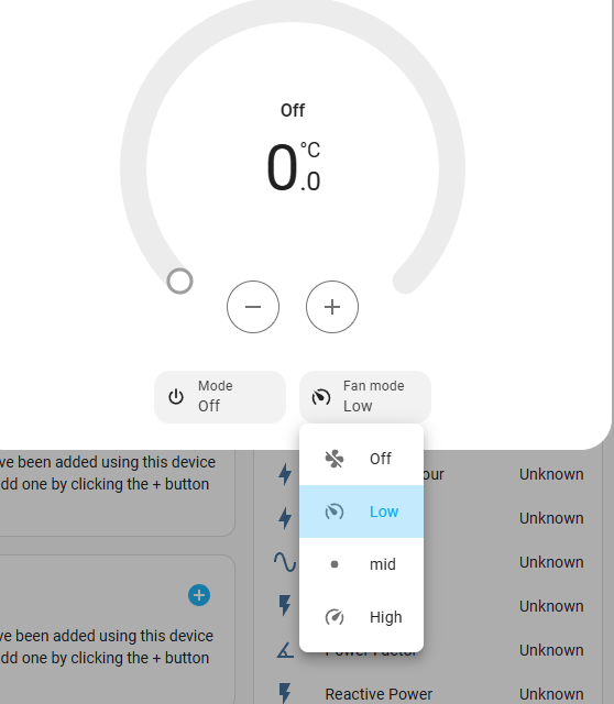

    Ok I'm working on it, but your preset modes are different from what driver has:
    Code: C / C++
    So we probably need to map them to low/mid/high, any preferences?
    WIP:
    Air conditioner control panel set to 0°C, turned off, with the fan mode dropdown set to Low.
  • Suggested fan-speed mapping for Smart Life levels
    #116 21563323

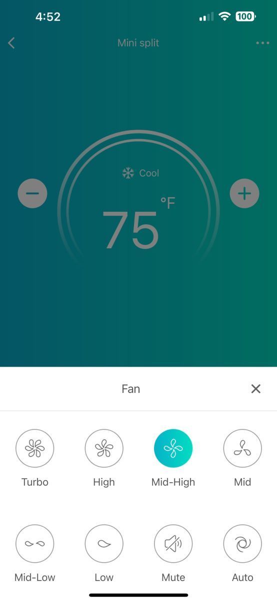

    Thanks, that makes sense. The driver definitely offers more options than standard HA presets.
    Below is a screenshot from the Smart Life app showing the available fan speed levels:
    auto, mute, mid-low, mid, mid-high, high, turbo
    App screen for controlling a mini split air conditioner, set to cooling at 75°F and Mid-High fan speed.
    Based on that, here’s a suggested mapping:
    FAN_AUTOMATIC → auto
    FAN_MUTE → mute
    FAN_1 → mid-low
    FAN_2 → mid
    FAN_3 → mid-high
    FAN_4 → high
    FAN_TURBO → turbo
    I’d recommend skipping FAN_OFF. Turning the fan off during cooling could cause the coil to freeze due to lack of airflow. The fan should only be turned off when the system is powered off and/or not actively heating or cooling.
    Let me know if this setup works or if you'd like me to test anything. Glad to help however I can.

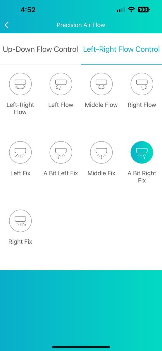

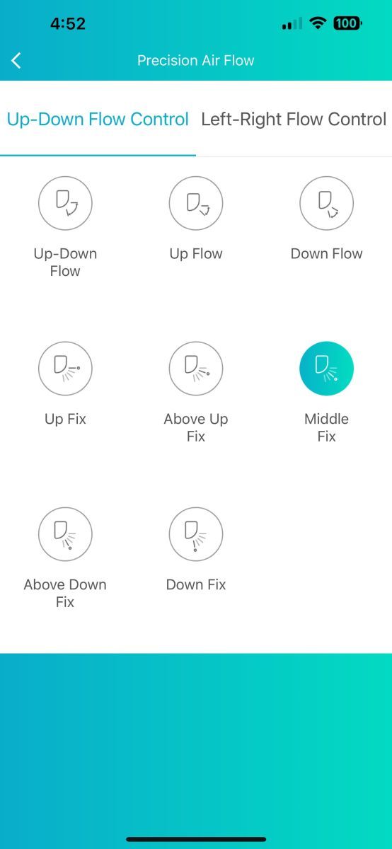

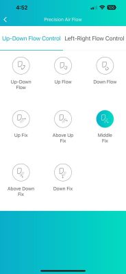

    Also, regarding swing positions the Smart Life app shows the following options:
    Vertical Swing
    up down flow, up flow, down flow, up fix, above up fix, middle fix, above down fix, down fix
    Horizontal Swing
    left right flow, left flow, middle flow, right flow, left fix, a bit left fix, middle fix, a bit right fix, right fix
    It would be great if these could be exposed in HA or the OBK UI especially the auto sweep modes like up down flow and left right flow which are commonly used
    Lastly users may also want access to additional system modes shown in the app like dry, fan, or auto mode depending on their mini split model

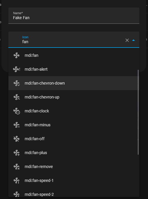

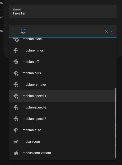

    Edit:
    There are fan icons with numbers, but only 1 through 3. I would just use mdi:fan for all fan speeds. Except auto, I would use mdi:fan-auto.
    Home Assistant Fan Icons:
    A list of fan-related icons in a user interface, with a text field named Fake Fan at the top. Icon selection screen showing a list of fan icons and a search bar, with the name field set to Fake Fan.
    Edit 2:
    Maybe these can be broken up?
    Vertical Swing Flow
    Vertical Swing Fixed
    Horizontal Swing Flow
    Horizontal Swing Fixed
    App screen for controlling air conditioner airflow direction with various directional settings. Air conditioner air flow control panel with various left-right direction options.

    It seems that HA climate AC entity has single swing option, not separate per H/V.
    For now, I've figured a generic selection dialog for swings. Would that be acceptable?
    Screenshot of an IoT device control panel with smart thermostat settings and expanded Vertical Swing Mode menu.
  • #120 21563343
    dressyspider
    Posts: 83
    Rate: 10
    Perfectly acceptable
    Thank you for adding this in!
