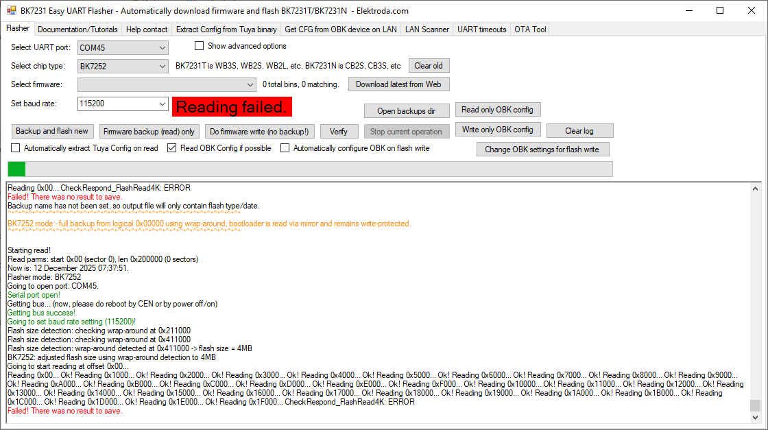

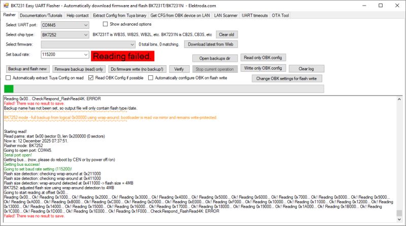

  • BK7252 read errors appear to stop flashing early
    #127 21778541
    Posts: 5212
    Help: 446
    Rate: 914
    I've been playing with BK7252 2/4mb wrap-around and generally with BK7252U BK7231T/U it seems to give up some as soon as there's a read error, no retries /per sector crc check? Is this correct? It seems other tools are more resilient/forgiving. hmm

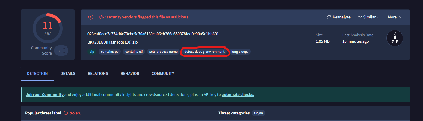

    also, any change in detection with the AV experiments? https://github.com/openshwprojects/BK7231GUIFlashTool/pull/88
  • #129 21779041
    Posts: 14755
    Rate: 12881
    i was rather expecting network scan tool and Process.Start to cause some alarms, but I haven't found anything meaningful yet. Strange.

    Haha, really? Nice! How did you come up with it? Even with bisecting approach, it would take me some time.
  • #132 21779175
    insmod
    Posts: 1432
    Help: 168
    Rate: 455
    >>21779170
    Well, it started detecting in that commit, and continued even after i removed both z and z2 flashers.
    So, i took a guess and removed all combobox.add except for one. And it worked.
    How/why would it trigger av, i don't know.

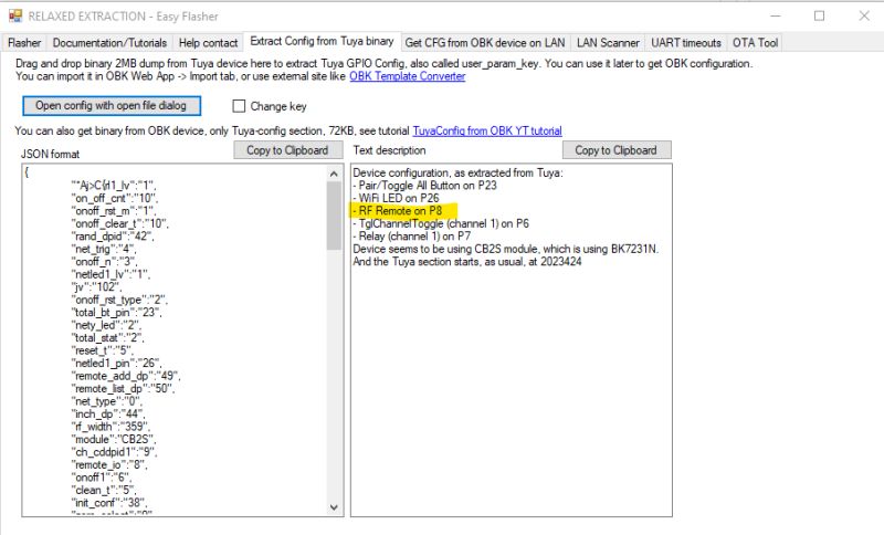

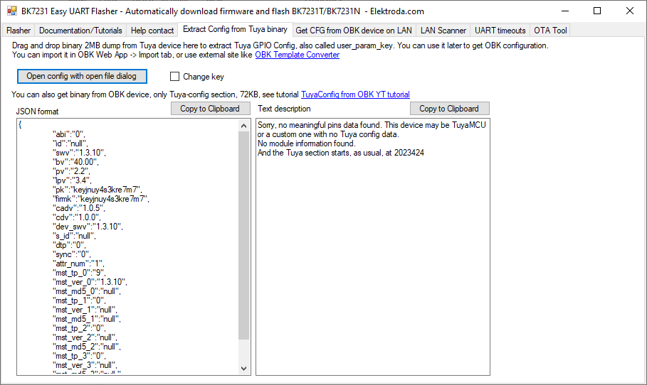

    #133 21781489
    Posts: 5212
    Help: 446
    Rate: 914

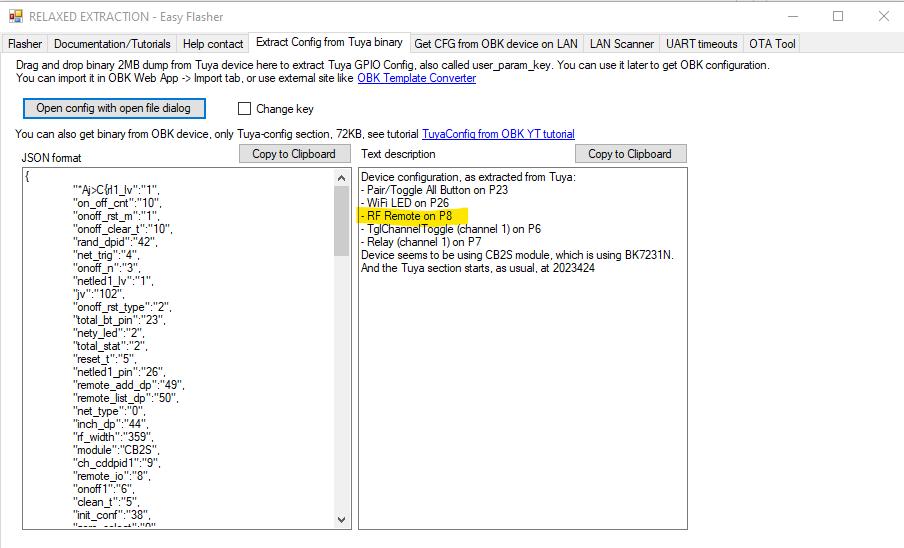

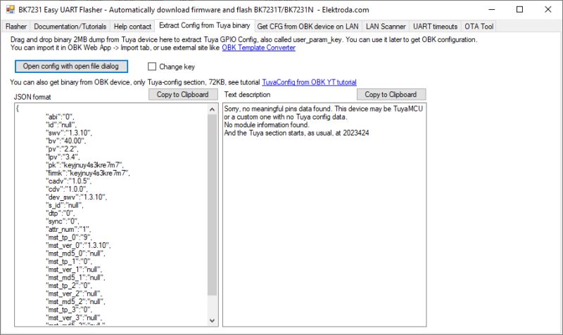

    Screenshot of Easy Flasher software with extracted Tuya device configuration
    but only on my relaxed extraction branch, which I often use to get more info https://github.com/divadiow/BK7231GUIFlashTool/tree/relaxedextraction
    otherwise it's this with v178:
    Screenshot of BK7231 Easy UART Flasher with device JSON config displayed
    I wonder if any "Sorry, no meaningful pins data found.." user posts may be because of EF rather than the data not being there
  • #134 21781506
    Posts: 14755
    Rate: 12881
    Which changes did you make to improve extraction, any downsides?
    Any ideas for fixes for remaining AV detections?
  • Relaxed Tuya key extraction to scan full decrypted buffer
    #135 21781521
    Posts: 5212
    Help: 446
    Rate: 914
    it's basically replacing
    with this
    tldr:
    (t34 tweaks was a previous branch. got gpt to update after insmod sorted T34 module name because there were merge conflicts)
    downsides are that you get random junk at the end of extraction sometimes. I'm sure it could be nicer, but it's been v useful to know you get closer to getting all the infoz, including wifi credentials if stored, so there's that to consider filtering out. Users might blindly paste those about without noticing.

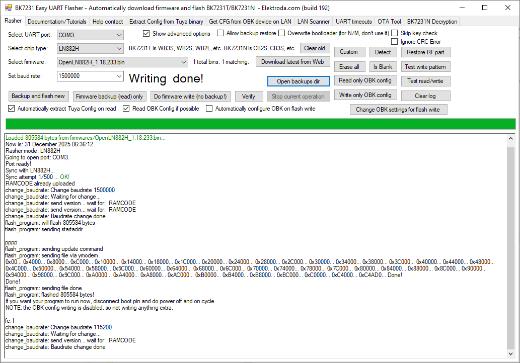

    Updated BL and LN882H flashing support
    #145 21794374
    insmod
    Posts: 1432
    Help: 168
    Rate: 455
    BL chip detection by bootrom version. BL602 - 1, BL702 - 0x7020001, BL616 - 0x6160001. Not known for BL704/706/618.
    Added BL702 and BL616 read. For some reason BL702 write is not working. Didn't bother to fix it. BL616 will read if BL602 or BL702 is selected and BL616 rom version is detected.
    Rewritten LN882H ramcode flash read to use xmodem-1k (for robustness).
    Added CRC check for LN882H.
    LN read and OBK write work first try

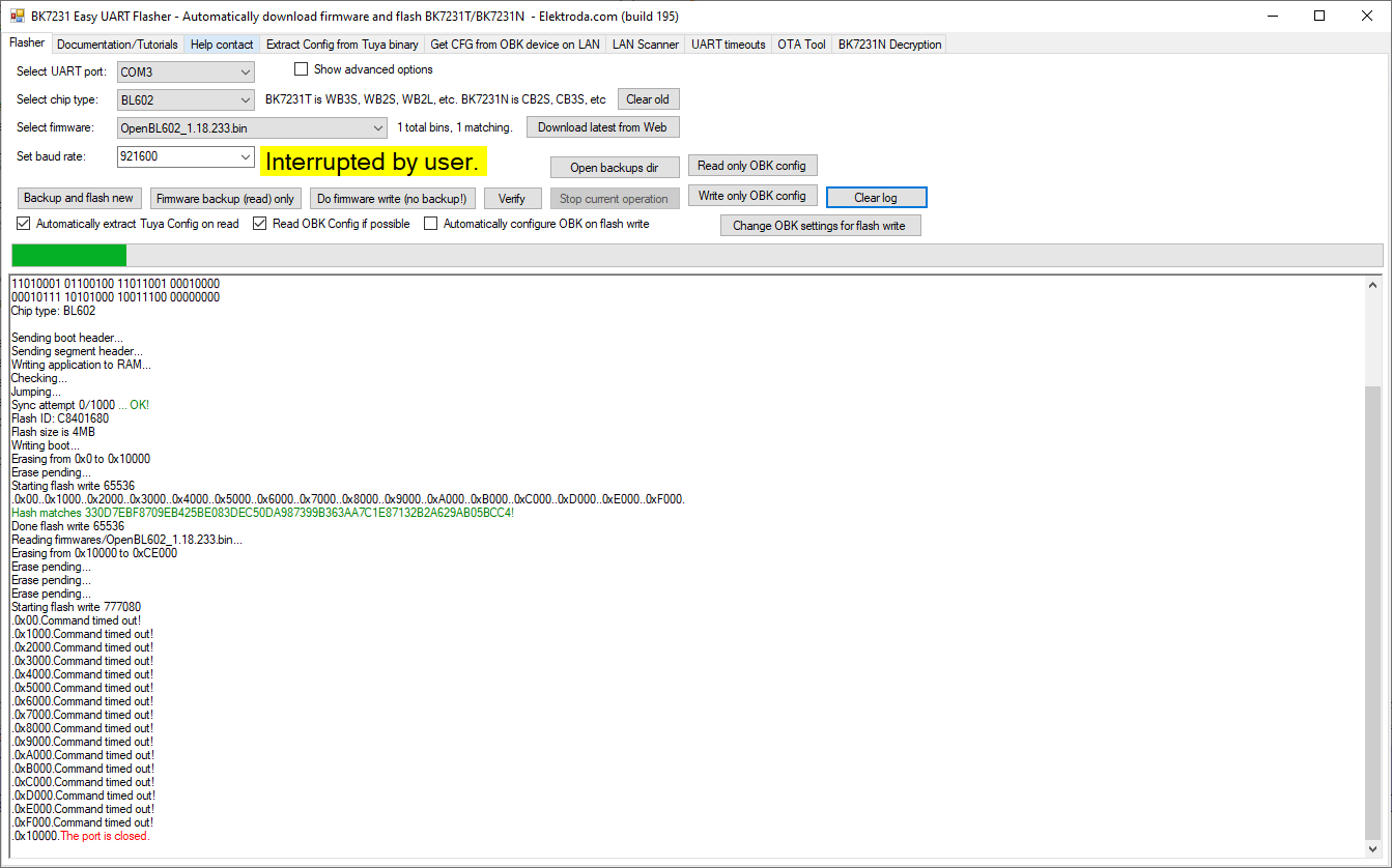

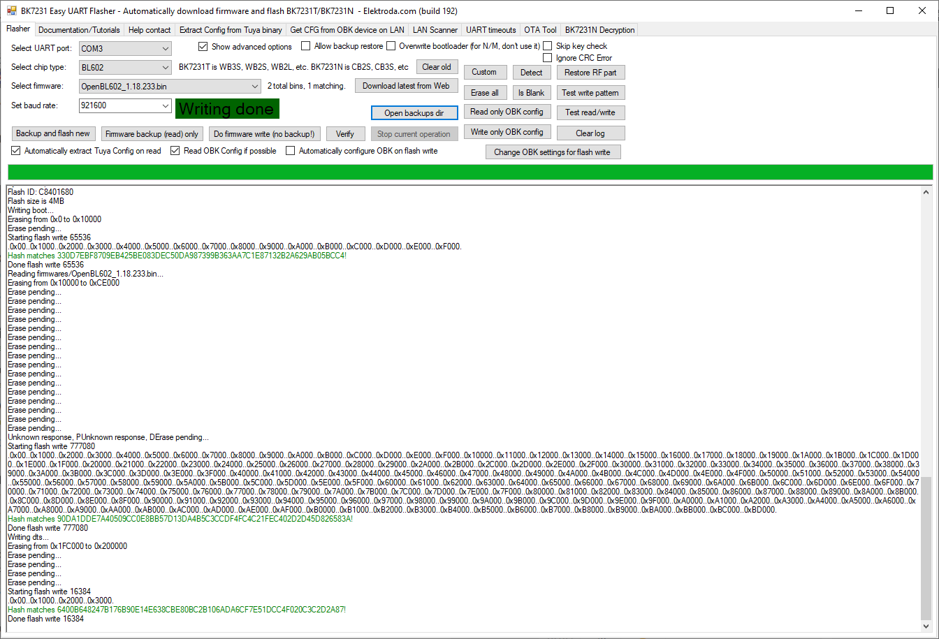

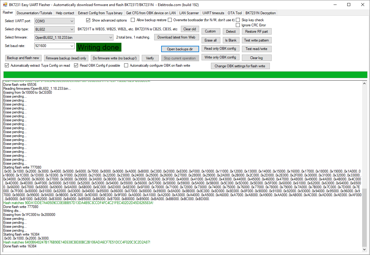

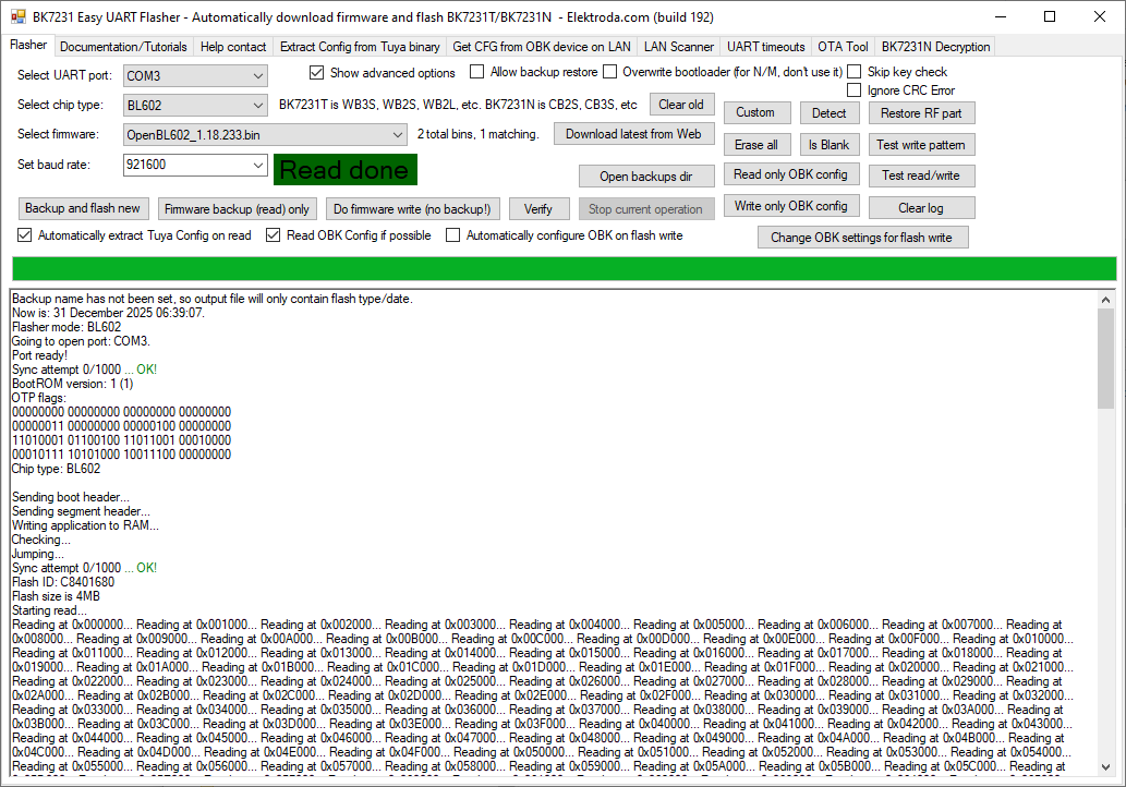

    BK7231 Easy UART Flasher screen showing completed memory read and hex data.Screenshot of BK7231 Easy UART Flasher showing successful firmware flashing
    BL602 seems OK too
    Screenshot of BK7231 Easy UART Flasher with successful BL602 flash read completed Firmware flashing process for OpenBL602 completed with Writing done message
    though I do get command time out half the time when writing

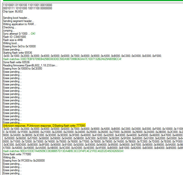

    Screenshot of BK7231 Easy UART Flasher with “Interrupted by user” message
    just noticed this. I wonder what that is
    Screenshot of debug log during BL602 chip flashing with error message highlighted
    Added after 53 [seconds]:
    Screenshot of BK7231 Easy UART Flasher showing errors during firmware flashing on BL602
    Added after 32 [minutes]:
    can be seen if successful write too though
    Screenshot of BK7231 Easy UART Flasher after successful firmware flashing
  • BL702 write timeouts fixed by reducing buffer length

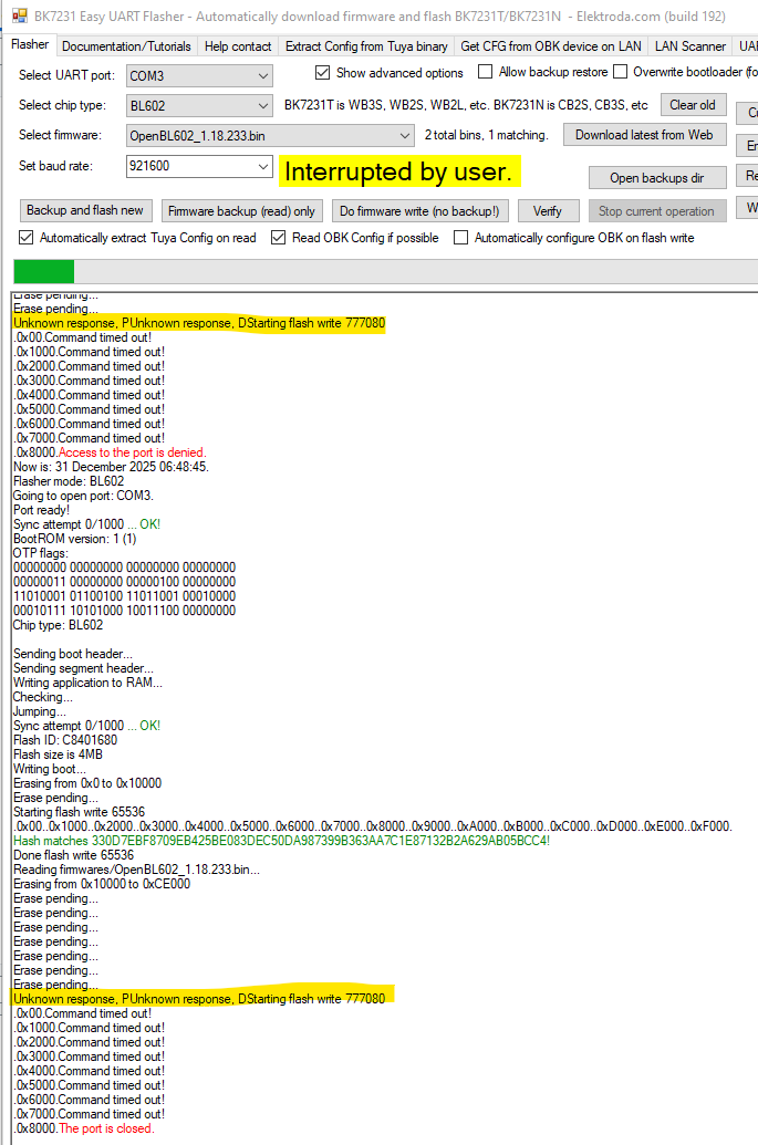

    #147 21794420
    insmod
    Posts: 1432
    Help: 168
    Rate: 455
    PD is for pending, OK is for when erase is done. But serial.Read(buf, 0, 2) somehow returns when only 1 byte is available and doesn't wait for second byte (it will be zero).
    Tried to fix it, please check.
    Plus try 2000000 baud on LN
    For BL702 it always times out on write for me
    BootROM version: 117571585 (7020001)

    Added after 24 [minutes]:
    On BL702 it works if i reduce buffer length to less that 915 (?) 914 works, but 916 doesn't. If 915, then one write succeeds (at 0x202B), but the rest fails.
    This is write with 512 buffer. Initial writes times out, but the rest is fine.
    Reading backups\readResult_BL702_test_2025-27-12-08-01-05.bin...
    Erasing from 0x0 to 0x100000
    Erase pending...
    Erase pending...
    Erase pending...
    Erase pending...
    Erase pending...
    Erase pending...
    Erase pending...
    Starting flash write 1048576
    .0x00.Command timed out!
    .0x200.Command timed out!
    .0x400.Command timed out!
    .0x600.Command timed out!
    .0x800.Command timed out!
    .0xA00.Command timed out!
    .0xC00.Command timed out!
    .0xE00.Command timed out!
    .0x1000.Command timed out!
    .0x1200..0x1400..0x1600..0x1800..0x1A00..0x1C00..0x1E00..0x2000..0x2200..0x2400..0x2600..0x2800..0x2A00..0x2C00..0x2E00..0x3000..0x3200..0x3400..0x3600..
    0xFFA00..0xFFC00..0xFFE00.
    Hash matches F5FB04AA5B882706B9309E885F19477261336EF76A150C3B4D3489DFAC3953EC!
    Done flash write 1048576

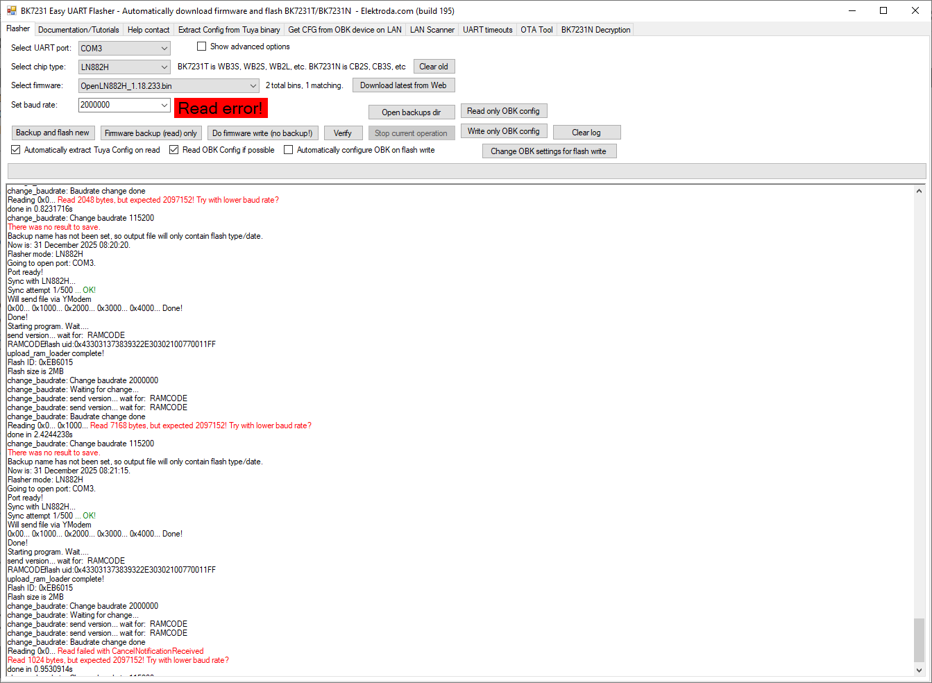

  • 2 Mbps baud improves write success on LN
    #148 21794442
    Posts: 5212
    Help: 446
    Rate: 914
    921600. 6x no, 4x yes in 10 tests. board removed from power between each try. powered with BT button depressed each time before attempts
    BK7231 Easy UART Flasher interface with Interrupted by user message
    insmod wrote:
    Do you have any other BL that is not BL602?
    sadly no. @p.kaczmarek2 has BL702 though
    Added after 6 [minutes]:
    nice. 10x success writing at 2mbs. speedy
    reading never succeeds
    Screenshot of BK7231 Easy UART Flasher showing Read error during flashing
    #149 21794502
    insmod
    Posts: 1432
    Help: 168
    Rate: 455
    Did some additional fixes for BL, now write always succeeds for me on BL702 with 1024 buffer (and 4096 too).
