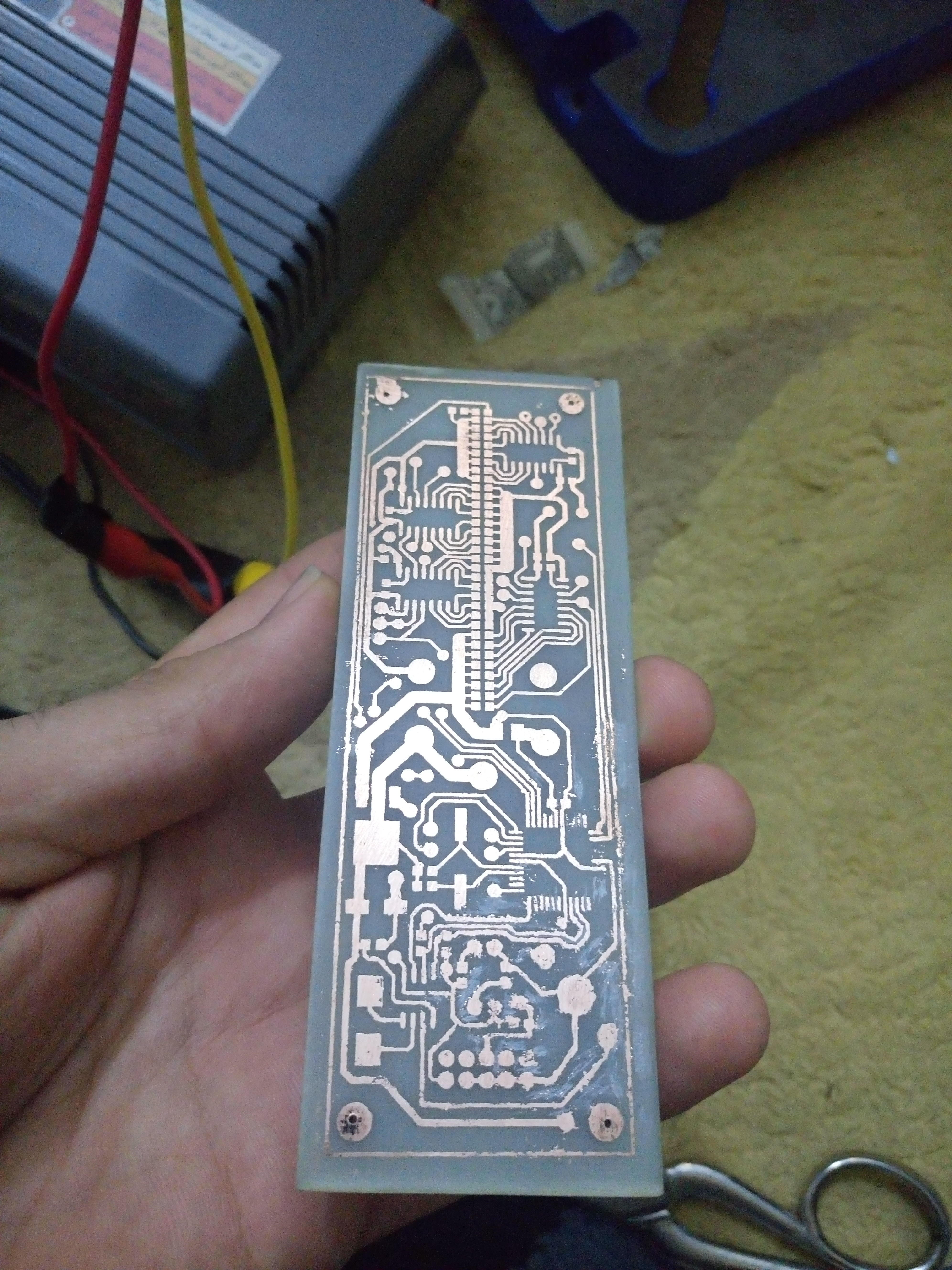

  • #217 13876501
    Sonia1993
    I have one more question, I was able to etch the board and I encountered another problem with the micro resistor k200 and k270 are these resistors in KILO or in ohm ?? I have not come across such a designation yet, thanks in advance
  • #218 13880503
    DJCheester
    Level 28  
    Posts: 2090
    Help: 75
    Rate: 960
    In this case, you treat k as a comma, so you read 0.200k and 0.270k correctly, so these are just ohms.
    PS you have never met a marking on resistors, e.g. M10 it was a 100k ohm resistor
    Regards ....
