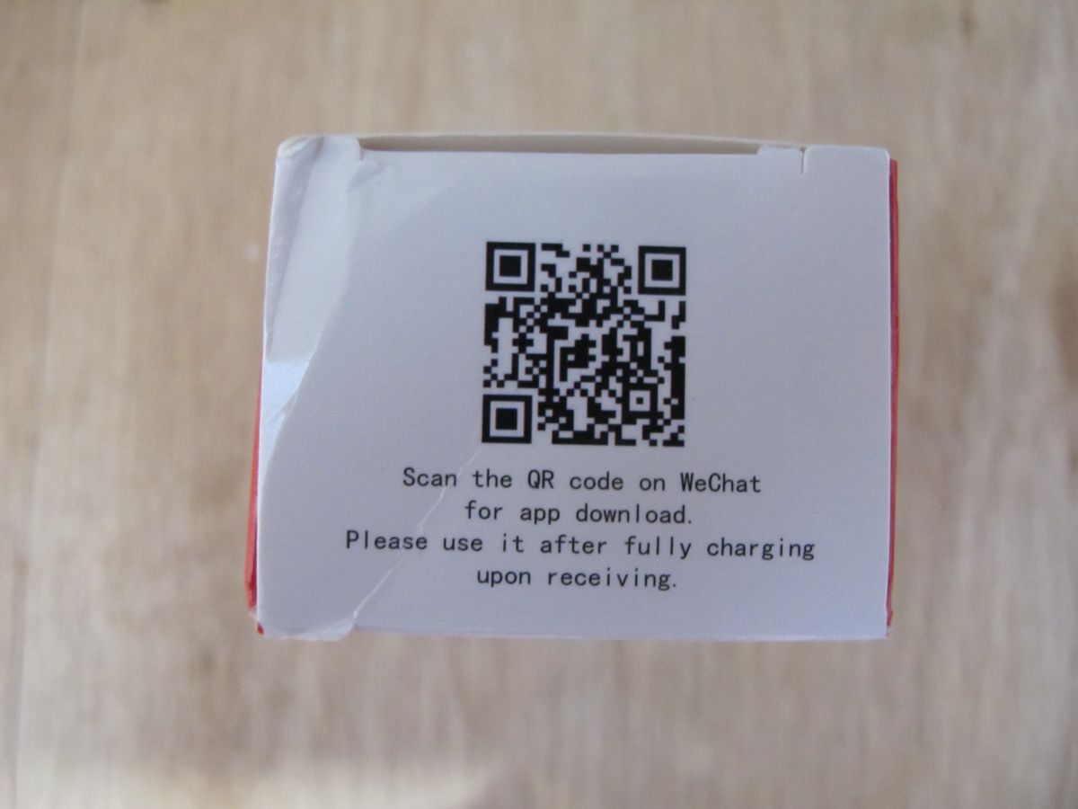

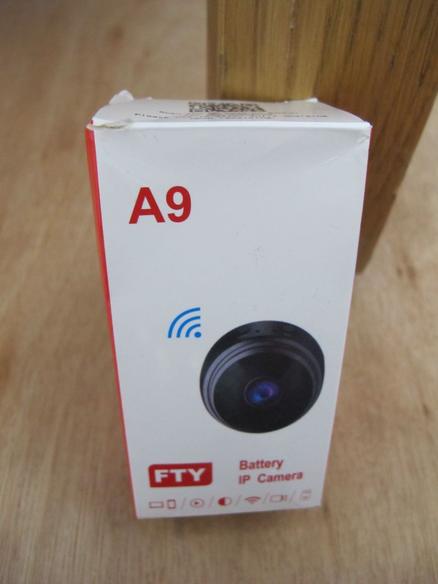

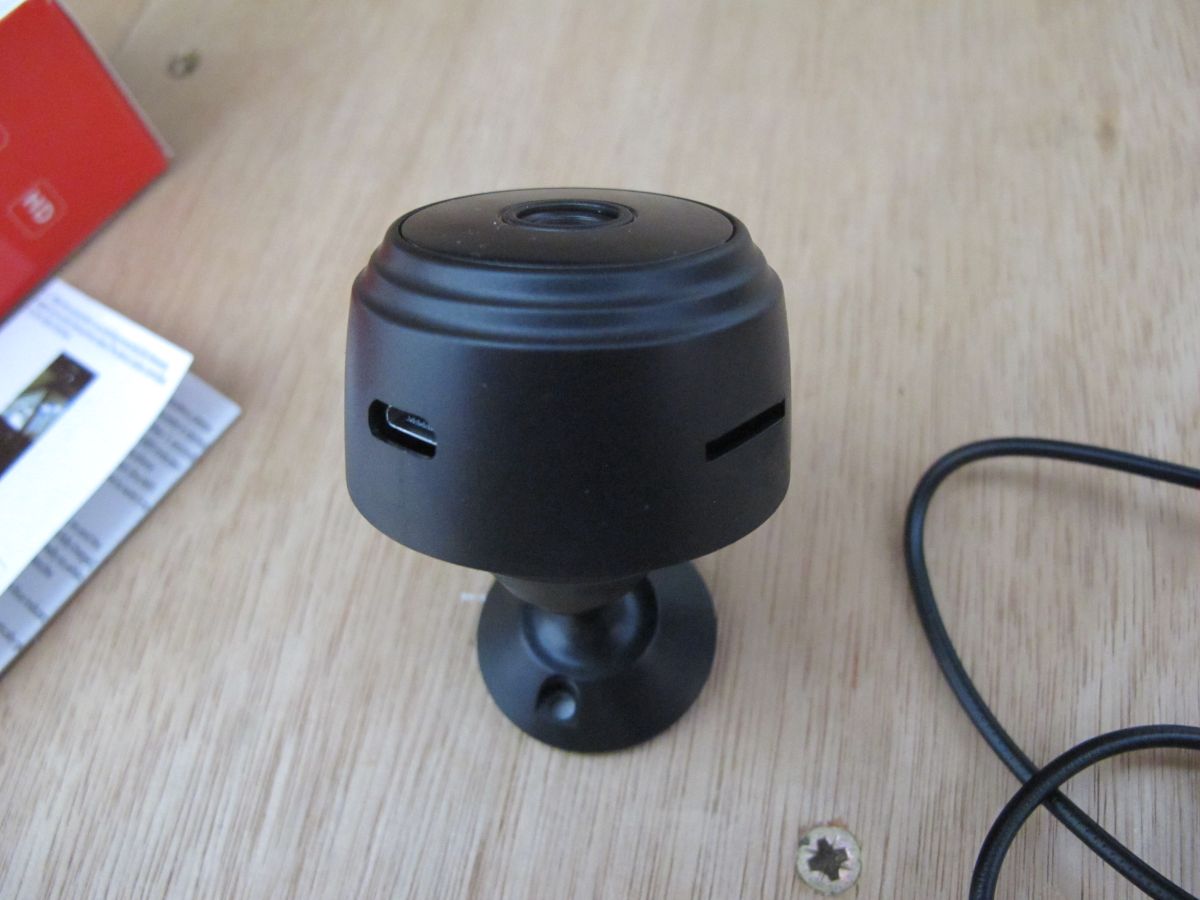

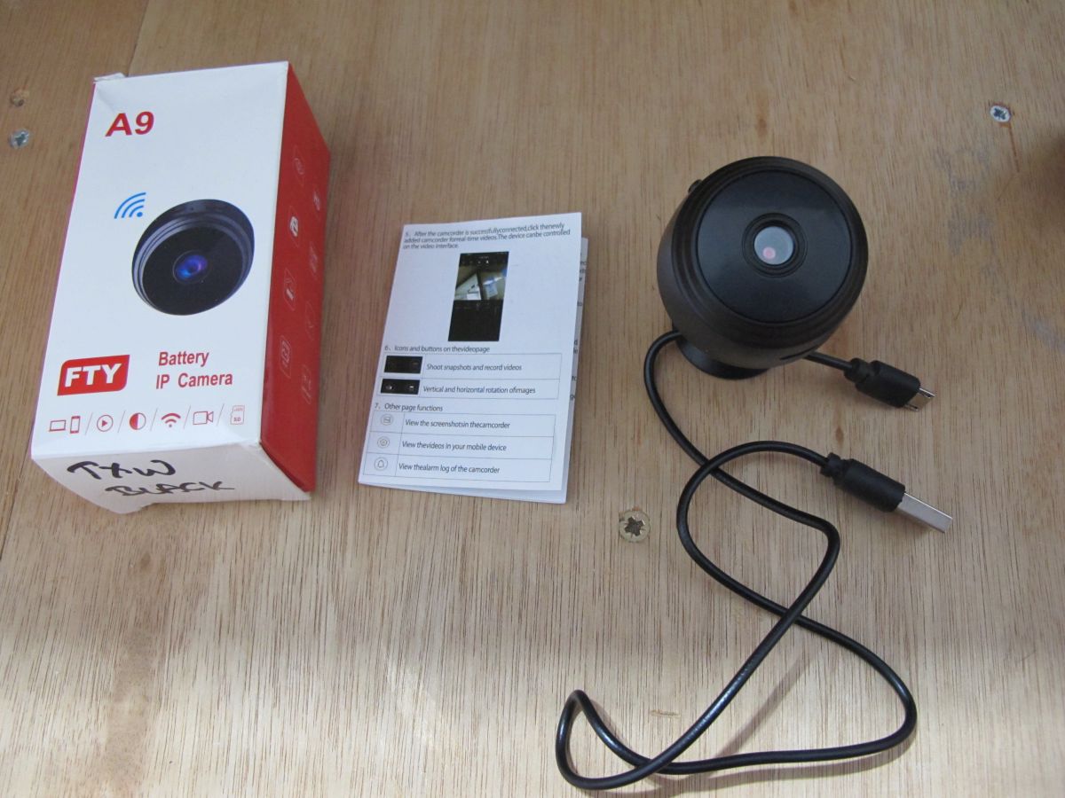

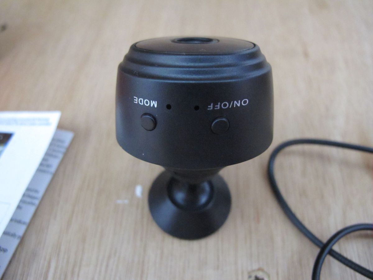

Another FTY A9 camera variation. This was bought in Feb 2024 and I no longer have record of where from exactly - Ali Express for sure. Not seen this posted anywhere I don't think, so here's some info:
Packaging of the A9 IP camera lying on a wooden surface. A QR code and instructions in English on a white box against a wooden background. Packaging of an FTY A9 battery IP camera on a wooden surface. Label on a red box with details about the A9 WiFi Mini Camera. Red packaging side with icons and feature symbols, placed on a wooden background. Small IP camera with box, user manual, and USB cable on a wooden surface. Small black camera or spy camera with cable, stand, and manual on a wooden table. Black security camera on a stand, top view. A black security camera on a stand, placed on a wooden surface.
Choice SKU: 742329872052
Item: A9 WIFI Mini Camera Recorder Security Monitoring Wireless Video Mini Camera Recorder Voice Camera Smart Home For Infants And P Sensor
Hunan Shiyue Technology Co. Ltd
Room 514,515,516, 517-208. Building 3, Yulong Tianxia Jiayuan II Complex, No. 799 Youmutang Road, Guanshaling Street, Yuelu District Changsha City, Hunan Province, PR China
AP SSID broadcast is FTYC535866GRDBZ
I don't know which battery it came with as I have several in a pile from a few cams.

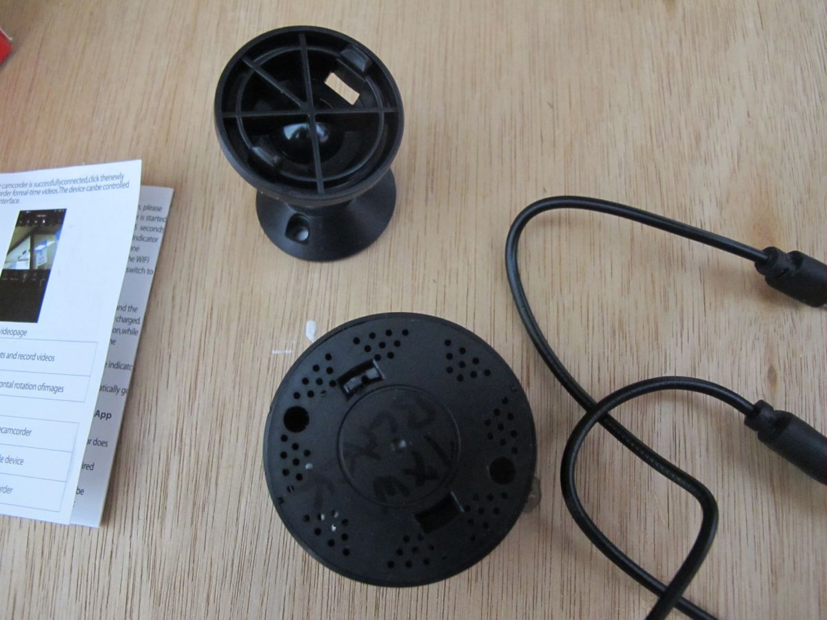

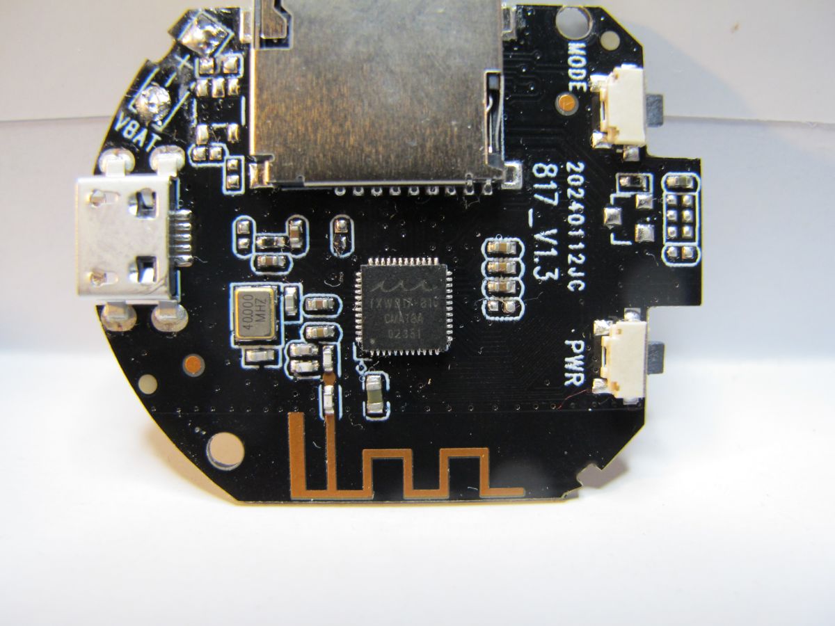

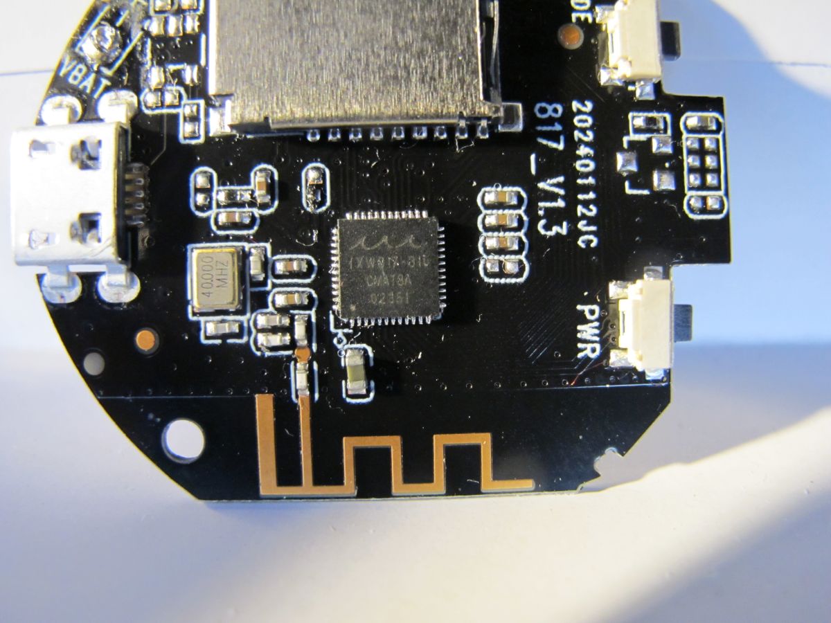

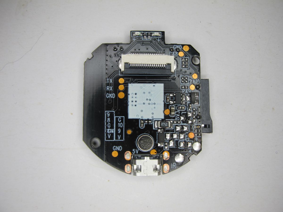

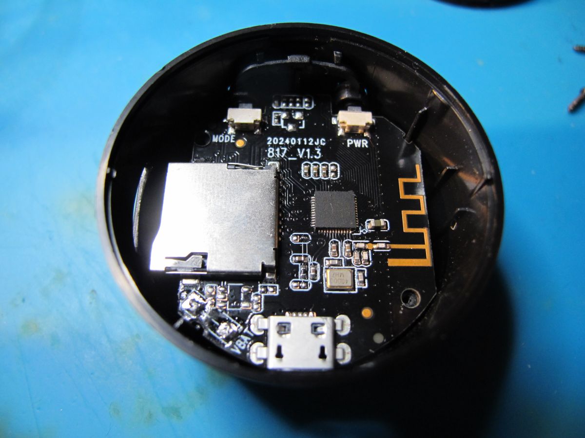

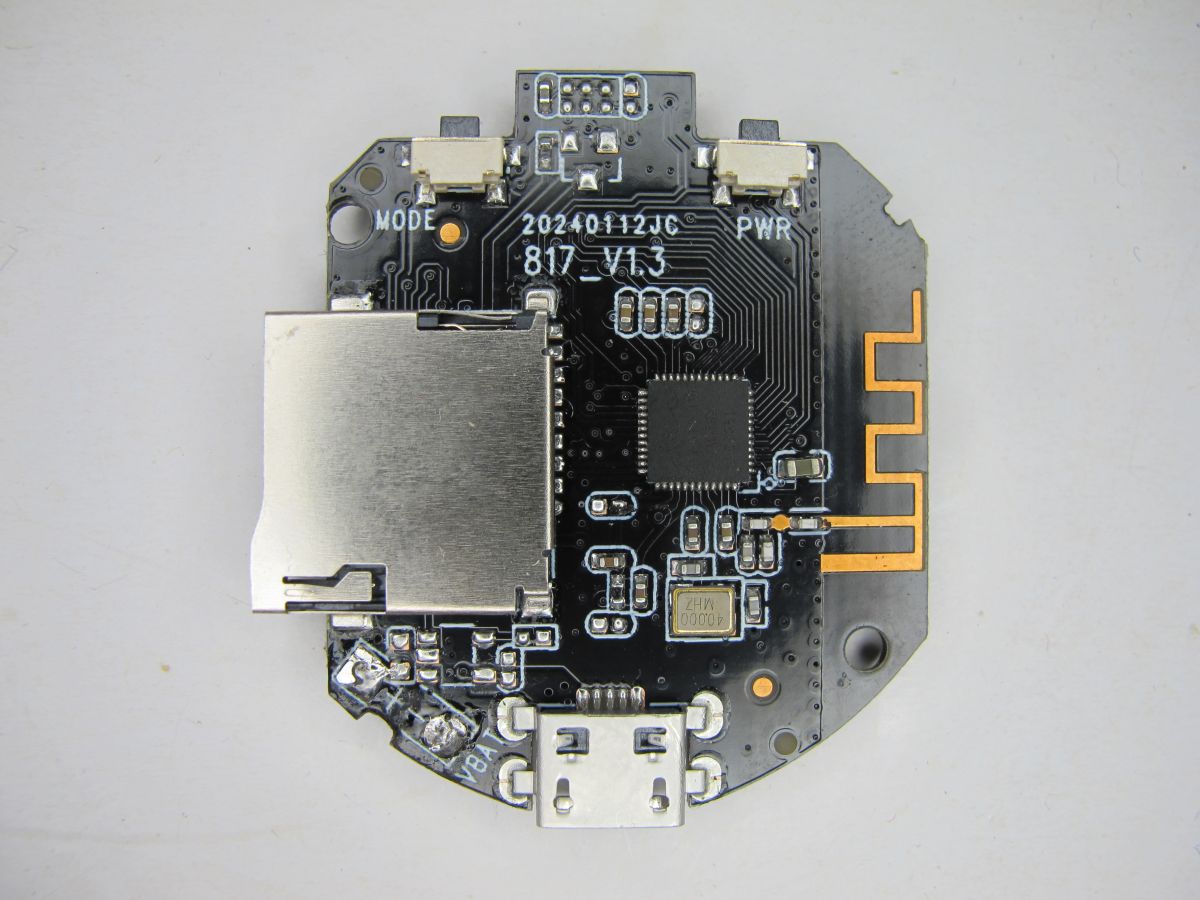

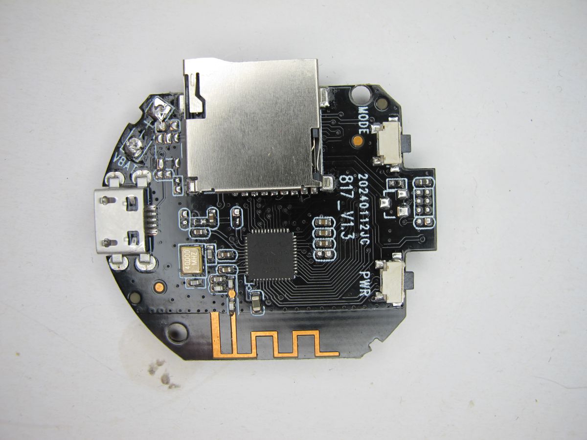

Inside of a round electronic device showing a PCB with a micro USB port and a microSD card slot. Disassembled camera with electronic circuit board, lens, and casing parts on a blue surface. Small modular camera placed on a blue surface. Printed circuit board with various electronic components and connectors. Printed circuit board with microSD slot, micro USB port, electronics, and antenna. A round printed circuit board with a micro USB port, a microSD card slot, and electronic components. Round printed circuit board with micro USB port, microSD slot, and built-in antenna. Close-up view of a round printed circuit board with a micro USB port, electronic components, and conductive traces. Printed circuit board with various electronic components and connectors. Close-up of a round printed circuit board with electronic components, micro USB port, and PCB antenna.

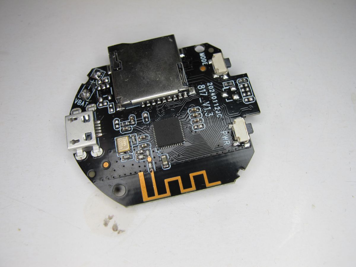

MCU is the popular QFN48 Taixin Semi TXW817-810 - eg https://www.elektroda.com/rtvforum/topic4121456.html

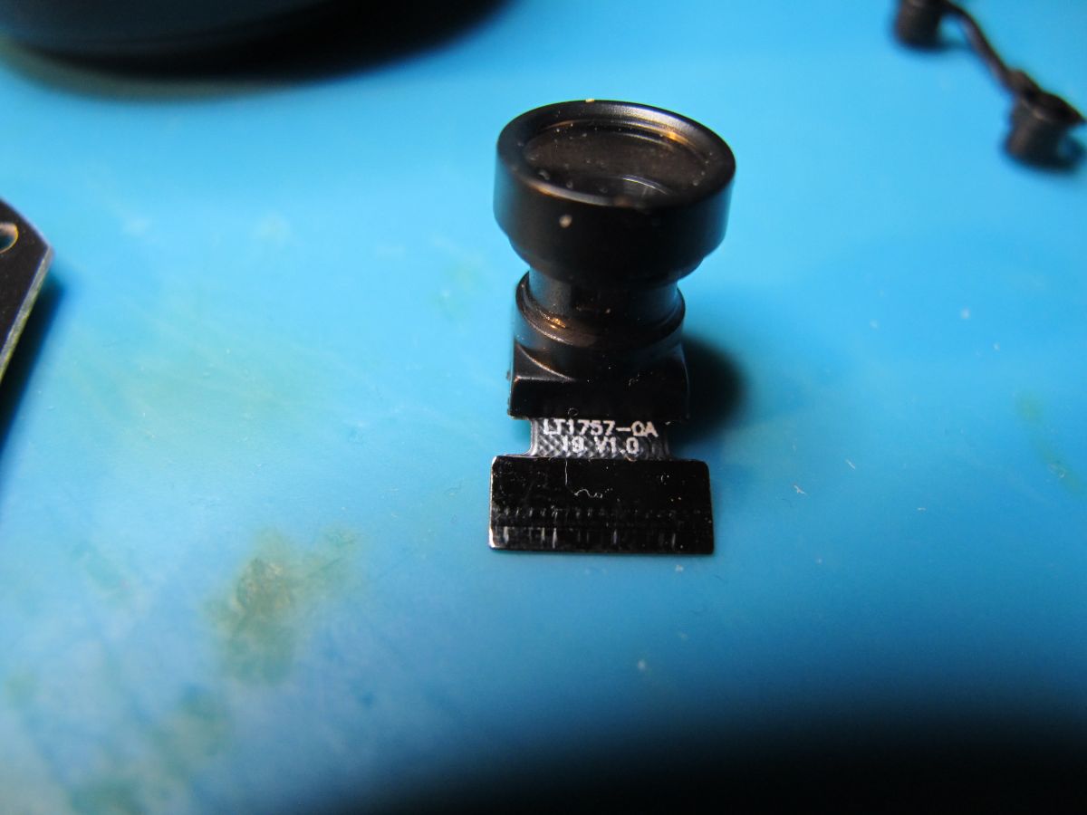

cam sensor is a 640x480 SuperPix SP0A19 (LT1757-OA-10 V1.0) also included in the XF16 cam module ID parade https://www.elektroda.com/rtvforum/topic4121965.html
PCB markings: 20240112JC 817_V1.3

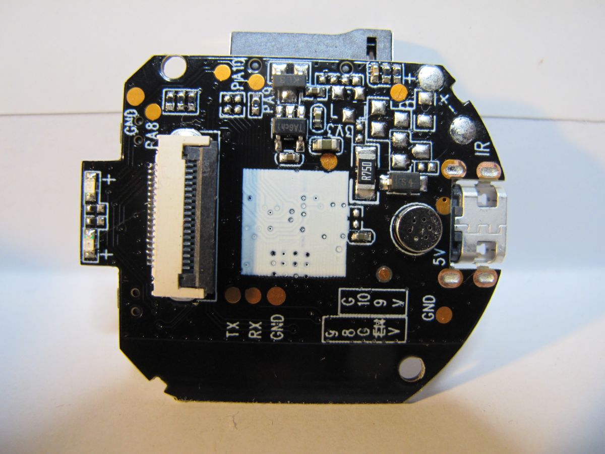

from RX pad at 921600 baud

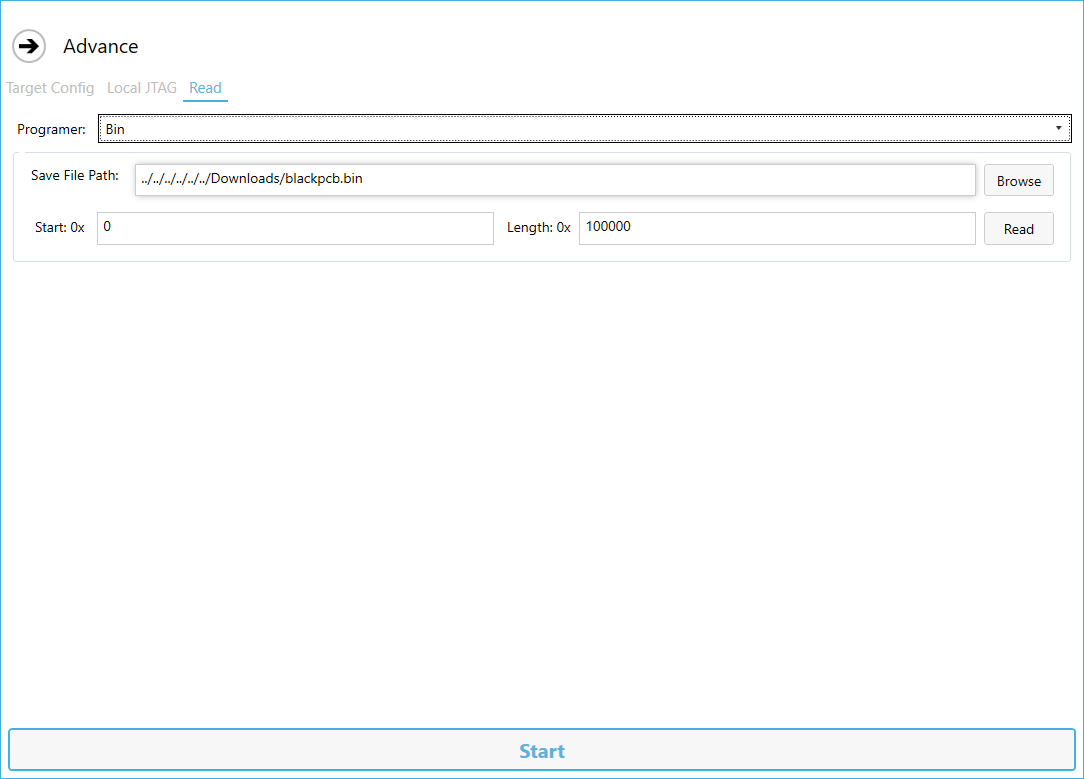

For once DebugIO (PA9) and DebugCLK (PA10) are correctly labelled so a backup can be taken with those - see topic C-SKY Flash Programmer with STM32 CK-Link Lite: Reading/Writing to Taixin TXW817-810 MCU for firmware backup instructions. BUT note that PA10 is shared with the blue LED so almost immediately the GPIO switches to flashing the LED. Precise timing is required to catch the firmware before it boots far enough to change GPIO function. In the T-Head Debugging Server once connected:
and 1mb dump with C-SKY Flash Programmer
Screenshot of a program window for memory reading via JTAG with read mode and binary file path selected.

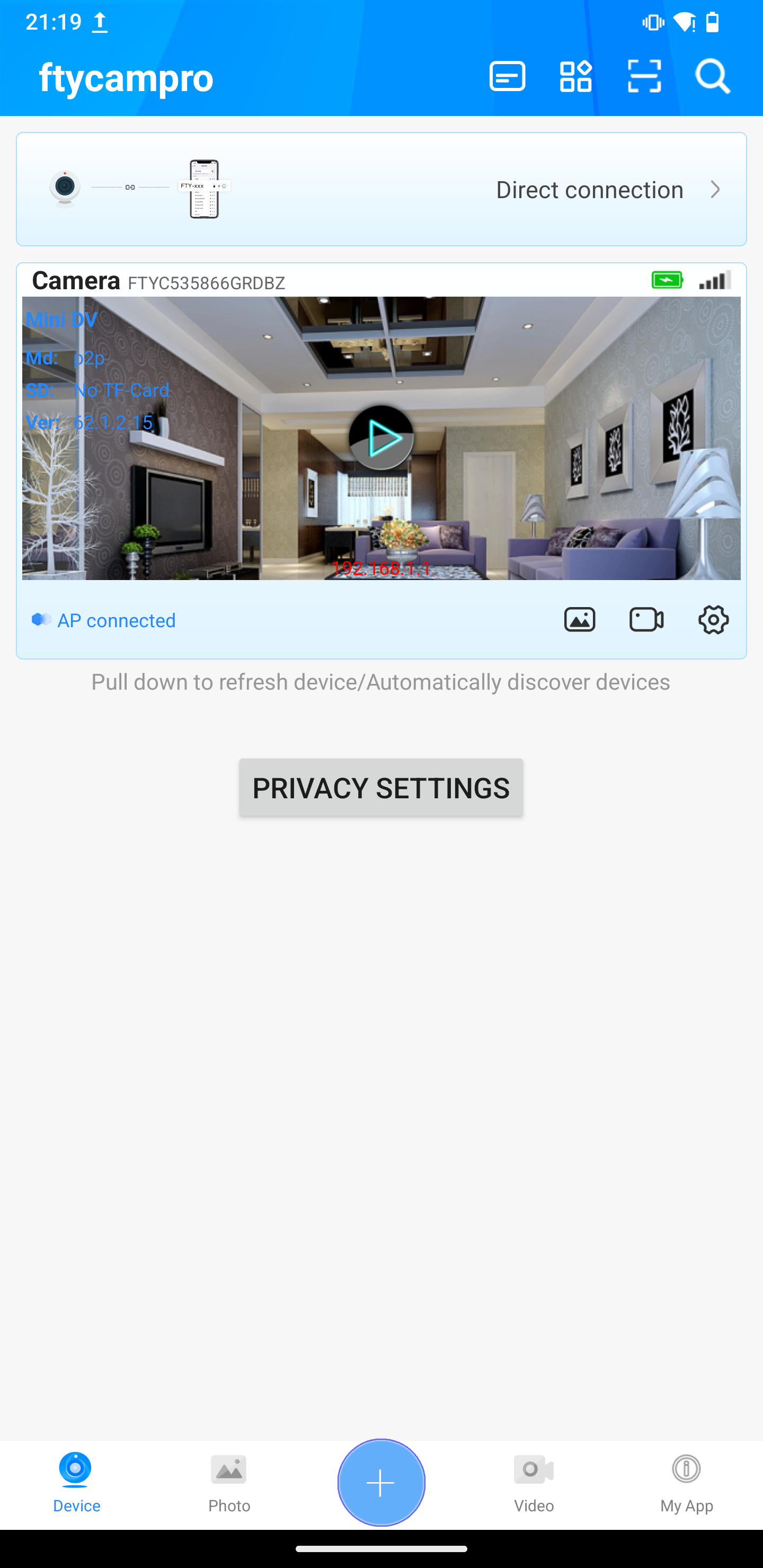

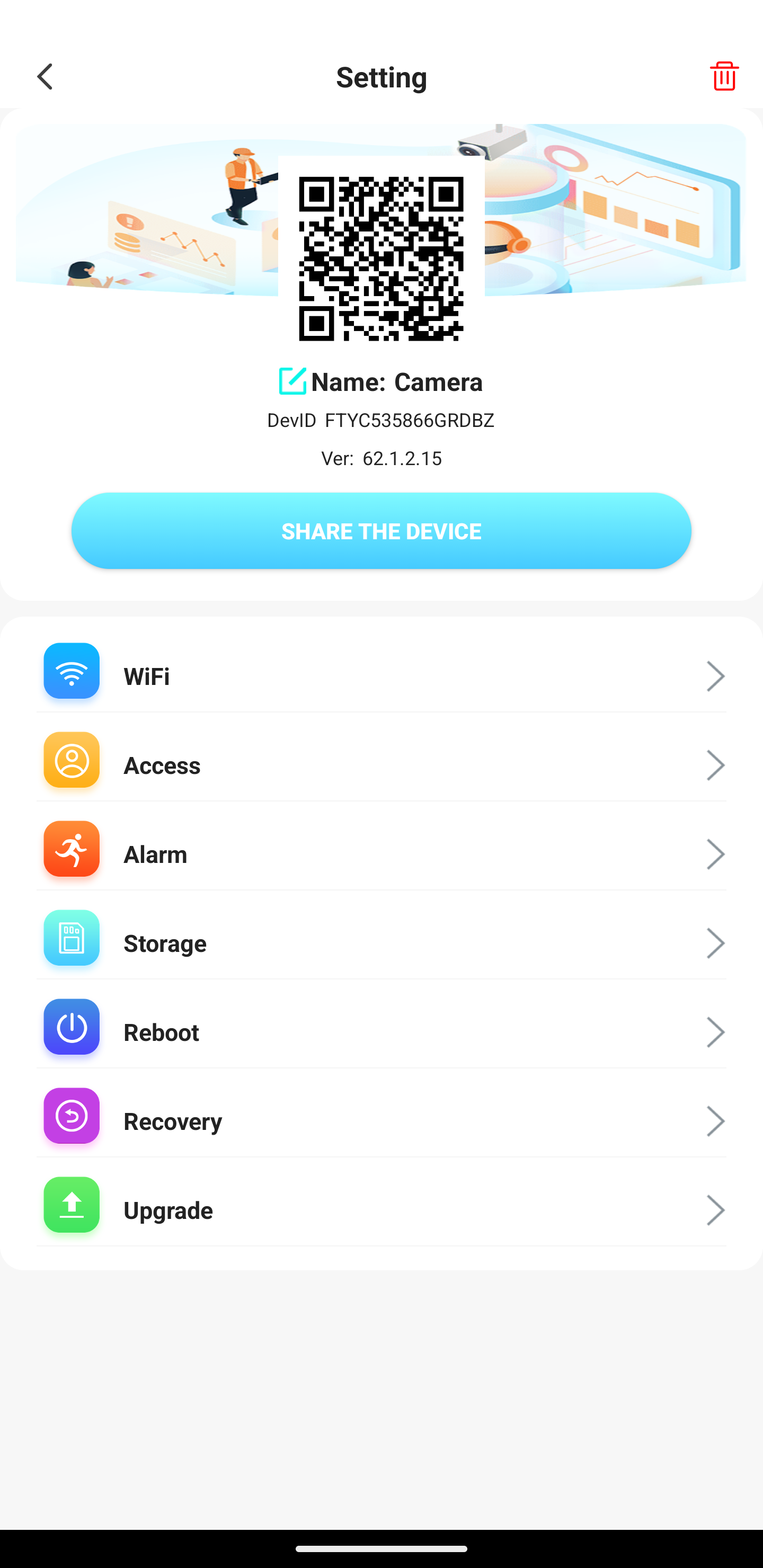

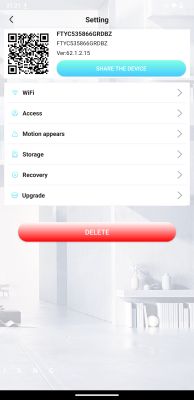

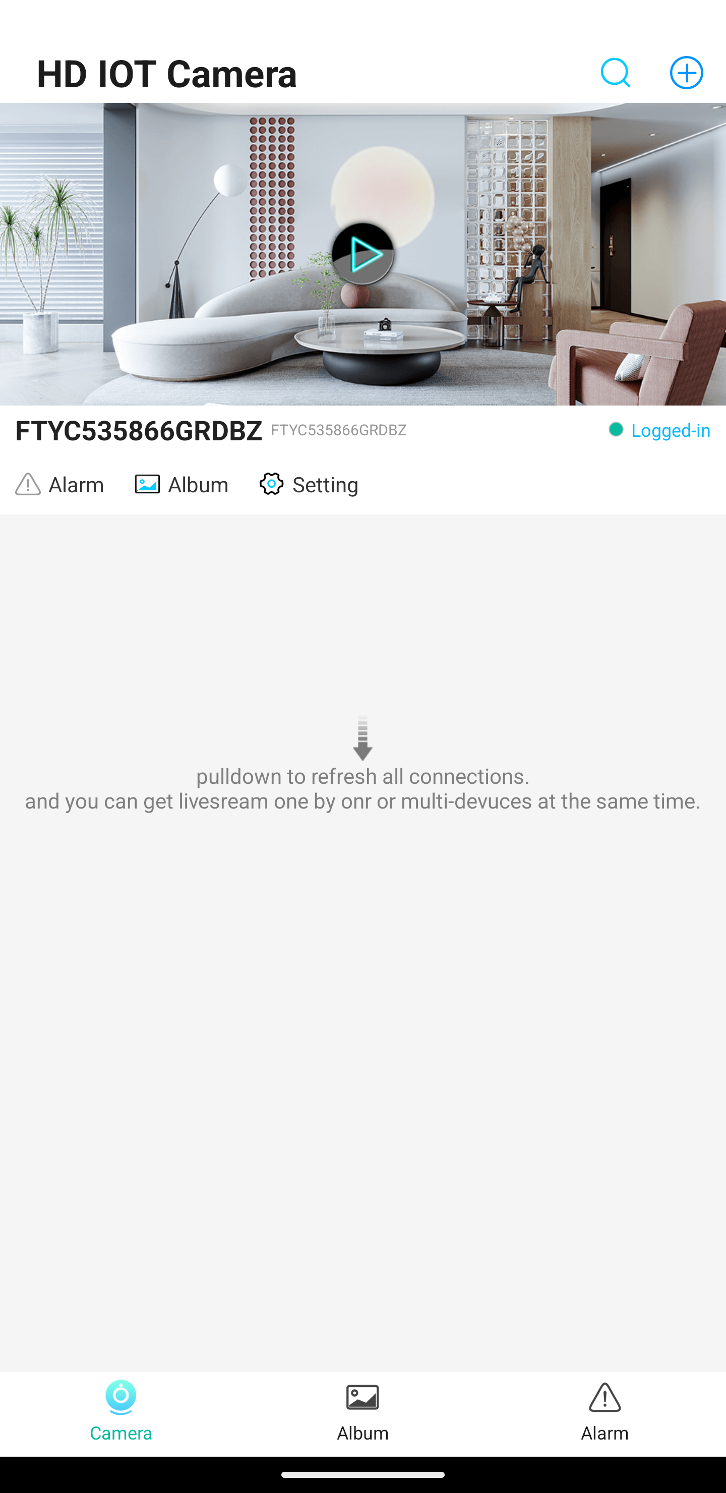

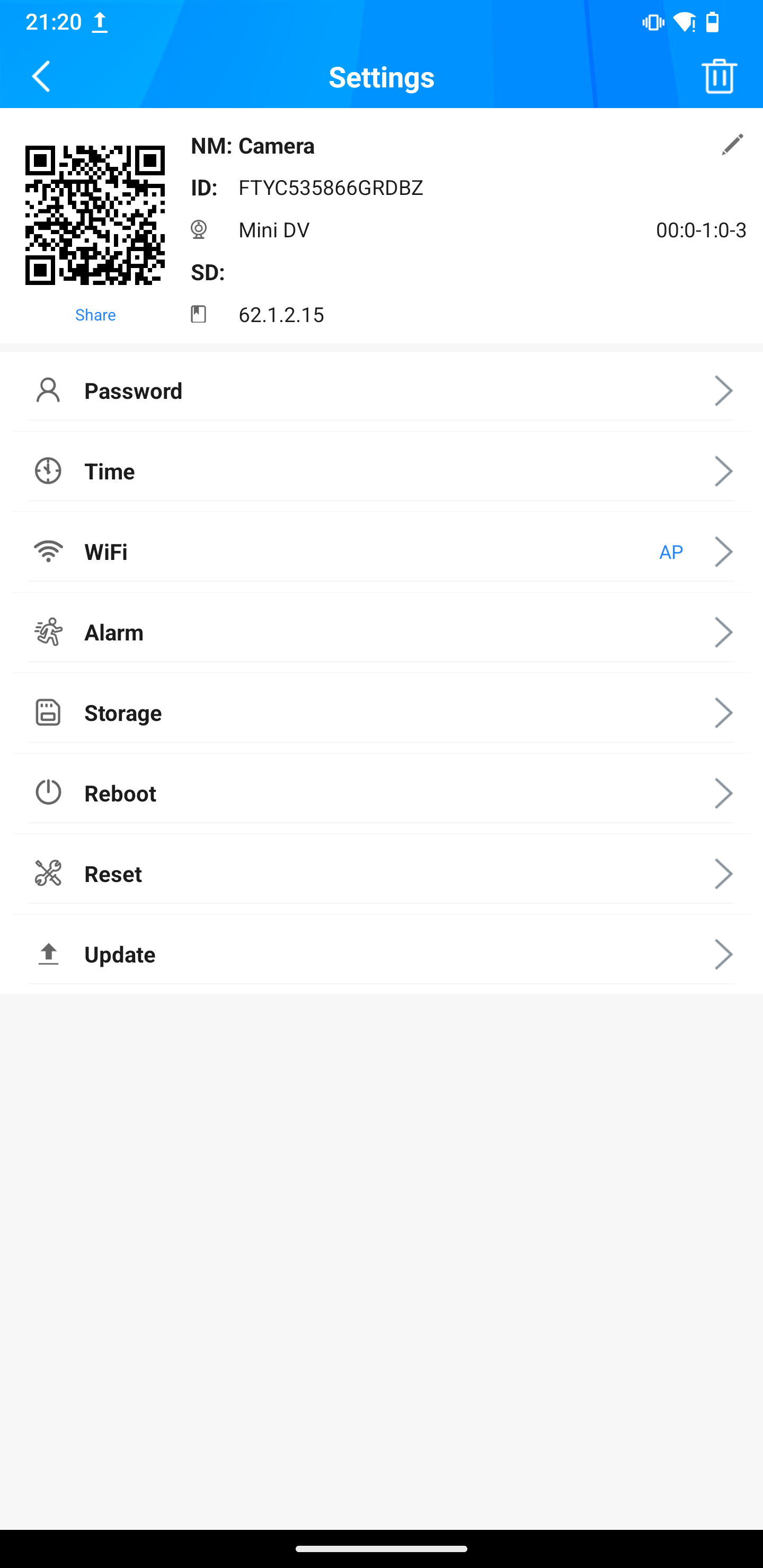

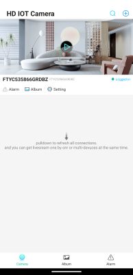

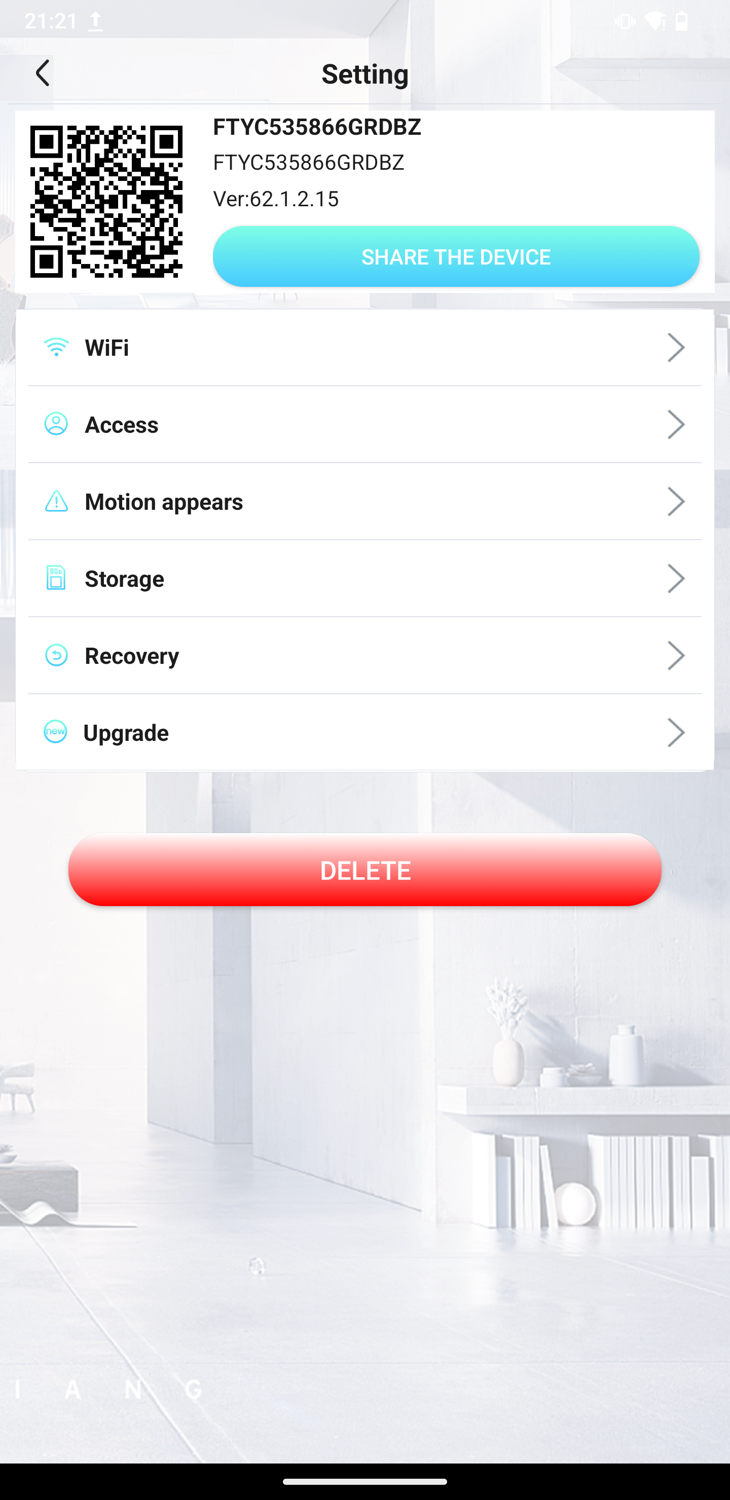

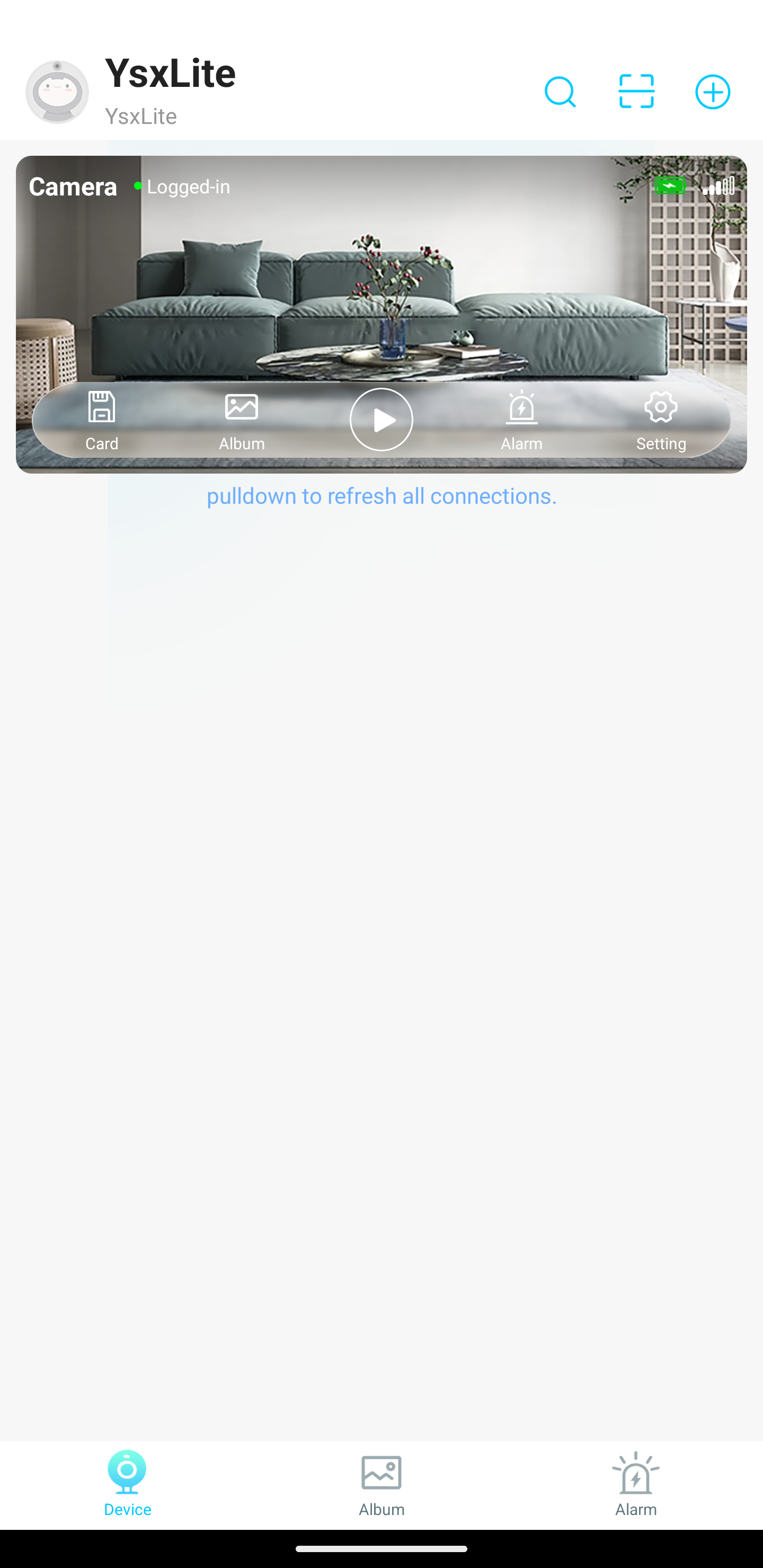

Cam is detected by ftycampro, HD IOT Camera and YsxLite apps
Screenshot of a mobile surveillance app showing a live camera view of a living room. Settings screen of a Mini DV camera app with a visible QR code and configuration options.
HD IOT Camera app interface showing a live view of a modern living room. Device settings app screen with configuration options, a QR code, and a Delete button.
Screenshot of the YsxLite app showing a camera view of a modern living room with a gray sofa and coffee table. Camera settings screen in a mobile app, showing a QR code and device management options.

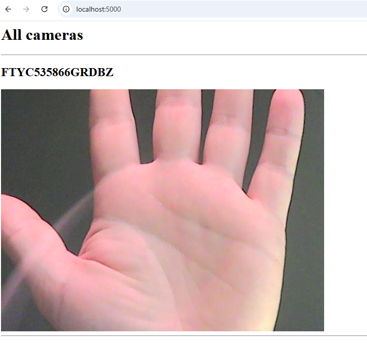

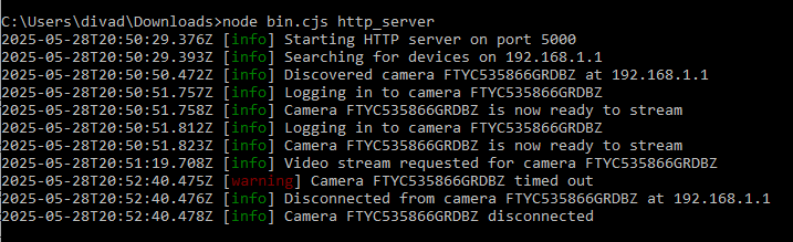

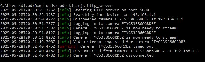

Cam can also be used locally, without cloud, thanks to cam-reverse - Elektroda guide.
The image shows an open hand with fingers spread against a dark background.
Console with HTTP server logs from Node.js, showing connection attempts with a network camera.
