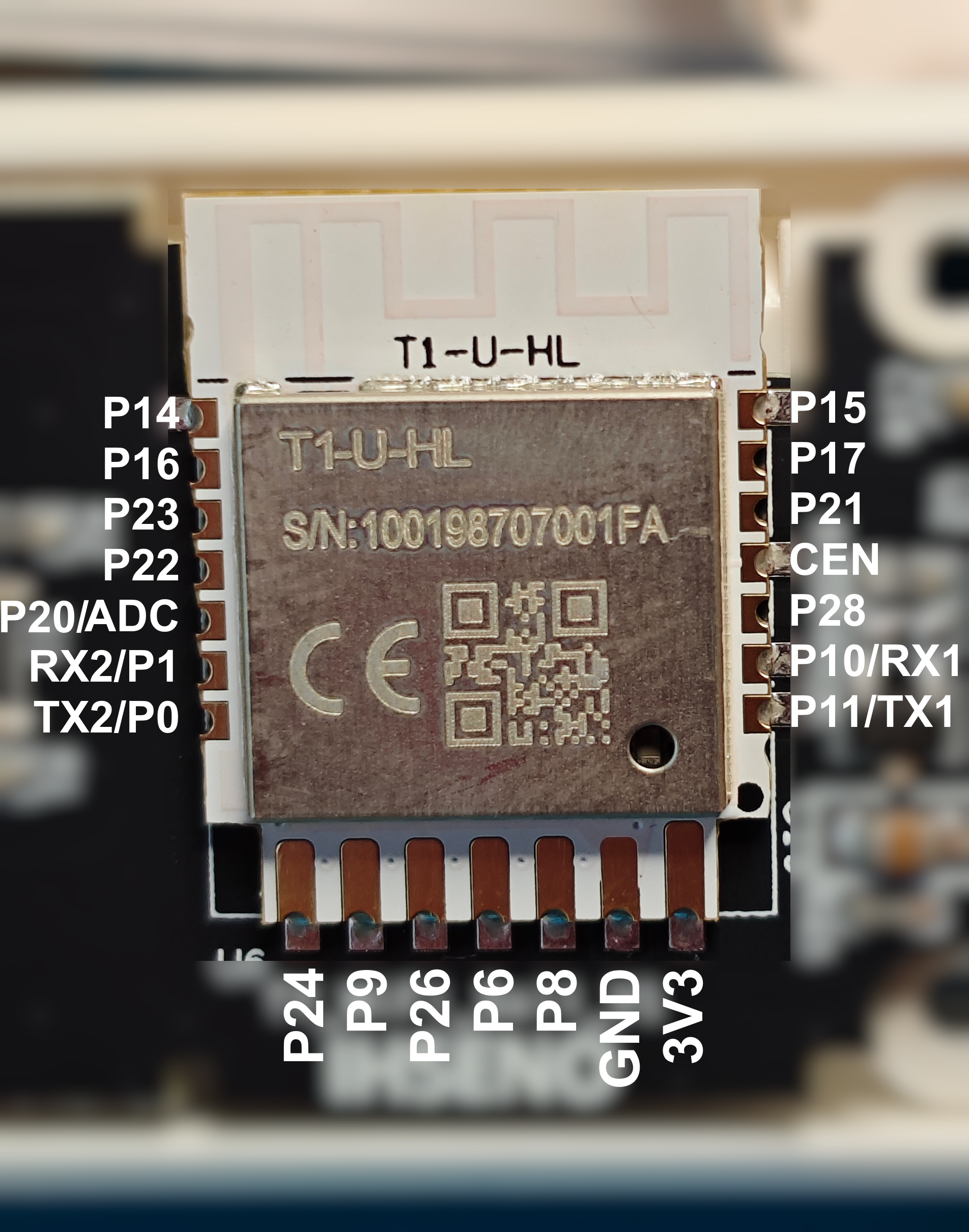

to reveal the main module - the T1-U-HL, a 16kb MindMotion MM32G0001 Arm Cortex-M0 TuyaMCU (also seen here) and an HGSEMI C5551 WSAH SOIC8 chip.
Tuya T1-U-HL module and components on IHSENO TY_WiFi_Soil_V1 sensor PCB Tuya T1-U-HL module and IC on PCB of IHSENO TY WiFi Soil V1 device Close-up of PCB with push button, HGSEMI C5551 chip, and SMD components. Close-up of PCB with MM32G0001 chip and Tuya T1-U-HL module with exposed test pads

T1-U-HL details - https://developer.tuya.com/en/docs/iot/T1-U-HL-Module-Datasheet?id=Kdfp5j893qwxg
Top view of Tuya T1-U-HL module with pin numbers and size measurements Bottom view of T1-U-HL module with labeled pins and mechanical dimensions
Pin No.SymbolI/O typeDescription
1P14I/OA normal GPIO pin, corresponding to Pin 19 on the IC. It can be reused as SPI_SCK.
2P16I/OA normal GPIO pin, corresponding to Pin 20 on the IC. It can be reused as SPI_MOSI.
3P23I/OA normal GPIO pin, corresponding to Pin 16 on the IC.
4P22I/OA normal GPIO pin, corresponding to Pin 15 on the IC.
5ADCI/OAn ADC pin, corresponding to P20 (Pin 13) on the IC.
6RX2I/OUART_RX2, corresponding to P1 (Pin 30) on the IC.
7TX2I/OUART_TX2 to print logs, corresponding to P0 (Pin 31) on the IC.
8P24I/OSupport hardware PWM4, corresponding to Pin 17 on the IC.
9P9I/OSupport hardware PWM3, corresponding to Pin 27 on the IC.
10P26I/OSupport hardware PWM5, corresponding to Pin 23 on the IC.
11P6I/OSupport hardware PWM0, corresponding to Pin 24 on the IC.
12P8I/OSupport hardware PWM2, corresponding to Pin 26 on the IC.
13GNDPGround pin.
143V3P3.3V power pin.
15TX1I/OUART_TX1 to send user data, corresponding to P11 on the IC (corresponding to Pin 29 on the IC).
16RX1I/OUART_RX1 to receive user data, corresponding to P10 on the IC (corresponding to Pin 28 on the IC).
17P28I/OA normal GPIO pin, corresponding to Pin 12 on the IC.
18CENI/OThe reset pin, active low, and pulled up internally. It is compatible with the designs of other modules. Corresponding to Pin 11 on the IC.
19P21I/OA normal GPIO pin, corresponding to Pin 14 on the IC.
20P17I/OA normal GPIO pin, corresponding to Pin 22 on the IC. It can be reused as SPI_MISO.
21P15I/OA normal GPIO pin, corresponding to Pin 21 on the IC. It can be reused as SPI_CS
Tuya T1-U-HL module with labeled signal and power pins
