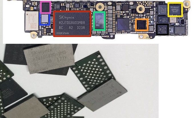

    add this function NAND Flash 64BIT 16GB - serial number (S / N) record in this memory ?Flash NAND Lite Memory Programmer! TSOP48
  • #122 17233230
    funak
    Posts: 1082
    Help: 101
    Rate: 461
    Unfortunately, I have not found documentation for this memory, so I cannot say whether the programmer will handle this memory, however:
    - first, use the LGA -> TSOP48 adapter.
    - secondly, I do not know if this memory will work if it is supplied with only one supply voltage of 3.3V.
    - thirdly, due to the large capacity, the recording of this memory will be quite difficult because there will be a lot of errors during the recording, which will have to be corrected.

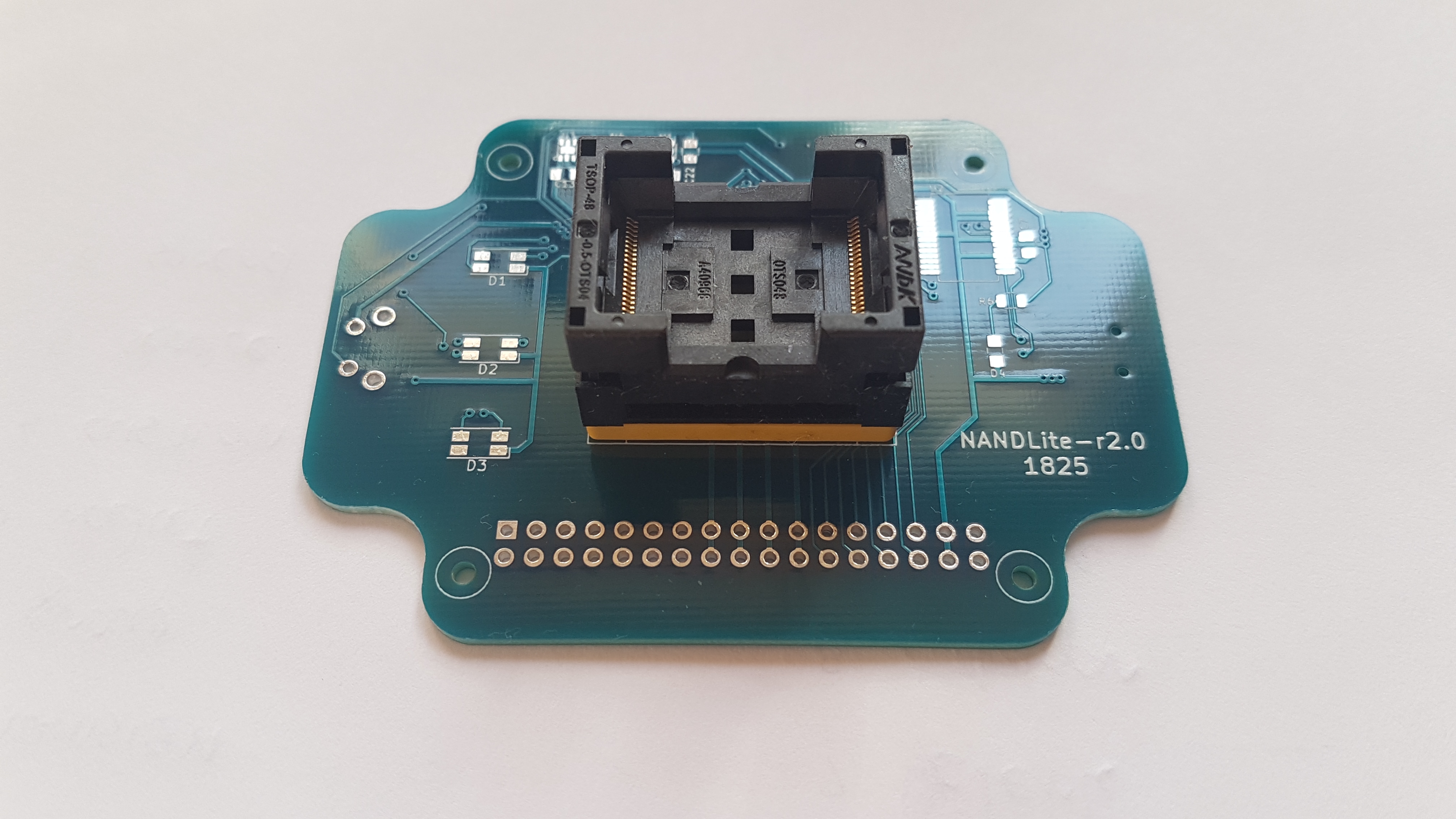

    A new prototype of NANDLite v2.0 in the amount of 10 will be released next week.
    5 pieces are already reserved.
    What's new:
    - long-awaited support for two 1.8V / 3.0V supply voltages, which means that it will be possible to read the systems already in SSD hard drives
    - the ability to connect and disconnect the system from the programmer without removing the USB
    - miniUSB connector for connection with a computer
    - EXT connector for external expansion adapters, planned support for many memories, including NOR, eMMC, SPI, I2C and others, but also support for BGA adapters
    - automatic detection of the type of connected adapter, or several at the same time, if necessary.
    There will also be a major overhaul of the application that supports the programmer. So the news is getting ready :)

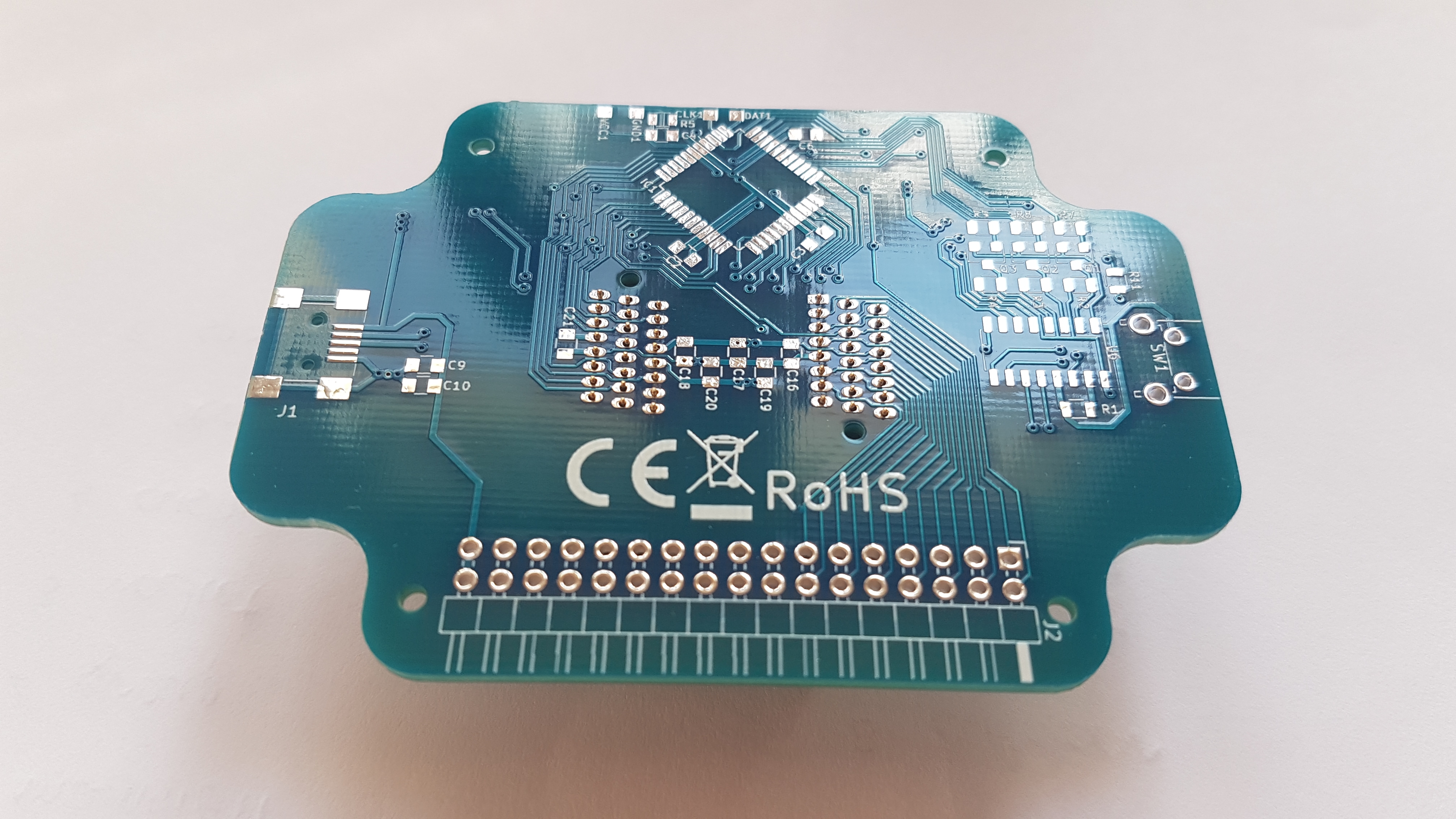

    Version 2.0 is not assembled yet, but I can already put photos of real PCBs.
    I am still waiting for the delivery of 1.8 / 3.0V stabilizers.

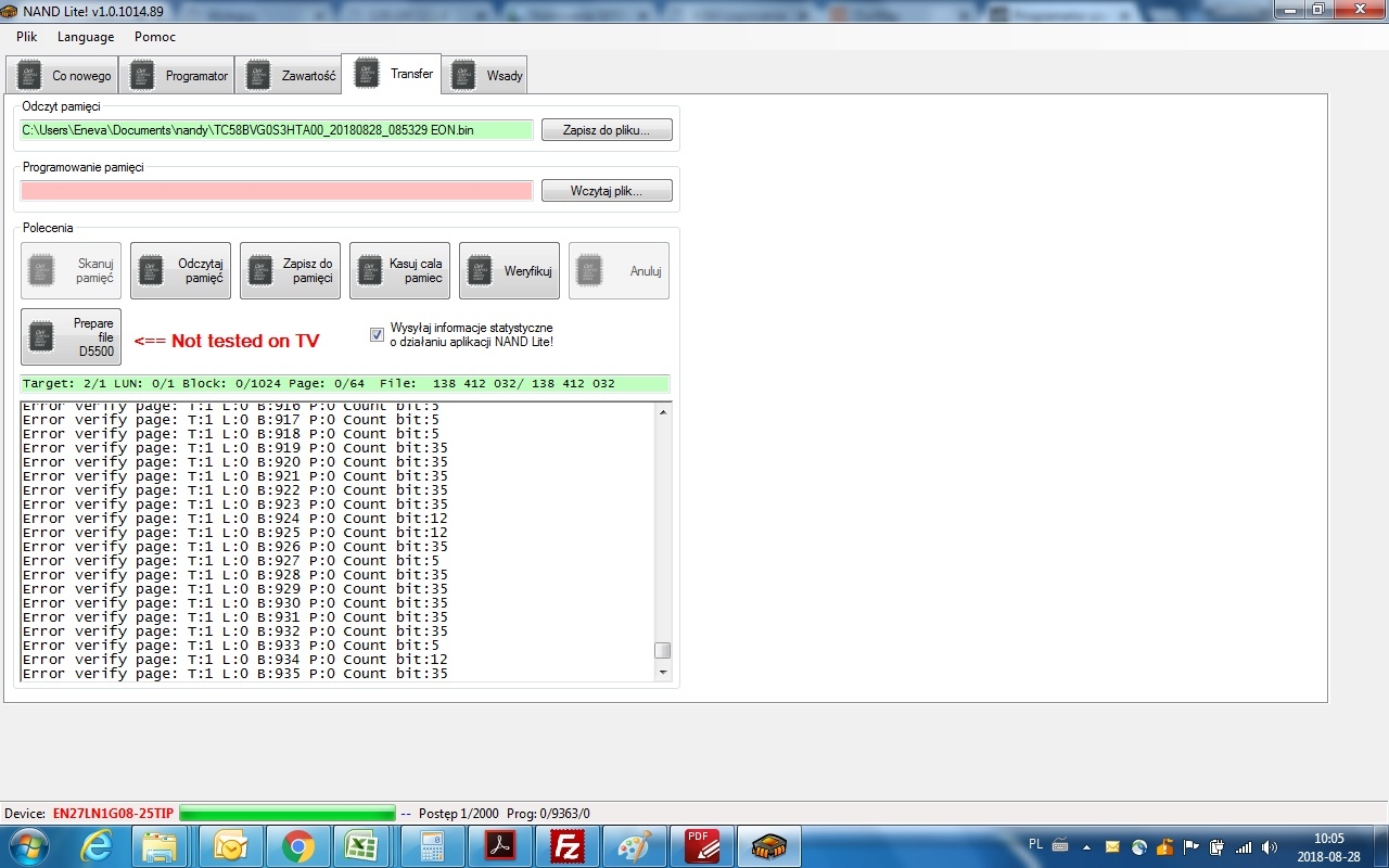

    Hello, I have an urgent need to read and program the TC58BVG0S3HTA00 chip. Unfortunately, the programmer does not have the signature of this system, although this system appears on the list.
    Is it possible to somehow read and program this cube with this programmer?
    Regards

    Yes, the programmer reads it without any problems (98 F1 80 15 F2 16 08 00). I even sent it from the programmer to the server :)
    I'm just sitting and trying to adjust something, but I think there will be a problem with the algorithm and correction.
    Target and LUN gave 1
    I set the LUN size to 1024
    Block size 64
    Page size is 20148 + 8
    I am testing it on clean bone, but with poor results so far
    Here is the link to the memory specification: https://business.toshiba-memory.com/info/docget.jsp?did=14875&prodName=TC58BVG0S3HTA00

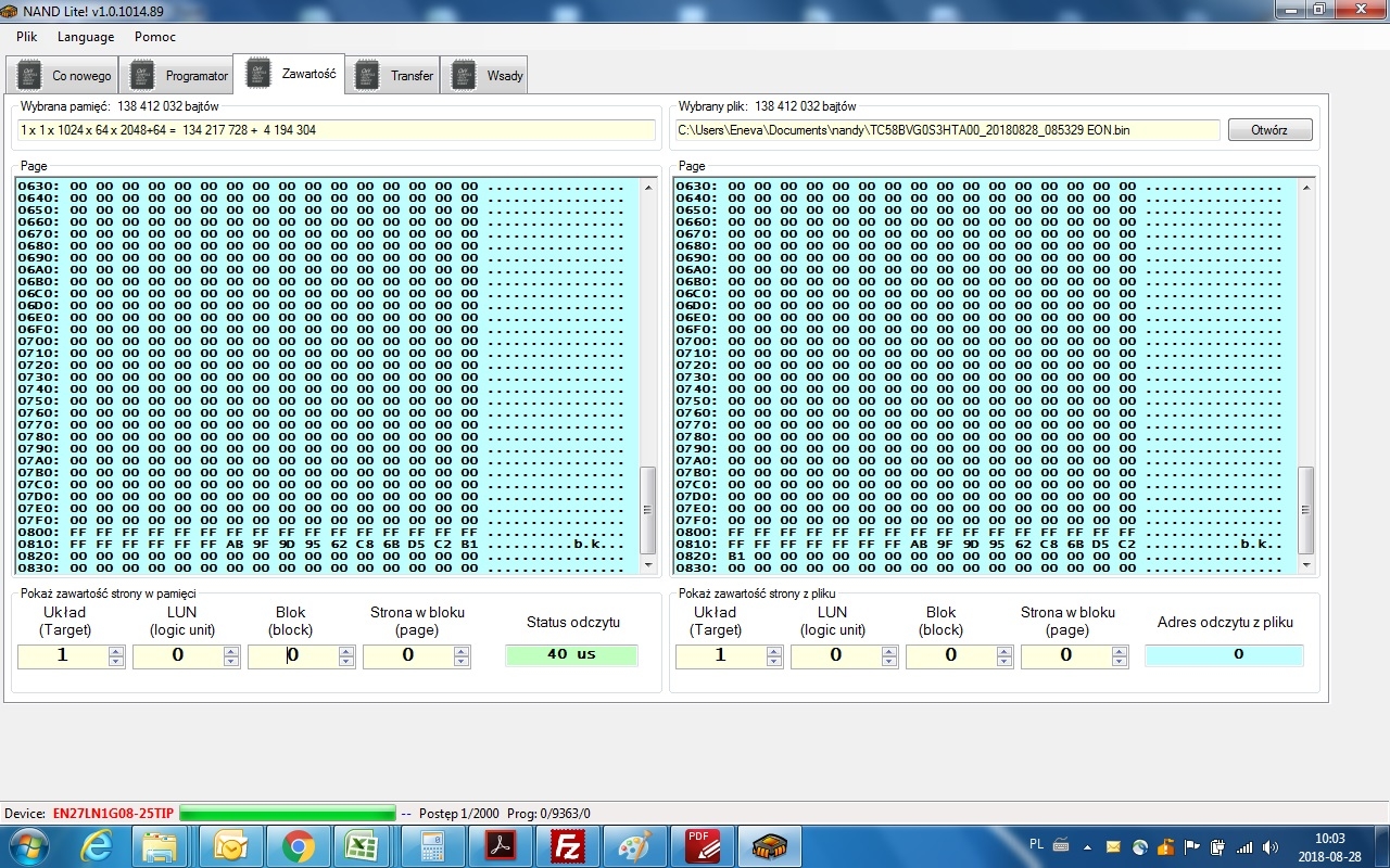

  • #135 17408719
    funak
    Posts: 1082
    Help: 101
    Rate: 461
    Target: 1
    LUN: 1
    LUN Size: 1024
    Block Size: 64
    Page size: 2048 + 64
    So you take the top 2 memory in the list - click - without detecting the chip, and you already have memory access.
    Eg EN27LN1G08-25TIP
    ECC is implemented in memory. You do not have to count it, it will calculate itself, but you have to follow the appropriate instructions. And here the problem may arise.
    As I read the documentation, it shows that the ECCs are stored beyond the address range available to the user. It also shows that it works transparently, so theoretically using the signature of the above memory you should read and write it without any problems. Only the ECC status cannot be read. I would have to implement it additionally.
    Added after 3 [minutes]:
    It's best to choose a layout from the list, go to the content tab and move the indicators at the bottom in the left panel, the page will be loaded immediately.
    For diagnostic purposes, you can increase the PageSize value, e.g. to 2048 + 128.
    Then the first 64 bytes outside MainArea are SpareArea, and the next 64 bytes are ECC. I wonder if he will read it. Post a screenshot of the contents of some memory page.
    Especially the end space.

    funak wrote:
    Target: 1
    LUN: 1
    LUN Size: 1024
    Block Size: 64
    Eg EN27LN1G08-25TIP
    With these settings, it reads something, but during verification, there are a lot of errors. The same when I program a different bone with a ripped batch, it is programmed without errors, while when verifying there are a lot of errors.
    Does the program save any logs that can be inserted here?

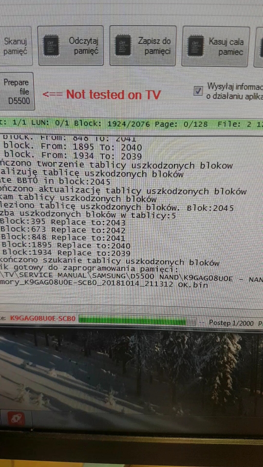

    Rate: 20
    Hello colleagues,
    I do not know if it is important, but I want to share the information that using NandLite v1.0.1014.89 I programmed the Nand K9GAG08UOE-SCB0 for the Samsung D5500 without any problems.
    The TV turned on for about 10 seconds. there was an image and a reboot. I downloaded the file from the Internet, as it was in the description before, erasing the memory, then preparing it - it took a few minutes - and then saving it to the memory. After soldering the Nanda, the TV works without any problems.
    Regards.

How do I prepare a Samsung D5500 dump?
  1. Detect K9GAG08U0E.
  2. Press “Prepare file D5500”; select source dump and output file.
  3. Click “Erase”, then “Write”. The wizard remaps all bad blocks and recreates the BBT automatically [Elektroda, funak, post #16649962]

Where can I buy genuine TSOP48 sockets?
Original Yamaichi TSOP48 cost ≈PLN 180 at Semicon; tested Chinese clones work but lose spring tension after ~100 insertions [Elektroda, tplewa, post #15976786][funak, #15979863].

Failure fact: what causes endless verify loops?
If geometry is unset (page = 0), the app enters an infinite verify loop—select a matching chip definition first [Elektroda, funak, post #18400138]
