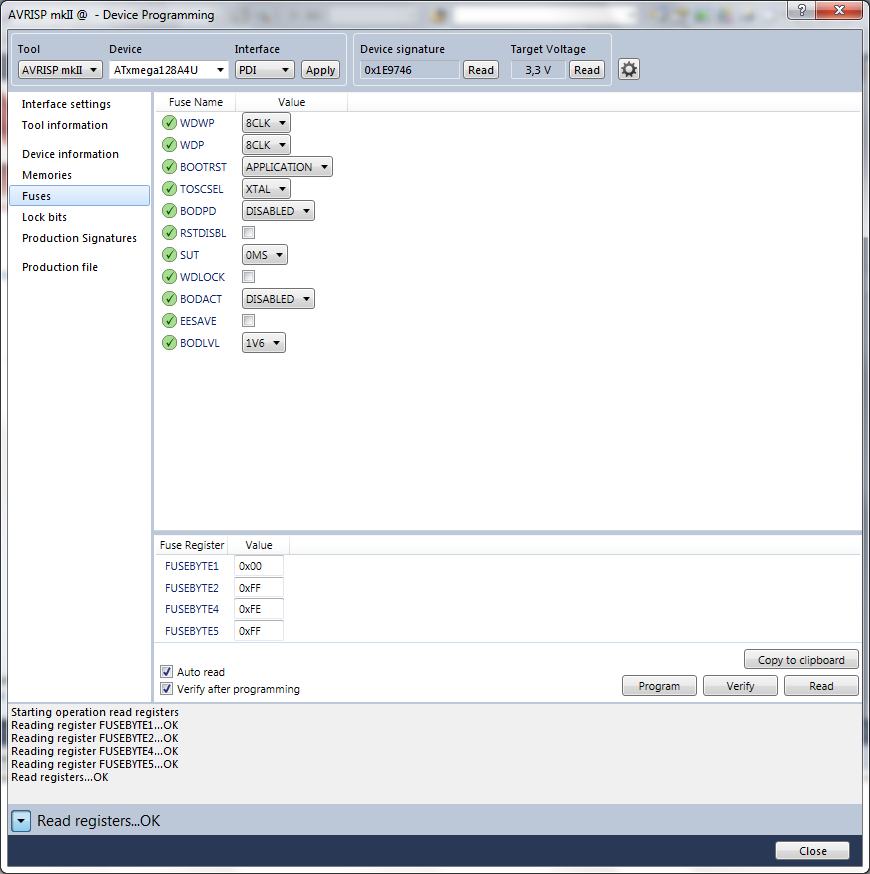

  • #198 17790726
    funak
    Posts: 1082
    Help: 101
    Rate: 461
    EXab wrote:
    funak - Fyuzy how to program?
    BOOTRST - BOOTLOADER
    TOSCSEL - PINS
    BODPD - CONTINOUS
    BODACT - CONTINUOS

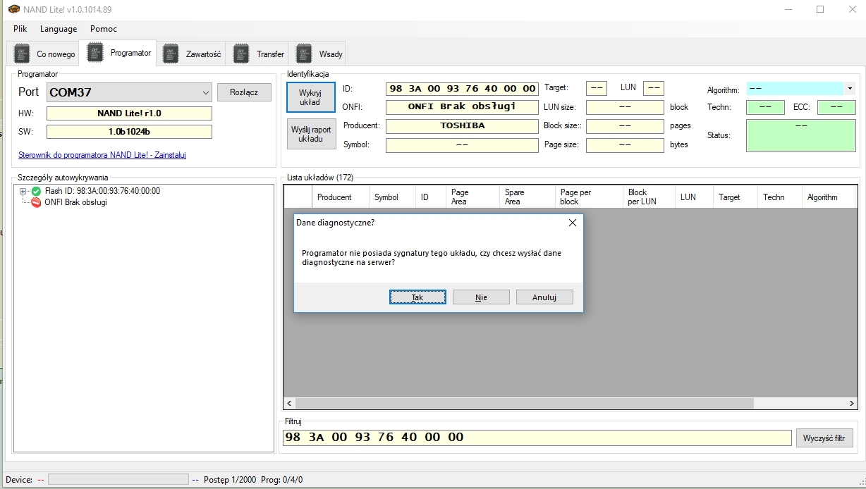

    Hello, after inserting the TC58DVM92A5TA10 chip into the programmer, it does not detect it, but when I manually select the TC58DVM92A5TA00 chip, it is OK and the question here is that the systems differ in the final 10 and 00, does it have any effect on the reading and correct writing?
  • #203 17878408
    funak
    Posts: 1082
    Help: 101
    Rate: 461
    Please let me know what does not detect?
    That is, it gives the identifier 00 00 00 00, is the ID like 98 76 ....?
    If he gives all zeros, there is no need to dwell on memory, there is no contact with it.

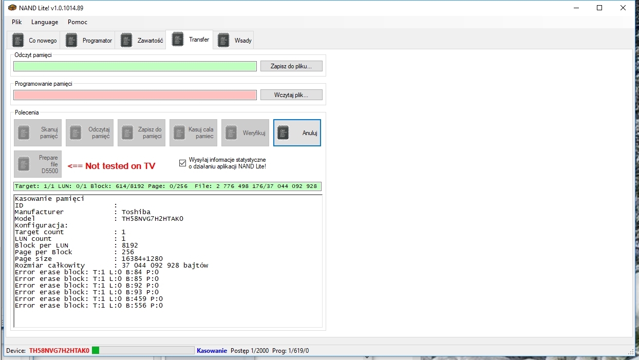

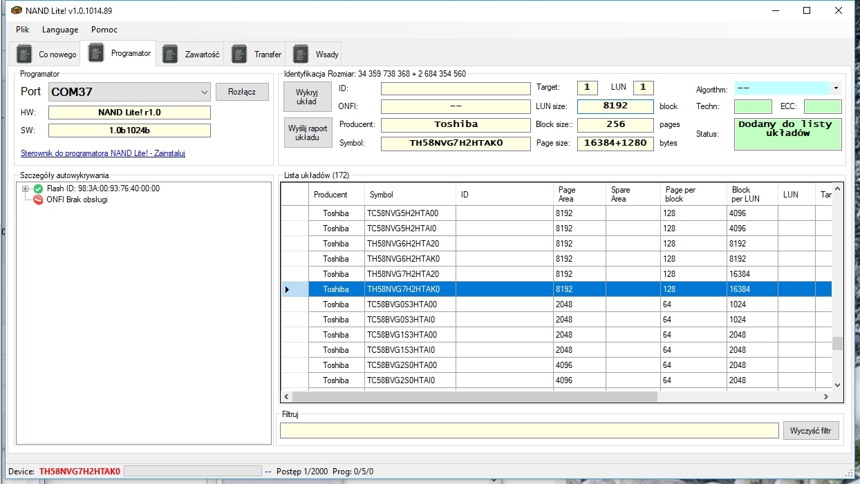

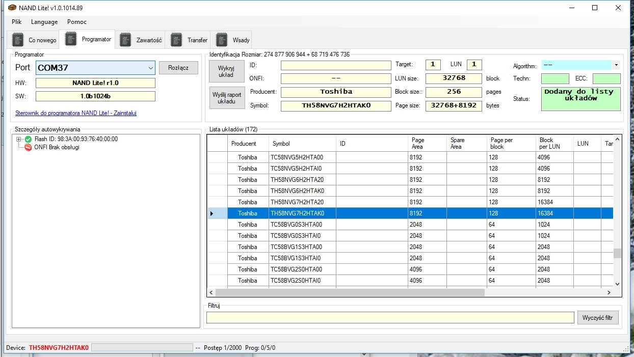

    For example, I can give a memory taken from an SSD with the designation TT58G2ZASA.
    Flash NAND Lite Memory Programmer! TSOP48
    I only know that the memory comes from a 128GB SSD for mSATA.
    There were 4 chips on the disk, so it can be concluded that this memory has a capacity of 32GB or 256Gbit.
    So I enter large values from my hand
    Target: 1
    LUN: 1
    LUNSize: 32768
    BlockSize: 256
    PageSize: 32768 + 8192
    The program calculated a memory capacity of 274GB, but we are going on.
    We go to the Content tab and try to read any page.
    We move the indicators and what do we see?
    And we see that:
    - The memory is empty because they are all FFs
    - memory changes its content around 0x4500, which is 17 664.
    And here we can see what the page size is. Basically MainPage is a power of two, so the page size is: 16384 + 1280.
    I assume that the block size is 256, so we change it to get the 32GB:
    Now the memory should be erased, so let's go:
    Memory erased and here's a surprise:
    From block 4212, there are only errors, so the number of blocks in this memory is 4212.
    Error erase block: T:1 L:0 B:2630 P:0

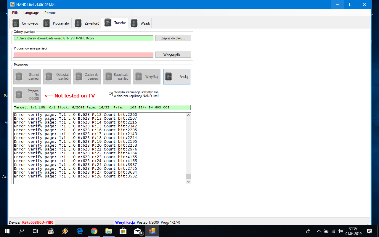

    Error erase block: T:1 L:0 B:2635 P:0
    Error erase block: T:1 L:0 B:3122 P:0
    Error erase block: T:1 L:0 B:4212 P:0
    Error erase block: T:1 L:0 B:4213 P:0
    Error erase block: T:1 L:0 B:4214 P:0
    Error erase block: T:1 L:0 B:4215 P:0
    Error erase block: T:1 L:0 B:4216 P:0
    Error erase block: T:1 L:0 B:4217 P:0
    Error erase block: T:1 L:0 B:4218 P:0

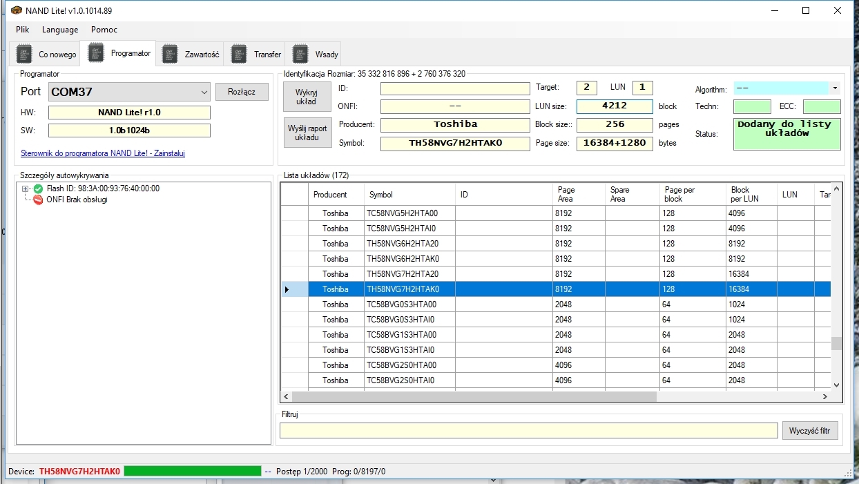

    So we correct:
    LUNSize: 4212
    And the program counts that 17.6GB of memory capacity, so where is the rest?
    It looks like there are two structures in this physical memory that are switched by separate CE inputs.
    Thus, target: 2
    To sum up:
    And so it was easy to communicate with my unknown memory.
    The example may not be universal and there are many possibilities, but it shows how universal the programmer is, where you can experiment yourself :)

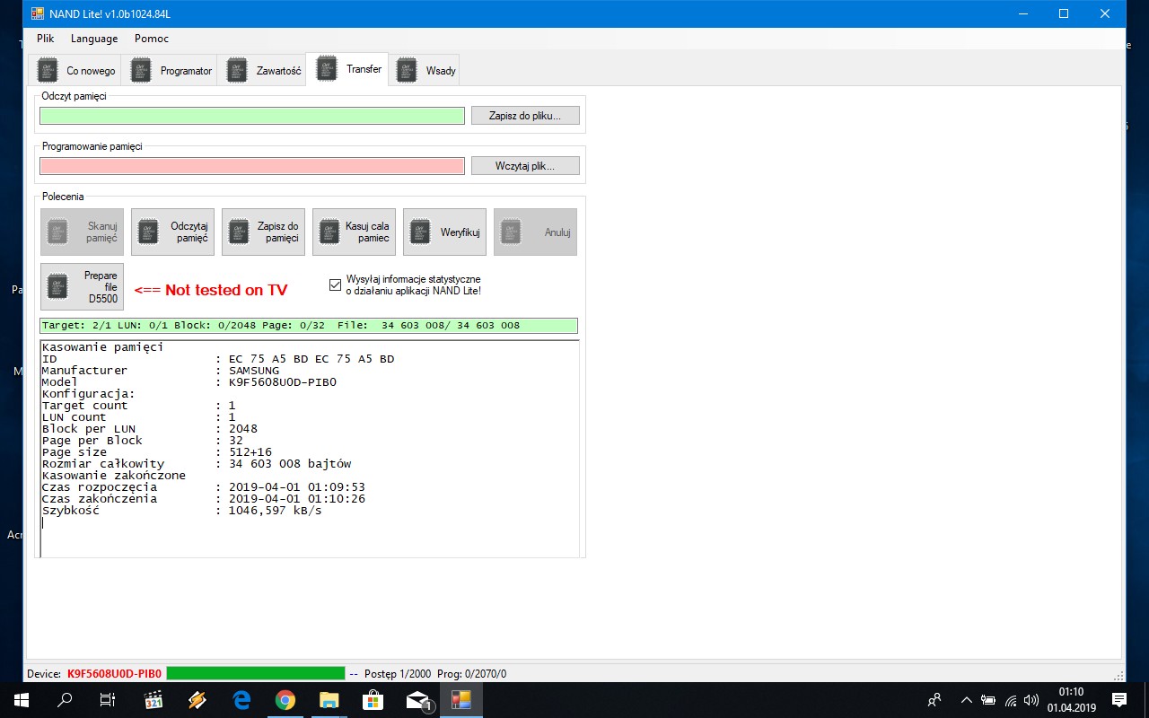

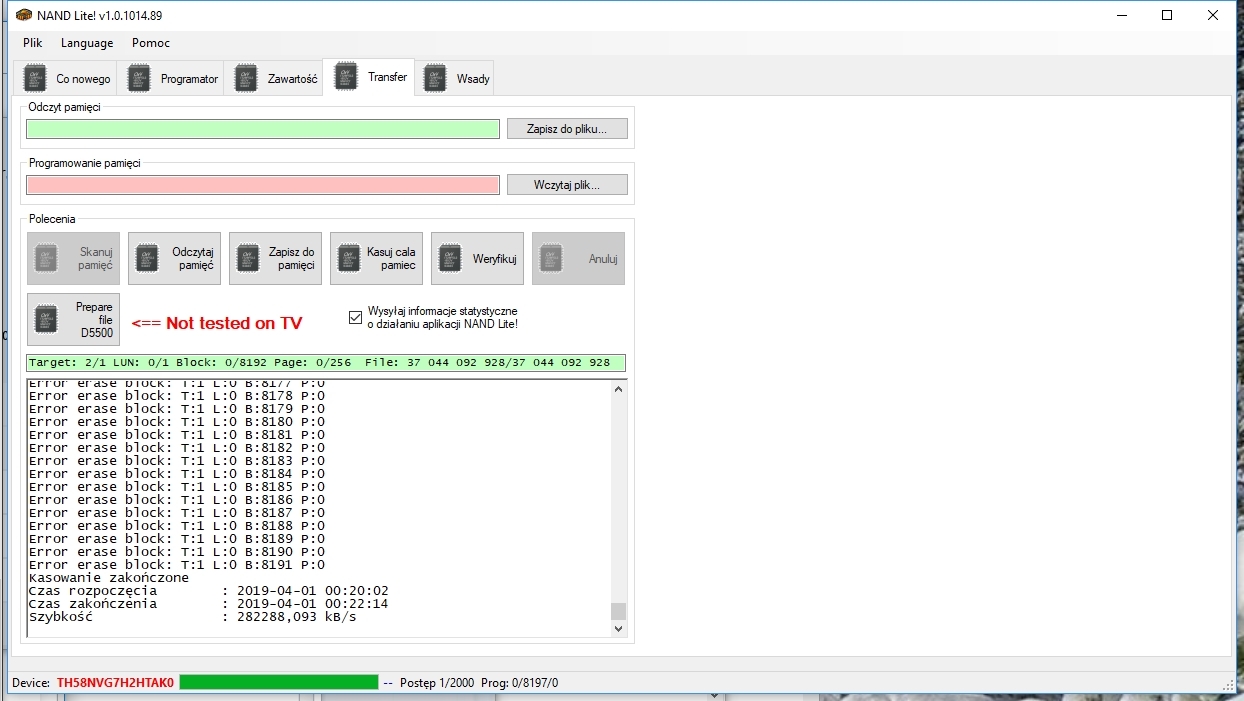

    OK, I understand the new memory chip erasing and here we can see it.
    and the verification of the same memory goes like this Flash NAND Lite Memory Programmer! TSOP48
    The memory verification screen shot was taken 45 minutes after it started working and the progress bar will not budge. What is it - let me add that memory is new and so is the case with each of them.

How do I prepare a Samsung D5500 dump?
  1. Detect K9GAG08U0E.
  2. Press “Prepare file D5500”; select source dump and output file.
  3. Click “Erase”, then “Write”. The wizard remaps all bad blocks and recreates the BBT automatically [Elektroda, funak, post #16649962]
