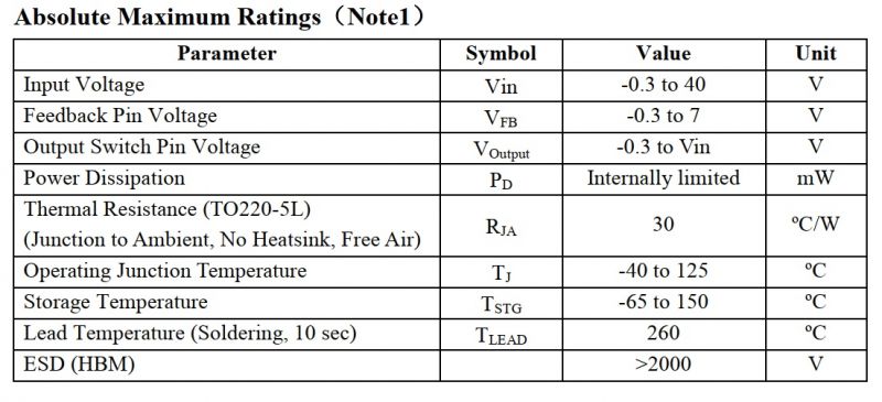

    Justyniunia wrote:
    For me, the max range ended earlier in relation to the potentiometer setting.
    To take full advantage of the regulation range, this converter should be powered from a "rigid" 32-33VDC source. Then there is a full range of adjustments. In the case of an ordinary transformer, it may not work (large voltage fluctuations behind the bridge depending on the load), but the use of a switching power supply, e.g. 24VDC / 10A with an additional potentiometer to set the Uwy (most allow for 22-27V regulation, so it may require modification) and set to 32VDC will allow you to enjoy the full range of adjustments. Initial voltage stabilization is required in order not to exceed the AMR (Absolute Maximum Ratings) of the manufacturer XL4016;
