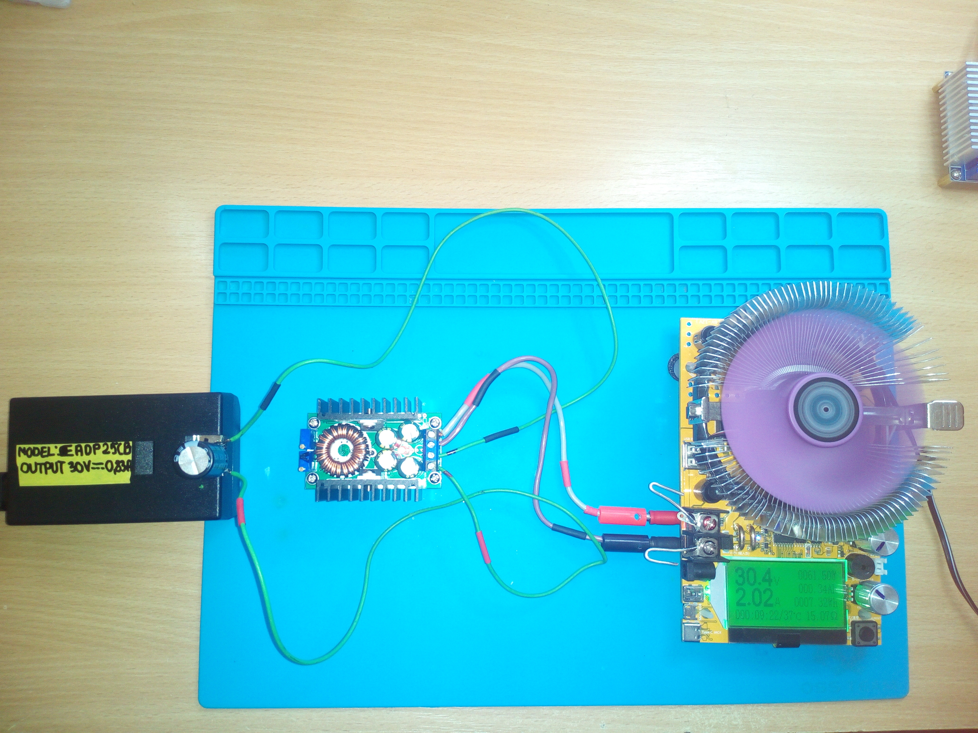

    arturavs wrote:
    Someone tried?
    If he tried, it was probably only once. :cry:
    From such a small (dimensionally) module and small heat sinks there is no chance to get 2x more power.
    It is also problematic to power the converter from a switching power supply. I tried with ATX converted to 24V. Unfortunately, the power supply died at the first attempt to connect a current load around 5 A. But the converter "survived". :D
  • #62 17591899
    sylweksylwina
    Posts: 13214
    Help: 1882
    Rate: 2353
    Someone may have the module damaged by too high current? (I suspect it at least)
    Voltage regulation works, but current regulation does not (current flows even higher than the nominal maximum). What could be damaged?
    I do not mean "turning" this converter module to a higher current, but adding an additional transistor, replacing the choke to get 20A.

  • #66 17593530
    ArturAVS
    Moderator
    Posts: 26359
    Help: 2301
    Rate: 7818
    eurotips wrote:
    Do you need a diode at all? the module was conceived as a charger, so it is enough for someone to take a little trouble and check what happens when he connects the battery without giving voltage to Vin
    I checked on the module received yesterday. I connected the gel 12V / 7Ah. The 30A series fuse has blown.
    An additional diode is not needed, the reverse current will flow through the choke and the diode contained in the module.
  • #67 17593821
  • #68 17593846
    ArturAVS
    Moderator
    Posts: 26359
    Help: 2301
    Rate: 7818
    For testing purposes, I connected according to the diagram from # 1. Nothing happens except that the meter is working. I did not look at the board, but it looks like it can be powered from the measured voltage. Vin was fed from an 18V / 10A power supply, and disconnected during operation.

    I have a question about the ammeter in this set. Does it show the current consumed, i.e. when there is no load, it shows nothing? Is it used to set the current limit and will it show the steady current even without a load?
  • #70 17621449
    kj1
    Electrician specialist
    Posts: 3282
    Help: 278
    Rate: 848
    Yes.
