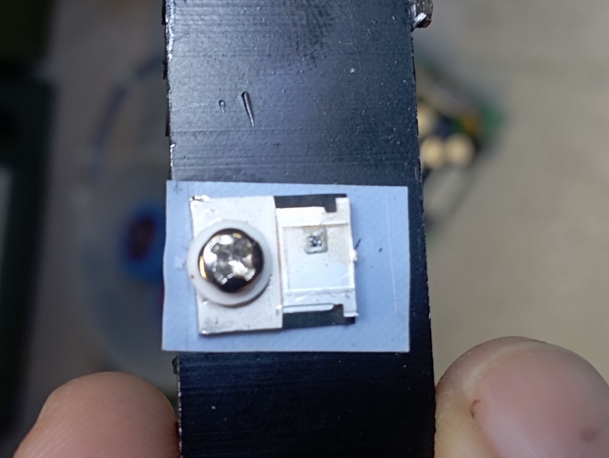

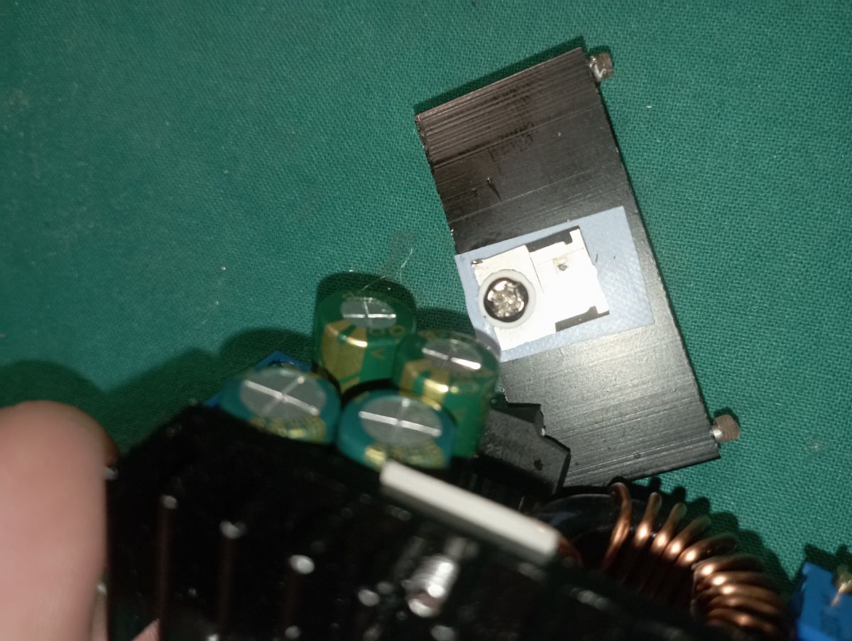

    dukealex
    Close-up of a damaged electronic circuit with a visible transistor and coils.
    hi. i lost too much time whi this circuit. mount a fake xl4016. fast burn the internal mosfet. bat products.lost money. bye
    nb:
    Is the microscopic chip on the transistor visible? it's too small to dissipate 300 watts 8 amps!! ridiculous.

    Echoing the fakes... You can damage other equipment because of them.
