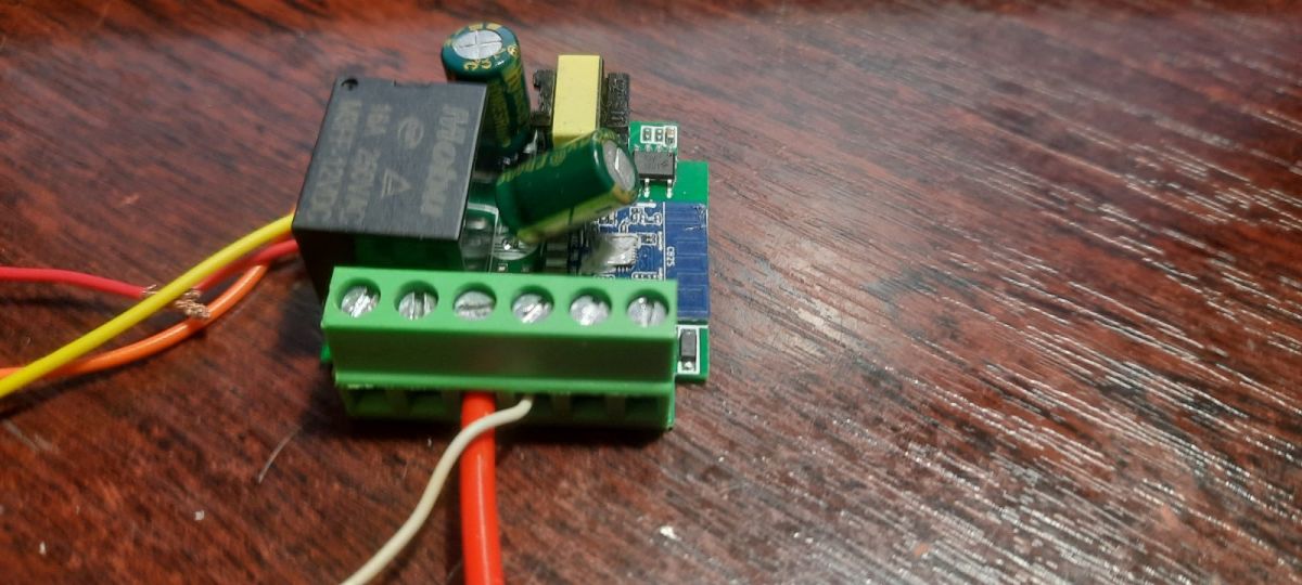

    I've bought two more of these modules
    https://aliexpress.ru/item/1005003596386767.html
    And with FW version OpenBK7231N_QIO_1.12.33 got no problems so far(execpt TCP console - it's still broken, but it doesn't matter alot for me)
    Really great work, thank you very much!

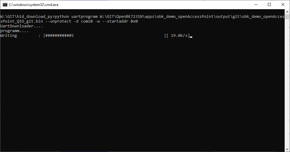

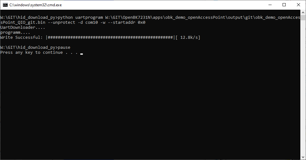

    Something seems very wrong here, but please provide some basic information first.
    Where do you get "Read CRC failed", from the flash utility (hid_download_py), from Beken chip on boot somehow, or from OpenBeken after OBK boot and tries to read my config structure?
    Can you post screenshot, full log?
    I am compiling with that N version SDK often (not using Github online compilation) and it works correctly.
    The only thing you have to be aware of is that you're supposed to flash QIO version at offset 0 on N platform and UA version at default offset at T platform.

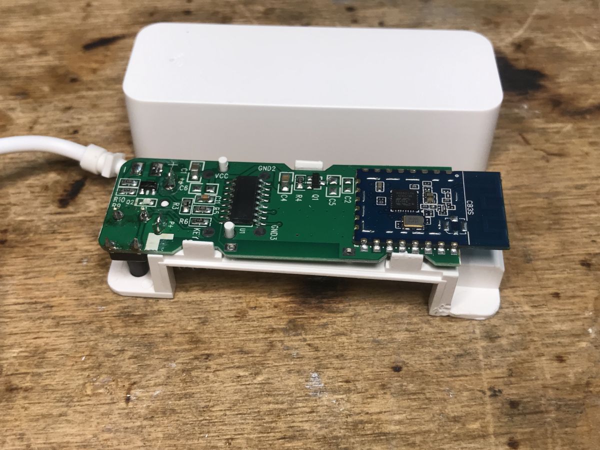

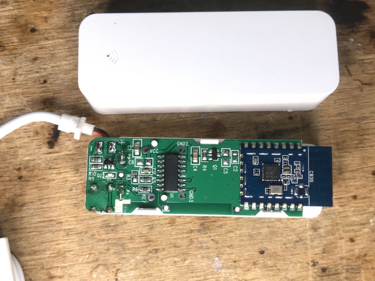

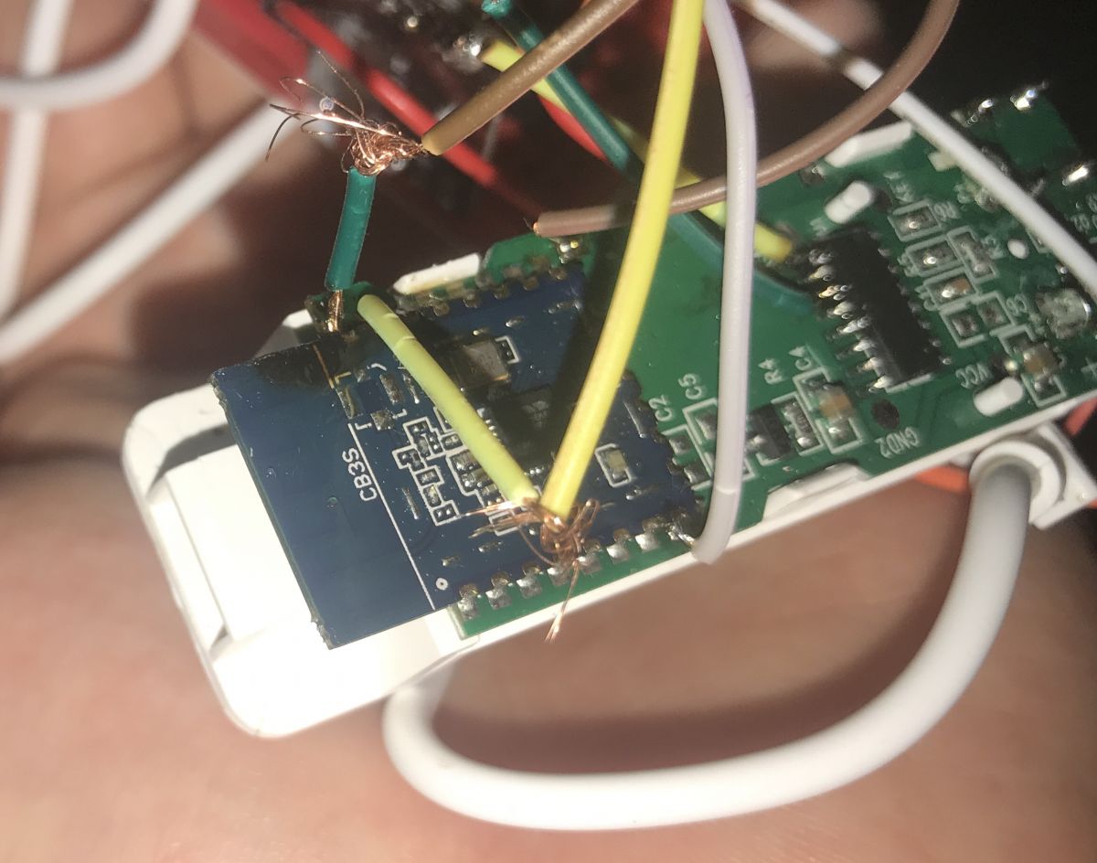

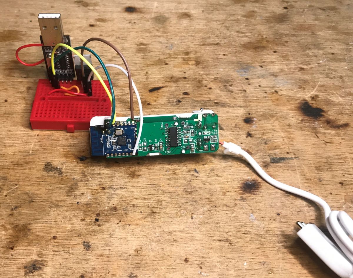

    I have been recently playing with CB3S module and no problems here (about 2 days ago):
    Qiachip Smart Switch - BK7231N / CB2S - interior, programming Qiachip Smart Switch - BK7231N / CB2S - interior, programming Qiachip Smart Switch - BK7231N / CB2S - interior, programming Qiachip Smart Switch - BK7231N / CB2S - interior, programming Qiachip Smart Switch - BK7231N / CB2S - interior, programming Qiachip Smart Switch - BK7231N / CB2S - interior, programming
    It's a TuyaMCU water sensor, MCU enables WiFI module for a minute to send state update to server and then disables WiFi module again.
    python uartprogram W:\GIT\OpenBK7231N\apps\OpenBK7231N_App\output\1.0.0\OpenBK7231N_app_QIO_1.0.0.bin --unprotect -d com10 -w --startaddr 0x0

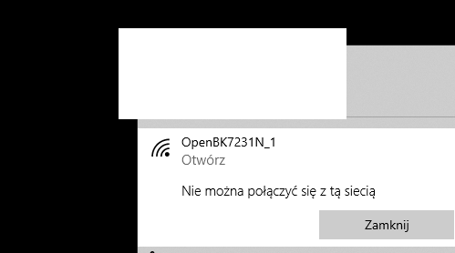

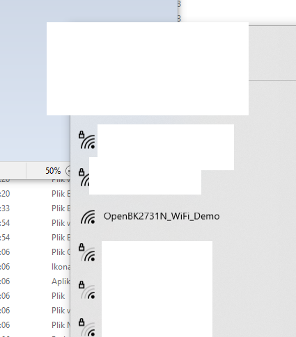

  • AP-only BK7231N demo for CB3S testing
    #109 20148806
    Posts: 14754
    Rate: 12875

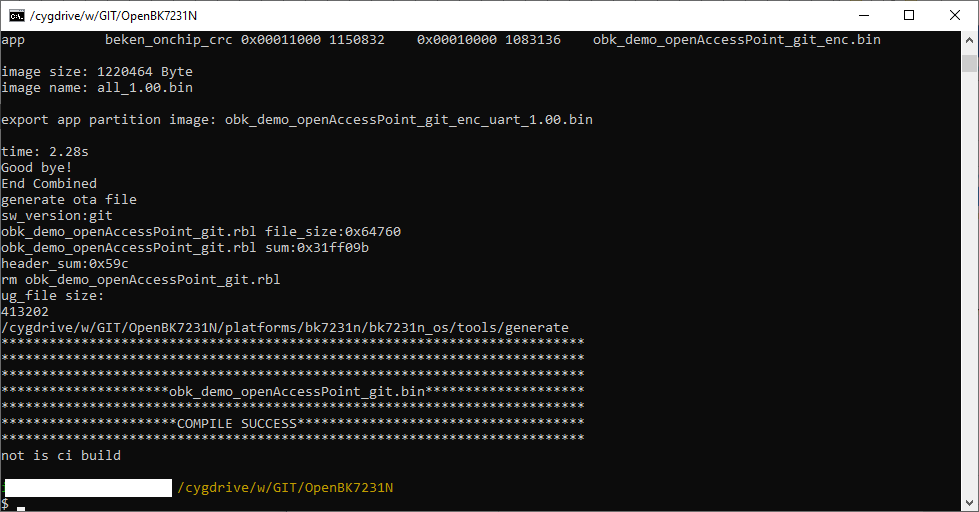

    Ok let's try different approach.
    I created a AP only demo for you (simple BK7231N program, no OBK):
    https://github.com/openshwprojects/OpenBK7231...mmit/15bd888de014ca403e99eda5d5b70104f8a39a82
    compiled it:
    Flashed it to CB3S:
    and it creates AP:
    Please flash this demo app to your device and tell me if a AP shows up.
    • obk_demo_openAccessPoint_QIO_git_Nversion.zip (675.29 KB) You must be logged in to download this attachment.
  • AP-only BK7231N demo flashed to test access point creation

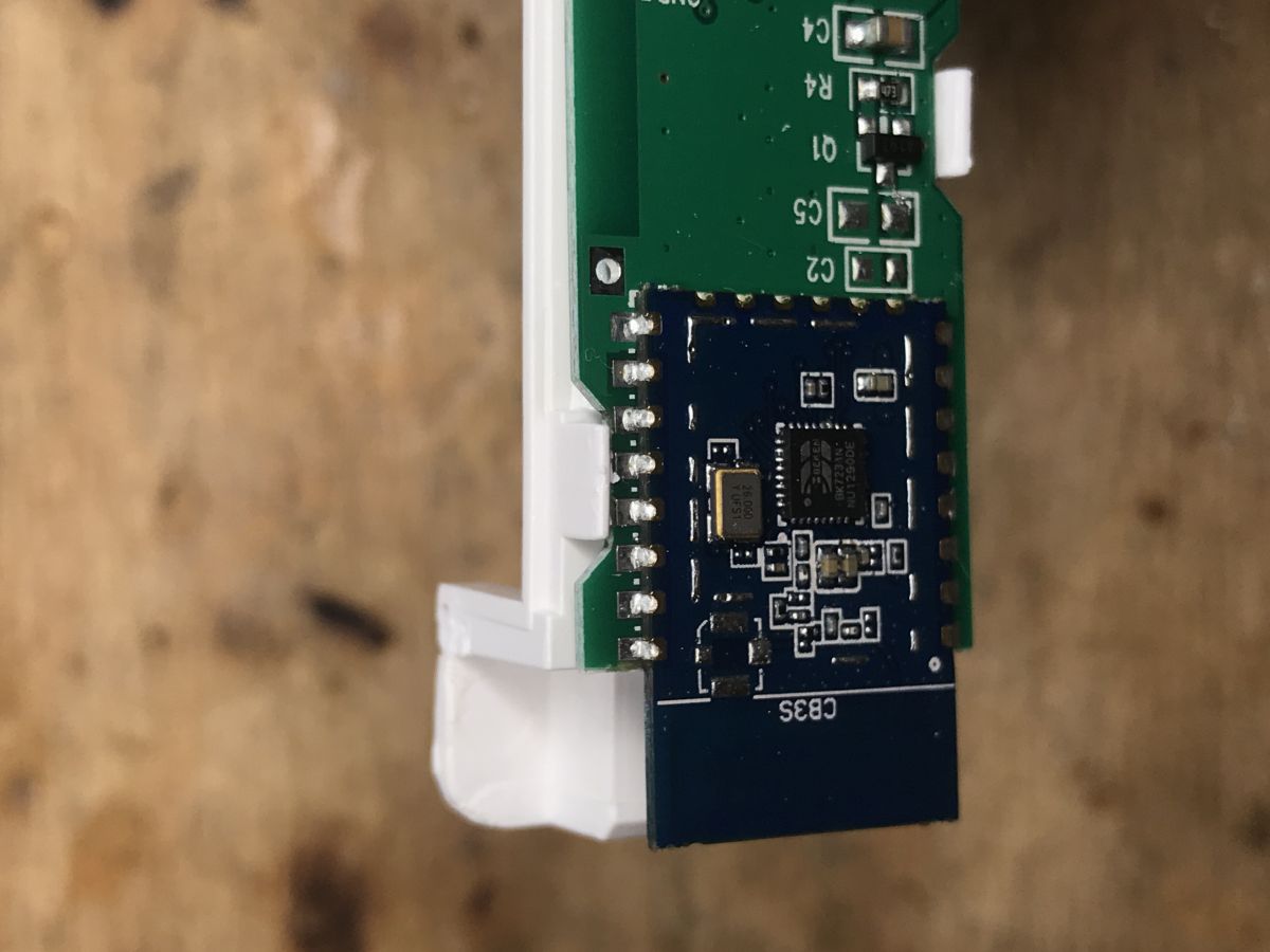

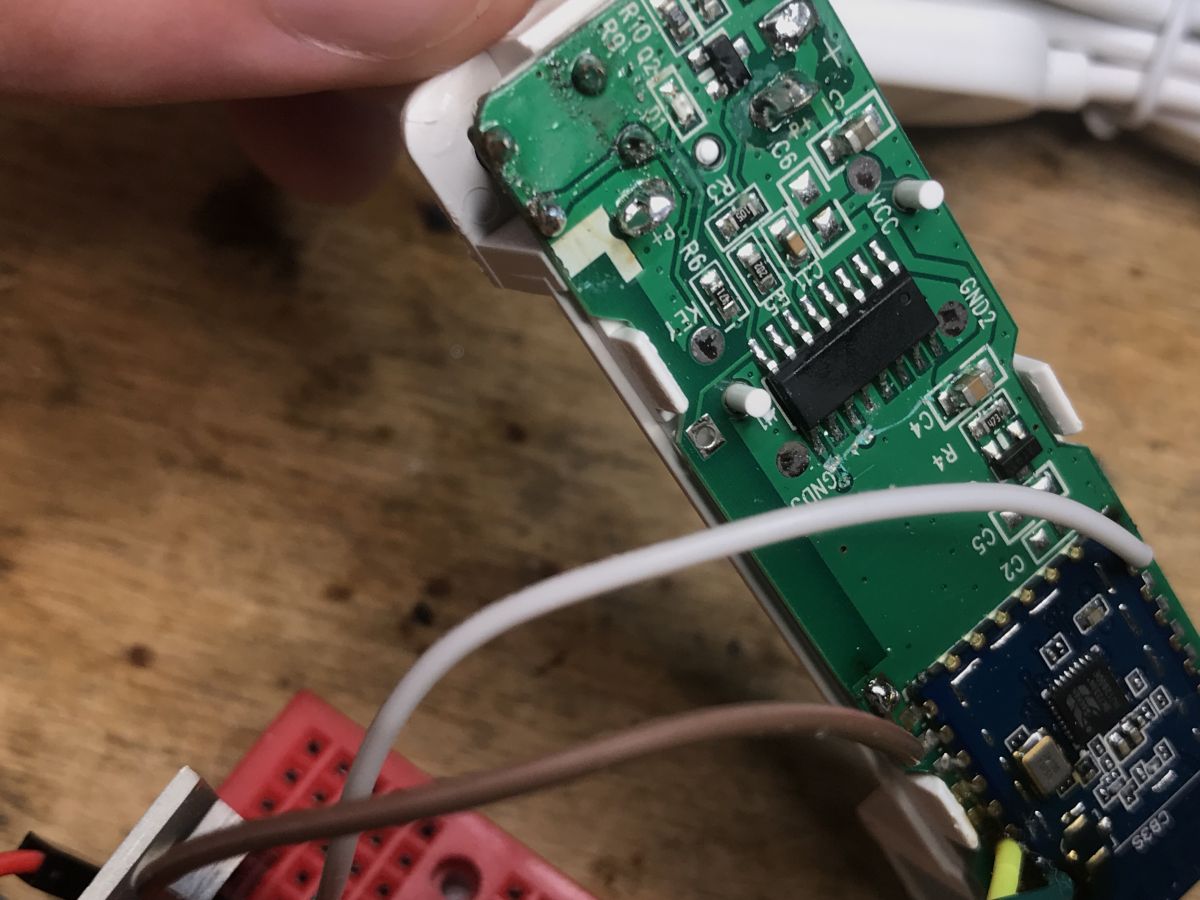

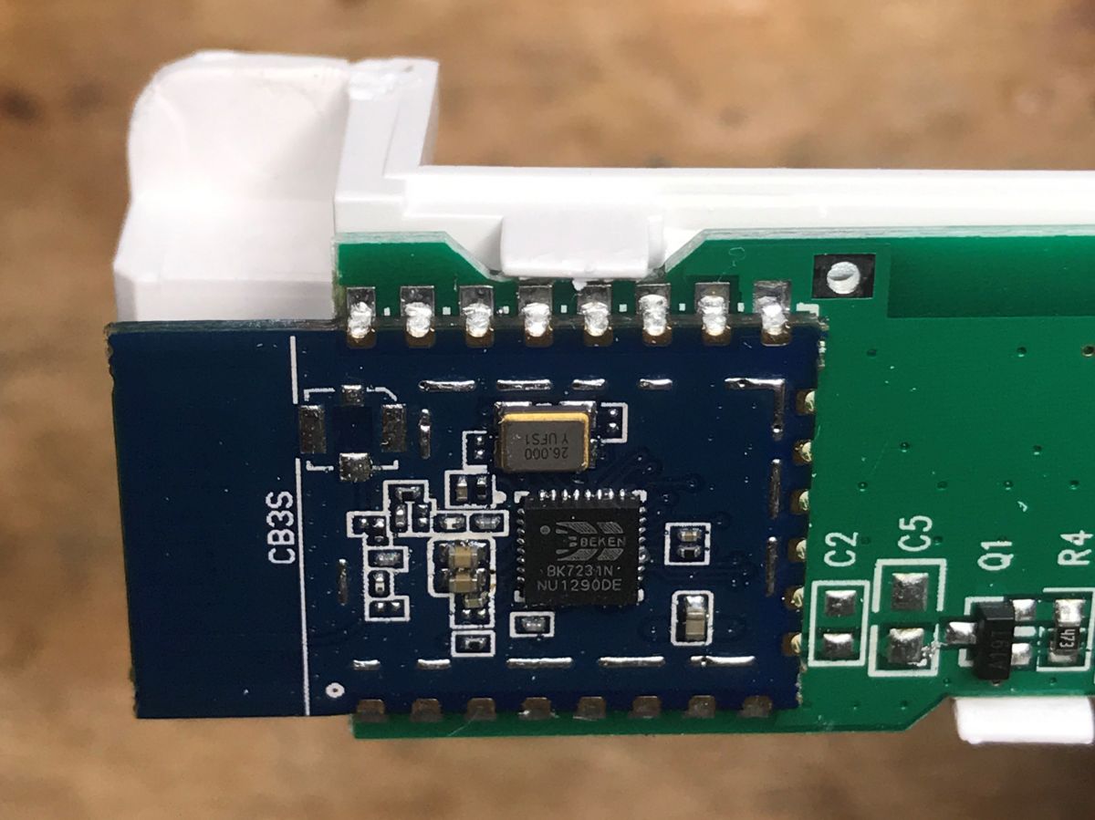

    compiled it:
    Flashed it to CB3S:
    and it creates AP:
    Is it necessary to flash full-sized (2 MB) firmware with FF at the end or just overwite original flash memory with demo app (1 MB)?
  • QIO firmware flashes cleanly at 0x0
    #111 20148835
    Posts: 14754
    Rate: 12875
    i always flash only the QIO generated by build and never had any problems.... I am suprised by @00svd00 experience, that's a new thing to me.
    python uartprogram W:\GIT\OpenBK7231N\apps\obk_demo_openAccessPoint\output\git\obk_demo_openAccessPoint_QIO_git.bin --unprotect -d com10 -w --startaddr 0x0
    pause
    You are the first ones to report such issues.
    EDIT: it's almost as like you're both doing something wrong, I don't know, but still, maybe something changed in the firmware or I made some kind of bug that I am not aware of yet... still, very strange. Other users also tested N version and there were no such issues with 0xFF and flashing
    EDIT2: Maybe at one point you
    a) flashed UA at wrong offset (zero) and overwrote bootloader?
    b) flashed QIO at wrong offset (non-zero?) (but it should be recoverable)
    well, no idea
  • QIO flash boots AP but no web UI
    #112 20148839
    SFMax
    Posts: 26
    pause
    well, no idea
    I backup my original firmware first and then flash obk_demo_openAccessPoint_QIO_git.bin. OpenBK2731N_WiFi_Demo is appeared and I can connect to it but nothing is available by ip 192.168.4.1.
  • #113 20148845
    Posts: 14754
    Rate: 12875
    This is good news.
    it is OK, as said, it's only AP demo... it's not OpenBeken.... it's just to test if your device boots.
    Ok, now, can you send me your firmware backup so I will flash to my CB3S and see if it boots?

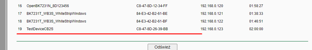

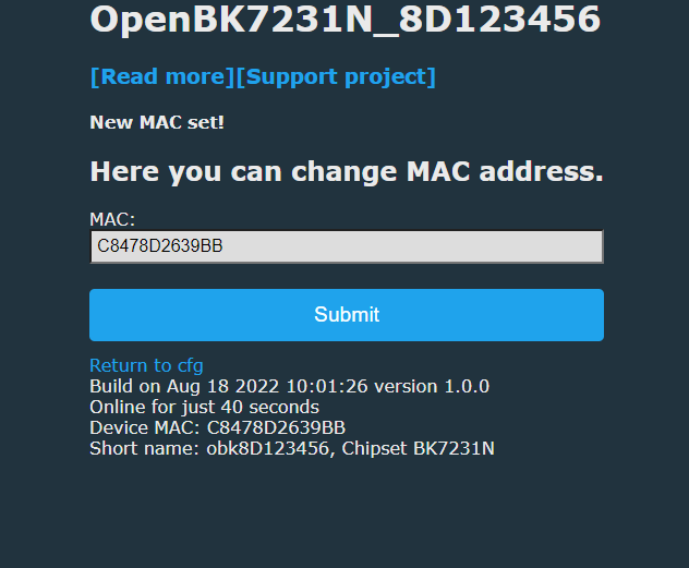

    I have tested your flash and it seems there is a certain MAC address issue which later causes the the AP to be non-connectable for my router. My router fails to connect to AP that has 00 00 etc mac.
    It seemed like MAC flash sector was broken, but I don't know if it was wrong in the first place or did it break during the 0xFF overwrite made by @00svd00 if I remember correctly.
    I changed MAC code handling and moved whole MAC storage to our CFG struct on N platform. So broken flash won't cause wrong MAC any more.
    It works for me now:
    Device connects to wifi, reconnects, etc.
