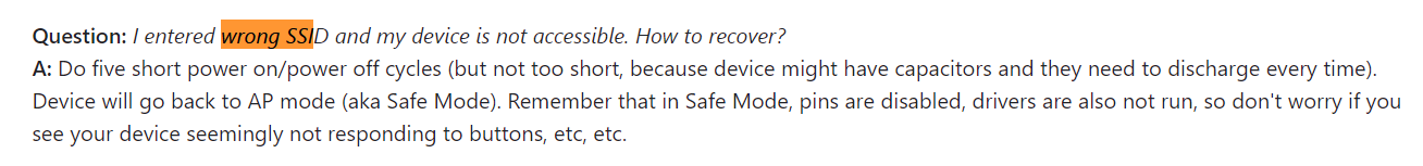

    Of course, but Tasmota 40 second hold is problematic because if you configure button incorrectly, it will always reset itself. We have another mechanism. As per our faq:
    FAQ excerpt about entering a wrong SSID with instructions to recover device access via five short power cycles.
    Read more on: https://github.com/openshwprojects/OpenBK7231T_App/blob/main/docs/faq.md
  • #46 20707788

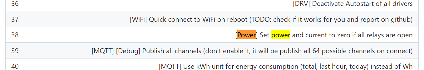

  • Enable flag 38 to zero current when relay opens
    #49 20868215
    Posts: 14767
    Rate: 12909
    Having non-zero current measurement was reported in the past and it seemingly also happens on Tasmota. Tasmota solves it with force-setting current to zero when relay is open, and we have the same option:
    Screenshot of a table with flags to set in the OpenBK7231T application. Flag 38 concerns setting power and current to zero when all relays are open.
    You can go to flags and enable flag 38.
    See more our docs here:
    https://github.com/openshwprojects/OpenBK7231T_App/blob/main/docs/flags.md
    What do you mean by "light a bit", are you talking about the LED on the device, or about the connected appliance?
