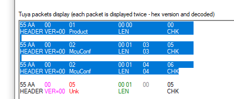

    My current plan is to write a simple "battery powered device simulator" for Windows OpenBeken simulator and then implement the battery powered devices protocol correctly. I will start working on that in a few days, I hope.

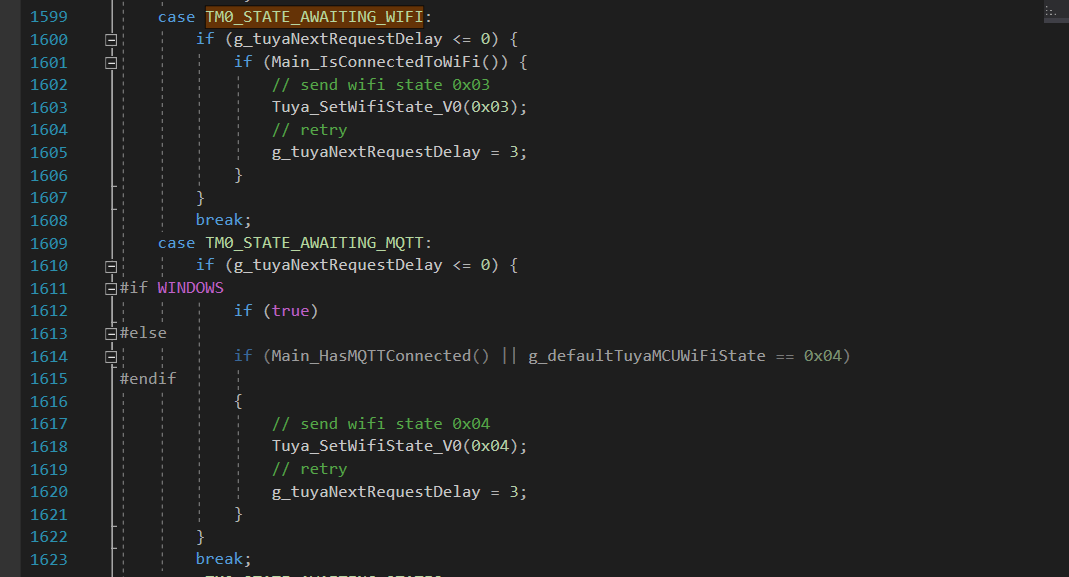

    Just a doubt that bothers me:
    When you send a notification to TuyaMCU that the WiFi module is connected (55 AA 00 02 00 01 04 06), do you verify if it is really connected? Or is it just a simulated communication?
  • TuyaMCU heartbeat received with flag 37 enabled

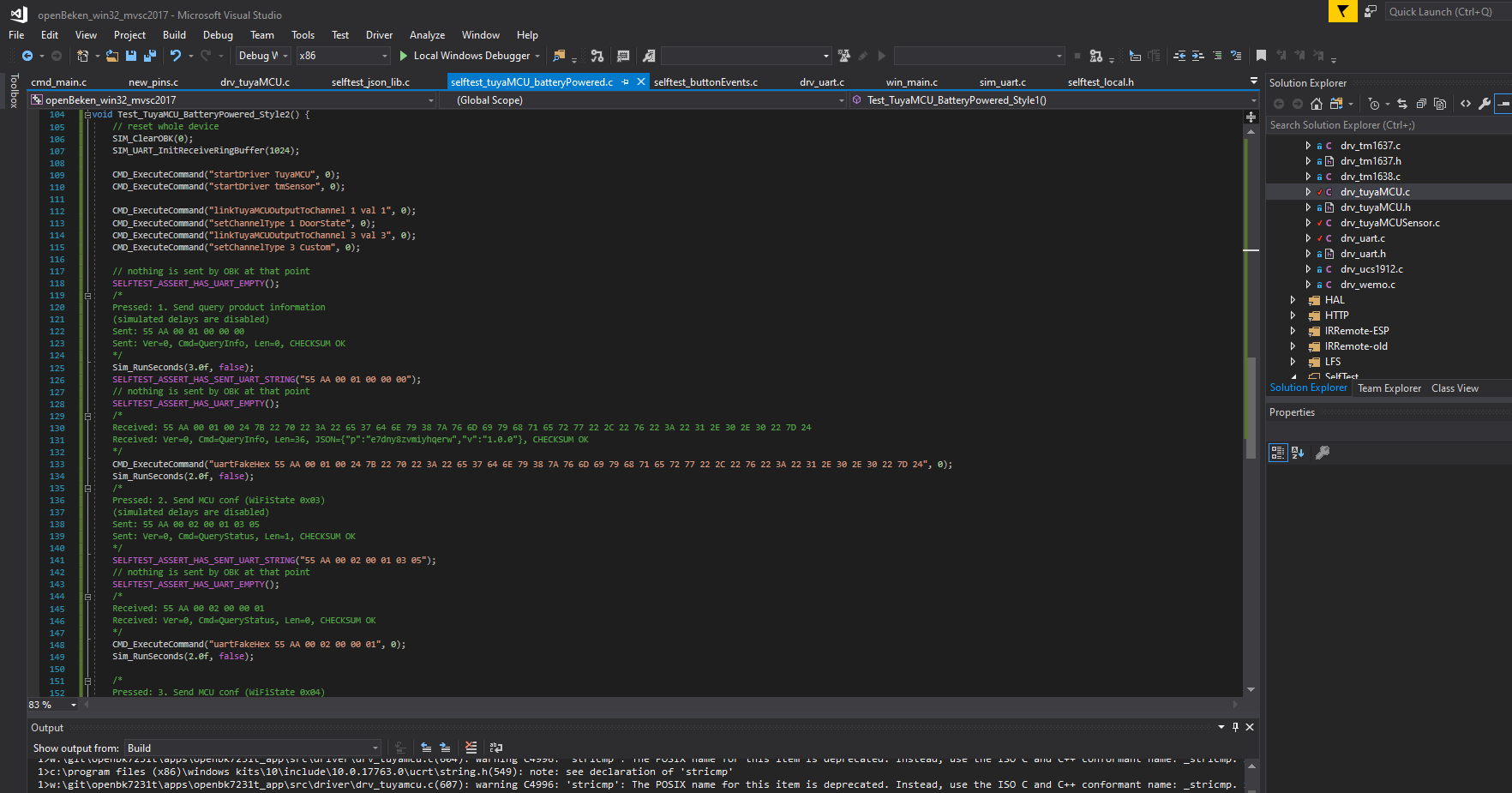

    I have also entered the gathered data to the SelfTest system so OBK now basically tests itself on Windows simulator start:

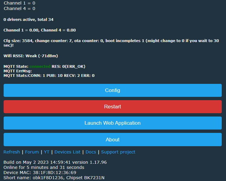

    How it works for you? What is your autoexec.bat? Why do you have no drivers running?

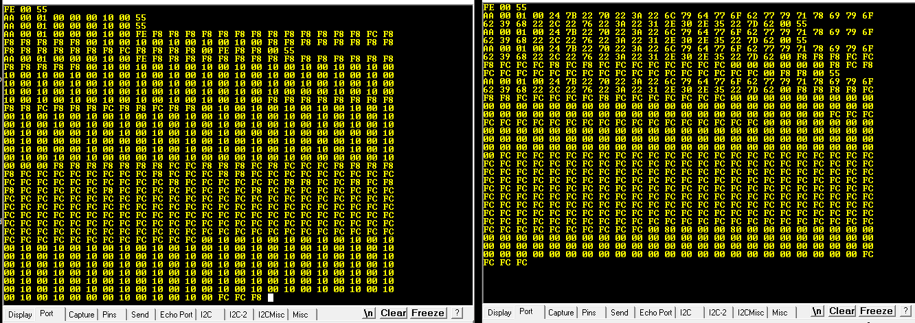

    A simultaneous Log Tx/Rx with RealTerm between chips doesn't work for you?
    Added after 52 [seconds]:
    Motion sensor with BK7231N and TuyaMCU battery powered devices protocol

    I am afraid that you are misunderstanding me. I am not talking about OpenBeken AP mode. I am saying that, with Tuya devices with TuyaMCU, if you press button for a long time several times, they will not shut down WiFi module. WiFi module will stay powered for over a minute or so. At least in case of my door sensors.
    I follow the instructions in the manual to enter AP mode. Long press until the leds turn off and repeat the sequence again. I don't know if there is another way to do it but it has worked well for me so far.
    capture...txt (1.47 kB)You must be logged in to download this attachment. capture...txt (1.7 kB)You must be logged in to download this attachment.
  • AP mode likely triggered by five power cycles

    The log you have attached contains two perfectly valid TuyaMCU transactions. There seems to be nothing wrong with it.
    The only strange part is here:
    Let me quote this:
    55 AA	00	02		00 01	03	05
    HEADER	VER=00	McuConf		LEN	03	CHK
    HEADER	VER=00	McuConf		LEN	04	CHK
    first MCUconf is with WiFi state 0x03 (WiFi connected) and second is with 0x04 (MQTT connected).
    Let's look at the code:
    It is not possible to get 0x04 WiFi state packet (MQTT connected) unless you have MQTT connection (or are on windows, or force default state) !!
    You must have MQTT connection working.
    @spin55, can you check/confirm, do you get MQTT connection working?
    The following log may mean that only HTTP is not working for you.
    @spin55, does device show up in DHCP?
    @spin55 , get device IP and run:
    ping 192.168.0.111 -t
    (change IP to yours), does it respond?
    The only problem possibility is that you have somehow WWW panel broken, but that would be very strange. Maybe try to Restore RF partition in BK flasher on in our Web App?
  • Need TX2 log to diagnose AP mode issue
    1683048619: New connection from 192.168.1.57 on port 1883.
    1683048619: New client connected from 192.168.1.57 as obk1F8D1236 (p2, c1, k100, u'homeassistant').
    1683048641: New connection from 192.168.1.57 on port 1883.
    1683048641: Client obk1F8D1236 already connected, closing old connection.
    1683048641: New client connected from 192.168.1.57 as obk1F8D1236 (p2, c1, k100, u'homeassistant').
    1683048799: Client obk1F8D1236 has exceeded timeout, disconnecting.
    1683048874: New connection from 192.168.1.57 on port 1883.
    [INFO] found homeassistant on local database
    1683048875: New client connected from 192.168.1.57 as obk1F8D1236 (p2, c1, k100, u'homeassistant').
    1683048920: New connection from 192.168.1.57 on port 1883.
    1683048920: Client obk1F8D1236 already connected, closing old connection.
    1683048920: New client connected from 192.168.1.57 as obk1F8D1236 (p2, c1, k100, u'homeassistant').
    1683049076: Client obk1F8D1236 has exceeded timeout, disconnecting.
    1683049172: Saving in-memory database to /data/mosquitto.db.
