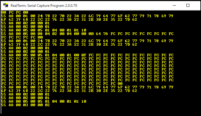

    Realterm and MQTT traces for Tuya battery protocol
    #182 20645222
    spin55
    Posts: 209
    Help: 17
    Rate: 42

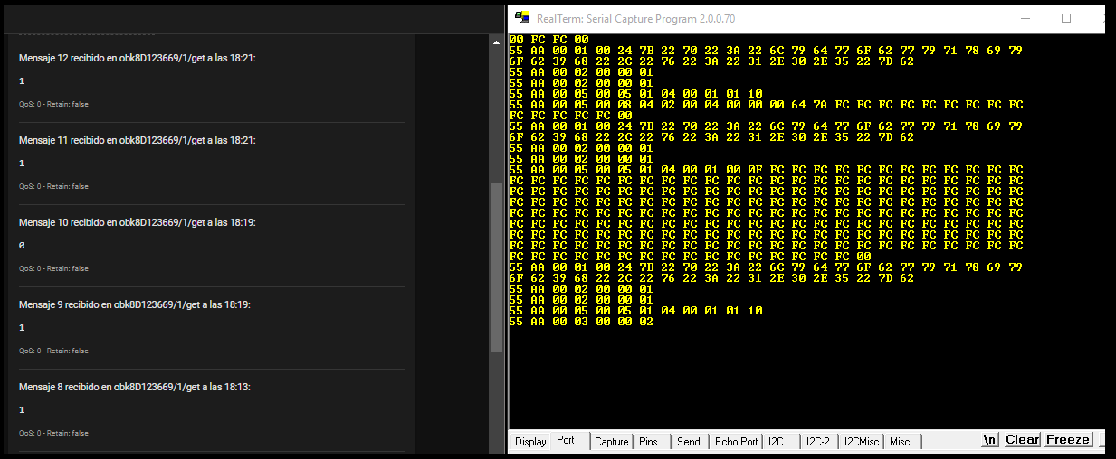

    In case you want to play with the device, I leave you these notes that, although they are already discussed throughout the thread, can help to focus the issue.
    If you configure the Realterm Display tab as I indicated above, you will see your Rx information like this:
    Motion sensor with BK7231N and TuyaMCU battery powered devices protocol
    There you can see a complete cycle from when the power is connected until it enters pairing mode by long pressing the button.
    And you can see the changes if you monitor channel 1 on MQTT in Home Assistant (HA):
    To know the Tuya protocol for battery powered devices:
    https://developer.tuya.com/en/docs/iot/tuyacl...niversalserialaccessprotocol?id=K95afs9h4tjjh
    And to make it easier for you to interpret those commands:
    https://www.elektroda.com/rtvforum/topic3970199.html
    Greetings

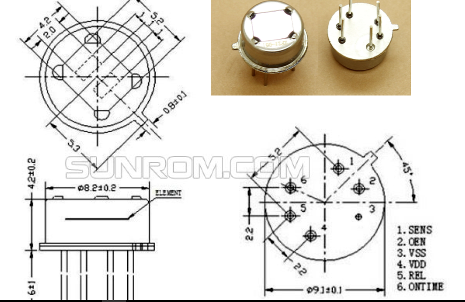

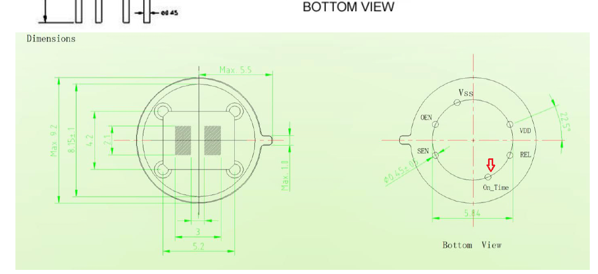

  • 5v-powered PIR test with CBU pinout changes
    #185 20646690
    spin55
    Posts: 209
    Help: 17
    Rate: 42
    dmarcondescctv wrote:
    Happy to hear your or someone else's suggestion for a PIR.
    https://www.elektroda.com/rtvforum/topic3975583.html#gallery-35
    https://es.aliexpress.com/item/10050047382480..._id=202307080643418529150435676320008874913_4

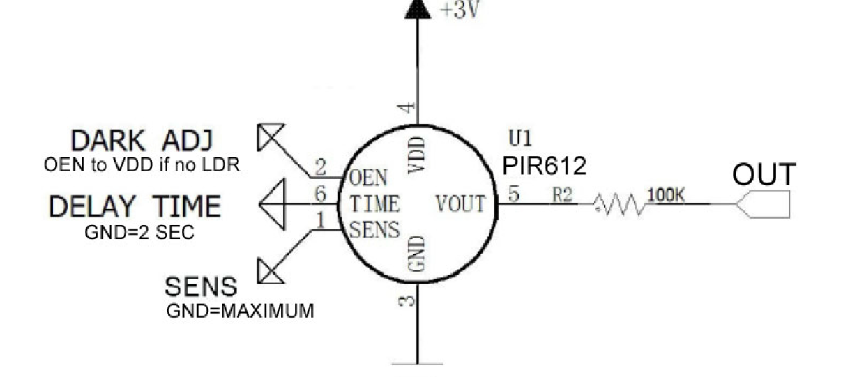

    I have carried out a test with this PIR that is powered by 3xAAA batteries and has a CBU module. I have removed the batteries and have fed it with 5V. I have removed autoexec.bat and changed the pinout:
    You can leave only "16" and "26", the rest is left over since it will be permanently powered.
    After intrusion detection it takes about 35 seconds to reset the sensor compared to 1:20 minutes for the NEO, but it can be reduced to 2 seconds with a small modification (although I haven't tested it). Once reset, detection is fast because it is always online. Something similar happens with door sensors.
    I have experimented with this model because it is what I have at hand, but anyone that does not have a TuyaMCU chip and is powered by microUSB at 5V will work.
    This is in terms of a cheap Wi-Fi solution, but the ideal is to use battery-powered Zigbee devices because the consumption is much lower, it is faster and they have other obvious advantages, but that is another topic.
    Grettings

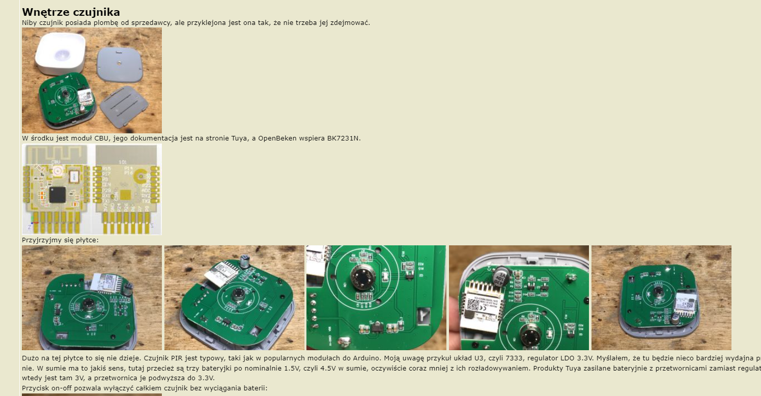

  • #186 20646772
    Posts: 14811
    Rate: 12977
    @spin55 my guide for that one (non-TuyaMCU version) is almost ready:
    I will post it soon, first in Polish, then English:

    I have posted some information about that sensor, currently in polish:
    https://www.elektroda.pl/rtvforum/topic3988602.html
    Maybe we will setup English translation soon

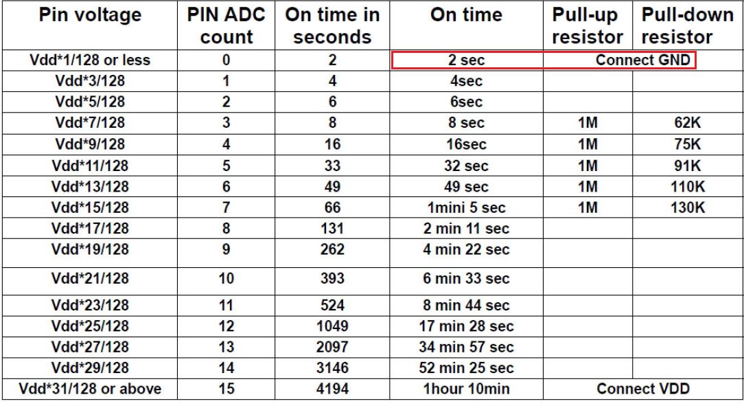

    By default the PIR takes 33 seconds to reset, but this time can easily be cut to 2 seconds by grounding pin 6.

    Info:TuyaMCU:Received: 55 AA 00 02 00 00 01
    Info:TuyaMCU:ProcessIncoming[v=0]: cmd 2 (MCUconf) len 7
    Info:TuyaMCU:ProcessIncoming: TUYA_CMD_MCU_CONF, TODO!
    Info:TuyaMCU:Received: 55 AA 00 05 00 05 01 04 00 01 00 0F

  • #194 20982385
    p4nd0ra
    That is a very good question. I have 3 of those and all exhibit the same issue.
    When pressing the reset button it connects back to the network and I can access it for some time.
    AP mode can be triggered as well.
    What is this message by the way?
The discussion revolves around configuring a motion sensor device powered by the BK7231N chip and utilizing the TuyaMCU protocol. Users share experiences and troubleshooting steps related to flashing the device, setting up the autoexec.bat file, and ensuring proper communication between the TuyaMCU and the Wi-Fi module. Key issues include the device not waking from sleep, MQTT communication problems, and the need for specific commands to maintain connectivity. Solutions involve using RealTerm for monitoring, adjusting baud rates, and ensuring the correct setup of drivers and commands in the autoexec.bat file. Users also discuss the importance of maintaining a stable power supply and the potential for firmware updates to improve functionality.
TL;DR: "TuyaMCU will try to turn off WiFi module after about 90 seconds." Configure OpenBeken with tmSensor + TuyaMCU, map dpIDs (motion/battery), and publish retained MQTT updates for Home Assistant. [Elektroda, p.kaczmarek2, post #20320779]
Why it matters: This FAQ helps BK7231N TuyaMCU PIR owners get fast, reliable local MQTT motion and battery telemetry into Home Assistant without Tuya cloud.
What’s the correct OpenBeken autoexec.bat for a BK7231N TuyaMCU PIR?
Use TuyaMCU + tmSensor, then map dpIDs to channels. Example: startDriver TuyaMCU startDriver tmSensor setChannelType 1 readonly linkTuyaMCUOutputToChannel 1 val 1 setChannelType 4 readonly linkTuyaMCUOutputToChannel 4 val 4 This maps motion (dpId 1) to ch1 and battery (dpId 4) to ch4. Update firmware first to ensure 0x05 parsing and low‑power handling. [Elektroda, p.kaczmarek2, post #20320779]
How do I keep the PIR online long enough to configure or OTA flash?
Enter pairing mode to keep Wi‑Fi powered longer. Long‑press the button about 6 seconds, wait briefly, repeat if needed. This prevents TuyaMCU from shutting the module too early. Then finish OTA or WebApp setup. “Pair mode keeps the module powered for over a minute.” [Elektroda, p.kaczmarek2, post #20563807]
How do I sniff TuyaMCU traffic and find dpIDs?
Use Realterm at 9600 baud, HEX display, do not connect CEN. Trigger motion and look for frames beginning 55 AA. Motion typically reports in 0x05 packets; you will see dpID=1 changes. Capture to a file for analysis. [Elektroda, p.kaczmarek2, post #20310728]
Which dpIDs does this PIR use for motion and battery?
dpId 1 is motion state (Enum 0/1). dpId 4 is battery percent (Value 0–100). Link dpId 1 → channel 1, dpId 4 → channel 4 using linkTuyaMCUOutputToChannel. Then publish retained MQTT for HA. [Elektroda, p.kaczmarek2, post #20332445]
