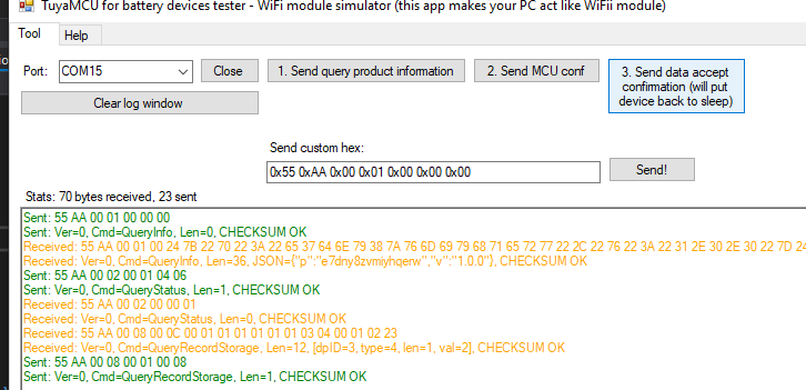

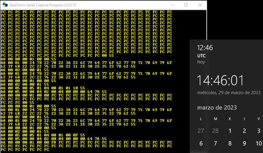

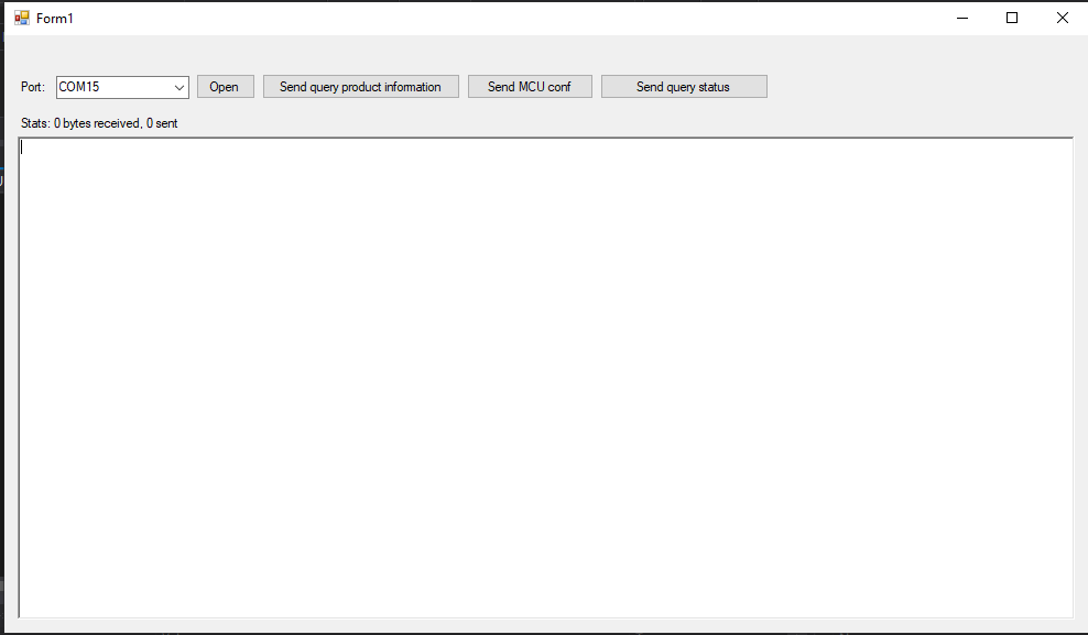

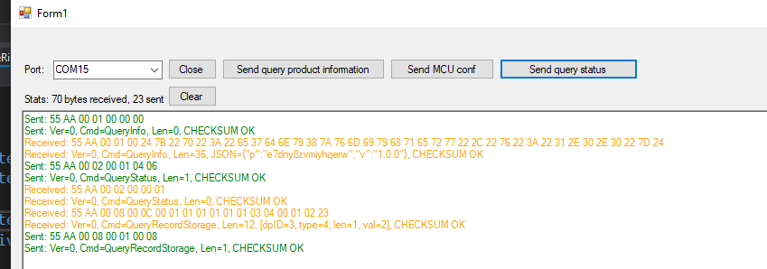

    Can someone measure the traffic between MCU_Tuya and the WIFI module with Realterm or similar software and publish it to make a comparison?
    If you need help with Realterm to make the screenshots, I offer to help you.

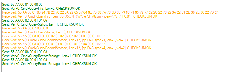

  • Reverse engineered next dimmer protocol for OBK
    #62 20508068
    Posts: 14811
    Rate: 12977
    @spin55 good spotting, online counter was last changed by @iprak , but I think I will change this to stop counter and change page background if there was no page reply in some time.
    Sorry for late reply, I am a bit busy today, I spent few hours reverse engineering next dimmer protocol for OBK. Details will be posted on forum soon, but so far I can show few photos:
    Spoiler:
    Motion sensor with BK7231N and TuyaMCU battery powered devices protocol
    Motion sensor with BK7231N and TuyaMCU battery powered devices protocol Motion sensor with BK7231N and TuyaMCU battery powered devices protocol
  • TuyaMCU motion data frame decoded from serial logs

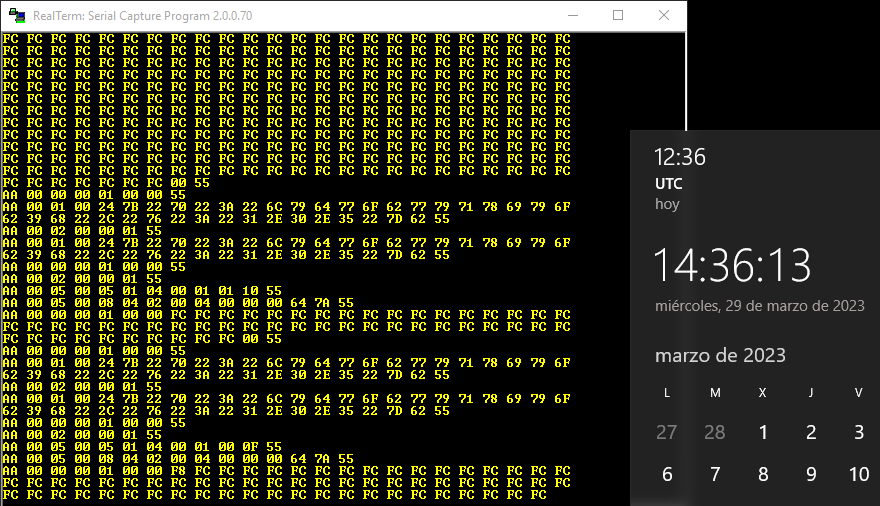

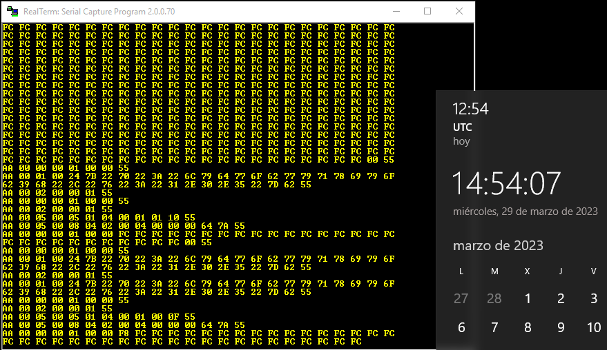

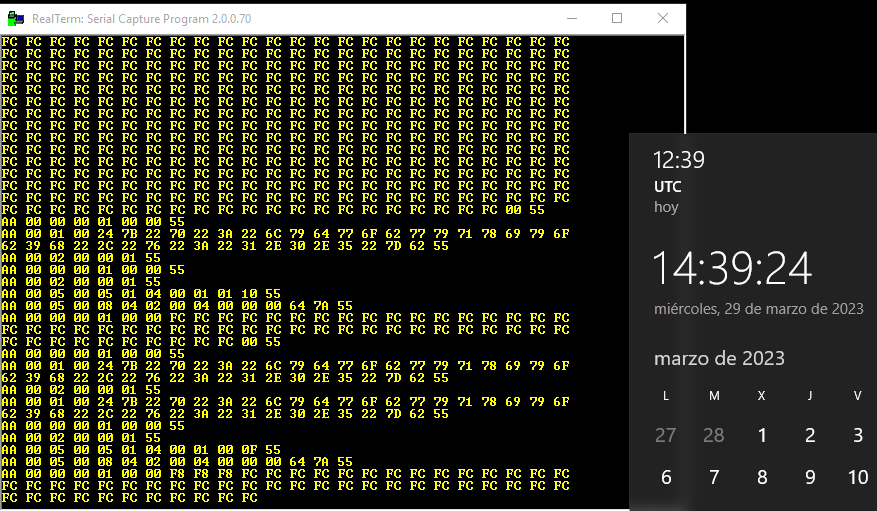

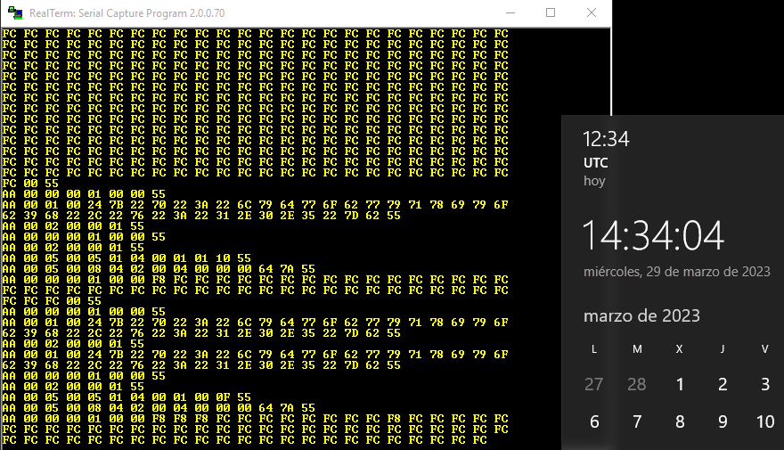

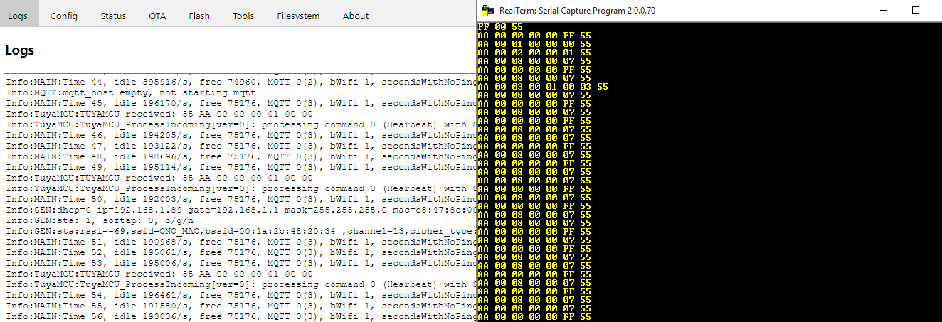

    spin55
    Posts: 209
    Help: 17
    Rate: 42
    @p.kaczmarek2 I appreciate all the help you give on the Forum. Please reply when you can.
    Added after 9 [minutes]:

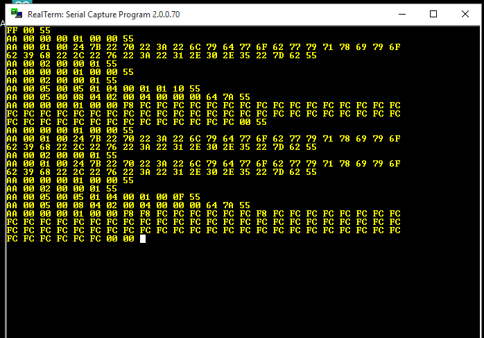

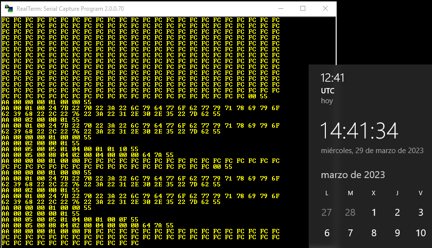

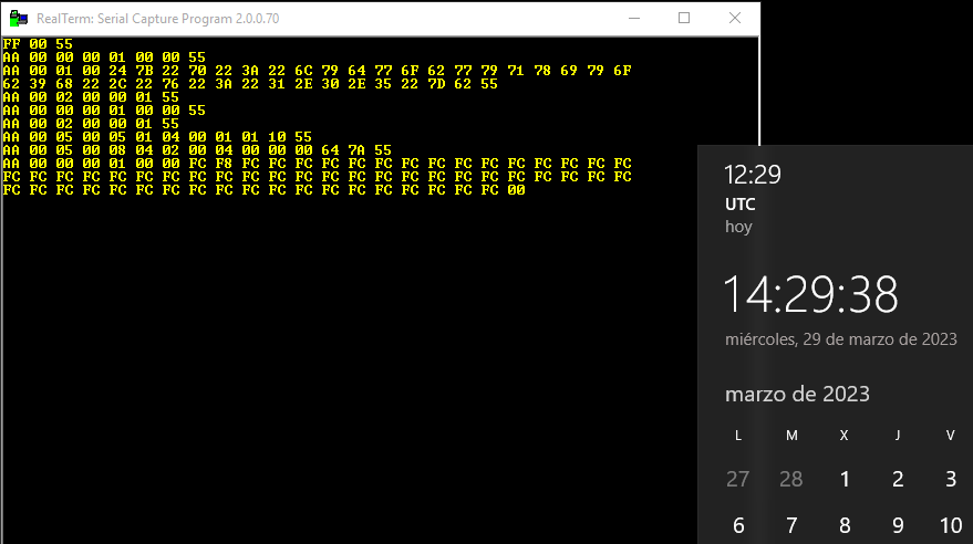

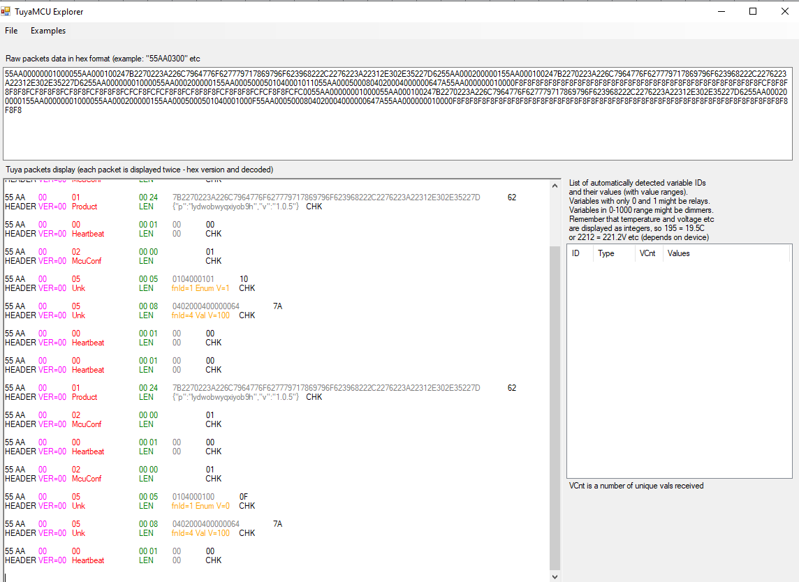

    The wifi module sends this:
    55AA00000000FF55AA000100000055AA000200000155AA000100000055AA000800000755AA00000000FF55AA000800000755AA00020001040655AA00030001000355AA000800000755AA00000000FF55AA0008000007FEF8F8F8F8F8F8F8F8F8F8F8F8F8F8F8F8F8F8F8F8F8F8F8F8F8F8F8F8F8F8F8F8F8F8F8F8F8F8F8F8F8F8F8F8F8F8F8F8F8F8F8F8F8F8F8F8F8F8F8F8F8F8F8F8F8F8F80055AA00000000FF55AA000100000055AA000200000155AA000100000055AA000800000755AA00000000FF55AA000800000755AA00020001040655AA00030001000355AA000800000755AA00000000FF55AA0008000007FEF8F8F8F8F8F8F8F8F8F8F8F8F8F8F8F8F8F8F8F8F8F8F8F8F8F8F8F8F8F8F8F8F8F8F8F8F8F8F8F8F8F8F8F8F8F8F8F8F8F8F8F8F8F8F8F8F8F8F8F8F8F8F8F8F8F8
    According to this information: https://developer.tuya.com/en/docs/iot/tuyacl...niversalserialaccessprotocol?id=K95afs9h4tjjh
    It seems that the module is correctly reporting to the MCU that it is connected:
    55AA000200010406
    However, the alleged publication of data does not reach Homeassistant nor is the website updated.
    And the MCU_Tuya chip this:
    55AA00000001000055AA000100247B2270223A226C7964776F627779717869796F623968222C2276223A22312E302E35227D6255AA000200000155AA000100247B2270223A226C7964776F627779717869796F623968222C2276223A22312E302E35227D6255AA00000001000055AA000200000155AA0005000501040001011055AA0005000804020004000000647A55AA000000010000F8F8F8F8F8F8F8F8F8F8F8F8F8F8F8F8F8F8F8F8F8F8F8F8F8F8F8F8F8FCF8F8F8F8F8FCF8F8F8FCF8F8FCF8F8F8FCFCF8FCFCF8F8FCF8F8F8FCF8F8F8FCFCF8F8FCFC0055AA00000001000055AA000100247B2270223A226C7964776F627779717869796F623968222C2276223A22312E302E35227D6255AA000200000155AA00000001000055AA000200000155AA0005000501040001000F55AA0005000804020004000000647A55AA000000010000F8F8F8F8F8F8F8F8F8F8F8F8F8F8F8F8F8F8F8F8F8F8F8F8F8F8F8F8F8F8F8F8F8F8F8F8F8F8F8F8F8F8
    Here you can see the motion detection information clearly:
    55AA00050005010400010110 --> "1"
    55AA0005000501040001000F --> "0"
    And battery level:
    5AA0005000804020004000000647A --> "100"
    I can update firmware via OTA so the wifi module can be controlled by the MCU
    Does it happen to anyone else?
    Greetings

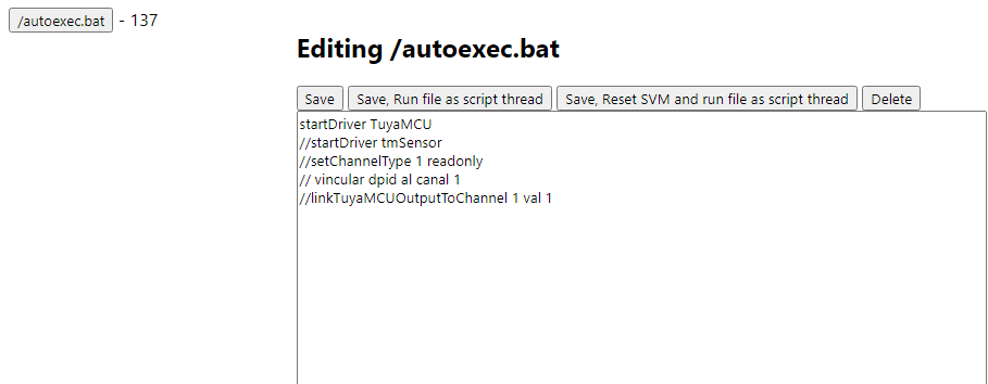

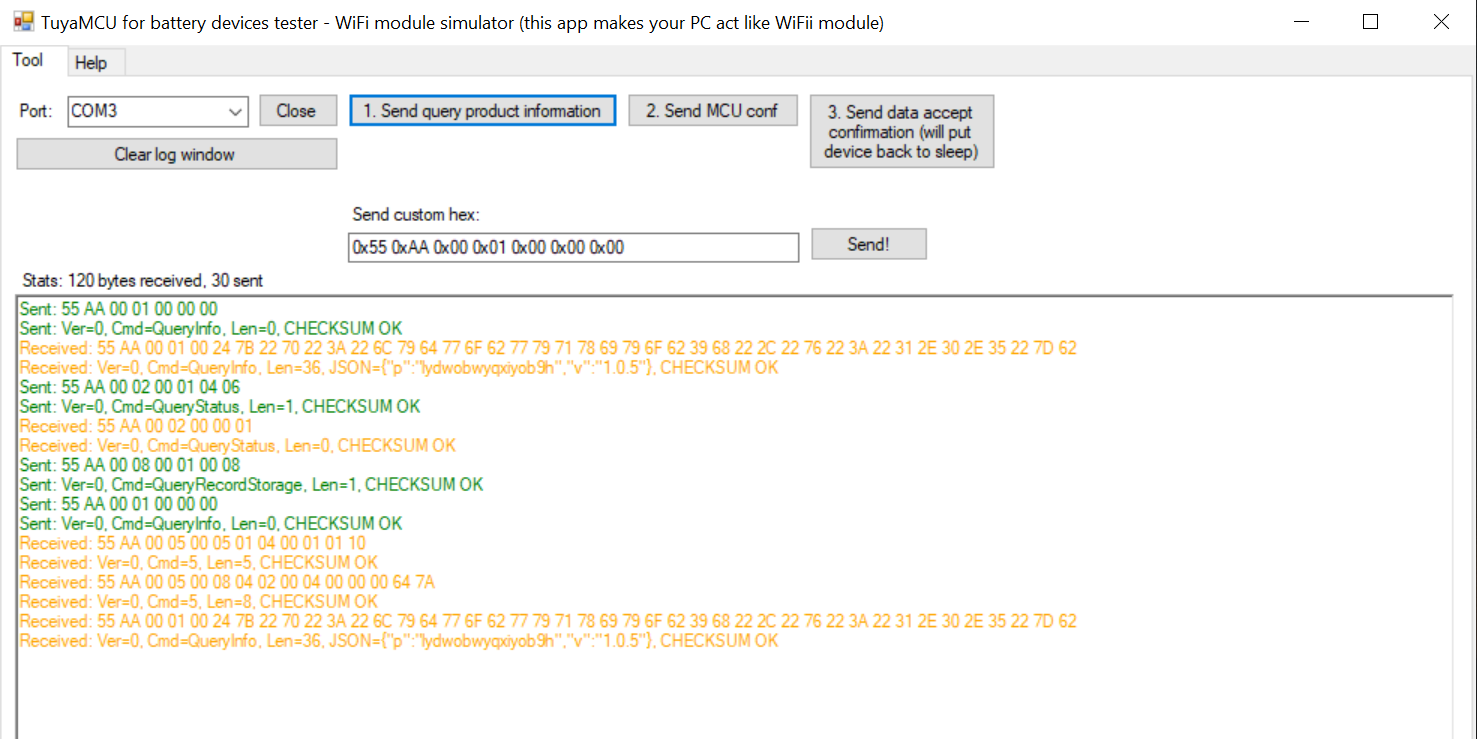

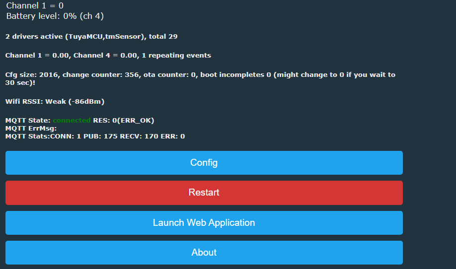

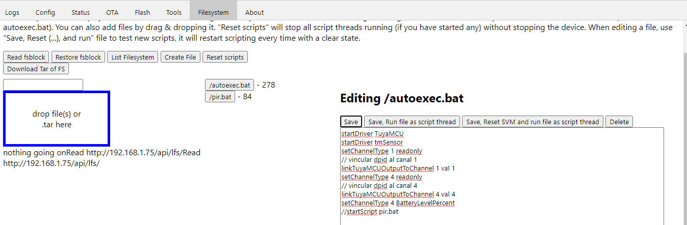

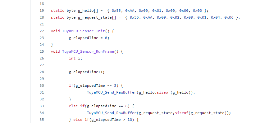

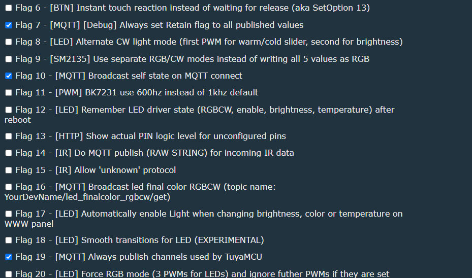

    Okay @spin55 , so first steps I would recommend is:
    - do you have tmSensor running which will ask TuyaMCU to wait and to get sensor state?
    - do you have "publish all states on connect" flag and the "publish tuyamcu vars" flag?
    - have you read topic about related improvement? https://github.com/openshwprojects/OpenBK7231T_App/issues/478
  • Clarifying tmSensor and TuyaMCU publish flags
    #65 20508215
    spin55
    Posts: 209
    Help: 17
    Rate: 42
    I'm reading it, but I don't think I can Do nothing because I don't have the right tools installed nor the knowledge to handle them.
    Thank you
    What is seen by Home Assistant?
    It looks like it's first reporting 1 and later 0. Is 1 or 0 received, or nothing at all?
    Can you do a comparison between TuyaMCU data report and publishes received by HA?
    If you are saying that those publishes do not reach HA, then is device connected to MQTT? Are other publishes seen by HA? Is the IP publish seen? The one done at startup? Or nothing at all? Do you have it paired with HA?
    Here's how TuyaMCU for low power devices should work:
    [url=https://obrazki.elektroda.pl/3632775400_1679770609.png]
    Added after 10 [minutes]:
    I modified publish code for tmsensor to do a quicker, forced all tuyamcu channels publish, can you check if it helps for you?
    You need to update to build 1.15.627

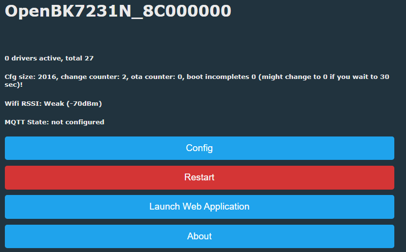

  • Web only accessible in update mode, no motion detection
    #67 20508599
    spin55
    Posts: 209
    Help: 17
    Rate: 42
    I have tried these two configurations in HA:
    - unique_id: "OpenBK7231N_1F4A8B0C_binary_PIR_2"
      name: "Motion sensor_2"
      state_topic: "obk1F4A8B0C/1/get"
      qos: 1
      payload_on: 1
      payload_off: 0
    - unique_id: "obk1F4A8B0C_voltage"
      state_topic: "obk1F4A8B0C/4/get"
      unit_of_measurement: '%'
      value_template: "{{ value }}"
    And this:
         - unique_id: "OpenBK7231N_1F4A8B0C_binary_PIR"
           value_template: '{{ value | replace("0", "Reposo") | replace("1", "Activado") }}'
    The problem is that the web does not start and therefore there is no possibility of Log TuyaMCU.
    I've updated to version 629 and it's still the same.
    Added after 17 [minutes]:
    I can only access the web when I put the pir in Update mode by pressing the button for 6 seconds until the leds turn off and repeat. Only with this sequence I can access the web and update via OTA, but it does not detect movement. In normal operation it is not possible to open the web.
    I rule out that it is an electrical fault because with a long double press on the button, the web is activated.

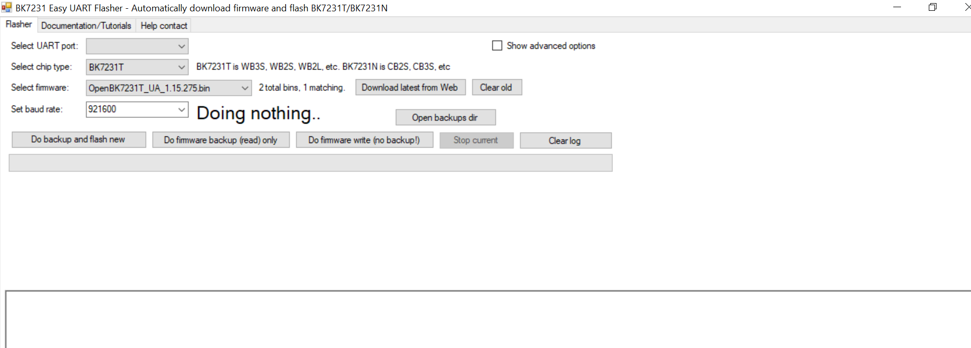

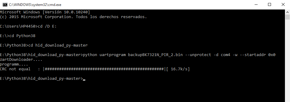

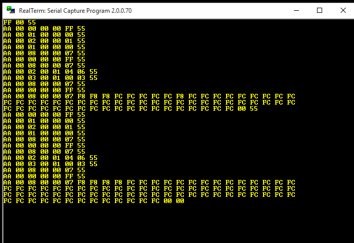

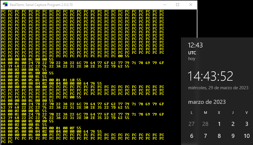

    #68 20512592
    spin55
    Posts: 209
    Help: 17
    Rate: 42

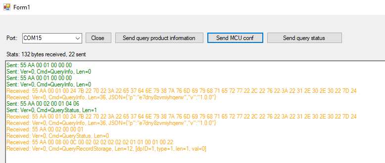

    Hello. I keep trying but I'm stuck. Any help would be well received.
    After many failed tests, I think the Tuya_MCU chip code might be failing because it only does one power-up cycle and then doesn't respond anymore.
    I have flashed the BK7321N chip several times, both by USB and via OTA without problems, so I rule out that the firmware is corrupted.
    This is the Rx communication:
    And there is the Tx line:
    From there the motion detector no longer changes or turns on the leds. In addition, this first change is not published on the web or on Homeassistant.
    In order to access the web I have to press the pairing button until the LEDs go off and repeat the sequence. In this way I can access the Log and keep the connection alive without time limit. In fact, it is the only way to update via OTA. But in this state, the motion sensor does not change state.

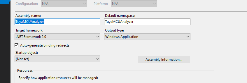

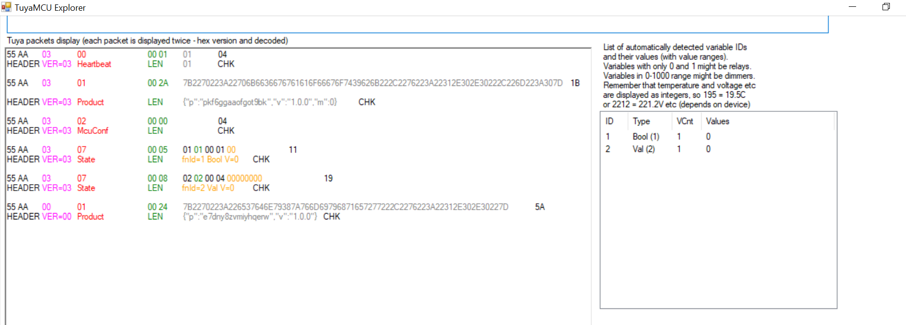

    @p.kaczmarek2, can you tell me where this tool can be downloaded?
    https://obrazki.elektroda.pl/2272847700_1679770424_thumb.jpg
    https://www.elektroda.com/rtvforum/topic3937723-60.html#gallery-10
    Greetings
  • #69 20513796
    Posts: 14811
    Rate: 12977
    I haven't published it yet, but here's a debug build for you:
    • TuyaMCUAnalyzer-20230329.zip (22.1 KB) You must be logged in to download this attachment.
  • 2-minute reset cycle blocks MQTT transmission

    There are important news related to this thread. I am preparing a summary of the tests carried out.
    Greetings
    Added after 48 [minutes]:
    Yesterday I received another pir motion just like this one.
    After flashing it has the same symptoms. The captures with Realterm are identical in the Tx and Rx tracks of communication between TuyaMCU and BK7321N.
    The screenshots clearly show the motion sensor trigger reset cycles and they are correct, but the reset time is not 1 minute as the instruction manual says, but 2 minutes. That's why I thought that it only did a reset cycle and trip when it was turned on.
    This is what the manual for the device says:
    Main function
    Operate status: alarma/ normal (the device can be triggered only once 1 minute)
    Device Status-----------------LED State
    Smart Wi Fi ------------------Indicator flashes quicly

    The TuyaMCU chip detects the state changes of the motion detector and controls the BK7321N through the CEN pin, first passing through a transistor. But this activation time lasts a few seconds and I think that is the reason why the data does not reach the web or Home Assistant through MQTT.
    Without Realterm it is impossible to see what is happening because the wifi module does not have enough time to activate and transmit. The only way for the chip to transmit is to do a Reset according to the manual. The device enters AP mode and you can access the web and view the logs, but it does not respond to motion detection. This is the method I use to do firmware updates via OTA without fear of being cut off during the process.
    Does anyone have this device and can confirm if it works correctly?
    Greetings
    Added after 8 [hours] 2 [minutes]:
    I continue with the tests. I've put the CEN pin to VCC through a 1K resistor to hold the 3 volts longer than the 10-12 seconds controlled by the TuyaMCU chip, but still the same.
    I think I'm going to leave it waiting for someone to buy the same device and have more luck or knowledge than me on the subject.
    Greetings

    Would you be able to capture the full communication of the original Tuya firmware with that MCU?
    It gives CRC error when I load the original backup.
    I did one last test restoring the original backup from the other device and it gives the same CRC error.
    Despite this, I installed the Smartlife App to test if it was possible to pair it, and I have not been able to.
    So I reinstalled OpenBeken firmware and now it shows up with mac zero.
    That doesn't worry me because it can be restored, but look at the Log. It is not loading the drivers and see how it disconnects and reconnects the BK7321N from time to time.

    I loaded startDriver TuyaMCU and startDriver tmSensor in autoexec.bat and there are no more Logs, although in Realterm you can see the cycles already described above. And if I remove startDriver tmSensor the web is activated again and there are Logs.
    Greetings

    Rx:
    Tx:
  • Need full UART capture to compare Tuya packets
    #73 20516304
    Posts: 14811
    Rate: 12977
    CRC error can be ignored.

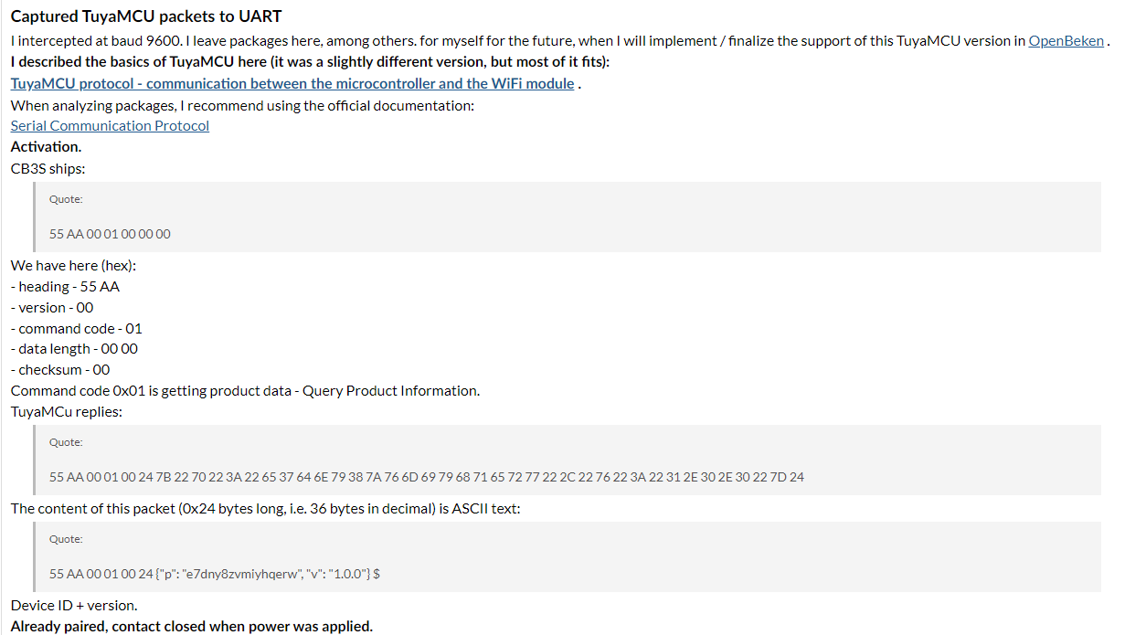

    A full dump of UART communication in a format that I can copy would help.
    Btw, have you seen this topic?
    https://www.elektroda.com/rtvforum/topic3914412.html
    I've did a basic breakdown of TuyaMCU communication there for the similar device to yours. Maybe it could help.
    This is normal. If you don't have tmSensor running, the MCU will try to reboot MCU in infinite loop. This is because the MCU is waiting for OBK to send first packet, which is:

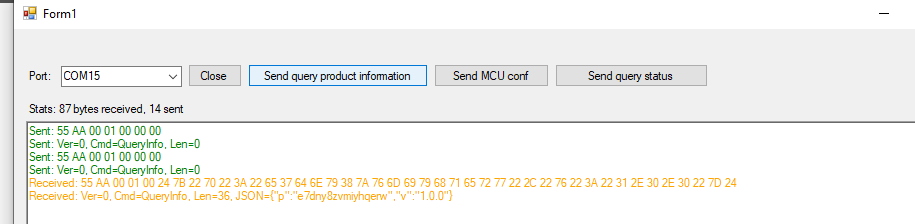

    You can see that OpenBeken tmSensor driver sends it after 3 seconds uptime:
    spin55 wrote:
    And that's how it is now. It does a boot cycle of 123 times and stops. It is only reactivated by pressing the button or disconnecting and reconnecting.
    123 times? I looked at the log text and I see that by "123 times" you mean uptime 123 second... ok..
    Info:MAIN:Time 123, idle 194114/s, free 75184, MQTT 0(7), bWifi 1, secondsWithNoPing -1, socks 2/38
    So you are saying it does not wake up to make measurement again after N seconds?
    My main conclusions would be:
    1. uptime 123 seconds is enough to report values over MQTT, do you get them?
    2. if it does not wake up later to do another measurement, then something is missing from UART protocol
    3. Again, full capture of what is sent by Tuya original firmware on both lines would be very, very helpful. Because then I can compare packets one by one and see what is missing for OBK
    This must be something specific to this device, because I already tested that sensor:
    with our tmSensor driver and it worked well.
  • Motion sensor freezes without tmSensor driver enabled
    #74 20516798
    spin55
    Posts: 209
    Help: 17
    Rate: 42
    Yes, that's what I'm saying. Every time I press the button it starts a new cycle, otherwise it just freezes there because the motion sensor isn't responding. It may be because startDriver tmSensor is disabled because otherwise the web won't start.
    :MAIN:Started TuyaMCU.
    Info:MAIN:Time 1, idle 287869/s, free 80032, MQTT 0(0), bWifi 0, secondsWithNoPing -1, socks 2/38
    Info:TuyaMCU:TUYAMCU received: 55 AA 00 00 00 01 00 00
    Info:TuyaMCU:TuyaMCU_ProcessIncoming[ver=0]: processing command 0 (Hearbeat) with 8 bytes
    Info:MAIN:Time 2, idle 191602/s, free 80032, MQTT 0(0), bWifi 0, secondsWithNoPing -1, socks 2/38
    When connected to the mains, it publishes all the channels you are subscribed to, but then only reports the status when I manually press the button. Note that in autoexec.bat only startDriver TuyaMCU is enabled because otherwise the web won't start.
    Tema al que suscribirse
    obk1F4A8B0C/#

    2. if it does not wake up later to do another measurement, then something is missing from UART protocol.
    It is that there is no communication between TuyaMCU and BK7321N with that backup. It's like the device is locked. The LEDs do not respond as the instruction manual says. That's why I went back to the OpenBeken firmware. I already told you with the two original backups and the same thing happens. I will try again.
    The information explained in the link https://www.elektroda.com/rtvforum/topic3914412.html is very interesting, but the Tuya commands have already been commented throughout this and other threads: https://developer.tuya.com/en/docs/iot/tuyacl...niversalserialaccessprotocol?id=K95afs9h4tjjh
    Thanks

    This is a very hard issue to debug without original packets capture. I don't know how it's possible that original backup does not want to talk with TuyaMCU.
    Futhermore, we have users just right now, today reporting that they have TuyaMCU sensors working in OBK:
    https://www.elektroda.com/rtvforum/topic3968377.html
    So it is something specific to your device. I will try to order a similar one, please wait some time, or maybe we can try something in a meantime.
    It is very strange. By default, the tmSensor is required to get anything over TuyaMCU from battery powered device.
    For my door sensor, to which review I linked earlier, the communication flow is as below:
    - first TuyaMCU powers CB3S
    - then OBK tmSensor sends hello to TuyaMCU
    - TuyaMCU responds
    - then OBK tmSensors sends get state
    - TuyaMCU responds and sends also packets with variables.
    So the behaviour you describe is unexpected.
    Are you really sure that you are getting data over TuyaMCU with no tmSensor started?
    Your device must be using a slightly different protocol than the one I had. And different than the device discussed earlier today here:
    Maybe the correct solution would be to don't use tmSensor for your device, and just figure out how to make it wakeup after given time. Maybe it expects OBK to send something setting a sleep time? Maybe one of dpIDs is a sleep time that must be sent? Do you have a list of available dpIDs for this device? Maybe sleep time/measurement interval was configurable in Tuya and that's what we are missing?

    I have several devices of the type TH06 and S09 that have a Tuya chip and work perfectly with the tmSensor driver.
    If I don't start tmSensor, it starts web but I don't get change data from pir sensor.
    If I start tmSensor the web doesn't start but I can see with Realterm that the communication between MCU's is correct. I have previously uploaded those screenshots. That is, it works fine but without Wi-Fi connection. I can also measure with a multimeter how it controls the voltage on the CEN pin of BKN.
    Motion sensor with BK7231N and TuyaMCU battery powered devices protocol Motion sensor with BK7231N and TuyaMCU battery powered devices protocol Motion sensor with BK7231N and TuyaMCU battery powered devices protocol Motion sensor with BK7231N and TuyaMCU battery powered devices protocol Motion sensor with BK7231N and TuyaMCU battery powered devices protocol Motion sensor with BK7231N and TuyaMCU battery powered devices protocol Motion sensor with BK7231N and TuyaMCU battery powered devices protocol Motion sensor with BK7231N and TuyaMCU battery powered devices protocol Motion sensor with BK7231N and TuyaMCU battery powered devices protocol Motion sensor with BK7231N and TuyaMCU battery powered devices protocol Motion sensor with BK7231N and TuyaMCU battery powered devices protocol Motion sensor with BK7231N and TuyaMCU battery powered devices protocol

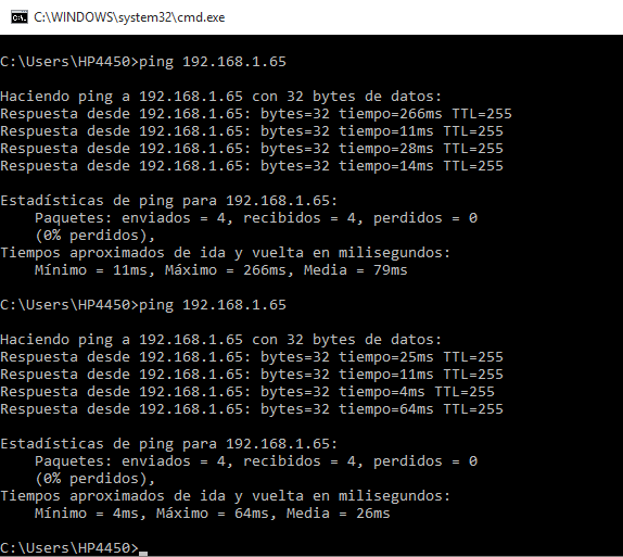

    How long is BK module powered if you have tmSensor started?
    Is only Web interface not responsive? How long is it pingable from your PC?
    I am asking because there is nothing in tmSensor that can break Web interface and it only seems like with tmSensor the MCU shuts down the WiFi module too early so it has no time to connect to network... but it's just a guess...
    13-14 seconds.
    Added after 37 [minutes]:
    Tx:
    Rx:
    I am probably wrong because taking a look at the screenshots of the communication between TuyaMCU and BKN I see commands that It doesn't match the information from Tuya: https://developer.tuya.com/en/docs/iot/tuyacl...niversalserialaccessprotocol?id=K95afs9h4tjjh
    There it says that each command must receive confirmation by the other party. So why does BKN respond with a command 08 to a command 05 sent by TuyaMCU?
    The 03 command should not be sent by TuyaMCU?, and should not be 04 instead of 03?. Perhaps that is why there is no answer in Rx?.
    According to Tuya that command 04 would reset the Wi-Fi and select the smartconfig mode. But does this make sense when you have just been told that you are connected to a router and cloud?
    Greetings

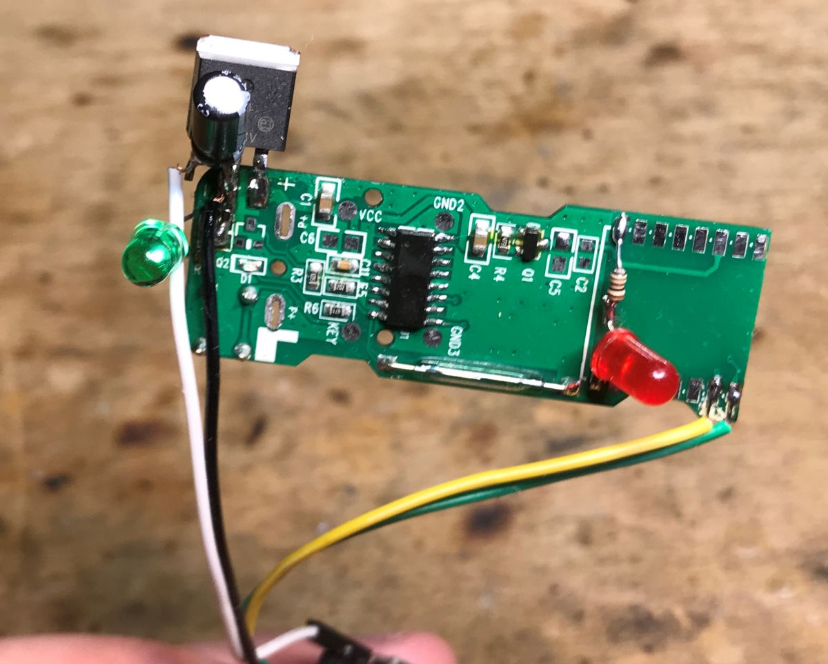

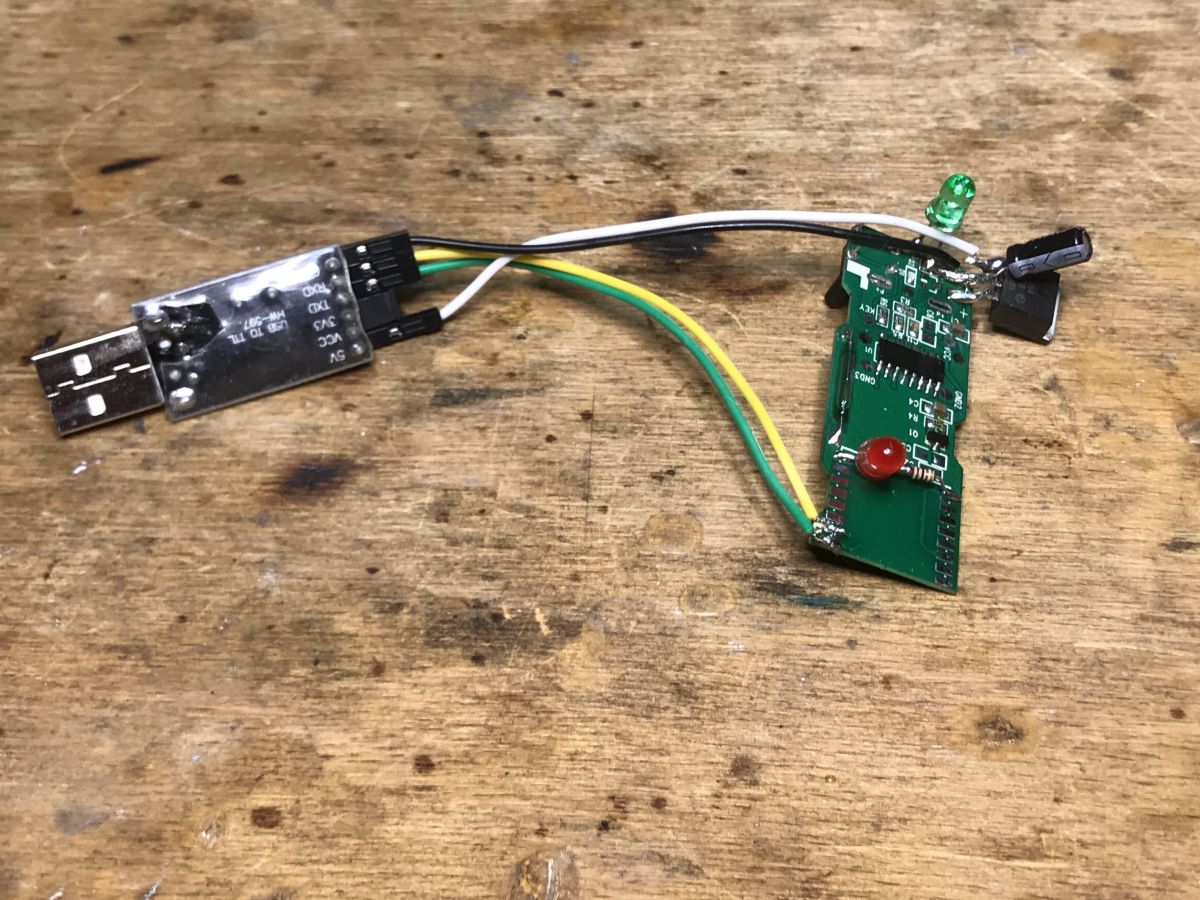

    @spin55 I really want to help you, but I only can use what I have, and I have only the board from mentioned door sensor. I have desoldered the CB3S in the past because I needed it for dev board, but now I added USB to UART converter and I can connect it to PC:
    I think you can understand what I did there, right? PC is in role of OBK now.
    Red LED shown when WiFI module would be powered on.
    My first observation is that it reports nothing when I wake up it with door sensor, the red LED goes on for 10 seconds, then turns off for 0.5 second, then goes on for 10 seconds, and again, and again.
    Basically TuyaMCU tries to power on WiFi module, but receives nothing, so it reboots it after 10 seconds, and tries again, etc. After about 10 cycles of 10 seconds power on, the MCU gives up and turns off WiFi module forever.
    My second observation was made while I wrote a simple tester app for this purpose:
    This app simulated OBK.
    So, when I wake up my door sensor TuyaMCU, and send the first packet from my PC (acting as OBK), I get a reply:
    Then, when I send McuConf, I get a reply followed by a state variable (dpID):
    I am too slow and I had a packet duplicate for some reason, but you get the point... here's the whole communication:
    Sent: 55 AA 00 01 00 00 00
    Sent: Ver=0, Cmd=QueryInfo, Len=0
    Received: 55 AA 00 01 00 24 7B 22 70 22 3A 22 65 37 64 6E 79 38 7A 76 6D 69 79 68 71 65 72 77 22 2C 22 76 22 3A 22 31 2E 30 2E 30 22 7D 24
    Received: Ver=0, Cmd=QueryInfo, Len=36, JSON={"p":"e7dny8zvmiyhqerw","v":"1.0.0"}
    Sent: 55 AA 00 02 00 01 04 06
    Sent: Ver=0, Cmd=QueryStatus, Len=1
    Received: 55 AA 00 02 00 00 01
    Received: Ver=0, Cmd=QueryStatus, Len=0
    Received: 55 AA 00 08 00 0C 00 02 02 02 02 02 02 01 01 00 01 00 22
    Received: Ver=0, Cmd=QueryRecordStorage, Len=12, [dpID=1, type=1, len=1, val=0]
    and now red LED (WiFi module power) stays on much longer...
    I haven't done much tests so far, and it seems that timing also might be a factor here, but everything works within expectations.
    Still, would you be interested in playing around with that tool? You could try replacing WiFi module with USB to UART connector just like I did and we will see how it exactly works in case of your device.
    Otherwise the only way I can see is that I need to get one piece of your problematic device somehow.
    Added after 25 [minutes]:
    Sorry, I had an extra useless byte that was breaking, now here is how full transaction looks like:
    The last "queryrecordstorage" may be named incorrectly, but basically that 0x08 type packet says that reporting is done and MCU can shut down now.
    That's how full transaction looks like for my door sensor.
    @spin55 would you like to try my app to debug your device TuyaMCU?
    Of course I would be interested, but I am afraid that I will be able to install it for the same reason that I could not with TuyaMCUAnalyzer or BK7231Flasher due to a .NET Framework error. But I'm willing to try.
    In this case there is no module, the BK7321N goes on the motherboard, but I guess by pulling up the transistor that goes to CEN or forcing it to GND somehow, I could override the chip and freely use Tx and Rx.
    I think the best solution would be to try the old app if I can install it. If not, I would not mind sending you the Pir Motion to the address that you indicate by private message. You could also order one and have it delivered there, but we run the risk of it being a different version.

    I had to give up on using Min and Max, etc, and write their replacements, but it takes just a one minute to do it.
    • TuyaMCUAnalyzer-20230401.rar (29.34 KB) You must be logged in to download this attachment.
  • #87 20519056
    Posts: 14811
    Rate: 12977
    Ok I am attaching this program as well:
    Here is how a correct transaction seems to look like for my door sensor:
    • BatteryPoweredTuyaMCUDemo-20230401.rar (18.74 KB) You must be logged in to download this attachment.
  • CEN pin grounded to access TuyaMCU
    #88 20520149
    spin55
    Posts: 209
    Help: 17
    Rate: 42
    I have been able to communicate with TuyaMCU by setting the CEN pin of BK7321N to GND.
    As you can see, TuyaDemo works and makes the task much easier, because it can also be done with RealTerm but it is much heavier.
    I'll experiment with the commands to see what happens. I will inform him and see if between the two of us we deduce where the problem may be.
    Thank you very much for your help. Even if in the end you won't be able to pull this off, the knowledge gained will have been worth it.

  • TuyaMCU UART trace shows dpIDs and Wi-Fi conflict
    #90 20520260
    spin55
    Posts: 209
    Help: 17
    Rate: 42
    Earlier you have mentioned something like that your MCU device is reporting dpIDs over TuyaMCU even without tmSensor driver, which basically means it will send data over UART without "QueryInfo" packet, which is now shown to be sent on the screenshot you provided.
    I don't understand what you mean specifically. Without tmSensor there is no publication of dpIDs but there is wifi, with tmSensor there are dpIDs but there is no wifi.
    Can you now check again, is your MCU really sending data without sending anything from PC first?
    Do you mean if you receive data with TuyaDemo? If so, nothing is received with both CEN to GND and open.
    Added after 11 [hours] 18 [minutes]:
    This is the communication between TuyaMCU and BKN captured with RealTerm and repeatedly posted with images throughout the thread. With tmSensor loaded and working correctly everything except Wi-Fi transmission.
    Tx:
    55 AA 00 00 00 00 FF
    55 AA 00 08 00 00 07
    55 AA 00 03 00 01 00 03
    Rx:
    55 AA 00 01 00 24 7B 22 70 22 3A 22 6C 79 64 77 6F 62 77 79 71 78 69 79 6F
    62 39 68 22 2C 22 76 22 3A 22 31 2E 30 2E 35 22 7D 62
    55 AA 00 05 00 05 01 04 00 01 01 10
    55 AA 00 05 00 08 04 02 00 04 00 00 00 64 7A
    If I am correctly interpreting the information from the Tuya protocol https://developer.tuya.com/en/docs/iot/tuyacl...niversalserialaccessprotocol?id=K95afs9h4tjjh, the MCU reports the DPs via command 05, but BKN replies that it has received a command 08. It doesn't seem right.
    That is, MCU sends: AA 00 05 00 05 01 04 00 01 01 10 55 and BKN confirms with: AA 00 08 00 00 07 55. Wouldn't you have to answer?: AA 00 05 00 00 04 55.
    When this is cleared up, we can continue with AA 00 03 00 01 00 03 55.
    NOTE:
    The commands appear with 55 at the end instead of the beginning because they are direct copies of the RealTerm terminal. Of course, the command starts at 55 on the previous line.
    Added after 39 [minutes]:
    This is the site where I bought the pir in case you want to ask for it: https://es.aliexpress.com/item/10050049224192...st_main.5.21ef194dBswjQ5&gatewayAdapt=glo2esp. It will be faster and safer than if I ask for it to be sent to your address.

What’s the correct OpenBeken autoexec.bat for a BK7231N TuyaMCU PIR?
Use TuyaMCU + tmSensor, then map dpIDs to channels. Example: startDriver TuyaMCU startDriver tmSensor setChannelType 1 readonly linkTuyaMCUOutputToChannel 1 val 1 setChannelType 4 readonly linkTuyaMCUOutputToChannel 4 val 4 This maps motion (dpId 1) to ch1 and battery (dpId 4) to ch4. Update firmware first to ensure 0x05 parsing and low‑power handling. [Elektroda, p.kaczmarek2, post #20320779]
How do I keep the PIR online long enough to configure or OTA flash?
Enter pairing mode to keep Wi‑Fi powered longer. Long‑press the button about 6 seconds, wait briefly, repeat if needed. This prevents TuyaMCU from shutting the module too early. Then finish OTA or WebApp setup. “Pair mode keeps the module powered for over a minute.” [Elektroda, p.kaczmarek2, post #20563807]
How do I sniff TuyaMCU traffic and find dpIDs?
Use Realterm at 9600 baud, HEX display, do not connect CEN. Trigger motion and look for frames beginning 55 AA. Motion typically reports in 0x05 packets; you will see dpID=1 changes. Capture to a file for analysis. [Elektroda, p.kaczmarek2, post #20310728]
Which dpIDs does this PIR use for motion and battery?
dpId 1 is motion state (Enum 0/1). dpId 4 is battery percent (Value 0–100). Link dpId 1 → channel 1, dpId 4 → channel 4 using linkTuyaMCUOutputToChannel. Then publish retained MQTT for HA. [Elektroda, p.kaczmarek2, post #20332445]
Home Assistant shows the PIR as ‘unknown’ or ‘unavailable’. How do I fix it?
Enable OpenBeken Flag 7 to publish all values with retain. Remove availability_topic from your HA YAML, since HA removed retain on binary sensors. Quote: “Solution: remove availability topic … and enable retain on OBK.” [Elektroda, p.kaczmarek2, post #20329316]
What HA YAML should I use for the motion entity (MQTT binary_sensor)?
Example: binary_sensor:
  • platform: mqtt name: "PIR Motion" state_topic: "obkDevice/1/get" qos: 1 payload_on: 1 payload_off: 0 Replace obkDevice with your topic (e.g., obk8C000000). Ensure retain is enabled on OBK (Flag 7). [Elektroda, p.kaczmarek2, post #20324662]
How do I expose battery percentage to Home Assistant?
Use an MQTT sensor for channel 4: sensor:
  • platform: mqtt name: "PIR Battery" state_topic: "obkDevice/4/get" unit_of_measurement: "%" value_template: "{{ value }}" This reads dpId 4 mapped to channel 4 as a percentage. [Elektroda, p.kaczmarek2, post #20333999]
Why does my PIR publish only ‘1’ (motion) and miss the ‘0’ (clear)?
Initialize the channel so changes are detected. Two options: SetStartValue 1 -1 (remember last state) or setChannel 1 2 once in autoexec, so both 0 and 1 cause a change. This prevents ignored first updates. [Elektroda, p.kaczmarek2, post #20578050]
How do I get battery percent to render nicely on the OBK UI?
Update firmware, then set: setChannelType 4 BatteryLevelPercent. This channel type was added later; update to a build that includes it. Quote: “Battery Percent Indicator was added … so you would need to update the firmware.” [Elektroda, p.kaczmarek2, post #20332736]
