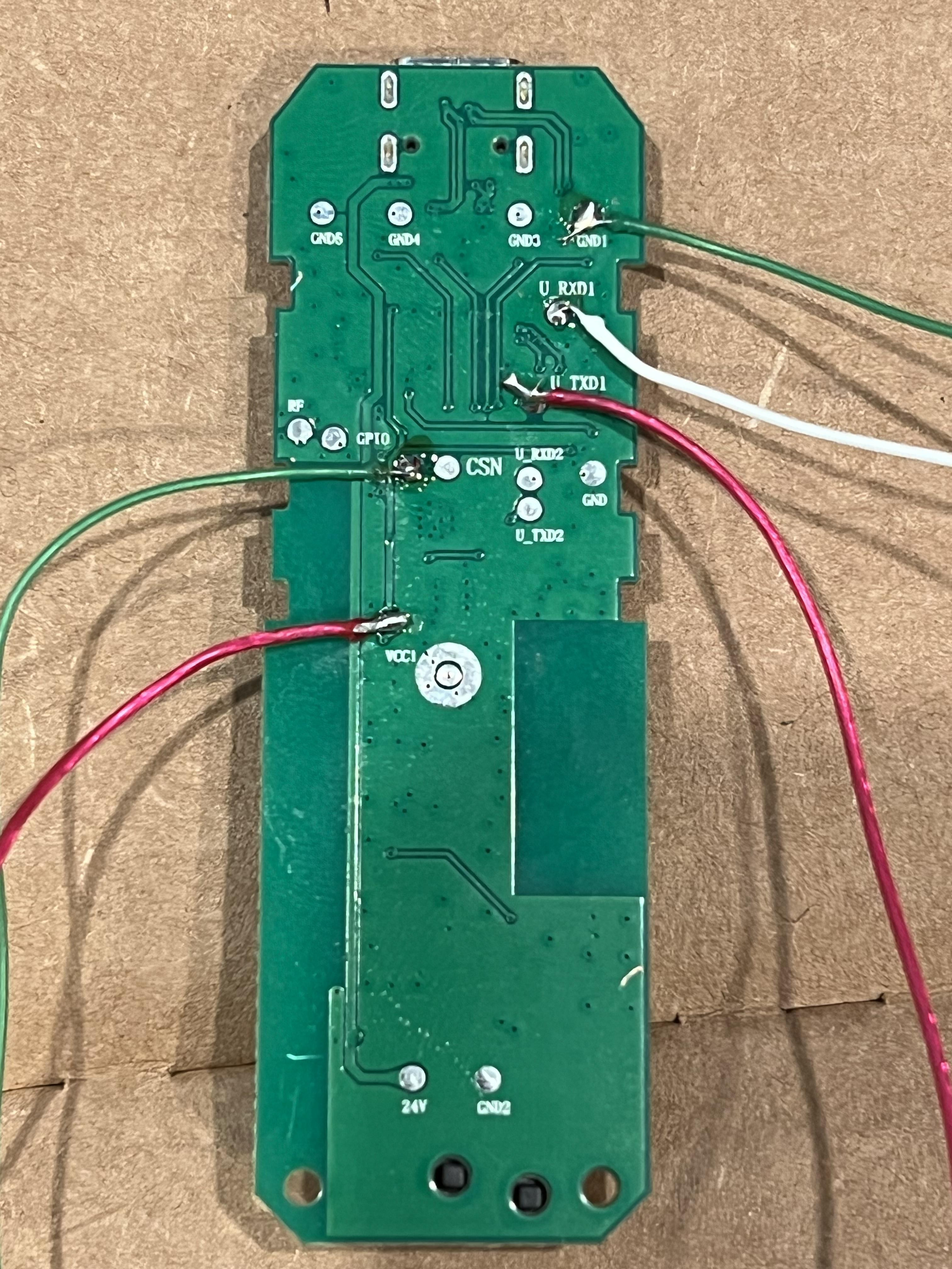

  • FEIT Smart WiFi Light Strip FETAPE/RGBW/CNTRSC on BK7231N was torn down and mapped for OpenBK/CloudCutter.
  • RGBW mode needs flag 24 in the native interface; the web app misreports status, and the BLE wireless remote still does not work.
  • The working pin map is 6=PWM;4, 7=PWM;2, 8=PWM;1, 9=PWM;0, plus 26=Btn_SmartLED;0, with no signal on pin 24.
  • Flashing through RX1, TX1, GND, and CEN worked without desoldering, and the 1.0.9 OpenBK update notably improved Wi‑Fi performance across five devices.

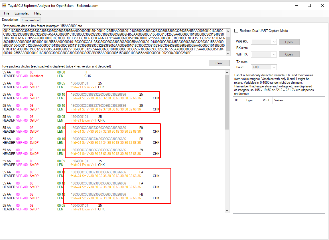

  • #72 20718251
    plexusresort0a
    >>20715687
    Thanks for the tips! I finally got something useful looking! I don't know where to go from here.
    Here's the actions I captured!
    capture_c..or.txt (1.1 kB)You must be logged in to download this attachment.
    capture_di..._light.txt (1.48 kB)You must be logged in to download this attachment.
    capture_on...lights.txt (158 bytes)You must be logged in to download this attachment.
    capture_p..er.txt (224 bytes)You must be logged in to download this attachment.
  • #73 20718322
    Posts: 14615
    Help: 655
    Rate: 12633
    It looks like something that could work with tuyaMcu_setupLED.
    Can you please do, maybe, one more test?
    I want separate captures for:
    - setting 100% red color
    - setting 100% green color
    - setting 100% blue color
    Then we can use the search button:
    https://www.elektroda.com/rtvforum/find.php?q=tuyaMcu_setupLED
    It also seems that dpIDs are matching the standard ones. For example:
    Screenshot from TuyaMCU Explorer/Analyzer showing raw and decoded packet data.
    dpID 24 is a color data in a form of a string

  • #75 20719558
    Posts: 14615
    Help: 655
    Rate: 12633
    Blue is:
    55 AA	00	00		00 00		FF
    HEADER	VER=00	Heartbeat		LEN		CHK
    55 AA	00	06		00 05	1504000101	25
    HEADER	VER=00	SetDP		LEN	fnId=21 Enum V=1	CHK
    55 AA	00	06		00 10	1803000C303066303033653830336538	32
    HEADER	VER=00	SetDP		LEN	fnId=24 Str V=30 30 66 30 30 33 65 38 30 33 65 38	CHK
    In ASCII: 00f003e803e8
    When you search for it on our forum:
    https://www.elektroda.com/rtvforum/find.php?q=00f003e803e8
    it leads to @nethawk 's topic, so we're home....
    Green is:
    55 AA	00	06		00 10	1803000C303037383033653830336538	0B
    HEADER	VER=00	SetDP		LEN	fnId=24 Str V=30 30 37 38 30 33 65 38 30 33 65 38	CHK
    In ASCII: 007803e803e8
    It's also on our forum:
    https://www.elektroda.com/rtvforum/find.php?q=007803e803e8
    It has the same protocol, it seems.
    You can flash OBK now, but of course, make 2MB backup of original firmware.
