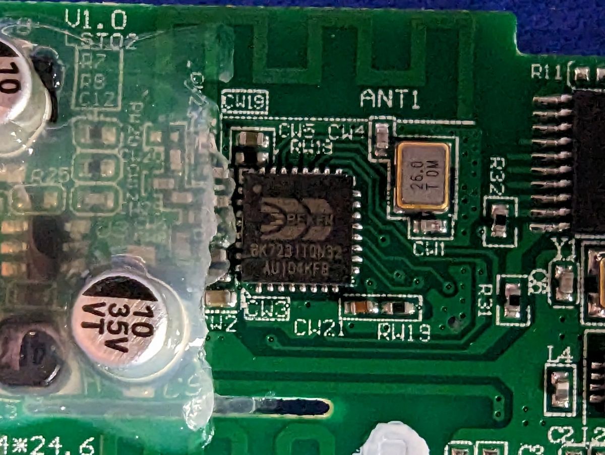

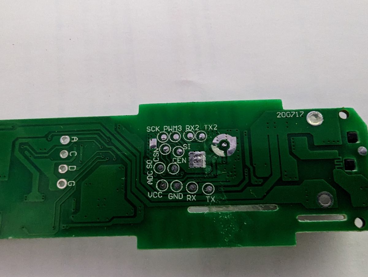

  • FEIT Smart WiFi Light Strip FETAPE/RGBW/CNTRSC on BK7231N was torn down and mapped for OpenBK/CloudCutter.
  • RGBW mode needs flag 24 in the native interface; the web app misreports status, and the BLE wireless remote still does not work.

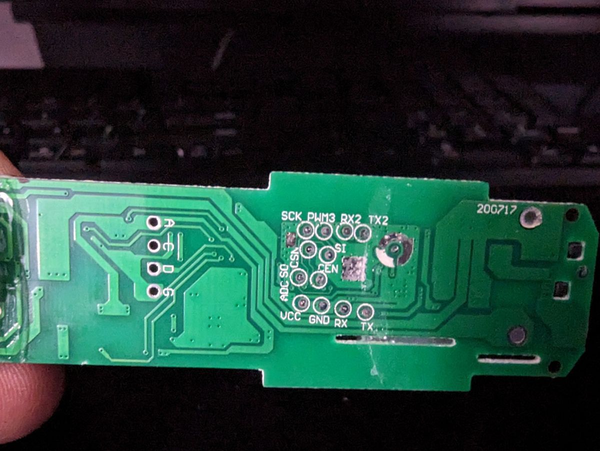

  • The working pin map is 6=PWM;4, 7=PWM;2, 8=PWM;1, 9=PWM;0, plus 26=Btn_SmartLED;0, with no signal on pin 24.
  • Flashing through RX1, TX1, GND, and CEN worked without desoldering, and the 1.0.9 OpenBK update notably improved Wi‑Fi performance across five devices.

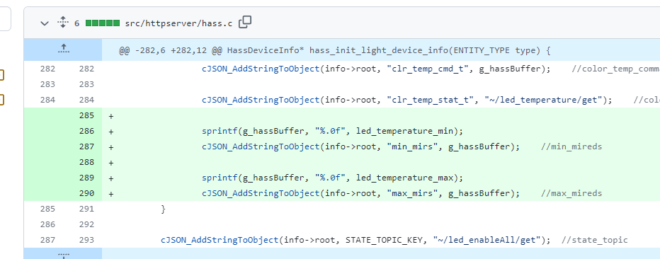

    Hmm, so it was tested:
    FEIT Smart WiFi Light Strip - Model: FETAPE/RGBW/CNTRSC - FCC ID: SYW-TAPRGBWCNTRSC - 7231N
    I'd personally just cast to integer with (int) and use %i, but if it works with our lightweight sprintf on Beken, then no problem, it's good as it is.
    If the configuration is not posted, you can help me by:
    1. getting config JSON from web app so I don't have to type it manually
    2. maybe doing pull request here if you can:;
    https://github.com/OpenBekenIOT/webapp/blob/gh-pages/devices.json
    I usually do it myself and it takes time, so it's always nice if someone helps

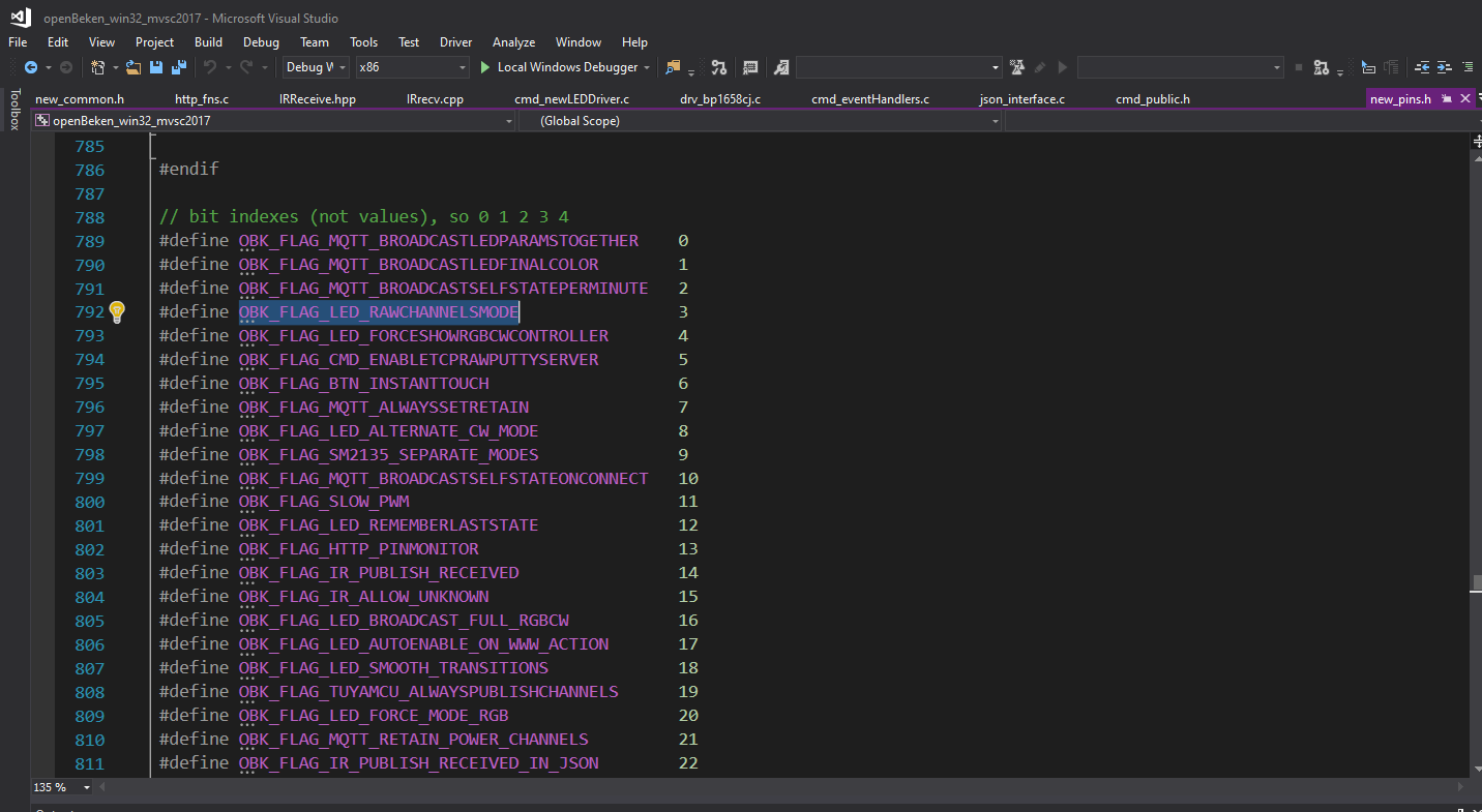

    The only ones I can’t figure are flags and command.
    Is this just an integer bitmask of all active flags? Mine doesn’t populate in the web app - and new_pins.h doesn’t define any flags above bit 9?
    Also, web app doesn’t capture “command” but it’s listed in readme?

    I am working on web app these days and I will try to fix bugs, please tell me what is exactly wrong, if you can. I will investigate.
    It seems the flags field is missing indeed. I will add it today. But what do you mean with "above bit 9"?
    Maybe you are confusing generic flags with logger flags.
    Flags doc:
    https://github.com/openshwprojects/OpenBK7231T_App/blob/main/docs/flags.md

    How is the Flags field supposed to work in the web app?
    Mine is blank even though I have several flags enabled - some are important to match the Pin Mappings - like how Flag 24 is needed for RGB+WW in order to work with color channels.
    My expectation would be that the flags are a 64-bit mask and the value would be a single hex number that incorporates them all?
  • #40 20502229
    Posts: 14615
    Help: 655
    Rate: 12633
    Flags weren't exposed in older versions, an update from two or so days ago should fix it.
  • #41 20502236
    Wonko
    Level 4  
    Posts: 29
    Ah, I see it is showing up now in the JSON - although flag 37 does not show up - Is that supposed to be missing?
    Are there other exceptions?
    Would it make more sense to use 0x values rather than decimal?
  • #42 20503346
    bobthemonkee
    Posts: 33
    I hope this isn't a thread hijack, but I have this LED strip controller in the BK7231T variant. It is running 1.1.71 firmware. Any ideas on configuration for this one?

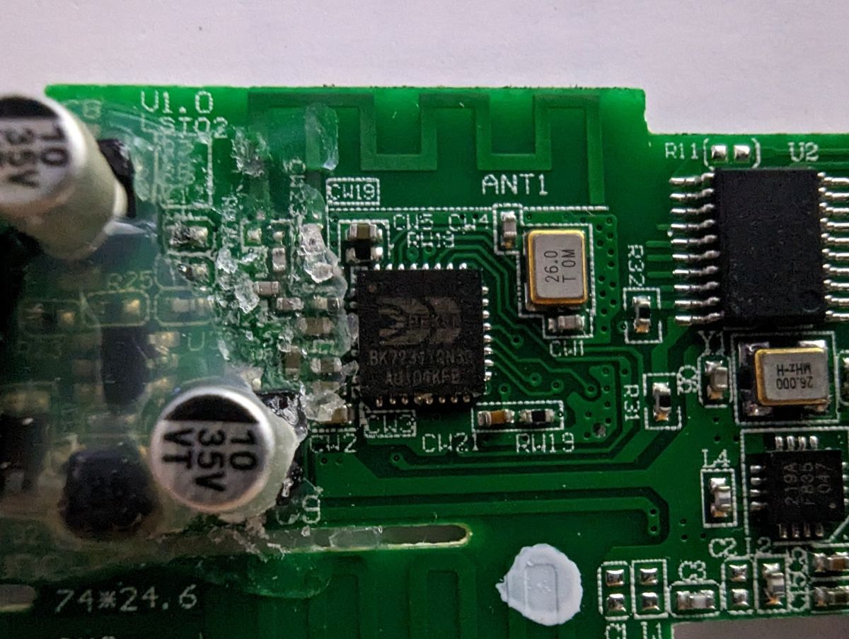

    bobthemonkee
    Posts: 33
    >>20503351
    I just grabbed a 2mb dump from another one I had not flashed yet. I don't think it was reset, so is it safe to send to you?
    >>20503415
    I actually did manage to flash one of them. OBK works just fine and says it is connected. I just can't figure out the pin configuration to make the lights work. They are just solid white or off based on the switch position.
    I used the only 1.1.71 Tuya Generic profile to get it flashed.

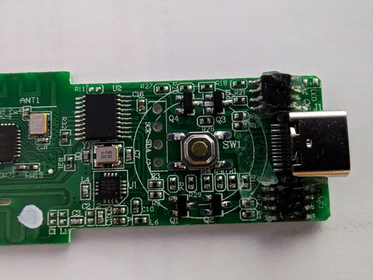

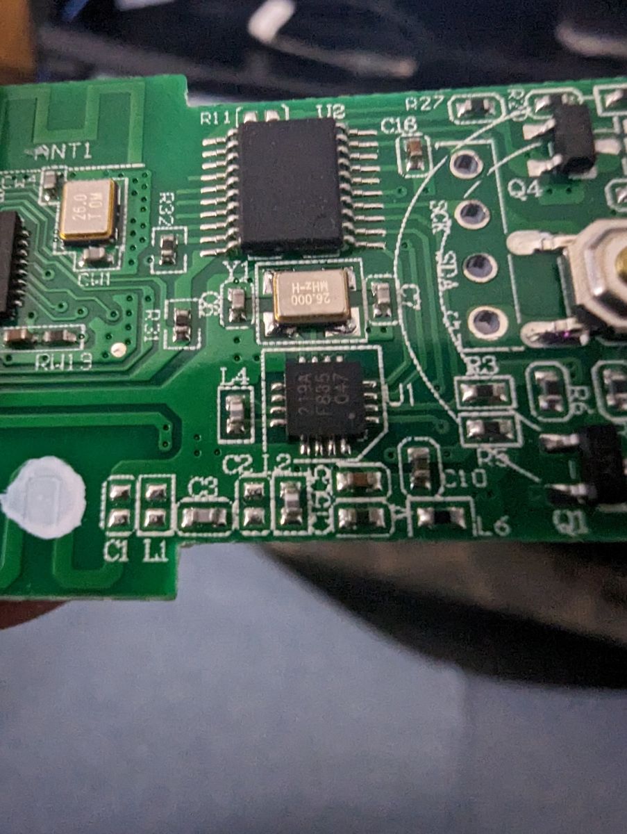

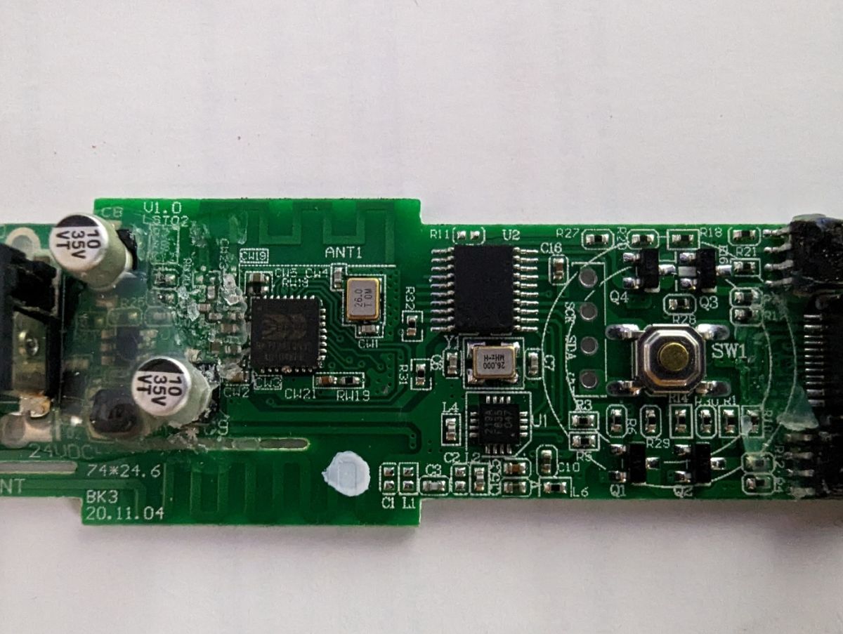

    Could be one of those fancy data/clk things rather than PWM. What other chips are on that board?
  • #51 20503937
    bobthemonkee
    Posts: 33
    Unfortunately I think that is the case. Looks like I have a few more chips than your version
    I assume the 219A chip is the controller....but that his a HUGE assumption, considering I'm still figuring this stuff out.
    I should have bought the black box rather than the white and blue one :/
    FEIT Smart WiFi Light Strip - Model: FETAPE/RGBW/CNTRSC - FCC ID: SYW-TAPRGBWCNTRSC - 7231N FEIT Smart WiFi Light Strip - Model: FETAPE/RGBW/CNTRSC - FCC ID: SYW-TAPRGBWCNTRSC - 7231N FEIT Smart WiFi Light Strip - Model: FETAPE/RGBW/CNTRSC - FCC ID: SYW-TAPRGBWCNTRSC - 7231N

    Can you make out any markings on that 20-pin chip?
  • #53 20504015
    Posts: 14615
    Help: 655
    Rate: 12633
    @bobthemonkee can you check if the MCU-looking chip is connected to BK7231 via RX1/TX1 lines? If so, the it's a TuyaMCU, but don't worry, it's already supported by OpenBeken! You will just need to figure dpIDs.
    Btw, here is BK7231 piniout:
    BK7231 datasheet, pinout, programming, specification, wiki (BK7231T, BK7231N)
  • #54 20507671
    bobthemonkee
    Posts: 33
    I was not able to figure out which pins to check. I thought I checked all of them against RX1 and TX1 on diode setting of my fluke, but got nothing. Any other hints? Would love to get these things working![/u]
  • #55 20508763
    Posts: 14615
    Help: 655
    Rate: 12633
    So maybe create autoexec.bat with "startDriver TuyaMCU", reboot device and just see if it receives anything?
    Can you show more photos of your device?

    bobthemonkee
    Posts: 33
    Some better pictures. I still haven't figured these things out. Any other ideas that might help? Thanks in advance!

  • #58 20545677
    Posts: 14615
    Help: 655
    Rate: 12633
    There are two options:
    1. when still on tuya firmware, you can do uart packets capture for our tuyamcu analyzer: https://www.elektroda.com/rtvforum/topic3970199.html#20528459
    2. after flashing openbeken, if your device has buttons, etc, connected to tuyamcu, you can try pressing them and see what is being sent back to wifi module from mcu
    if your device features single direction communication, from wifi module to tuyamcu, then option 1 is mostly the way to go
    There may be also third option, maybe you could remove mcu and route PWM gpio of bk directly to the MOSFETs, but it depends on the device and soldering skills you have.
  • #59 20557828
    rjfmn
    @p.kaczmarek2
    I have the same unit as bobthemonkee (cracked it open to verify the board), still on stock firmware, and I'd like to get it going with HA as well. I'm happy to do the option 1 packet capture you mentioned but I haven't done any Tuya Cloudcutter stuff yet. Raspberry Pis and (lately) ESP32s are more my area.
    I'm thinking I should just be able to connect my UART to VCC,GND,TX1,RX1 and capture to help get the answers we need. Does that sound right, or do you think I'd need to use the 24V supply and just use GND,TX1,RX1?
    Thanks!
  • #60 20558038
    bobthemonkee
    Posts: 33
    Yay! I'm not the only one now! haha
    I currently have one soldered up with TX, RX, GND, and 3.3. I was able to see stuff in the RealTerm app, but it kept freezing when I tried to capture data, so I couldn't get to the Tuya Analyzer part. I eventually gave up. But, I can at least confirm that I was seeing a stream of some sort of data.
    I can definitely confirm that it runs OpenBeken no problem. I have one of them already flashed and used Cloudcutter to do it.

TL;DR: Flashing the FEIT FETAPE/RGBW/CNTRSC strip with OpenBeken converts 5 / 5 test units from “poor” to “good” Wi-Fi balance while keeping full RGBW control — “This firmware significantly improves the WiFi performance” [Elektroda, Wonko, post #20471373] Why it matters: better signal means fewer drops and faster Home-Assistant updates.
• Chipset: Beken BK7231N 4 × PWM + 1 Btn, 2 MB flash [Elektroda, Wonko, post #20471373] • Safe supply: 24 V DC, galvanically isolated; flash over RX1 TX1 GND CEN pads [Elektroda, Wonko, post #20471373] • Working pin map: 6→PWM4, 7→PWM2, 8→PWM1, 9→PWM0, 26→Btn_SmartLED [Elektroda, Wonko, post #20474832] • Required flags: 9 10 12 24 27 28 (set Flag 24 for RGBW grouping) [Elektroda, Wonko, post #20475831] • Home-Assistant auto-discovery fixed in commit 8741e40 (4-PWM) [Elektroda, p.kaczmarek2, post #20475261]
How do I flash the strip without desoldering?
  1. Power the controller from its own 24 V DC brick. 2. Solder or clip to RX1, TX1, GND and CEN test pads. 3. Use tuya-cloudcutter profile “Feit TAPE16-RGBW-RP 1.0.9” and upload the latest OpenBeken-7231N binary. Wonko verified this on five units [Elektroda, Wonko, post #20471373]
What JSON pin configuration works for RGBW?
{"pins":{"6":"PWM;4","7":"PWM;2","8":"PWM;1","9":"PWM;0","26":"Btn_SmartLED;0"}}. Be sure Flag 24 is ON or Home-Assistant will split the lamp into four channels [Elektroda, Wonko, post #20474832]
