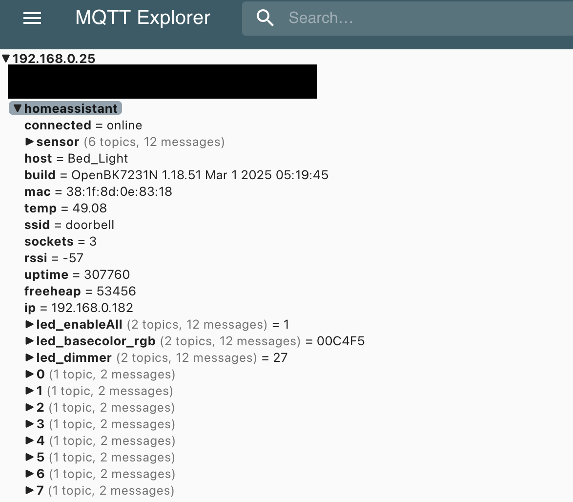

  • #96 21468053
    kadeross
    >>21462176
    Here's what MQTT explorer gives me:
    Screen of the MQTT Explorer app showing details of the connection with the homeassistant device.
  • #97 21468215
    Posts: 14615
    Help: 655
    Rate: 12632
    You have all LED topics visible, maybe you need to do Home Assistant discovery again. Maybe you did it before configuring the LED.
