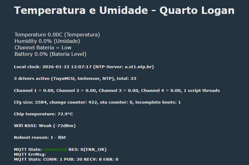

    #249 21752721
    flecom
    I've got one of these with a BK7238, flashed it with openbk and made an autoexec that looks like this:
    clearIO
    PowerSave 1
    startDriver NTP
    ntp_setServer 192.168.1.1
    // EDT-EST time zone
    alias winter_time ntp_timeZoneOfs -5
    alias summer_time ntp_timeZoneOfs -4
    winter_time
    // summertime
    alias check1 if $month>3 then summer_time
    alias check2 if $month==3&&31-$mday+$day<=6&&$day>0 then summer_time
    alias check3 if $month==3&&31-$mday+$day<=6&&$day=0&&$hour>=2 then summer_time
    // wintertime
    alias check4 if $month>10 then winter_time
    alias check5 if $month==10&&31-$mday+$day<=6&&$day>0 then winter_time
    alias check6 if $month==10&&31-$mday+$day<=6&&$day=0&&$hour>=3 then winter_time
    alias set_time backlog check1;check2;check3;check4;check5;check6
    startDriver TuyaMCU
    delay_s 2
    uartSendHex 55AA001000070101090400010026
    startDriver tmSensor
    setChannelType 1 temperature_div10
    setChannelType 2 Humidity
    setChannelType 3 ReadOnlyLowMidHigh
    setChannelLabel 3 "Batt_state"
    linkTuyaMCUOutputToChannel 3 val 3
    waitfor NTPState 1
    set_time
    // now wait for MQTT
    waitFor MQTTState 1
    // now wait for channel 1 to become non zero
    // if channel 1 is still 0, loop, wait 0.1s and check again
    again:
    delay_s 0.1
    if $CH1==0 then goto again
    publish DATA {"ROOM":"1","TEMPERATURE":$CH1,"HUMIDITY":$CH2}
    but all the data in the web ui is 0s... and the log all I see tons of this:
    Info:TuyaMCU:Consumed 20 unwanted non-header byte in Tuya MCU buffer
    Info:TuyaMCU:Skipped data (part) 00 00 00 00 00 00 00 00 00 00 00 00 00 00 00 00 00 00 00 00
    Info:TuyaMCU:Consumed 40 unwanted non-header byte in Tuya MCU buffer
    Info:TuyaMCU:Skipped data (part) 00 00 00 00 00 00 00 00 00 00 00 00 00 00 00 00 00 00 00 00 00 00 00 00 00 00 00 00 00 00 00 00 00 00 00 00 00 00 00 00
    i verified the connections between the tuyamcu and the wifi module are ok, any hints?
  • #250 21762087
    Posts: 14770
    Rate: 12913
    Don't do this:
    It looks like an attempt to avoid data publish before measurement, but it could be easier maybe, if you measure often, just save the previous measurement in flash (Set channel startup value) to -1 so the value is remembered.
    This was never required with tmSnsor I think

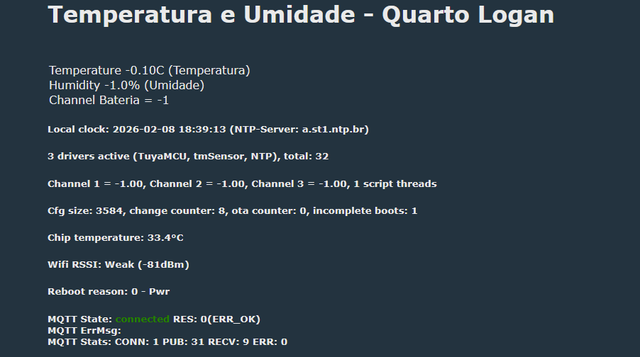

  • #251 21810847
    GoldMember
    Posts: 26
    I also bought one and it has BK7238 (T1-U-HL). Flashed it sucesfully but can't get readings. Did you manage to make it working?
  • Questions about CBU wiring, flags, and autoexec config

    1-What is the correct config for autoexec?
    2-also the flags
    3-I have to leave the mcu tx and rx connect to the CBU module?
    4-the display not sync the time
    mine is show 0 in the web, in the screen its ok (not the time)
    my acutal autoexec, I try almost all autoexec from this topic
    clearIO
    PowerSave 1
    // NTP BRAZIL
    startDriver ntp
    ntp_setServer a.st1.ntp.br
    waitFor NTPState 1
    ntp_timeZoneOfs -3:00
    // flags 2 10 19 37 51
    Flags 2251937253164036
    startDriver TuyaMCU
    delay_s 2
    //uartSendHex 55AA001000070101090400010026
    //tuyaMcu_setBaudRate 115200
    //tuyaMcu_defWiFiState 4
    linkTuyaMCUOutputToChannel 1 val 1
    setChannelLabel 1 "Temperatura"
    linkTuyaMCUOutputToChannel 2 val 2
    setChannelLabel 2 "Umidade"
    setChannelLabel 3 "Bateria"
    setChannelType 4 BatteryLevelPercent
    linkTuyaMCUOutputToChannel 4 val 4
    setChannelLabel 4 "Bateria Level"
    mqtt_broadcastItemsPerSec 20
    waitfor NTPState 1
    set_time
    waitFor MQTTState 1
    again:
    delay_s 0.1
    publish DATA {"Temperatura":$CH1,"Umidade":$CH2,"Bateria":$CH3,"Bateria Level":$CH4}
    // this is autoexec.bat, it runs at startup, you should restart after making changes
    // target to ping
    PingHost 172.16.0.1
    // interval in seconds
    PingInterval 10
    // events to run when no ping happens
    addChangeHandler noPingTime > 600 reboot
    Screenshot of dashboard showing temperature, humidity, WiFi, and MQTT stats

    Added after 4 [hours] 14 [minutes]:
    @p.kaczmarek2 @insmod @divadiow any guess on these new th08
    everything still 0 on web
    on screen the date show 0 , but the temperature and humidity its ok
  • #254 21833293
    tadeu1
    Posts: 83
    No ideia why just still like this
    Screenshot of “Temperatura e Umidade - Quarto Logan” dashboard with readings and MQTT status
