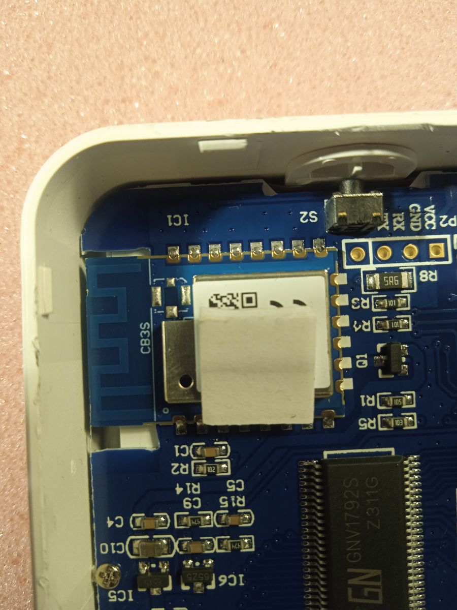

  • TH08-CBU-ATH20-V2 is a LCD calendar/clock/temperature/humidity unit with a BK7231N CBU module, BL55070 LCD driver, and ATH20 sensor.
  • U3 appears to be the Tuya MCU, while U8 with a 32.768 kHz crystal likely handles RTC and LCD/backlight control, and Q1 switches Wi‑Fi power.

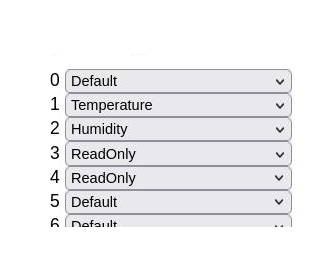

    Thank you all. It's already working, for me it works like this:
    startDriver TuyaMCU
    startDriver tmSensor
    startDriver NTP
    ntp_setServer 193.136.152.71
    ntp_timeZoneOfs 1
    setChannelType 1 temperature_div10
    setChannelType 2 Humidity
    setChannelType 3 ReadOnlyLowMidHigh
    linkTuyaMCUOutputToChannel 3 val 3
    setChannelLabel 3 BatteryLevel

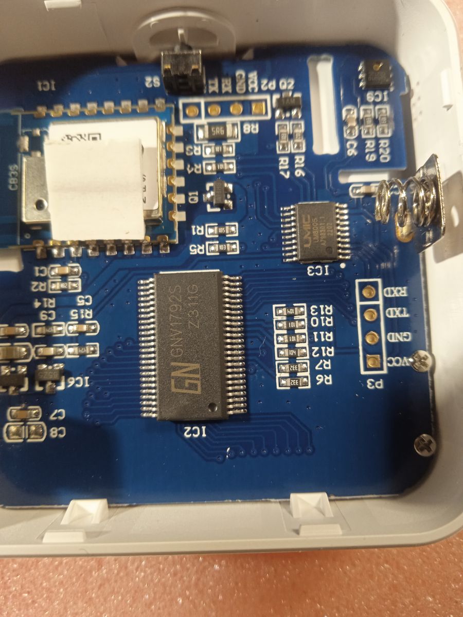

  • #185 21297666
    xeparrelik
    I've bought this device and I wanted to flash OpenBK into it, could anyone please tell me the instructions on how to flash it?
    I'm new to this and by reading the thread I'm with doubts on where to connect the wires (seems that there's few approaches).
    Thanks.
  • #186 21310308
    szabkaelektroda
    >>21074347 Hi! I also faced NTP issues. My IOT devices lives in a separated vlan and the default gateway is the ntp server and even with this setup the sensor sometimes stuck with 2070 date. At first I added the errno value of the printed error message and found out that even with wifi connected the send can return with noroutetohost errno, and the receive could stuck in eagain.
    I already actively test a patch that does a quick resend on receive failures on the first minute(like in send) and Main_IsConnectedToWiFi changed to boolean and returns tru only if the module also received ip from dhcp or has static ip configured. So far it is working good but i want to do more endurence testing. This battery operated devices has a lot of boots.
  • #187 21310983

  • #188 21311969
    szabkaelektroda
    Main_IsConnectedToWiFi should only check for WiFi connection, not NTP... you seem to have found correctly the issue, but the fix should be rather to add the NTP check somewhere, I'm not sure where yet.
    I think there is a little misunderstanding, the Main_IsConnectedToWiFi is extended to check IP existence which is in my glossary is strictly connectivity related and not NTP related.
    return g_bHasWiFiConnected>0 && (g_cfg.staticIP.localIPAddr[0] != 0 || g_currentIPString[0] != 0);
    If somebody needs the wifi status alone just use the another Main_HasWiFiConnected function.

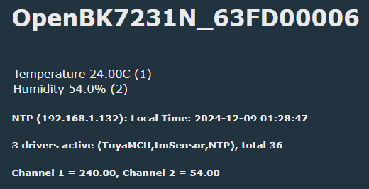

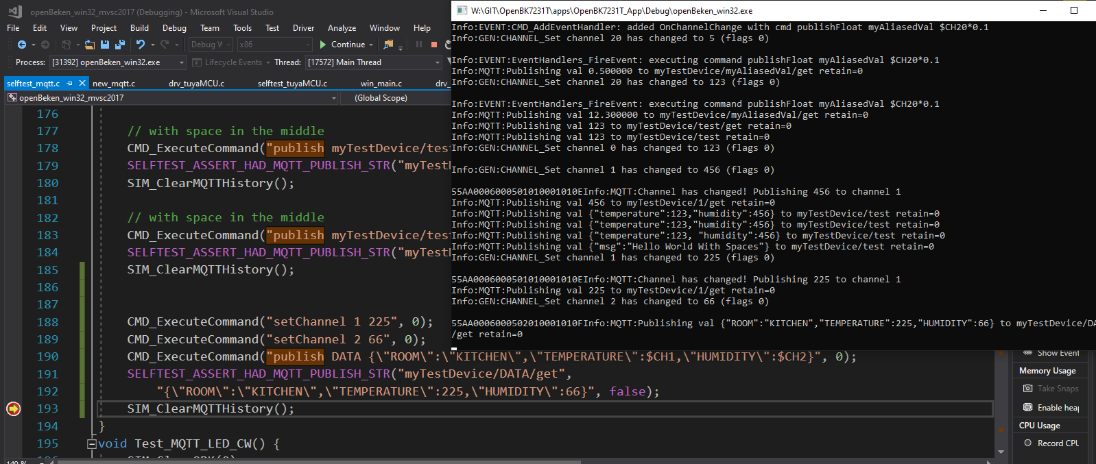

    Hi, I'm asking for advice on this module thanks to TyuaMCU, I have a problem getting the values ​​for the publish command
    The values ​​are normally displayed on the website and are sent as mqtt, but when I need to send them using publish, I get zero.
    Screenshot showing temperature and humidity data and the status of OpenBK7231N drivers.
    autoexe :
    startDriver TuyaMCU
    // TEMP $CH1
    linkTuyaMCUOutputToChannel 1 val 1 // maybe I just understand it wrong.. but now the value from TyuaMCU 1 should be connected to ch1??
    // HUM $CH2
    startDriver NTP
    ntp_timeZoneOfs 1
    ntp_setServer 192.168.1.132 // local NTP server for speed and loop prevention in case of internet outage
    // now wait for NTP
    waitFor NTPState 1
    // now wait for MQTT
    waitFor MQTTState 1
    delay_s 1
    publish DATA {"ROOM":"KITCHEN","TEMPERATURE":$CH1,"HUMIDITY":$CH2} // both are zero .. I also tried $1
    Thank you in advance for the information and knowledge. =) Tom
  • #190 21340135
    Posts: 14622
    Help: 655
    Rate: 12639
    Your Publish syntax is correct.
    Code snippet in Visual Studio testing JSON and MQTT syntax.
    You are getting 0 most likely because you are sending data BEFORE TuyaMCU sends it to OBK.
    I'd try something like that:
    REST OF YOUR OLD SCRIPT HERE....
    waitFor MQTTState 1
    // now wait for channel 1 to become non zero
    // if channel 1 is still 0, loop, wait 0.1s and check again
    again:
    delay_s 0.1
    if $CH1==0 then goto again
    The following suggestion was tested by self tests:
    - publish command JSON syntax test:
    https://github.com/openshwprojects/OpenBK7231...mmit/6940b06cfa9df8c1862e4aee5543bf4abc471e4d
    - waiting for channel 1 to become non-zero self test:
    https://github.com/openshwprojects/OpenBK7231...mmit/a0ab7c17e4632601f40e016e3afc2e93e799ce20
  • #191 21341044
    PC-maniak
    Posts: 6
    >>21340135
    WOOOW ! Thank you, that was it.
  • #192 21356710

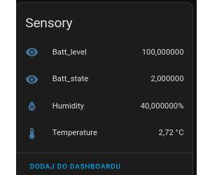

    GAAD
    Posts: 289
    Rate: 19

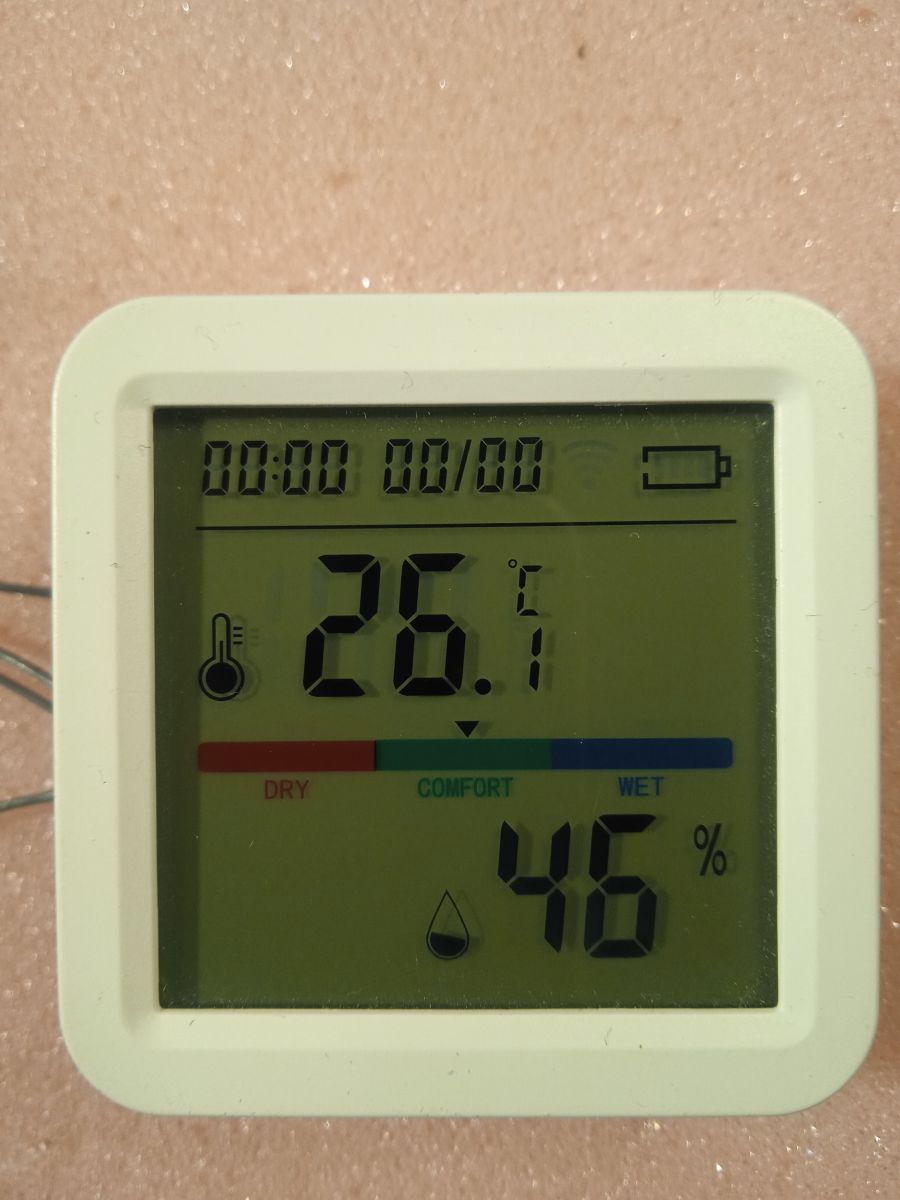

    I think I have another version of this sensor TH08C:
    Electronic thermometer and hygrometer with LCD display, showing a temperature of 26.1°C and humidity of 46%. Electronic thermometer and hygrometer display showing temperature 22.5°C and humidity 52%. Circuit board inside a sensor with visible integrated circuits and connectors. Close-up of the interior of an electronic device showing a PCB with electronic components. Close-up of the interior of an electronic device with visible components and markings.
    I am attaching the read content.
    Is there a chance to reprogram it and free myself from Tuya?
    • readResult_BK7231N_QIO_TH08C_2024-19-12-22-33-41.bin (2 MB) You must be logged in to download this attachment.

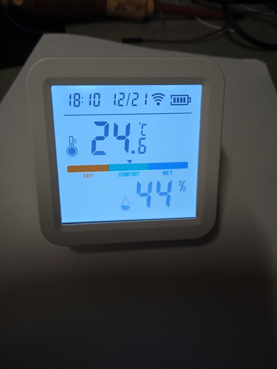

    Hello Im new in OpenBK and with your Help it was Easy to Flash the TH08. But one Problem i found. I Have the 12H AM/PM Version of the TH08. Default is temperature in F.
    Anyone know how to send the command to switch the display to C Temperature?
    The Mqtt data is fine in C but the display show F Temperature.
    yes. same process as with TH08 and any other Beken device with TuyaMCU. Your firmware is patched so no Cloudcutter - you'll have to UART flash.
    To start you off here is the dpID mapping for the firmware you posted
  • #195 21357267
    Posts: 14622
    Help: 655
    Rate: 12639
    https://www.elektroda.com/rtvforum/topic4038151.html
    Search for TH06 there:
    @GAAD as long as the dpIDs didn't change, it should be very easy, like with similiar modules. tmSensor driver should work. Just remember the basics that have been spoken on forum many time, like that you need to disconnect TuyaMCU for the time of the flashing because it's using the same UART port, etc, etc.

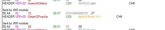

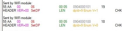

    @smoeller95s you need to know the dpID of temperature format enumeration. You can figure it in many ways:
    - you can capture traffic on original Tuya firmware with https://www.elektroda.com/rtvforum/topic3970199.html
    - you can get dpIDs from tuya developer API https://www.elektroda.com/rtvforum/topic4021129.html
    - you can just search the forum, maybe someone already has found out this dp?
    Maybe it could be also possible to just set temperature to C in Tuya App before flashing and the MCU just might remember that.
    EDIT:
    divadiow wrote:
    Thank you for sharing, that's what he asked for. So the temperature unit selection dpID on this device is 9, it's an enumeration with two possible options - C or F.

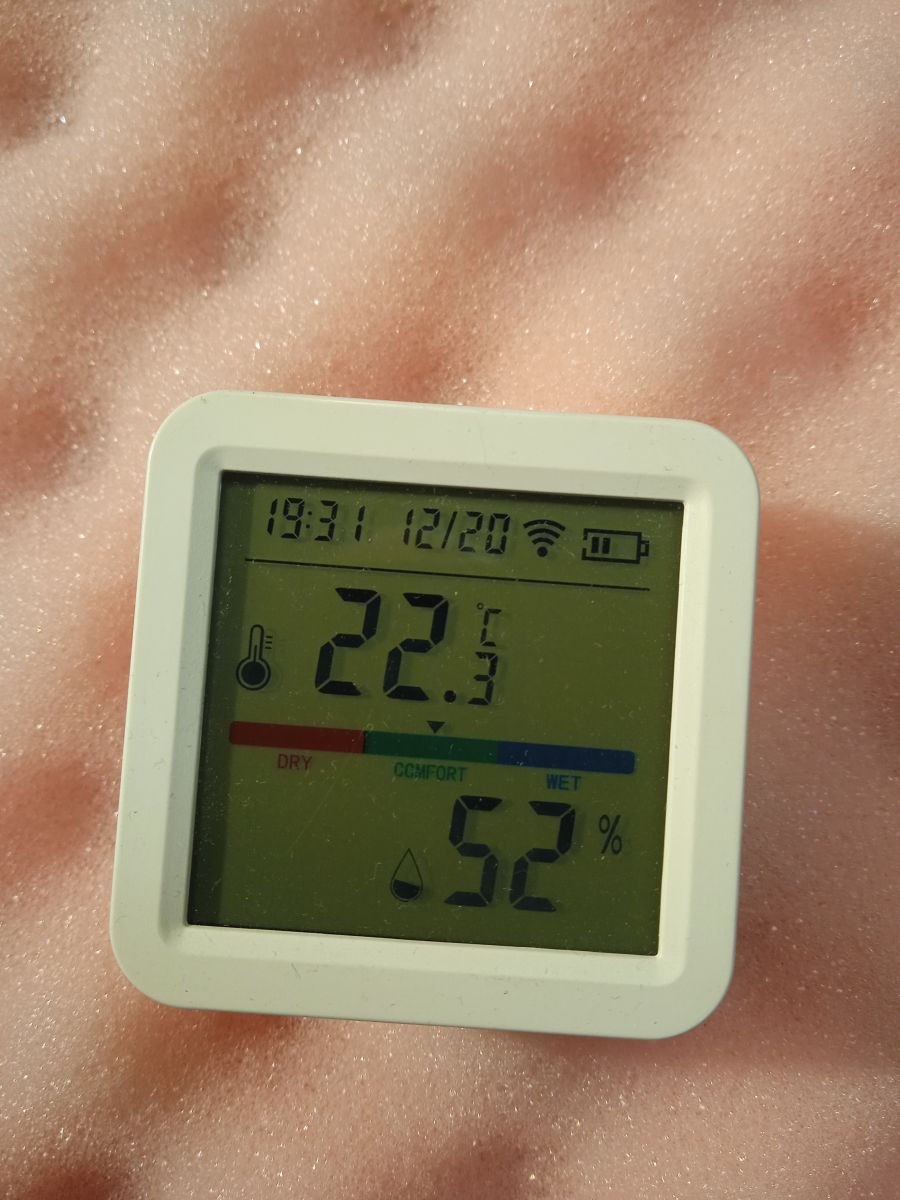

  • #196 21357478
    GAAD
    Posts: 289
    Rate: 19

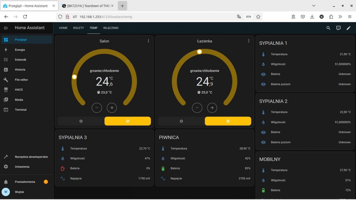

    Maybe in this module UART is probably free? I uploaded OBK without interrupting paths without any problem at 921600 baudrate, Rx and Tx and Vcc directly on CB3S. Now OBK works for me, on display outdated time, temperature and humidity but OBK does not see it. I found autoexec files but did not find dpio configuration.
    edit:

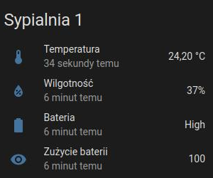

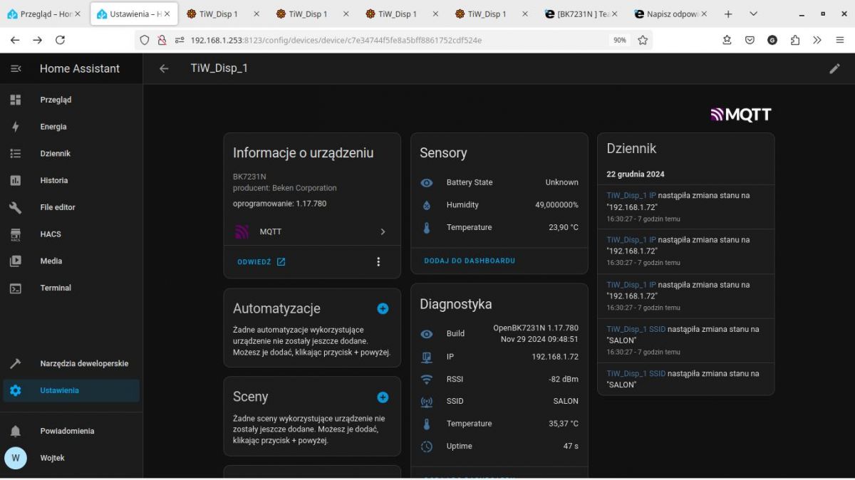

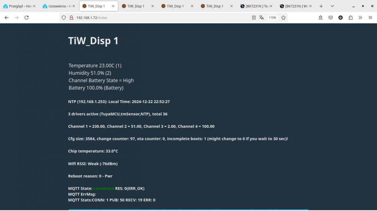

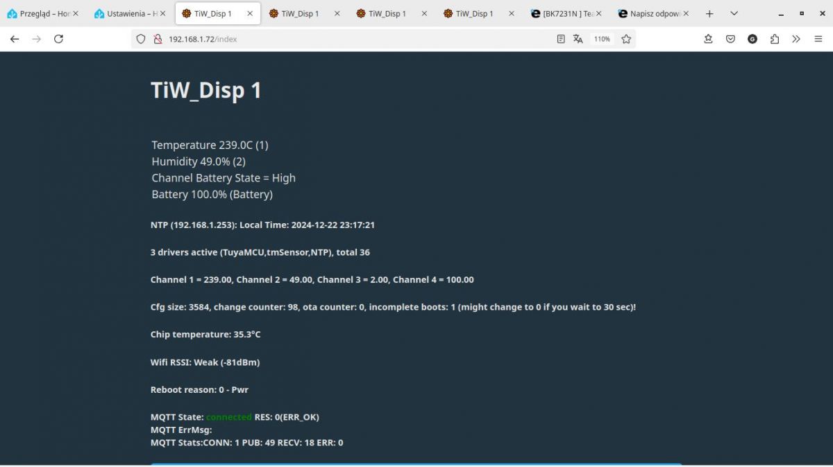

    It worked, but only for HA to show these readings My autoexec (NTP server in the local network)
    Digital display showing temperature and humidity.
    startDriver NTP
    ntp_setServer 192.168.1.253
    waitFor NTPState 1
    startDriver TuyaMCU
    ntp_timeZoneOfs 1

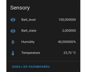

    setChannelLabel 3 "Battery Level"
    mqtt_broadcastItemsPerSec 20
    waitFor MQTTState 1
    again:
    delay_s 0.1
    publish DATA {"ROOM":"SYPIALNIA 1","TEMPERATURE":$CH1,"HUMIDITY":$CH2}
    He reported it, but can it be improved?
    Interface displaying battery level, humidity, and temperature.
    next autoexec temperature not divided by 10
    startDriver NTP
    waitFor NTPState 1
    startDriver TuyaMCU
    ntp_timeZoneOfs 1
    setChannelLabel 3 "Battery Level State"
    setChannelLabel 4 "Battery Level"
    linkTuyaMCUOutputToChannel 4 val 4
    setChannelType 4 ReadOnlyLowMidHigh
    waitFor MQTTState 1
    again:
    delay_s 0.1

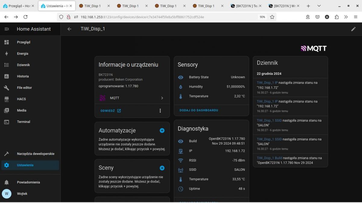

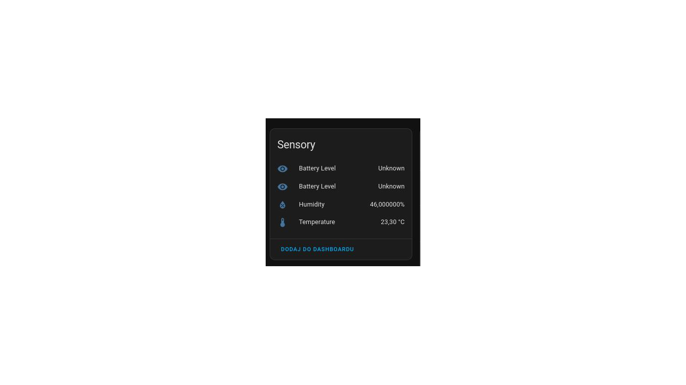

    It's almost perfect.
    How do I get rid of zeros after the decimal point in humidity?
    Why doesn't it send channels 3 and 4 with battery status even though I added them to autoconfig?
    When trying it sometimes sent, now there's nothing in HA even though it's displayed on the page.
    Home Assistant user interface displaying temperature, humidity, and battery level data for various rooms.

    I wrote that I do not have to divide the temperature by 10, i.e.
    "setChannelType 1 temperature"
    Theoretically it worked but after changing the battery in the HA instead of 20 degrees it is 2.0 degrees.
    Autoexec:
    startDriver NTP
    waitFor NTPState 1
    ntp_timeZoneOfs 1
    startDriver TuyaMCU
    //setChannelType 1 temperature
    setChannelLabel 3 "Battery State"
    setChannelLabel 4 "Battery"
    setChannelType 4 BatteryLevelPercent
    waitFor MQTTState 1
    again:y
    delay_s 0.1
    publish DATA {"Temperature":$CH1,"Humidity":$CH2,"Battery State":$CH3,"Battery Level":$CH4}
    On the OBK web page the temperature is correct but in HA divided by 10
    Configuration screen of TiW_Disp 1 device showing temperature, humidity, and battery status information. .
    Home Assistant dashboard displaying device data. .
    Despite sending two battery statuses, this data is missing from the HA.
    If I change the channel configuration to:
    it looks like this:
    Web page with information about the TiW_Disp 1 device, showing data on temperature, humidity, battery status, and other technical details. .
    but in HA:
    Screenshot of the Home Assistant interface displaying information about the TiW_Disp_1 device. .
    Sometimes, on the other hand, 230 degrees also appears in HA. I have completely lost my mind now.

    Info:TuyaMCU:Received: 55 AA 00 02 00 00 01
    Info:TuyaMCU:ProcessIncoming[v=0]: cmd 2 (MCUconf) len 7
    Info:TuyaMCU:ProcessIncoming: TUYA_CMD_MCU_CONF, TODO!
    Info:TuyaMCU:Received: 55 AA 00 05 00 05 09 04 00 01 00 17
    Info:TuyaMCU:ProcessIncoming[v=0]: cmd 5 (WiFiSelect) len 12
    Info:TuyaMCU:V0_ParseRealTimeWithRecordStorage: processing id 9, dataType 4-enum and 1 data bytes
    Info:TuyaMCU:V0_ParseRealTimeWithRecordStorage: byte 0

    Info:GEN:CHANNEL_Set channel 1 has changed to 238 (flags 0)
    Info:MQTT:Channel has changed! Publishing 238.000000 to channel 1
    Info:MQTT:Publishing val 238.000000 to obk689EE87D/1/get retain=0
    Info:MQTT:MQTT client in mqtt_incoming_publish_cb topic obk689EE87D/1/get
    Info:MQTT:Publishing val {"Temperature":238,"Humidity":0,"Battery to obk689EE87D/DATA/get retain=0
    Info:MQTT:MQTT client in mqtt_incoming_publish_cb topic obk689EE87D/DATA/get
    Info:MAIN:Time 46, idle 188008/s, free 58304, MQTT 1(1), bWifi 1, secondsWithNoPing -1, socks 2/38
    Info:MQTT:Publishing val TiW_Disp_1 to obk689EE87D/host retain=0
    Info:MQTT:Publishing val OpenBK7231N 1.17.780 Nov 29 2024 09:48:51 to obk689EE87D/build retain=0
    Info:MQTT:Publishing val d8:d6:68:9e:e8:7d to obk689EE87D/mac retain=0
    Info:MQTT:Publishing val 35.37 to obk689EE87D/temp retain=0
    Info:MQTT:Publishing val SALON to obk689EE87D/ssid retain=0
    Info:MQTT:Publishing val 1734909423 to obk689EE87D/datetime retain=0
    Info:MQTT:Publishing val 2 to obk689EE87D/sockets retain=0
    Info:MQTT:Publishing val -82 to obk689EE87D/rssi retain=0
    Info:MQTT:Publishing val 47 to obk689EE87D/uptime retain=0
    Info:MQTT:Publishing val 58016 to obk689EE87D/freeheap retain=0
    Info:MQTT:Publishing val 192.168.1.72 to obk689EE87D/ip retain=0

    I now do a reboot after every configuration change previously I thought that if I pressed "Save, Run file as script thread" it would automatically start it but in this case I don't think this is the case hence the false success. From the logs it looks like only 3 channels are being sent and the configured 4. HA still "can't see" both regarding the battery.
    Why the errors in the logs for the Tuya MCU? Maybe this version negotiates commas?
    When I press the button on the sensor to turn on the display backlight, zero values of the measurements are sent to the HA.
    Is there any chance to fully support this sensor and run more channels with minimum and maximum value settings and alarms?
  • #200 21359724
    smoeller95s
    To change from F to C i try the command "tuyaMcu_sendState 9 4 0" This not work.
    I Capture data, the Tuya Firmware send ObtainDPcache the sendState command send SetDP.
    Is there any other command to send the Data?
    Screenshot showing data related to the SetDP command sent by a WiFi module. Screenshot showing data communication with the Tuya WiFi module, including ObtainDPcache and QueryInitStatus commands.

    Posts: 209
    Help: 17
    Rate: 42
    Error:CMD:cmd again:y NOT found (args )
    again:y <--- delete y
    delay_s 0.1
    Try sending the command immediately after pressing the top button so that the device wakes up and can process it.

  • #203 21363871
    smoeller95s
    >>21359724
    To solve the C F Display Problem i add
    delay_s 2
    uartSendHex 55AA001000070101090400010026
    to the autoexec.bat
    Now this works fine.

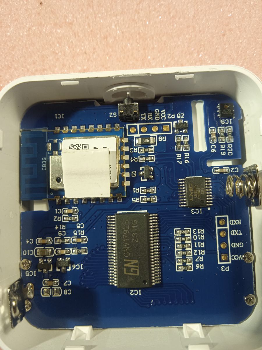

  • #204 21377331
    stefan94
    >>21356710
    Seeing the photos I think I have exactly the same device.
    But flashing directly to CB3S doesn’t work. Already flashed other devices with my setup. Power source should be reliable.
    SMD soldering isn’t one of my skills. So I have to wait for a friend.
    Is there maybe another way to keep the UM8005 quiet?
  • #205 21377445
    Posts: 14622
    Help: 655
    Rate: 12639
    Cut the traces or try to find reset pin of UM8005.

    There are two problems with me:
    1. for the channel setting temperature_div10 the system behaves as if the MCU divided the value by 10 and the OBK by another 10 i.e. total by 100 and instead of 22 degrees I have 2.2 degrees. If at runtime I change the channel in OBK to temperature without dividing by 10 it displays correctly but until restart because at restart autoexec reloads and I have divided by 100.
    2 The second problem is that I don't know how to OBK set the decimal places so that the temperature is with a precision of two and the humidity without commas.
  • #207 21377579
    Posts: 14622
    Help: 655
    Rate: 12639
    1 This is because you have mixed up the flags.
    https://github.com/openshwprojects/OpenBK7231T_App/blob/main/docs/flags.md
    It's all about the flag:
    [MQTT] Apply channel type multiplier on (if any) on channel value before publishing it
    If you do the HASS Discovery without this flag and then include it, you will get two divisions, and from 22.2 degrees (in Tuya 222) you will get 2.22
    Generally the temperature in the OBK channels should be without splitting, the same as from the MCU goes, only the channel type visually does the splitting.
    Another option is that you have unnecessarily added scaling in linkTuyaMCUOutputToChannel.... what whole autoexec.bat do you have?
    2 You need to be more specific, what do you have in mind?
  • #208 21377603
    GAAD
    Posts: 289

    The entire autoexec looks like this:
    clearIO
    startDriver NTP
    waitFor NTPState 1
    ntp_timeZoneOfs 1
    startDriver TuyaMCU
    setChannelType 3 ReadOnly //LowMidHigh
    setChannelLabel 3 "Batt_state"
    setChannelLabel 4 "Batt_level"
    After a reboot on OBK:
    Temperature 24.70C (1)
    Humidity 40.0% (2)
    Channel Batt_state = 2
    Channel Batt_level = 100
    NTP (192.168.1.253): Local Time: 2025-01-05 00:54:39
    3 drivers active (TuyaMCU,tmSensor,NTP), total 36
    Channel 1 = 247.00, Channel 2 = 40.00, Channel 3 = 2.00, Channel 4 = 100.00
    So correct but in HA:
    Screenshot of the Sensory panel displaying values in Home Assistant. .
    If I now change via web in the config tab the channel to temperature without dividing by 10 without rebooting
    Screenshot of a dropdown menu with channel settings.
    then on web OBK:
    Temperature 237.0C (1)
    Humidity 40.0% (2)
    NTP (192.168.1.253): Local Time: 2025-01-05 01:22:46
    for this in HA:
    Screenshot displaying sensor values. .
    Is there an option analogous to ESP with this syntax:
    sensor:
      - platform: tuya
        device_class: "temperature"
        sensor_datapoint: 3
        unit_of_measurement: "°C"
        accuracy_decimals: 1
        filters:
          - multiply: 0.1
    The point is also that in HA there should not be those zeros after the decimals so that I can set the temperature to have 2 decimal places and the humidity only as a total, the battery percentages also as a total.
    In addition, when I press the highlight button, zero values are automatically sent to the HA, which clutters up the statistics a bit. Maybe OBK should save these measurements somewhere?
    I didn't write this autoexec it's more of a clumsy attempt to edit the ready-made one from this thread.
  • #209 21377733

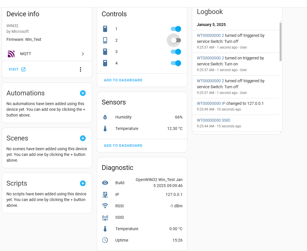

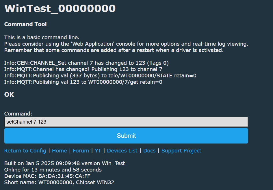

    Posts: 14622
    Help: 655
    Rate: 12639

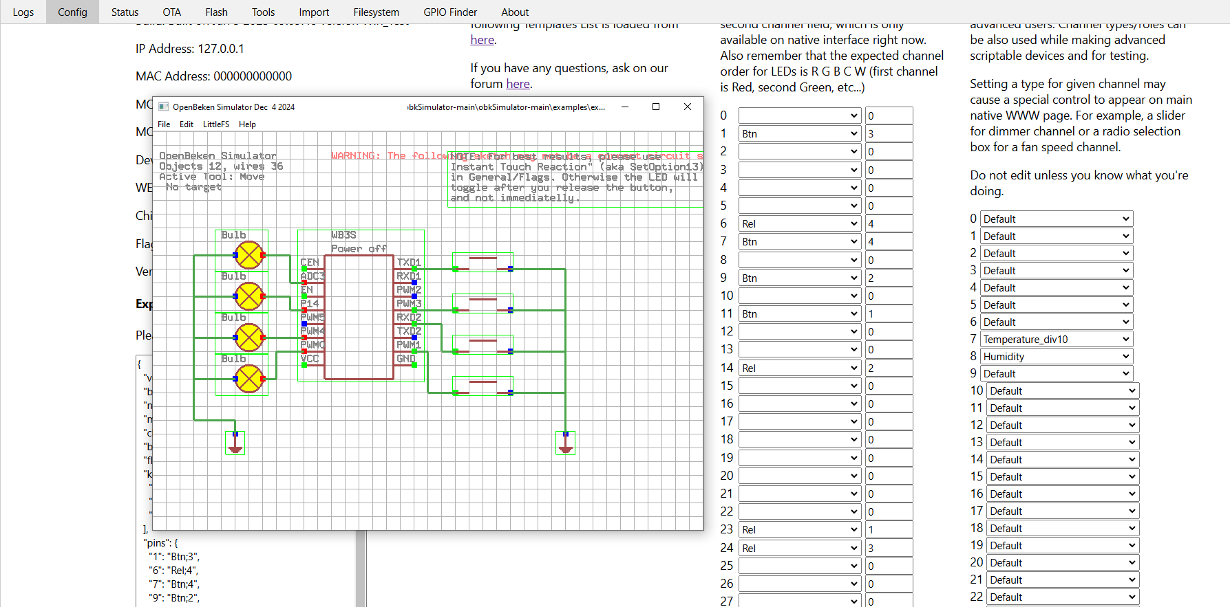

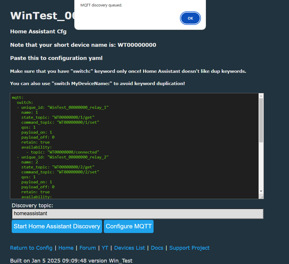

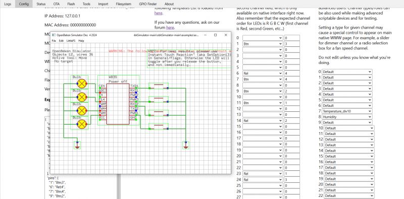

    Something must be wrong. Are you using our Home Assistant Discovery?
    https://www.youtube.com/watch?v=pkcspey25V4
    Until I ran the simulator and checked:
    Screenshot of OpenBeken simulator with an electrical circuit. .
    Screenshot of the WinTest_00000000 command tool with a command field. .
    Screenshot of Home Assistant configuration for the WinTest_00000000 device using MQTT. .
    And it works:
    Home Assistant interface displaying device information and logbook. .
    Or are you adding the device manually, via configuration.yaml? If so then the rounding is on your side.
    You could also give your own yaml on the OBK side to Discovery yourself, but this should not be necessary for such a simple device.
    If you want to remember previous measurements, then setStartValue 1 -1 where 1 is the channel number of the given channel to remember.
  • #210 21378288
    GAAD
    Posts: 289
    Rate: 19
    Thank you for your help.
    The temperature and humidity are now correct.
    I unchecked as you wrote
    Flag 33 - [MQTT] Apply channel type multiplier on (if any) on channel value before publishing it
    I don't know why they were on in both thermostats.
    Current autoexec:
    clearIO
    PowerSave 1
    startDriver NTP
    waitFor NTPState 1
    ntp_timeZoneOfs 1
    startDriver TuyaMCU
    // Flags 134743044
    //setChannelType 4 BatteryLevelPercent
    User interface showing environmental parameters and battery status for Bedroom 1 .
    And everything reads perfectly, well almost, because the channel with the battery percentage if I set it to
    "BatteryLevelPercent" it displays the percentages nicely on OBK but does not send to HA
    if I set it to "readonly" it only sends without percentages, but this is not a problem.
    Unfortunately I also had to deselect sending flags because it was making a total mess of flags above 30.
    So it works fine thank you for your help.
