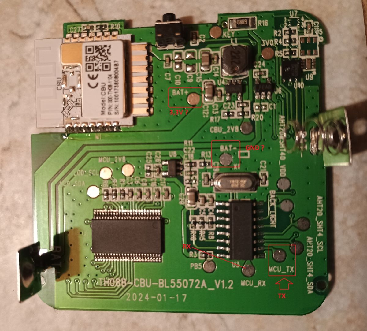

[BK7231N ] Teardown of TH08 LCD Calendar/clock/temperature/humidity, 3xAAA battery, backlight
morgan_flint 43893 254

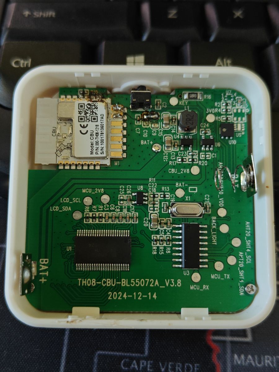

  • TH08-CBU-ATH20-V2 is a LCD calendar/clock/temperature/humidity unit with a BK7231N CBU module, BL55070 LCD driver, and ATH20 sensor.
  • U3 appears to be the Tuya MCU, while U8 with a 32.768 kHz crystal likely handles RTC and LCD/backlight control, and Q1 switches Wi‑Fi power.
  • It runs from 3xAAA cells at 4.5V and was bought for 4.49€ as a Choice offer.
  • The Tuya app shows a 1 hour update interval, and pairing can fail because the device connects only briefly between updates.

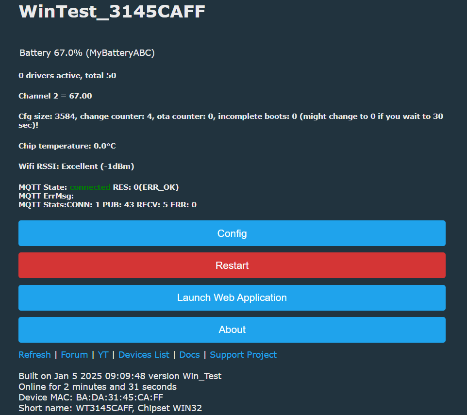

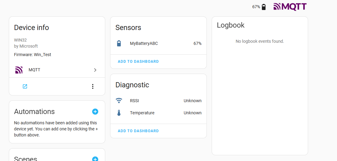

    What sending of flags, what is it? Maybe there is something to correct.
    BatteryLevelPercent I will check in the Simulator right away and if there is seriously a bug I will fix it and upload the Release. Many people just do their Yaml because then there is 100% control over everything
    Ready channel settings - i.e. for the dpID of this device? My TH06 only offered humidity and temperature, no alarms, so I had no way to check that
    Added after 24 [minutes]:
    @GAAD added:
    setChannelType 2 BatteryLevelPercent
    setChannelLabel 2 MyBatteryABC
    WinTest_3145CAFF diagnostic screen showing battery level at 67%, channel info, and MQTT status. .
    User interface of an application with device information and sensor status .
    Posted at:
    https://github.com/openshwprojects/OpenBK7231...mmit/3a1c3e9bbf6105e43d16653139a321a860de5207
    What is needed next? What else is missing?

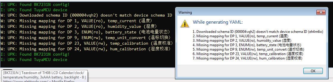

    It would be nice to complete:
    9 "Unit convert", this has already been tackled by colleague @smoeller95s
    10 "Set maxtemp",
    11 "Set minitemp",
    12 "Set maxhum",
    13 "Set minihum",
    14 "Temp alarm",
    15 "Humidity alarm",
    17 "Temperature report",
    18 "Humidity report",
    19 "Temp sensitivity",
    This would give the full functionality of the device and the convenience of configuration and, after all, we are reworking these devices not to lose but to gain. In most threads it is the case that if it works for someone, they write the rest either in OBK or in HA and no longer share it.

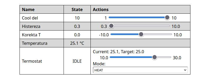

    Do we stand a chance of something like this for example:
        visual:
          min_temperature: 10 °C
          max_temperature: 30 °C
          temperature_step: 0.1 °C
    switch:
      - platform: tuya
        icon: mdi:power
        switch_datapoint: 1
        internal: True
    sensor:
      - platform: tuya
        device_class: "temperature"
        sensor_datapoint: 3
        unit_of_measurement: "°C"
        accuracy_decimals: 1
        filters:
          - multiply: 0.1
    number:
    - platform: "tuya"
      number_datapoint: 101
      min_value: 0.3
      max_value: 10.0
      step: 0.1
      multiply: 10
    - platform: "tuya"
      number_datapoint: 102
      min_value: 1
      max_value: 10
      step: 1
    - platform: "tuya"
      number_datapoint: 103
      min_value: -10
      max_value: 10
      step: 0.1
      multiply: 10
    User interface with thermostat settings .
    I know it takes more time in ESP it's not a web selector and probably autoexec won't solve the problem but maybe there are parameters for channels that can be set like range from to, divide by 10?
    Maybe it would be better to make one type for channels with data, e.g. temperature and as another option multiplier?
    With the development of the software, there will be more and more functions and options, so maybe it would be possible to sort this list alphabetically?
    You would certainly have to make a LowAlarm/HighAlarm channel for the alarm channels.

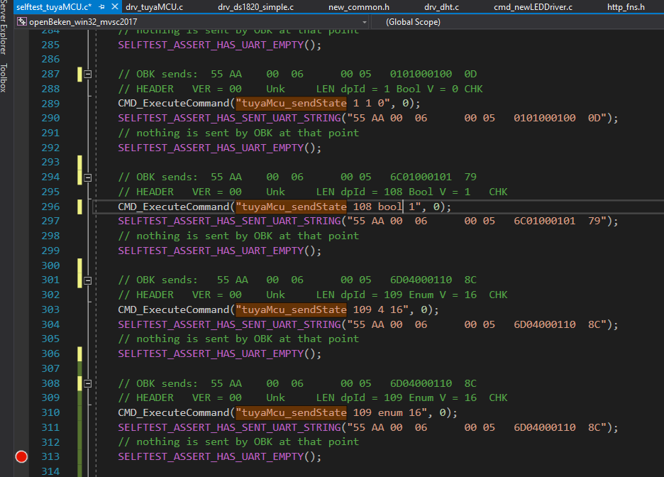

    You asked about flags.
    The problem with sending flags is quite troublesome and I have read about it already with blinds.
    When I send in the autoexec setting the flags for example.
    "Flags 134743044"
    then the flags should turn on: 2,10,19,27,43,47
    but, unfortunately, above the 30th one, completely different flags are switched on.
    With roller shutters it is similar - I send flags and they move and other flags are switched on, most often button locking, as my colleagues wrote about in threads about roller shutters.
    It looks as if one of the higher flags is not included in the counting/recounting from bin to hex because I think that is how it is done and then the shift occurs but as I wrote I am not a programmer, it is just my thoughts.
    I have checked on WBR1 that the 31st flag is the last one to change the value of the flags, if you select all the flags from 1-30 there are enough digits, adding 31 causes overflow.

    I'm working on the flags problem, but sprintf/sscanf on MCU is different than on Win32 simulator and I'm a bit stuck:
    https://github.com/openshwprojects/OpenBK7231T_App/pull/1494

    I have had no such problems, and have even recently operated an Atorch advanced meter in TuyaMCU:
    Advanced energy meter/thermostat with LCD Atorch S1TW-FR - cloudless operation .
    But that may be because the device in question here is a battery-powered device....
    I read somewhere that someone succeeded as he added:
    delay_s 0.5
    before sending the initial state.
    And yes you would have to look up how in the original firmware this is sent:
    TuyaMCU analyser - UART packet decoder for Tuya devices - dpID detector .
    You can also use tuyaMcu_sendState to send a packet directly.
    Here is the command documentation:
    Instead of using setChannel then try while the device is running, live use tuyaMcu_sendState from the documentation to set the dpID (here 10) to a value of 250, complete its type itself, here you have a screenshot of the self-tests so that there is no doubt that it works and sends the packet:
    Screenshot of source code inside an editor, displaying tuyaMcu_sendState commands and test results. .
    Maybe it also needs to be sent via dpCache.
    The battery-powered TuyaMCU devices also have a so-called dpCache. In this case, this device queries the WiFi module itself at startup for these values:

  • #227 21599220
    blacksun2
    Posts: 59
    I'm new to openBeken.
    I bought this temperature and humidity sensor at AliExpress:
    I can't find the correct pins to flash OpenBeken.
    Are the marked pins correct: for 3.3V, GND, TX, and RX?
    Where is the pin for CEN?
    Thank you.
  • #228 21599227
    DeDaMrAz
    Level 22  
    Posts: 604
    Help: 34
    Rate: 129
    blacksun2 wrote:
    I can't seem to find the correct pins to flash OpenBeken.
    Those are for the TuyaMCU most likely, You have CBU module so use this for pinout and reference - https://images.tuyacn.com/goat/pdf/01J6RB48RJ...er%20Platform_Tuya%20Developer%20Platform.pdf
    We have a flasher tool that has read flash/backup option, it is important that you backup CBU module for reference and whatever need may be.
    Search the forum for TuyaMCU driver and how to use it after you have flashed the module. I also think this device was done before so do some searching as well before we can move on with config and the rest.
  • #229 21599265
    blacksun2
    Posts: 59
    Sorry for the stupid question, but what is "TuyaMCU"?
    Regarding CBU, do I have to use the PINs at CBU-Board? Are there no contact-Point which I can use on the board? I am asking because of avoiding soldering.
  • #230 21599298
    DeDaMrAz
    Level 22  
    Posts: 604
    Help: 34
    Rate: 129
    there is no stupid questions only stupid answers :)
    TuyaMCu is the other chip on the board near which you've fount Rx and Tx pads, it is used for communicating with the sensor and LCD and only uses CBU module for WiFi communication via that UART (Rx and TX) no way for me to verify and the picture is not revealing much - just from experience.
    We are not touching that chip, only CBU module, so you may try to flash the device via those pads but be prepared for interuptions form TuyaMCU and being unable to flash it because of it.
  • #231 21604667

  • #232 21622917
    bogdanelhh
    Level 4  
    Posts: 8
    Hello, I flashed this bad boy
    PCB of a device with CBU module and labeled pads and electronic components.
    By hooking to cen, rx tx gnd and 3v3. To have it programmable I had to strip 3v3 below right side of push button between the two free pads. I also cut the rx tx traces on the back and resoldered them after flashing.
    Now the only issue I have is that it's not reporting to homeassistant, and that's because I suspect that tuyamcu shuts down cbu before he manages to connect or anything.
    Is there a way to increase the time cbu stays on? or even keep it on always and enable deepsleep?

    Are Channel 4, 14 and 15 original dp_ids from Tuya?
    How do you get them?
    I am asking because at https://iot.tuya.com, for my TH08b is only shown
    "code": "temp_current",
    "dp_id": 1,
    "code": "humidity_value",
    "dp_id": 2,
    "code": "battery_state",
    "dp_id": 3,
    "code": "temp_unit_convert",
    "dp_id": 9,
    "code": "temp_calibration",
    "dp_id": 23,
    "code": "hum_calibration",
    "dp_id": 24,
    Another question:
    How can I change time-format (12h AM-PM or 24h)?
  • #236 21624747
    how did you get these? usually you link a developer account with the Tuya app, pair device, then go into API explorer in dev portal to get dpID info. If you have factory fw dump or the Tuya config file downloaded I could check with that.
  • #237 21625533
    blacksun2
    Posts: 59
    That's my situation too. That's exactly how I did it.
    If you were thinking about the ltchiptool, it also only says that there are only these dp_IDs:
    Screenshot of terminal and warning dialog showing missing YAML data point mappings.
    Therefore, the question to GAAD was where he got the other dp_IDs from

    Posts: 5065
    Help: 438
    Rate: 893
    yes, but this bit means it's matched it to the wrong schema
    Error: schema ID (000004vqh2) does not match device schema ID (eh4m6o)
  • #239 21625542
    blacksun2
    Posts: 59
    I know.
    Because you have other oppotunities, I attached the backuped Firmware tool.
