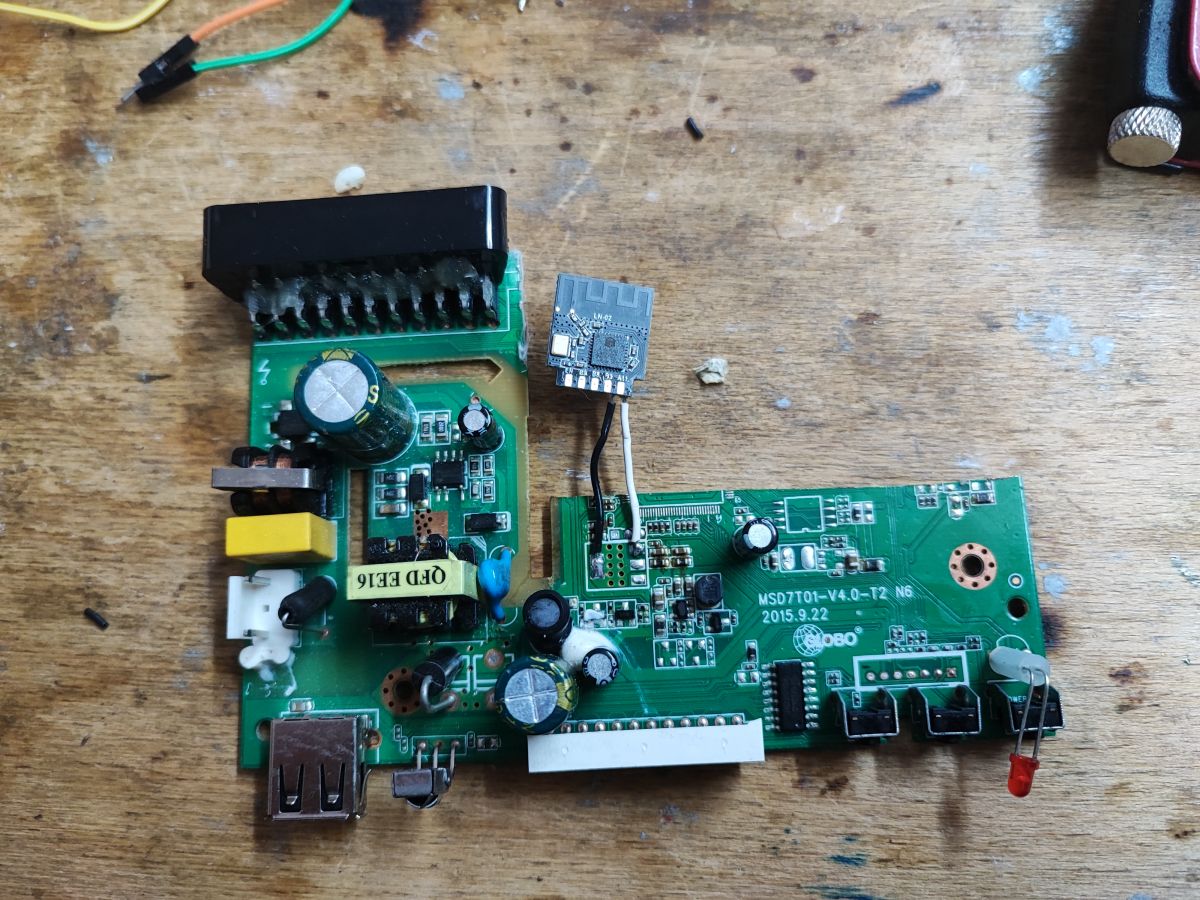

How to flash LN882H with open source Tasmota/Esphome style firmware - backup procedure included
p.kaczmarek2 69324 297
  • LN882H modules can be flashed over UART with open-source Tasmota/Esphome-style firmware to free cloud-controlled devices and integrate them with Home Assistant.
  • Wire module TX, RX, GND, 3V3, and BOOT/GPIOA9 to ground, and keep GPIOA9 low throughout the entire flashing process.
  • Backup uses `python LN882H_Flash_Dumper.py COMx flashdump`, and the firmware flash command is `LN882H_CMD_Tool.exe COMx download flash 921000 0x0 flashimage.bin`.
  • After flashing, power-cycle the module, disconnect BOOT from ground, and open 192.168.4.1 to configure it like other OpenBeken/Tasmota-style devices.
  • A reliable external 3.3V supply is recommended because powering directly from the USB-to-UART adapter’s 3.3V pin may fail.

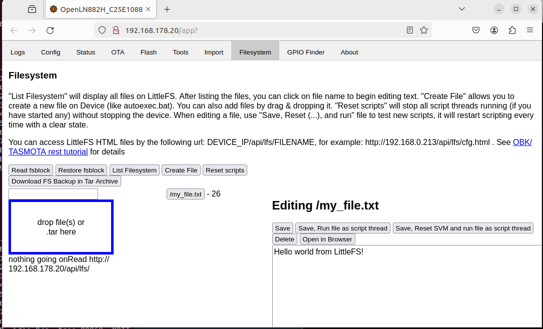

    But in the end, with all these hacks, I have successfully created a file which I could access after a reboot:
    LittleFS file system interface on a webpage.

    Yea I just noticed that, I am making LN882H dev board out of scrap and I was suprised to see that this particular pin is always high for me.
    Circuit board from scrap with electronic components, including capacitors and a USB port.
    Close-up of an electronic board with various components and a coil of wires.
    I almost got HD2015 display working.
