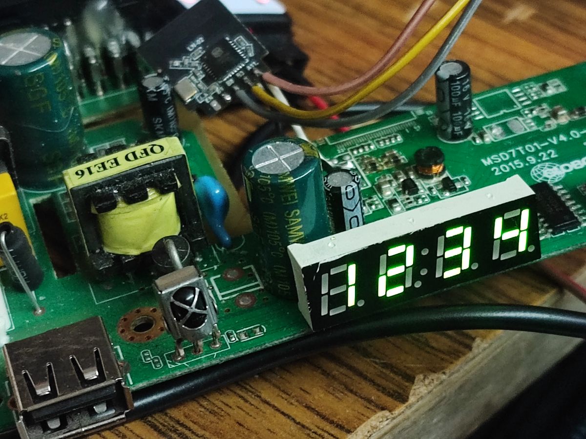

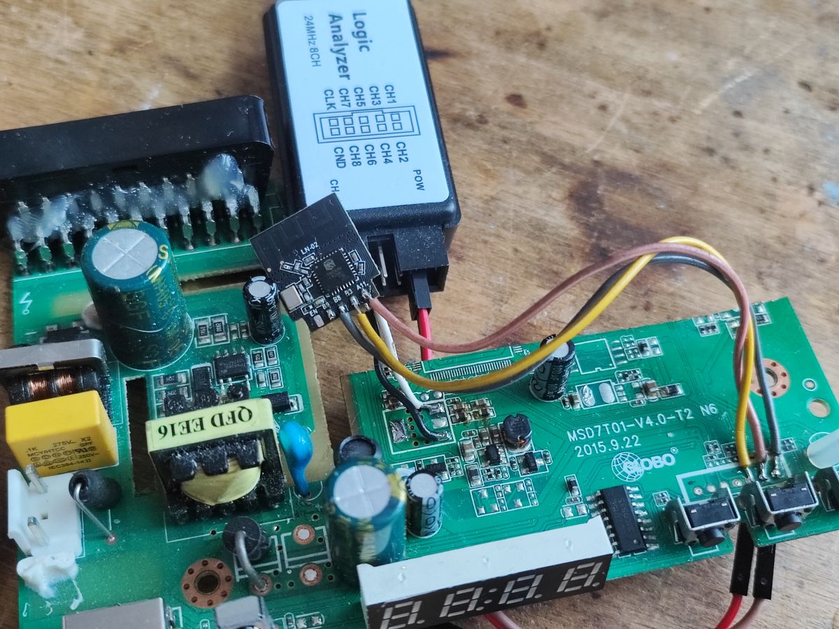

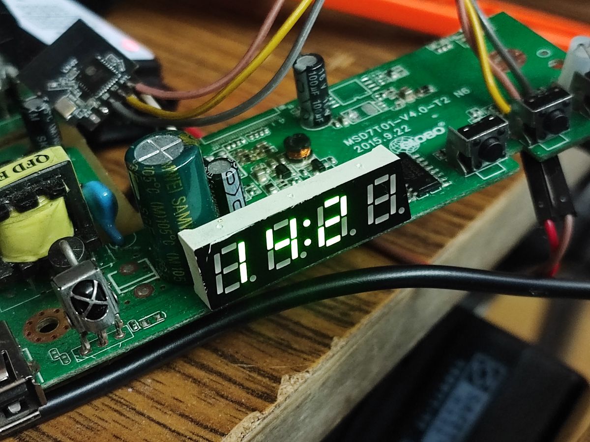

    My PR is very chaotic because I don't even have compiler setup locally and I am doing other things in the background but I finally managed to get stuff displayed.
    LED display showing digits 8.8.8.8 on a circuit board.

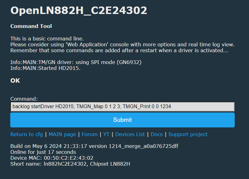

    To simplify things, I have a "shared TMGN driver" which supports multiple similiar display controllers like TM1637, TM1638, GN6932, etc.
    Added after 27 [minutes]:
    Ok it's working I guess:
    Screenshot of a command line tool for managing display drivers.
    Close-up of a circuit board with an LED display showing numbers 1.8.9.4.

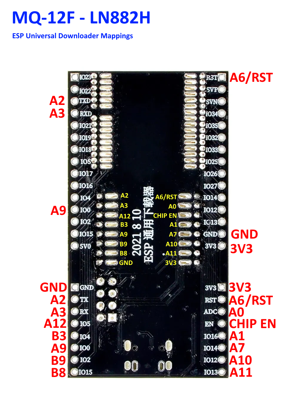

    >>21072408
    Guys, do you have B9 gpio working on your LN882Hs? For me, it's in high state all the time and OBK can't control it.
    That's probably, because B9 is Tx1 (so you will find your serial logs there on a physical port - at least this is where I get my logs from ;-))
    TX1 I/O UART_TX1 pin for log printing, corresponding to the GPIOB9 pin (pin 30) of the IC.

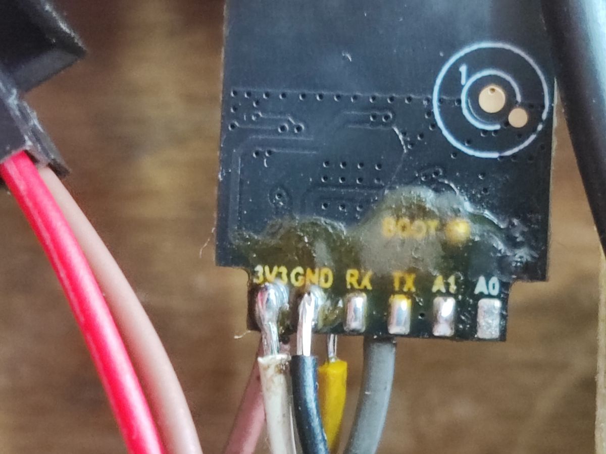

    Wait, but my module has TX and RX on the other side... so there are two UART ports, like on Beken? Well, that makes sense...

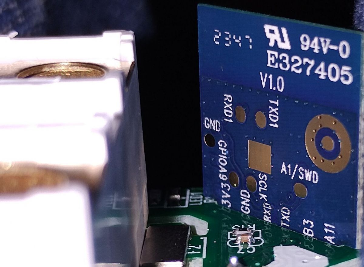

    Yes, there are two UARTS. On my WL2S module, the ports are on the back and labeled accordingly:
    https://obrazki.elektroda.pl/7439873600_1708165255.jpg
    So I think they are defined as UART somwhere, making any other setting useless.
    At least, I didn't even see glitches in serial log, if I change B09 in UI ...

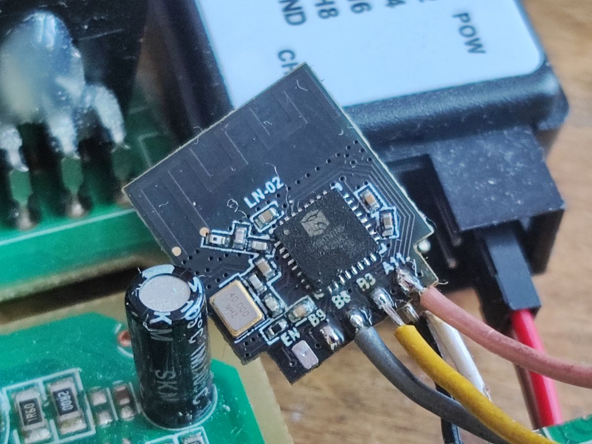

    Well, my module is different, you can see that I have B9 on the back and I was suprised that this B9 was not working:
    Electronic circuit board with connected logic analyzer and additional components. Image of an electronic module with B9 marking, with wires soldered to terminals. Close-up of an electronic module with visible pin labels: 3V3, GND, RX, TX, A1, A0.

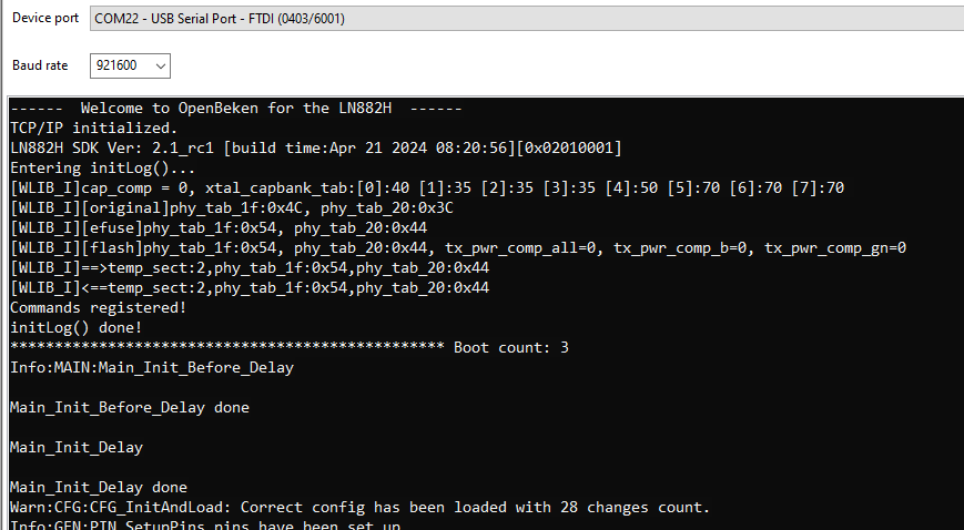

    That's why I pointed out, that I had the advantage of my module having the UART ports labeled not as gpio pin but as Rx/Tx.
    So I would call it: "works as designed" ;-)
    And I can only tell, that I like this feature: If you connect a 3.3V com port, you will be able to see the log with the unusual settings "921600 8N1".
    That's very useful e.g. to see if there are WiFi problems, which you obviously can't see in the JS apps Log section...

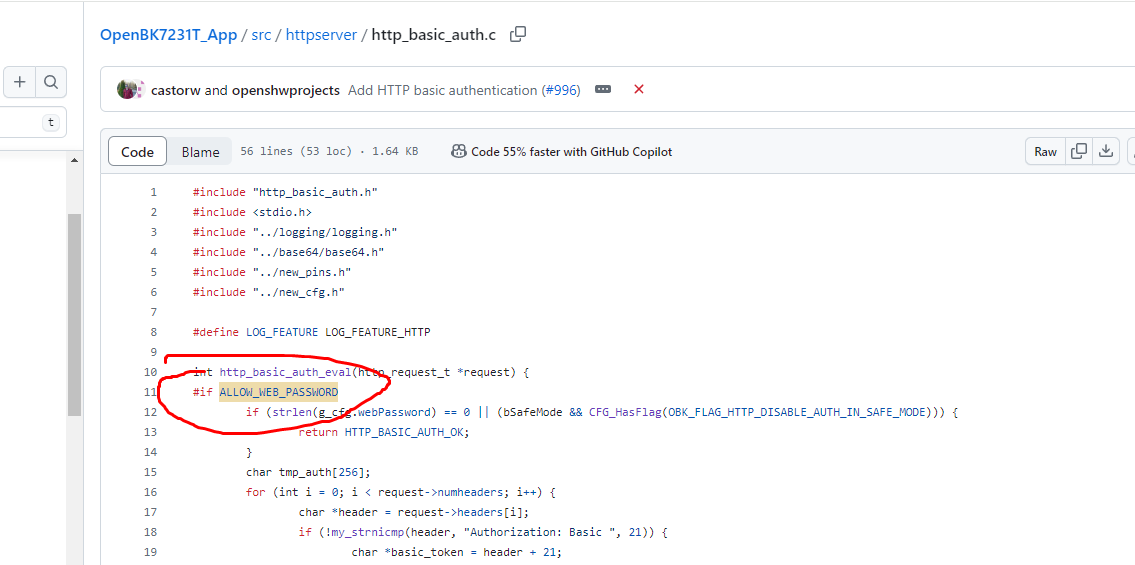

    This file is responsible for auth:
    https://github.com/openshwprojects/OpenBK7231T_App/blob/main/src/httpserver/http_basic_auth.c
    There is a define for that:
    Screenshot of the source code in the http_basic_auth.c file on GitHub.
    If you compile without ALLOW_WEB_PASSWORD defined, any connection will be accepted.
    You can also just manually edit code to accept any password. Then flash via UART.
    Here is a guide showing how you can compile OBK online, without any setup on your PC:
    https://www.elektroda.pl/rtvforum/topic4033833.html#20946719

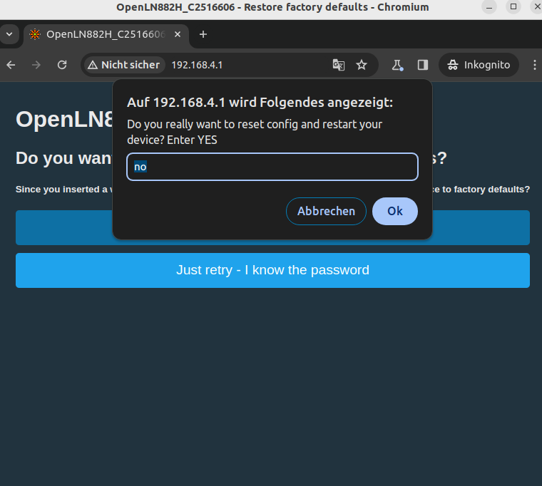

    I tried to implement a "general" possibility to reset the configuration, if "http auth" fails more than x times during the first minutes after startup.
    If you have a git account, you can download the "artifacts" there, containing an image for LN882H, too.
    https://github.com/openshwprojects/OpenBK7231T_App/pull/1240
    If you reset the device and give a wrong password more than 5 times, you will be asked if you like to reset the configuration of the device....
    Device configuration reset dialog box in the browser.

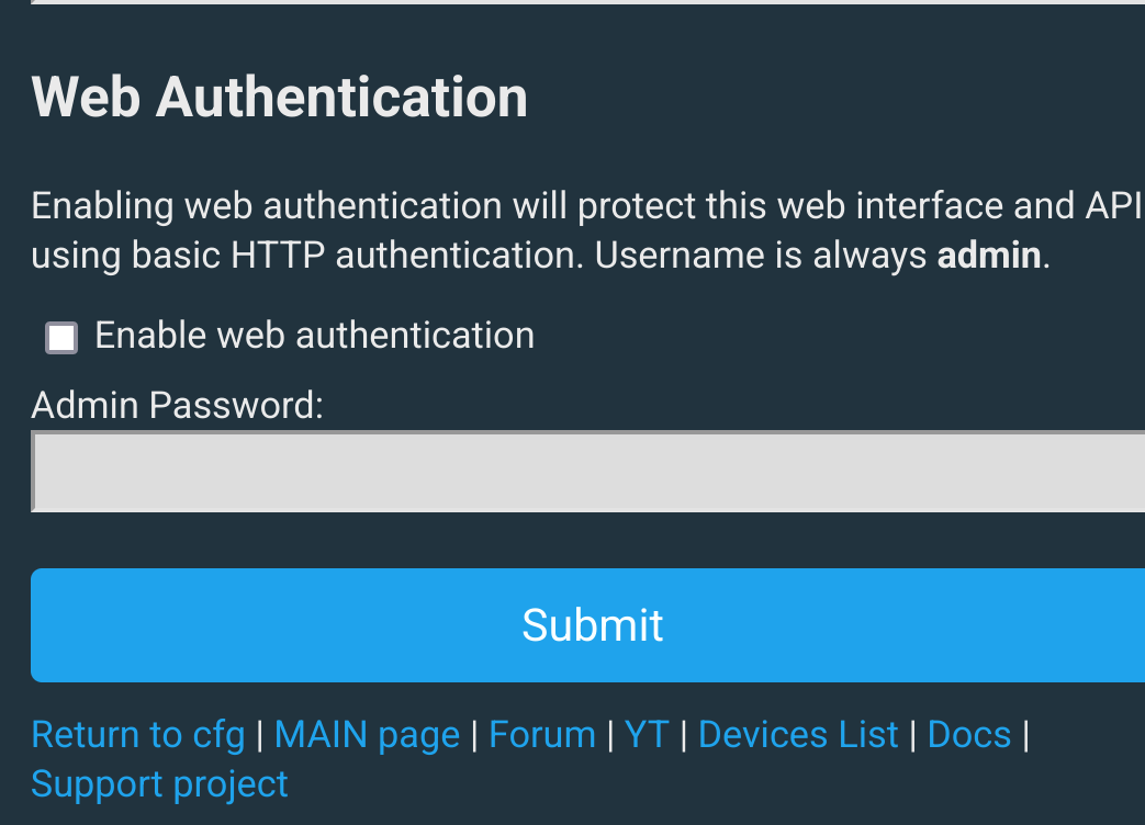

    max4elektroda wrote:
    As an additional point: I first thought of "you need to press the button during the procedure".
    now is an option: "Enable web authentication"
    so you can add the "Disable password reset" extension
    when setting a password, you decide whether you want to disable this option
    that would be very intuitive

    If there haven't been too many questions about lost passwords, it doesn't seem a big issue
    It's a possible security breach
    As stated above: everyone with physical access can do more harm than resetting the configuration
    It's only possible for a very short period of time
    We are talking about web auth with plain HTTP, so everyone in the network can read the credentials (they are only encoded but not encrypted)
    It should work as a simple way to overcome a possible lost password, so in my opinion, if disabled by default it won't be a help).
    At least at the moment I think most users are willing to flash a precompiled image but not to compile one themselves. If that was the case I would vote for completely disable it and every user with a forgotten password could easily compile a recovery image.
    I will accept all decisions and code it as you like ;-)
    All in all it was not too much of work, so even if it doesn't at all make it's way to the image, it's not a big deal.
