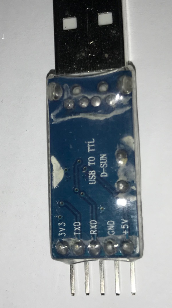

    Piorun2002
    Posts: 269
    Rate: 25
    >>20956716
    Were you able to upload the firmware to LN882 with this USB2TTL converter?
    I'm asking because this model does not have a voltage selection, so it may damage the chip..
    USB to TTL converter with visible pin labels and D-SUN logo.
    Is additional 3.3v power supply needed?
  • #130 21048197
    Posts: 5212
    Help: 446
    Rate: 914
    It may not have a selector but it does have separate 3.3 and 5v fixed outputs?
    Assuming it can feed a module enough current, the 3.3 should do.
    I only ever use external PSU now after too long wondering if flash failures were because of power.

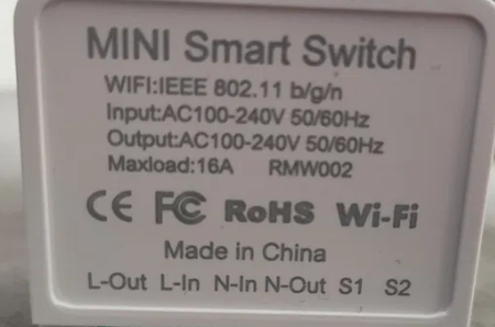

    Piorun2002
    Posts: 269
    Rate: 25
    I managed to upload the firmware to switch LN882H connected directly to the above USB2TTL converter, without additional voltage stabilizer and capacitors.
    Transfer speed 115200 (around two minutes)
    MINI Smart Switch label with technical information about the device.

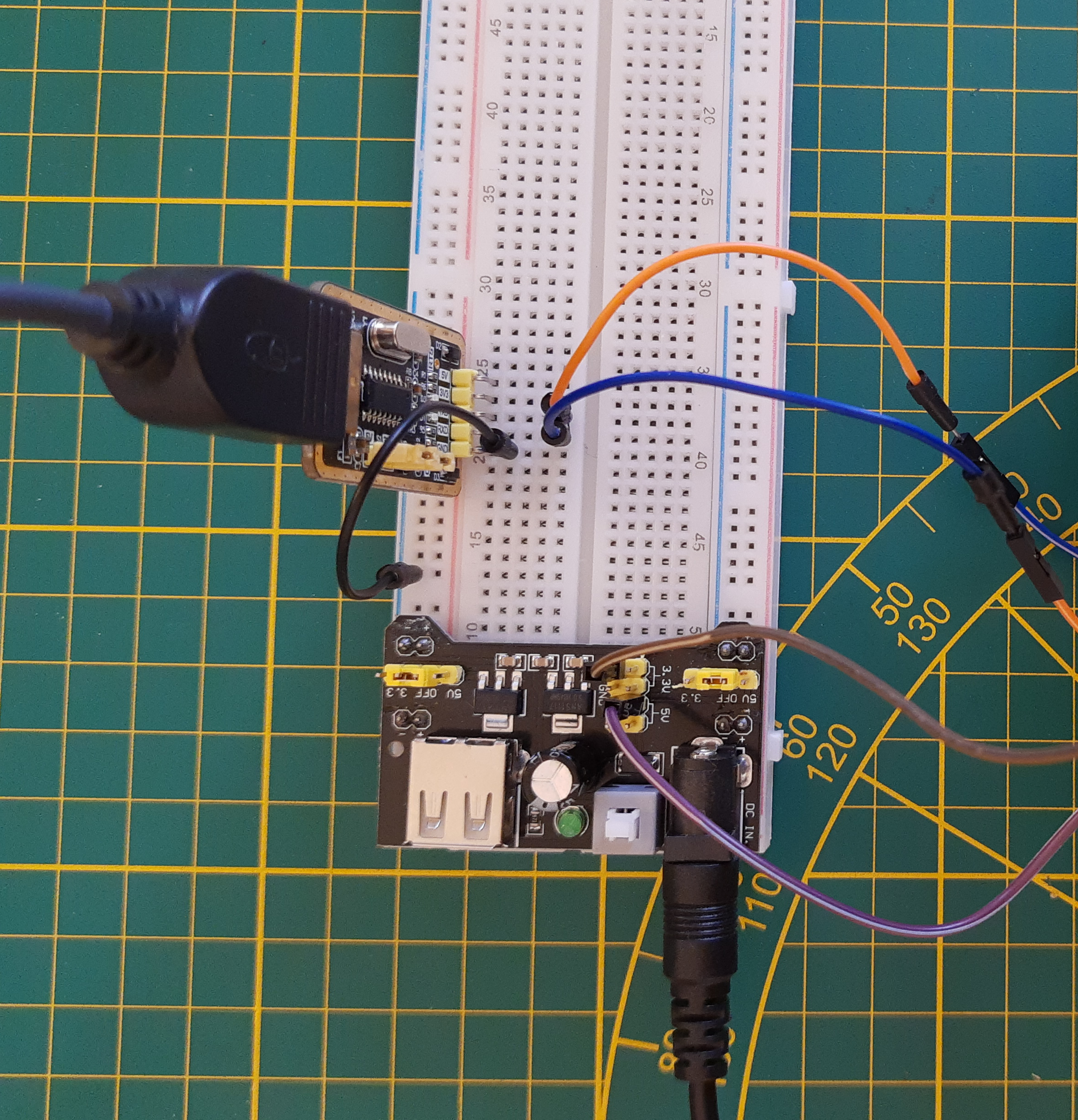

    ElektroTechnikus
    Posts: 22
    @Advian1
    I have also experienced erratic behaviour when flashing or testing afterwards when relying on my CH340 adapter as a power supply. But there are very different ones out in the wild...
    My solution is an old wall-wart with 9 to 12 V and a typical breadbord power supply that makes 3.3 and 5 volts out of it. It also has its own switch, which is useful for resetting the SoC without any fiddling.
    Image of a breadboard with a connected power supply and circuit.
    The fact that the relays do not work in this way may also be due to them not being operated with 3.3 volts but with 5 volts or more. Then besides a SPS normally there is an analoguous voltage regulator on the board and some driver IC, FET or BJT.
