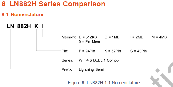

    Added after 2 [hours] 19 [minutes]:
    One more question about understanding the hole materia.
    Why is my dump file from the HL882KHI 4MB? Docs say that this chip has got 2MB Flash. LN882H series comparison diagram showing memory and pin designation.
    https://www.elektroda.com/rtvforum/topic4008545-150.html#20935788
    tbh I thought the .py file had been updated wherever it can be downloaded from

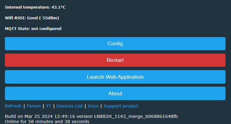

  • PowerSave mode lowers LN882H plug temperature
    #105 21022109
    max4elektroda
    Posts: 758
    Help: 49
    Rate: 189
    Since WiFi did work, I also tried on my plug:
    Seems to work quite o.k., the energy values shonw are reasonable and, best to say, after about 10 minutes the temperature is ~ 30°C, with a simple load of 25W !
    The bare module used to be around 35°C, not even inside a case, not to speak about realy, power converters ...
    Added after 7 [minutes]:
    Switched to "PowerSave 0", and one minute later temperature is well beyond 40° (over 45° just now).
    Added after 4 [minutes]:
    Switched back to PowerSave 1 at 47.8°
    After 3 minutes, temperature is 37.2°
    Added after 6 [minutes]:
    But it is really very slow (toggling switch took me 10 seconds) and readings for BL0937 are not updated as it seems :-(
    Added after some more [minutes]:
    This might have been a problem on my client.
    Now it looks o.k. I see readings for BL0937 changing again and switching is o.k.
    Temperature around 35° - that really looks good for me now (no long term test though)

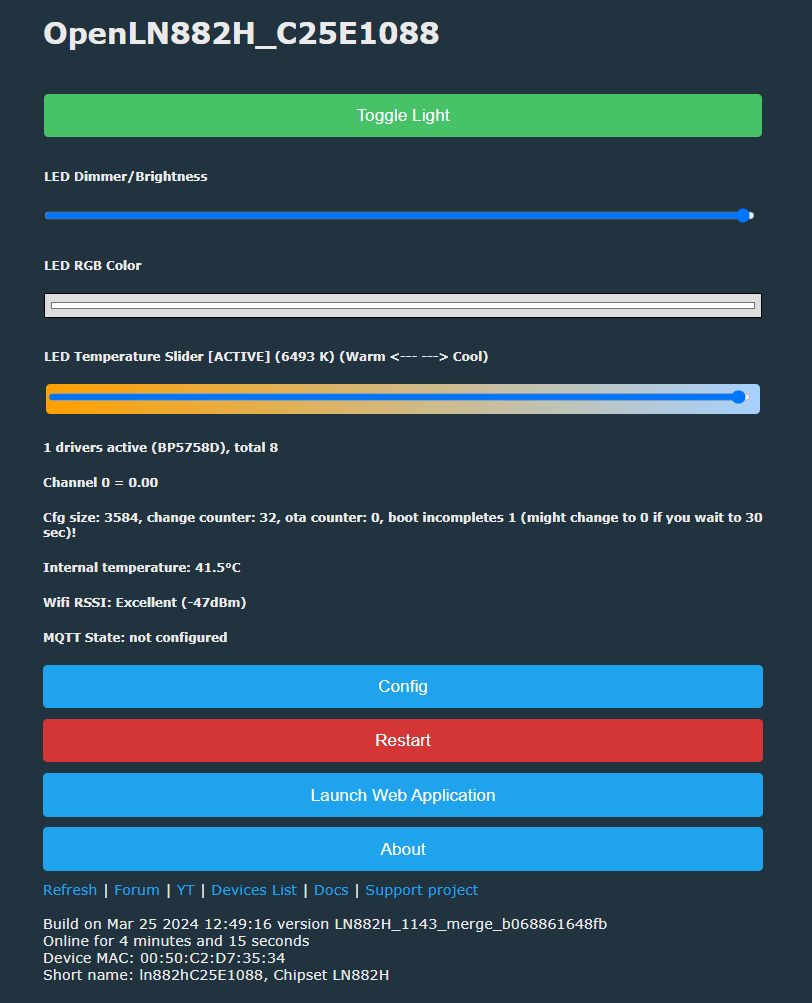

  • Powersave lowers temperature and power draw on LN882H candle lamp
    #108 21022196
    Posts: 5212
    Help: 446
    Rate: 914
    oh lol.
    im testing Build on Mar 25 2024 12:49:16 version LN882H_1143_merge_b068861648fb
    I have powersave 0 in startup command at the moment but have tried switching to powersave 1 in web app and ALSO see the temperature drop as well as the power consumption.
    This is the power consumption starting with powersave 0 with the 0.6-0.7w readings then powersave 1 with 0.3-0.5w readings from about 8s into the video
    but now I don't know where the PR fits into all this.
    Added after 9 [minutes]:
    i can't say im seeing a slow down with powersave 1 on the PR build though
    Added after 3 [minutes]:
    I'm just testing with this LN candle lamp. it was getting too hot with the bulb lit and it would reboot after a few minutes. temps were 80+ degrees C. see how long it lasts...
    Screenshot of the OpenLN882H_C25E1088 interface with controls for LED brightness and color temperature.
    Added after 54 [minutes]:
    bulb still on and online, which is a novelty. BP5758D_Current 1 1 set though so LEDs are LOW.
    Screenshot of a web application interface showing internal temperature and WiFi status.
    will try BP5758D_Current 5 5
    Added after 18 [minutes]:
    Too hot at 5 5, rebooted. Will try 3 3

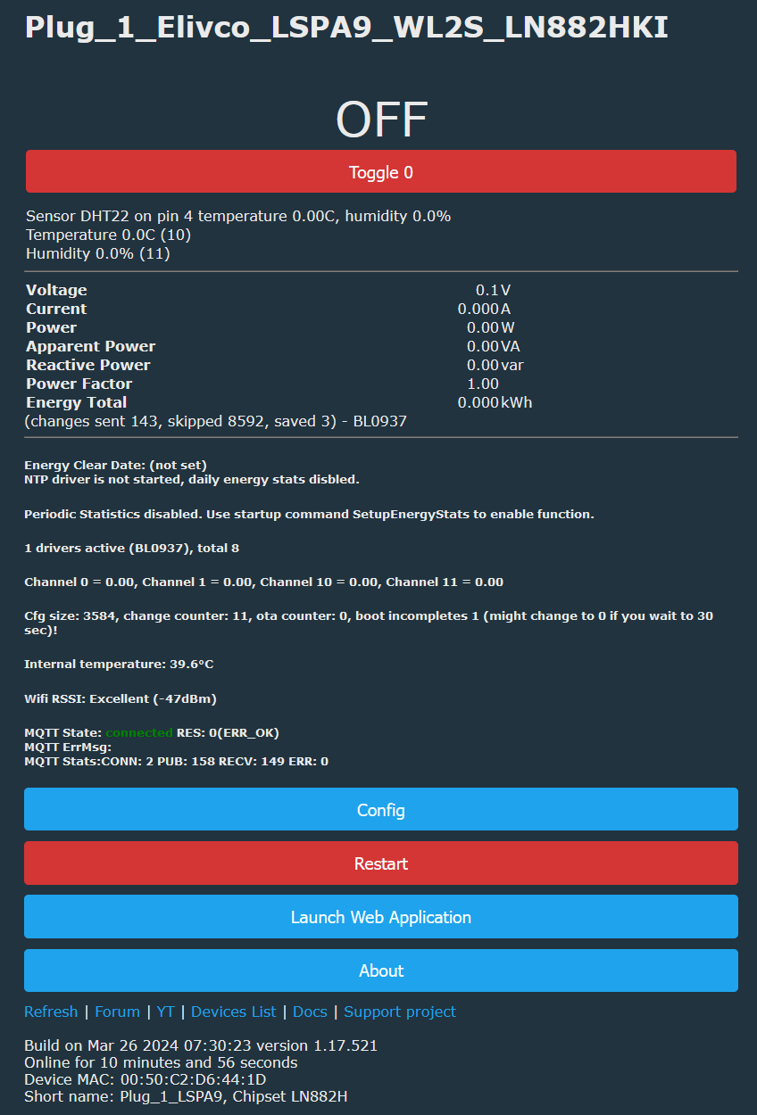

  • Measured LN882H power draw with and without powersave
    #110 21024816
    rufus4
    Posts: 65
    Rate: 9
    I made an interesting discovery. Tried to measure the power consumption of the LSPA9 with LN822HKI and the BL0937, because I recocnised that its getting quiet hot.
    It looks like Tuya does not use any power save mode at all on this device with the WL2S board. And this is very interesting. (Or they just don`t care?)
    Measured with a DMM and a clamp meter the device's power with relays off and on.
    OpenLN882H_1.17.521 takes 8.5 and 12.5 mA
    original Tuya FW takes the same 8,5 and 12.5 mA (this is incredible 2/3Watts)
    OpenLN882H_1.17.521 with experimental "powersave 1" takes an average of 6.5 and 10.5 mA (but GUI is not stable, freezes after a while)
    For comparison, a shelly plug (16A) takes around 4/7mA which is only half of the Tuya firmware.
    (I know, my mesurement is not very accurate because of powerpeeks. But without powersave mode the consumption seems to be nearly constant.)
    - BL0937 is known to work bad with powersave because BL0937 requires a change interrupt to work in order to count CF/CF1 pulses
    maybe thats the point?

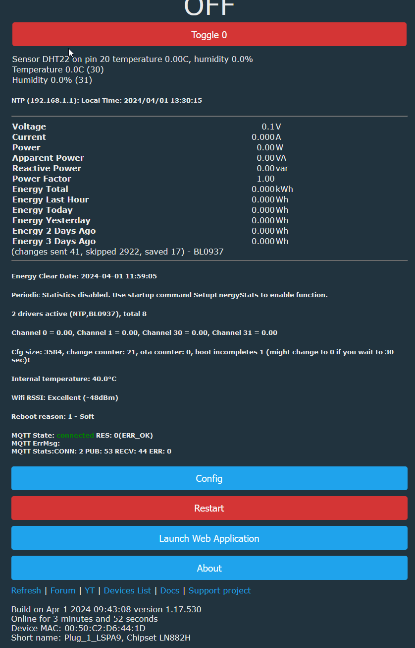

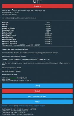

  • DHT22 support on LN882H remains unclear
    #111 21026099
    rufus4
    Posts: 65
    Rate: 9
    Is there a chance to get a DHT22 working on the LN882H?
    While setting the pins, I found all of this DHT's to choose on the list. So I thought I'll try and did solder one more pinout to pin 4 on the WL2S board and connected a DHT22.
    It looked like it got recognized and warned me to set two channels. But there are no values. Did I choose the wrong pin for that, do I need to start a driver or is there no such implementation in the FW?
    I know, maybe it's a bit too early for these thingies, but I love to fithering around with it and it would be nice to have temperature and humidity directly on a power plug to switch a dehumidifier. :)
    Device configuration screen with connected DHT22 sensor showing no temperature and humidity values.

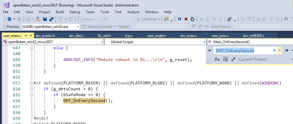

    The DHT update, however, seems to be disabled for LN882H currently:
    Screenshot of Visual Studio editor with the user_main.c file open.
    Let me try checking this out. I will update LN882H makefile to include DHT driver and then add enable there.
    DHT step 1:
    https://github.com/openshwprojects/OpenLN882H/commit/0467665d75a879d3024f538a5d31c313f844fc16
    Now I will try to enable it in app...
    Added after 1 [hours]:
    I think i enabled it, it should work on LN882H with 1.17.527 build, but I am not able to test...
    https://github.com/openshwprojects/OpenBK7231...mmit/f27907593411632f7186e0e9e6ff4e572880cf0f
    I also later moved the define to the correct place:
    https://github.com/openshwprojects/OpenBK7231...mmit/d38957aee0cbcbb745a1975447024ce6d7f54b45
    It should be more obvious now how do we enable DHT on new platform.

    rufus4
    Posts: 65
    Rate: 9
    First, I do have to say again that I'm a poor beginner and please for passion.
    And now one more question. Does the drivers start by themselves? DHT and NTP drivers I never have seen listed as working on the main GUI page.
    I think I made a mistake. I connected pin B4, but selected it as Pin 4.
    Which Pin number is B4 then on the list from 1-25?
  • DHT autostarts; B4 maps to pin 20
    You will have to start the drivers on the "execute custom command" line:
    Its "startDriver <driver>" e.g.
    startDriver NTP
    to start NTP.
    Only BL0937 is an exception and starts automatically.
    Correction: DHT also has an autostart.
    Regarding the pins: in the gui you can select B4 directly.
    It will be mapped to pin 20 in the config file (A# pins are 0 to 15, so the pin B0 is 16 and so on).

    rufus4
    Posts: 65
    Rate: 9
    Thanks a lot, finally I selected the right pin B4 now. Somehow it would have been too easy, open my eyes a bit wider only. :)
    But still DHT does not work in my case. And if I try to start the DHT driver manually, there is none on the list. Same with the newest build .530.
    --updated--
    Screenshot of a device control panel showing data related to a DHT22 sensor and other system parameters.

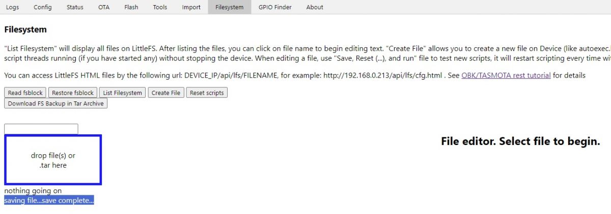

    I tried to create an autoexec.bat file to include these two commands, but the file was not created. Is the LittleFS mechanism implemented in the current version of OpenLN882H_1.17.524_OTA software?
  • #119 21028427
    Posts: 14755
    Rate: 12880
    @piotrret to enter more than one command in the short startup command should be used backlog : :
    backlog first command; second command etc; third
    Just like in Tasmota.
  • #120 21028556
    piotrret
    Posts: 67
    It works, thanks for the tip. I just wanted to ask about creating files, because, as I wrote earlier, I tried to create the autoexec.bat file, but after pressing the List Filesystem button, nothing appears, even though after using the Create File function, Screenshot of a filesystem interface showing the process of creating files and listing items in LittleFS. I have the message saving file...save complete...
