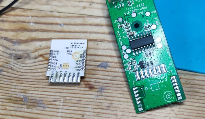

  • T34 flashes via pin 8 without CEN bridge
    #35 21041208
    Tilator
    Posts: 139
    Rate: 13
    t2004dd wrote:
    I flashed T34 chip successfully.
    Bridge CEN is not needed. You can start flashing if you just interrupt 3.3V , attached to the PIN8.
    I flashed it with baud rate 921600.
    BK7231N chip with soldered wires on a white surface.
    Electronic module with green screw terminal block and black relay on a PCB.
    Did you flash it using BK7231N flash file and procedure? Are T34 and BK7231N identical enough? Except different pinout.

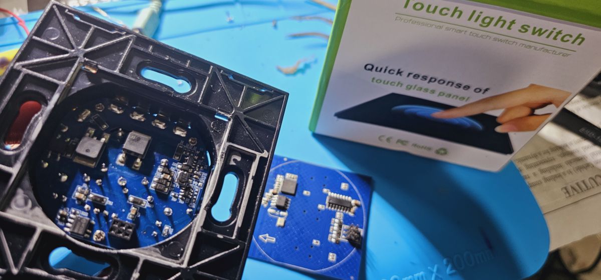

    #41 21049093
    dhanushkadx
    Posts: 8
    The image shows a blue printed circuit board with a detached SMD component next to it. Close-up of a blue circuit board with an SMD chip mounted on it. Printed circuit board with mounted SMD components. Screenshot of BK7231N flashing software on a computer. Electronic tools and circuit board on a blue workbench. PCB with SMD components, BGA flux, and tweezers on a blue background. Touch switch with a visible circuit board and packaging. Computer screen displaying the OpenBK7231N configuration interface. Screen of OpenBK7231N_E1E779B1 configuration with module setting options.
    This is not impossible if you have some smd chip reworking skills. actually this is my second switch . pervious one also succeeded. I used little flux and 400C hot air, be careful if u heat it too much pcb will be fried .

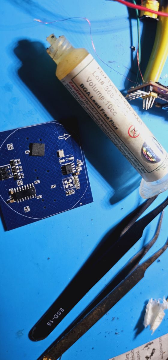

  • SMD rework tips for lifting BK7231N chips
    #45 21049685
    dhanushkadx
    Posts: 8
    its flux that is a chemical to prevent oxidation . I used 400 c air it took me less that a 60 seconds to lift the chip. there are technics to bring down the heating time much further . if u use a pre heating machine you can bring pcb temp to 150 so it will take about 20 seconds to lift the chip. watch some youtube videos if you haven't rework a smd chip ever. because if you apply hot air longer there is a risk of damage the chip or pcb. SMD chip reworking is a skill that u should improved . sometimes i also burn chips mistakenly . get some old pcb with smd chip and try to rework before you do that to the working pcb.
  • #46 21049686

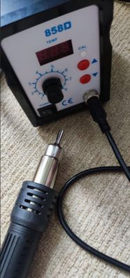

  • #60 21083513
    Posts: 14768
    Rate: 12909
    I have tested similiar model but with different visuals:
    View of the power label on the 858D/858A model device. Packaging of Renew Force soldering station model 858D.
    I will be posting review soon, this or next month.
