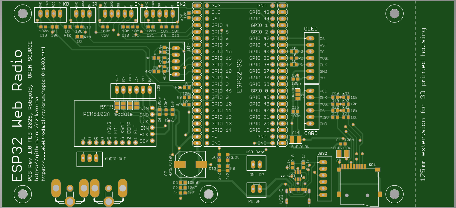

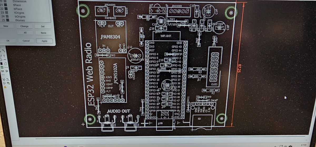

    And can I have the schematic for this Robgold board please :
    Front and back of a green “ESP32 Web Radio” PCB with labeled footprints for modules and connectors
    or give you the values of the components.
    I found schematics in the attached archives, but of other versions.
    I have one board and would not like to mull something over.
    Greetings.

    There should be an HTML file with a list of the elements in the thermal transfer file. The schematic is missing from the head. It is based on a schematic by colleague Robgold from github.
    Look for the HTML file there is a listing for this project.
    Regards...
  • #2345 21843332
    ejcon
    Posts: 301
    Rate: 68
    Computer screen showing an “ESP32 Web Radio” PCB layout with labeled connectors, GPIO pins, and board dimensions.
    [img-0]
    Maybe this will help you
  • Request for the missing schematic file
    #2346 21843336
    Dziwny234
    Posts: 21
    Or I'm a gammon, but I can't find it in any way.
    I've searched through Robgold's github zips and thermal transfer zips
    and haven't found it. There is only the schematic for your first version,
    but it does not fit at all.
    Can I ask for this file ?
    Added after 44 [seconds]:
    In the meantime, Ejcon has uploaded a pic.
    Admittedly, it's the version with one encoder,
    but it probably doesn't matter.
    Thanks.

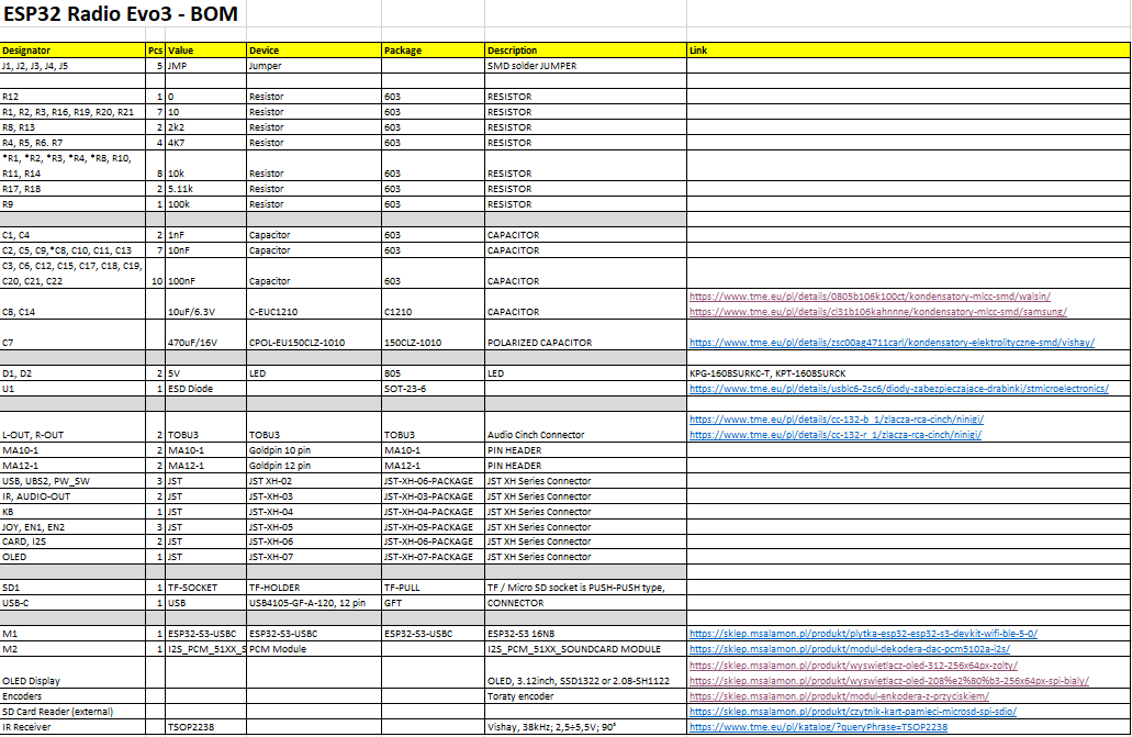

  • Component list for the ESP32-S3 audio circuit
    #2347 21843355
    slaslo
    Posts: 185
    Help: 24
    Rate: 56
    >>21843336
    C1 1nF CONDENSATOR-2.5MM-X-7.5MM Library
    C2 10nF CONDENSATOR-2.5MM-X-7.5MM Library
    C3 100nF CONDENSATOR-2.5MM-X-7.5MM Library
    C4 1nF CONDENSATOR-2.5MM-X-7.5MM Library
    C5 10nF CONDENSATOR-2.5MM-X-7.5MM Library
    C6 100nF CONDENSATOR-2.5MM-X-7.5MM Library
    C7 470uF/6.3V CONDENSATOR-ELECTROLIT-8MM Library
    C8 100nF CONDENSATOR-2.5MM-X-7.5MM Library
    C9 33nF CONDENSATOR-2.5MM-X-7.5MM Library
    C10 33nF CONDENSATOR-2.5MM-X-7.5MM Library
    C11 33nF CONDENSATOR-2.5MM-X-7.5MM Library
    C12 1000uF/16V CONDENSATOR-ELECTROLIT-10.5MM Library
    C13 33nF CONDENSATOR-2.5MM-X-7.5MM Library
    C14 220uF/16V CONDENSATOR-ELEKTROLIT-8MM Library
    C15 100nF CONDENSATOR-2.5MM-X-7.5MM Library
    C16 220uF/16V CONDENSATOR-ELEKTROLIT-8MM Library
    C17 33nF CONDENSATOR-2.5MM-X-7.5MM Library
    C18 100nF CONDENSATOR-2.5MM-X-7.5MM Library
    C19 4.7uF/16V CONDENSATOR-ELECTROLIT-6MM Library
    C20 33nF CONDENSATOR-2.5MM-X-7.5MM Library
    R1 10 REISTOR-10MM Library
    R2 10 REISTOR-10MM Library
    R3 10 REISTOR-10MM Library
    R8 10k REZYSTOR-10MM Library
    R9 220 REZYSTOR-10MM Library
    R12 330 REZYSTOR-10MM Library

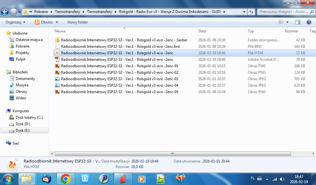

    Hello there is an html file in the folder in the version with two encoders is this one
    Windows Explorer screenshot showing “Radioodbiornik Internetowy ESP32‑S3” files in a Robogold folder
    Greetings ...
    Added after 10 [minutes]:
    I see you have provided a list ;)
    TSOP31238 receiver I will add to this.
    The jumpers you don't need to do are pulled on the top layer.
    The only jumper you need to put on if you want to use with the PAM8403 amplifier is the AMP jumper
    If you have any questions...
    Regards ...

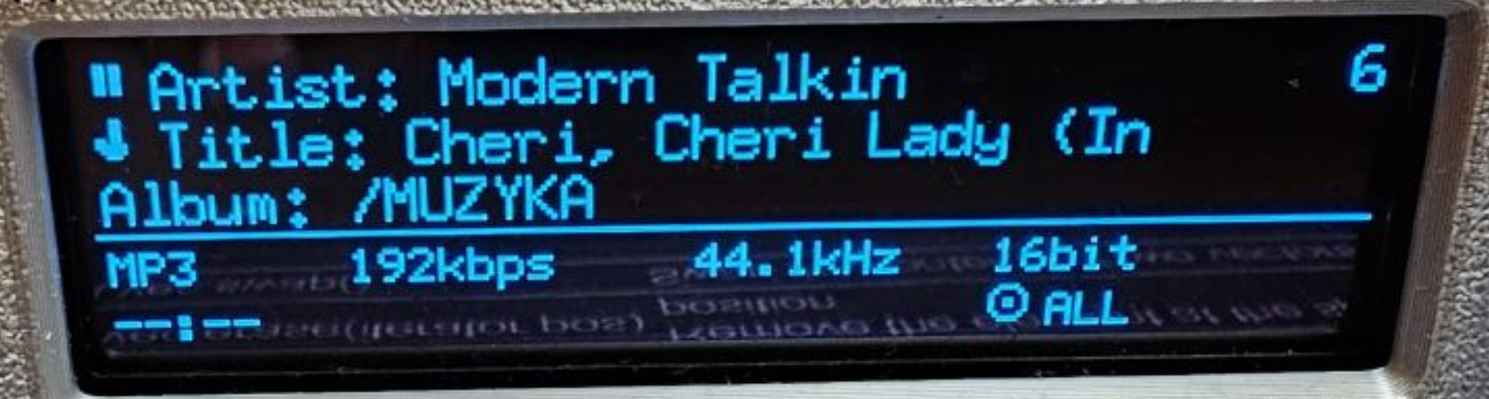

    SMALL IMPROVEMENTS TO SDPLAYER ADDED SYTL 8 as pictured
    Device display showing player UI: Artist, Title, Album and MP3 specs 192 kbps, 44.1 kHz, 16 bit
    Added support for rewind and fast forward pause stops playback after pressing ok play resumes playback from stop continues mute on all styles in the setlist menu we can choose which sdplayer styles to display when switching src

    #2350 21843682
    robgold
    Posts: 726
    Help: 10
    Rate: 290
    >>21843306 Perhaps that's why you can't find anything for this board on my GitHub because it's not my board ? ;)
    My version of the PCB is the one below:
    PCB render “ESP32 Web Radio” with ESP32‑S3 pin labels, OLED and SD connectors, and a PCM5102A module area
    It is fitted to the printed case (STL files are also made available on GitHub)
    The components with values are on the schematic. By the designators (C1, C2, C3 etc.) you are able to identify each component.
    In addition, I have uploaded the finished BOM (parts list with description) to GitHub https://github.com/dzikakuna/ESP32_radio_evo3/blob/main/BOM/Evo3-BOM_rev1.0.pdf [/url]
    Screenshot of the “ESP32 Radio Evo3” BOM table listing parts, values, and supplier links.
    Of course parts like OLEDs, encoders can also be ordered from Ali.... i've thrown in links to domestic suppliers if anyone wants to have them at home fairly quickly.

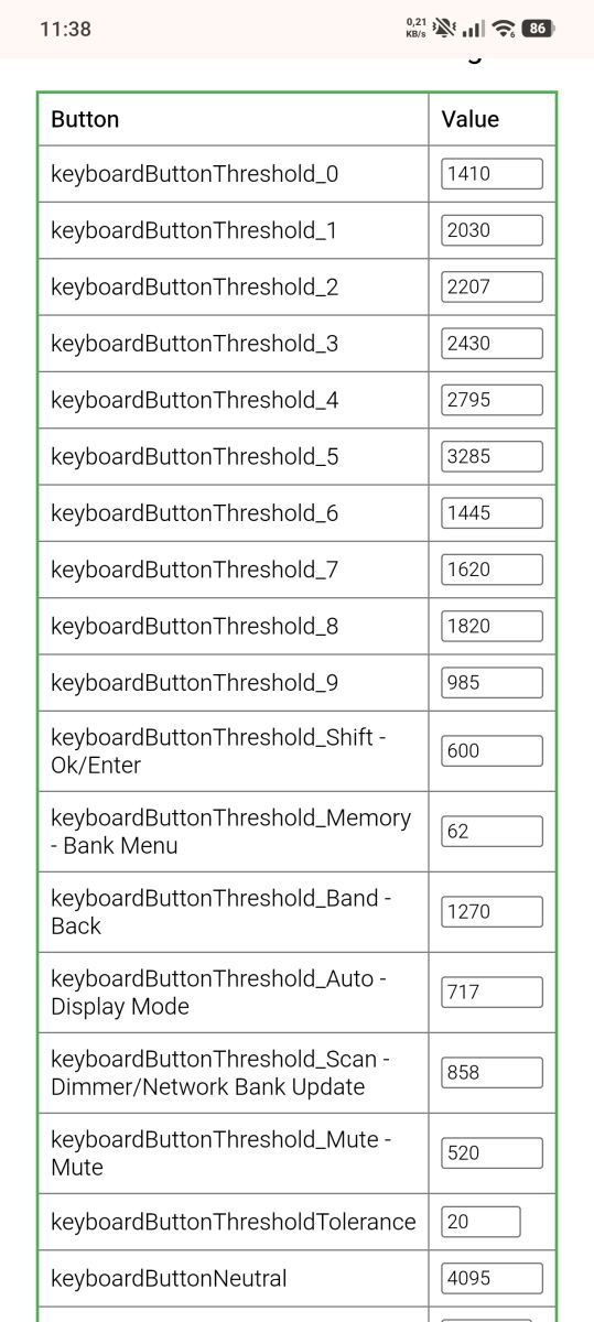

    I wanted to ask about the possibility of swapping functions for the ADC keypad my chassis unfortunately doesn't have a numeric keypad so I rather don't need the functions of the numeric keys I'm more interested in e.g. timer off or the operation of channels and banks i.e. channel up channel down and bank up and bank down. In the words of my colleague Robgold from a few posts ago this keypad works very nicely for me for 16 keys. For my rafia I chose a star keyboard layout because in my opinion it is then easier to have control of resistor drift whether by temperature or normal component ageing as it only works with one component each time hence it is very easy to locate the "culprit" when something stops working. If posting a video on this forum is not welcome then please let me know and then I will remove it immediately. Regards

    >>21843694
    Hi the tiles are my creation as Robgold wrote he has his official one on Github.
    My version coincides 99% with the original only it's on through-hole components and goldpinned modules (I've had my years and can't see the little crumbs).
    If you don't know something, I can help.
    The board was made based on the first version of the schematic and the radio about a year ago.
    The only thing not on the PCB is the GPIO9 output for the keyboard.
    Not many people have asked about it so far, and GPIO pins 16 and 17 for LED standby type tasks. One of these is output for two encoders.

    >>21843724 In the ADC settings, you can assign yourself values. In the latest version, I have added all the remote control keys, i.e. also the arrow keys, which were missing on the ADC keyboard, and made some changes to the operation.
    Additionally, change the main pull-up resistor from 100k to 22-24k and add as C8 marked*C8 on the PCB 100nF as an integration filter on the ADC input.

    In Evo 3.19.70 I have these keyboard configuration options it was from a bin file loaded. I made my keyboard in star and I have pull-up 10k and common resistor 100om on input to go out around 0.1v with first button because from my own experience I found out that below 0.1V and above 3.1V it is very different with linearity of ADC on ESP and 100n to ground on pin 9
    Screenshot of a table of keyboard thresholds: keyboardButtonThreshold entries with numeric values

    >>21844062 The latest one means the one that is with me in development 3.20.01. Such a mental shortcut. In 3.19.70 there is not yet this ADC configuration :)

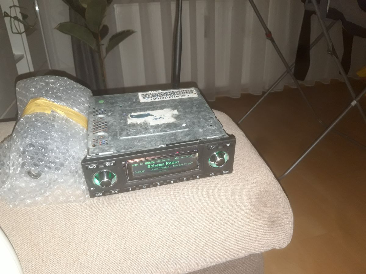

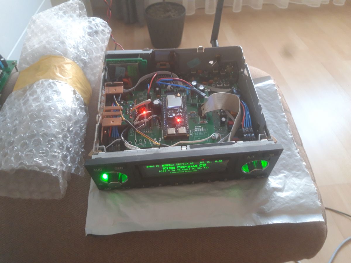

    Hi colleagues, this is my project of the "Robgold radio" with a lot of help from "DJCheester" in the housing of the car radio
    s dvuma encoder
    Open car radio housing with green-lit display and visible internal electronics
    Open car radio case with circuit boards and a green display, on a table next to bubble wrap
    Car stereo on a stool with a backlit display reading “Bohema Radio” and two control knobs

    Another happy radio owner 😀
    I only helped with the commissioning from my PCB.
    Tributes go to the developer of the software i.e. Robgold.
    Regards...
