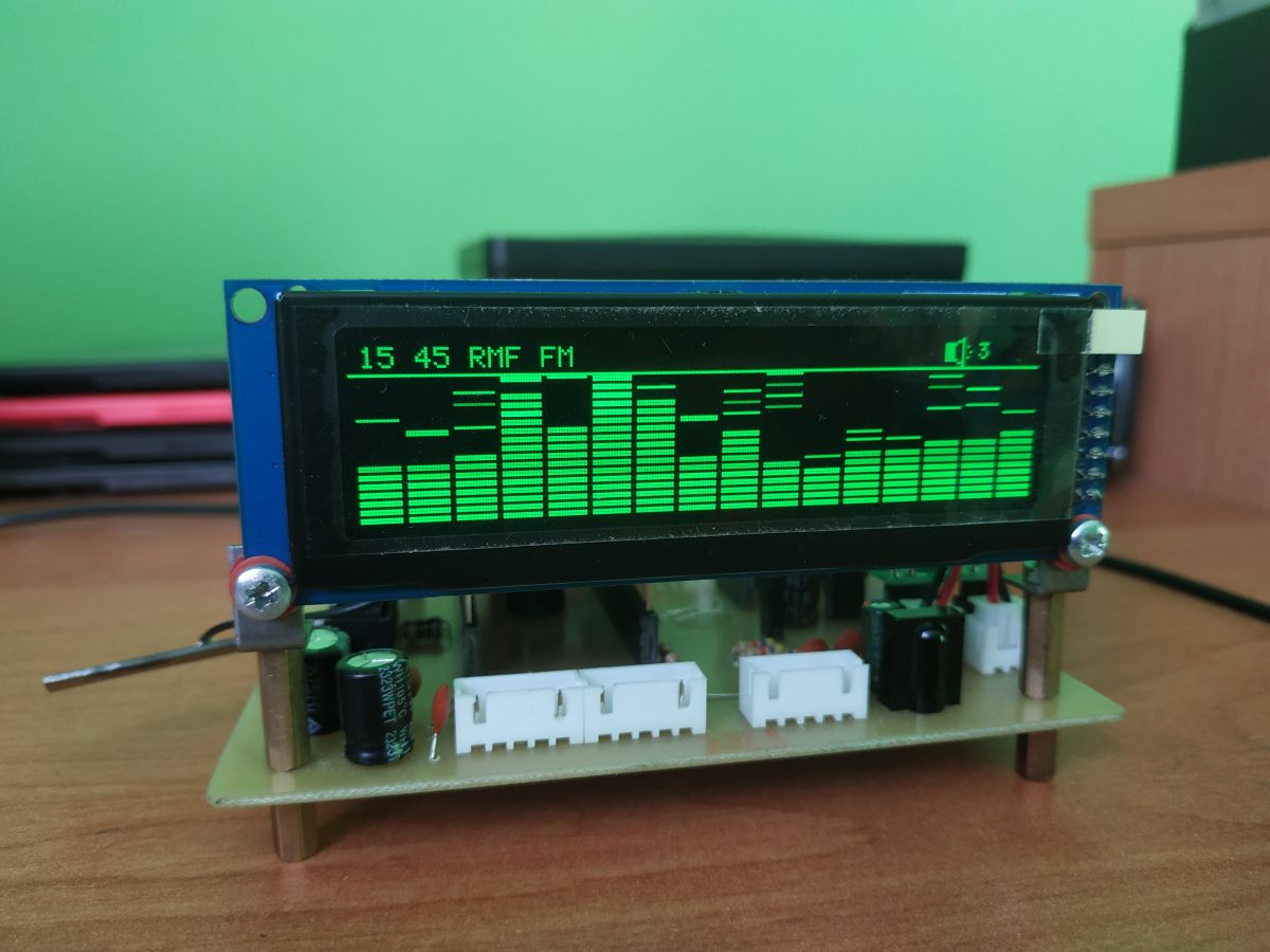

  • #2373 21848464
    DJCheester
    Posts: 2049
    Help: 75
    Rate: 949

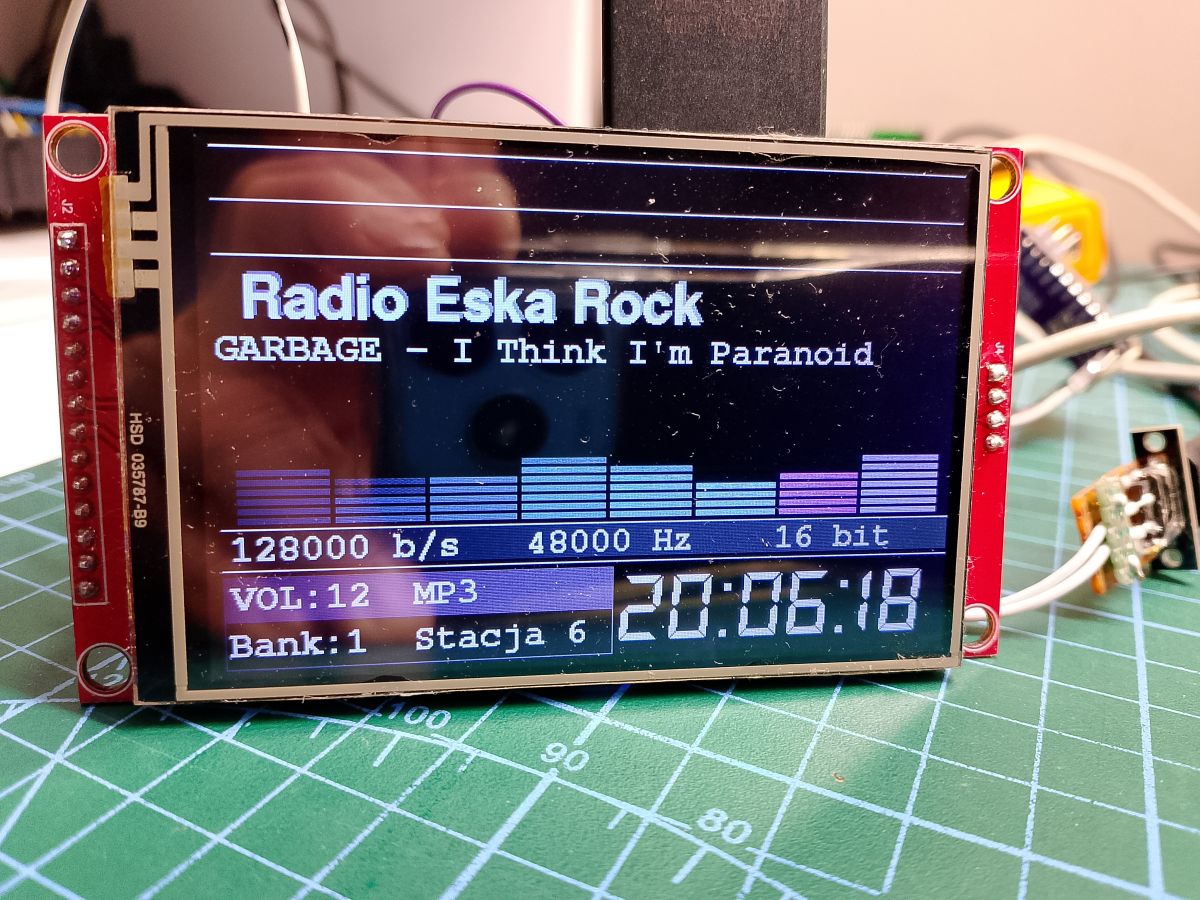

    For those who like Spectrum Analyser-type indicators.
    LCD module showing a green spectrum analyzer bar graph on an electronic circuit board on a desk
    Robgold's soft running on LittleFS 3.19.70 with added analyser views 5 and 6
    Greetings ...
    • Analizator-3.19.70b.zip (107.92 KB) You must be logged in to download this attachment.

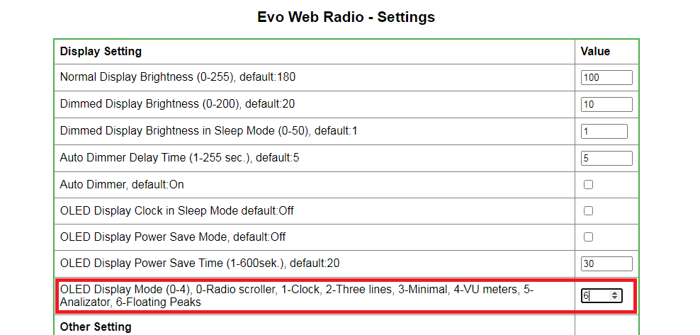

  • #2374 21849020
    JohnNagy
    Posts: 14
    It works very well. Thank you.
    Added after 2 [hours] 18 [minutes]:

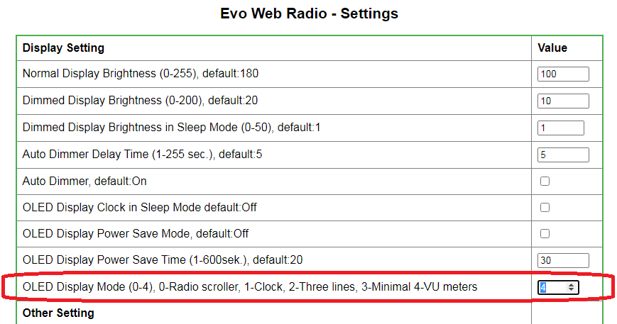

    >>21848464 There is one problem. You cannot manually set the screen mode to larger than 4 in the menu. Only with the remote control.

    >>21850329 I haven't noticed Budapest Rock not having tags before. In FLAC they always had (I think so, or rather I would have paid attention to it)
    @DJCheester probably the issue is that on the settings web page there is a limitation to 4 modes and when you added the new ones someone didn't correct there the so called maximum value for the cell which makes it impossible to write above the value 4. Correct and recompile or manually in the settings file write yourself "5" or "6". When reading, the radio does not check this value if it is within the allowed range of the settings form. It checks the global limit of the variable and this I assume is correct.
  • #2383 21851327
    DJCheester
    Posts: 2049
    Help: 75
    Rate: 949
    I sat that 3h and "fine-tuned" the analyser code for version 70b, a lot of it made me muse, that is, you are saying that the limitation is in the HTML code in settings max 4 and it should be 6. And it probably is, although the HTML I edited here I could have left out.
    I'm a bit ill at the moment so I probably won't be in the workshop for a while, the code is provided so this fix can be done by anyone for the time being.
    All in all, with the help of ChatGPT, this implementation worked, I didn't really believe I could do it with my knowledge.

  • #2386 21852241
    DJCheester
    Posts: 2049
    Help: 75
    Rate: 949
    >>21849020
    As far as this is concerned, I have corrected
    Screenshot of “Evo Web Radio - Settings” with “OLED Display Mode” highlighted and set to 4
    It is now like this
    Screenshot of “Evo Web Radio - Settings” with “OLED Display Mode” highlighted and set to 6
    Greetings...
    • Analizator-3.19.70bfix.zip (107.94 KB) You must be logged in to download this attachment.

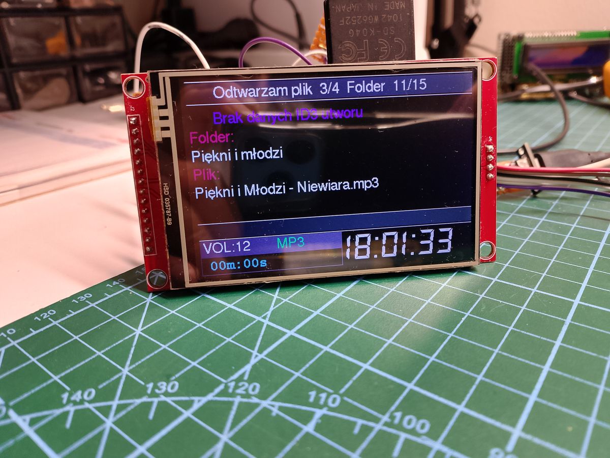

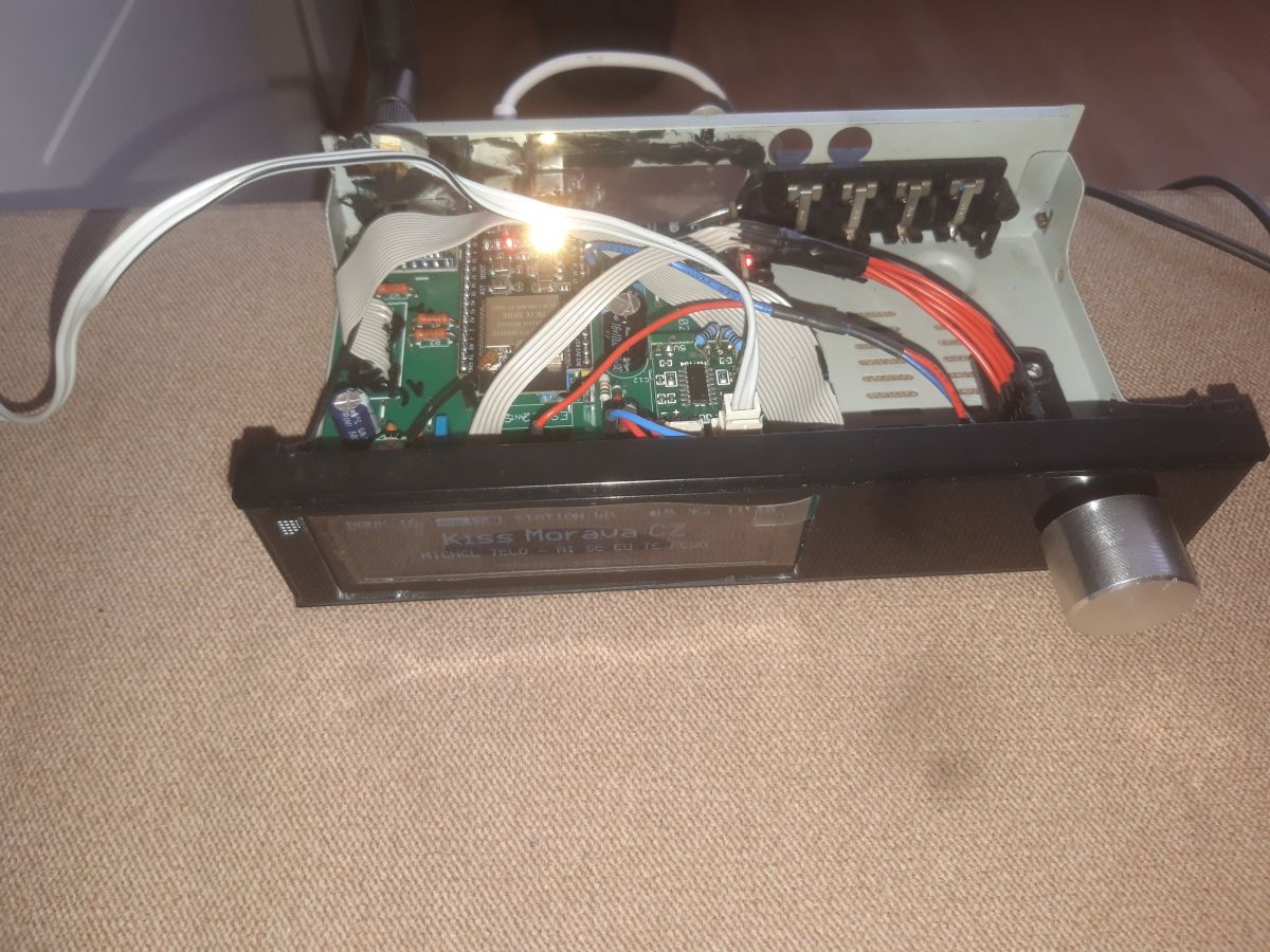

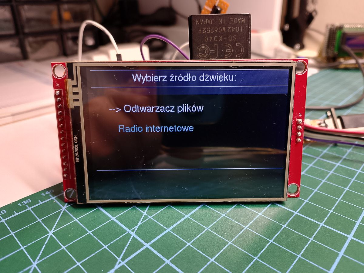

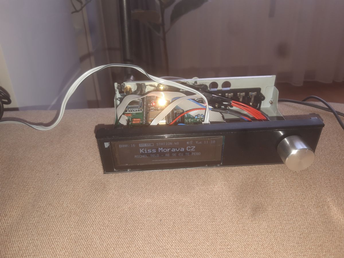

  • #2391 21853745
  • #2392 21853751
    supsak
    Posts: 81
    Nevjem, jaksz to u mne dzivne dzala, chyba że mosze dzialacz bialy vysvjetlacz...
    And what else would be good if there was in the menu-setting a LINE OUT... signal for power amplifier.
    In my case there is a very awake PAM8403.I had to make an Ateunator, because the radio already at 2 stupnu very drowsy... The same as when I added it to home cinema.PCM5102 dava for me enough... audio signal
    Added after 5 [minutes]:

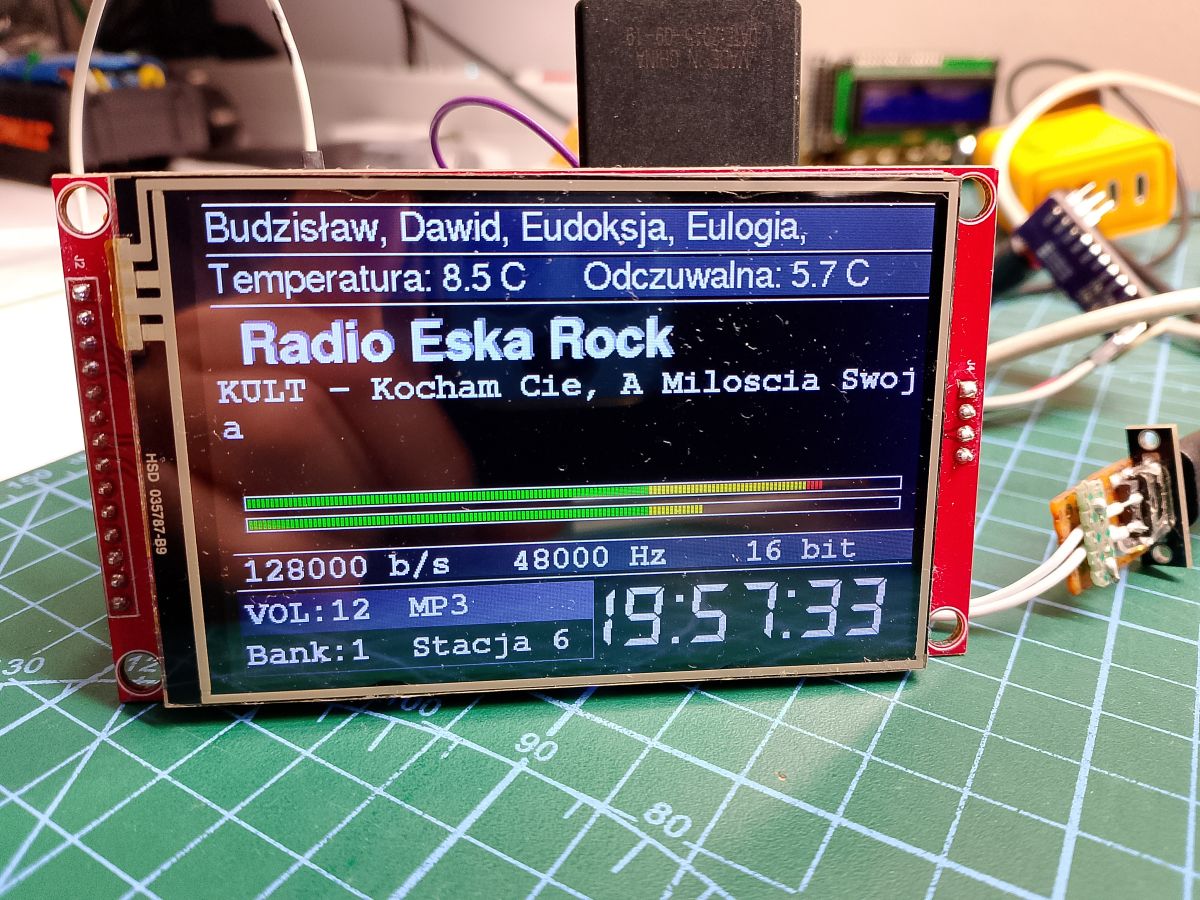

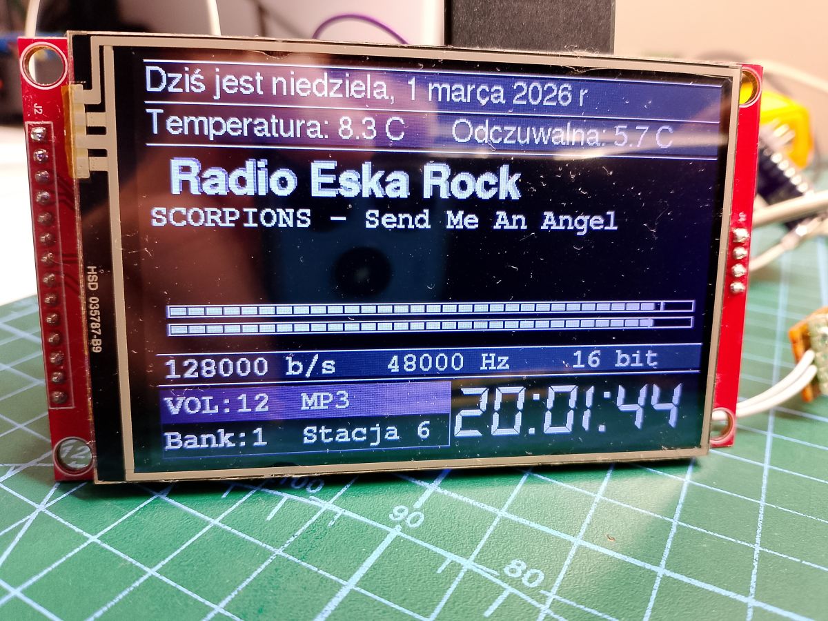

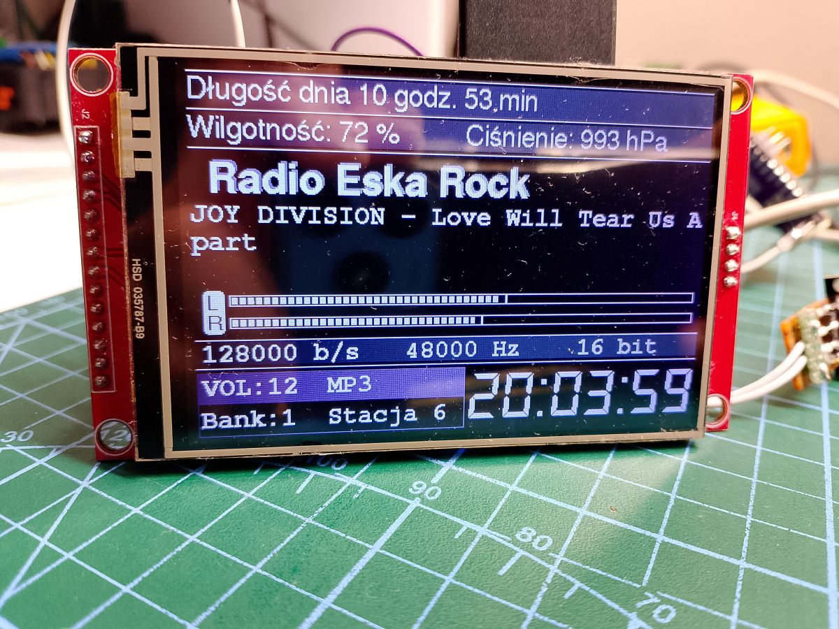

    Cool radio "KULA350"
    O to moj dalej projekt Robgolda, white vyswjetlacz, housing from satellite box....
    Prototype radio device with exposed electronics, display, and a large control knob
    Open audio device case showing circuit boards, wiring, front display, and a large control knob

    DJCheester
    Posts: 2049
    Help: 75
    Rate: 949
    >>21853745
    Cool this mod congratulations Kula350 😀
    Question did you keep the connections like MAJSTER XXL ?
    Do you still have the MP3 player ?
    Col. Suspak I see that another radio is already there 👍
    Greetings....

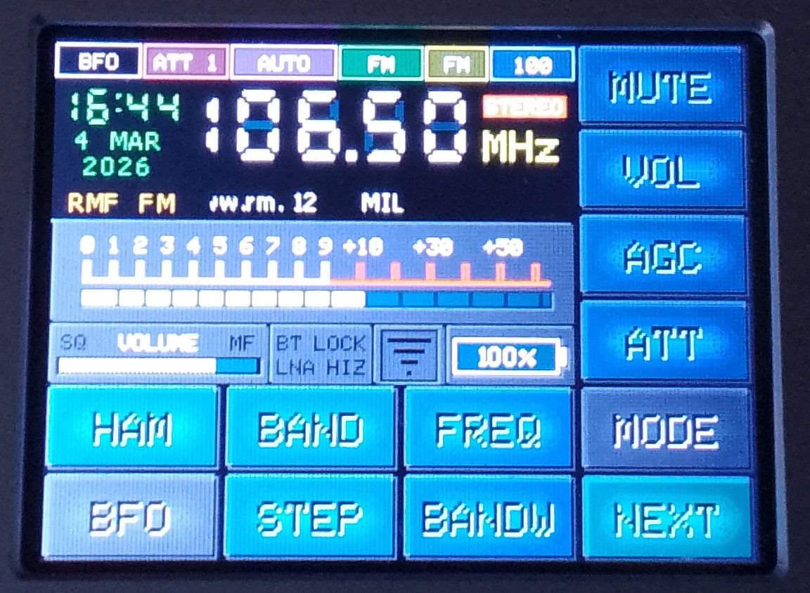

    @kula350 Bravo! Finally someone who has taken advantage of the graphic capabilities of the TFT. In my SDR, It looks like the following. The whole (touch) screen is interactive;
    Touchscreen SDR radio UI showing 88.50 MHz with on-screen buttons MUTE, VOL, AGC, MODE
  • #2396 21854322

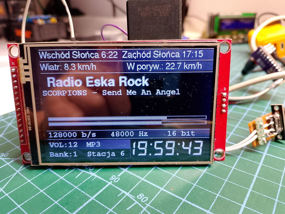

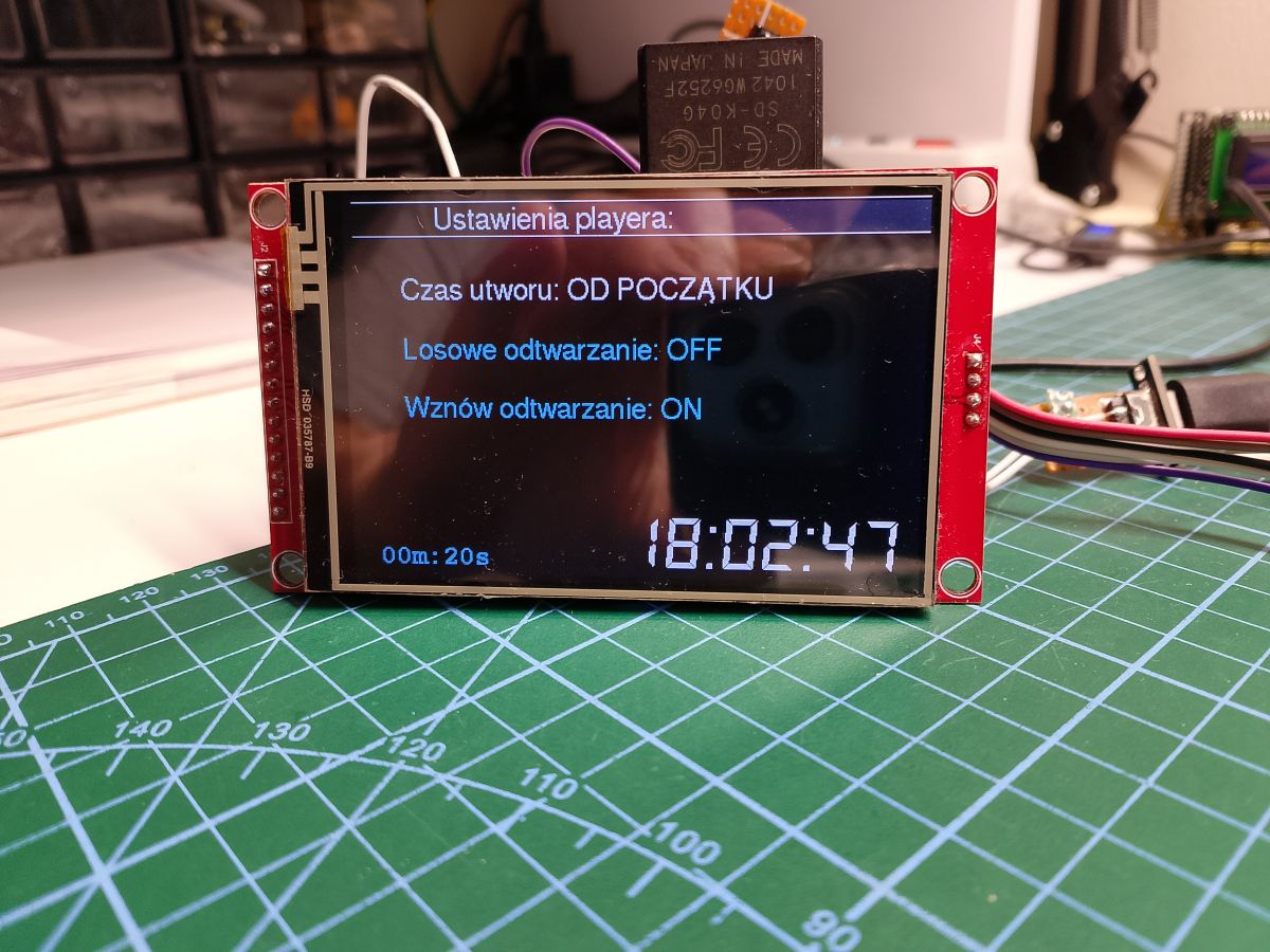

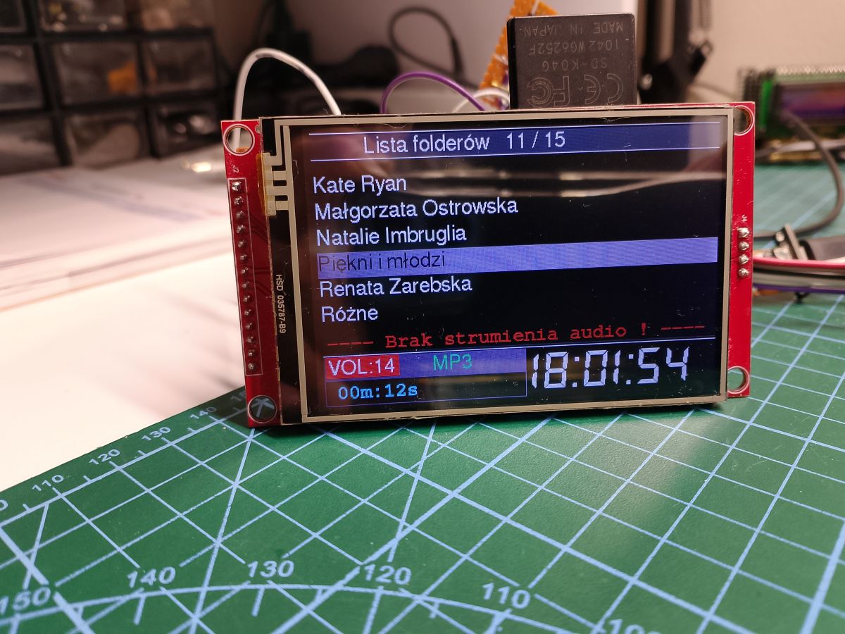

    @kula350 Beautiful work, when I find time I'll go through the code, I'll probably steal something. I was already thinking my v3 had gone into oblivion, yet it has such a cool player. State what type of display it is exactly, as I think you have some better contrast than mine, you can see as if it's in a soft gloss, in mine it's matte.
