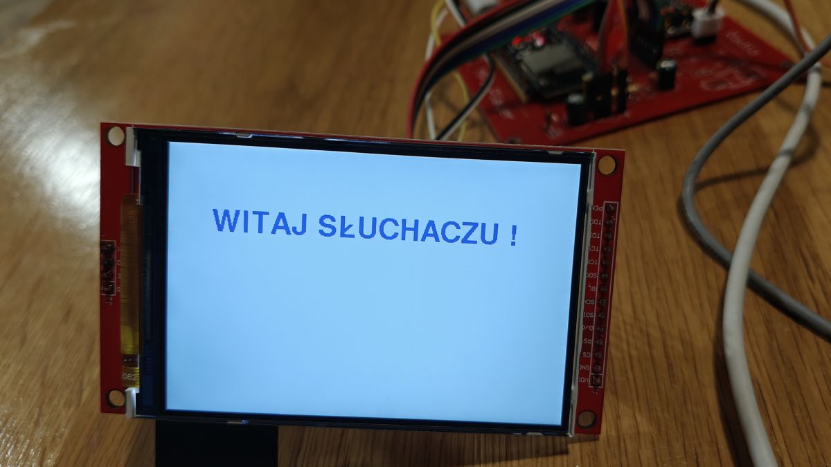

    Hello again :)
    I have built myself a circuit based on the Major's radio.
    I got this problem with the display. There are like reversed colours.
    Is it a matter of a bad display or some mistake on my part?
    Any ideas how to change this?

    dawidkosciesza wrote:
    Any idea how to change it?
    Specify the exact model of this display. It is likely to be an IPS display. They require colour inversion in the driver.
  • #2318 21842516
    dawidkosciesza
    Posts: 54
    Rate: 14
    >>21842511
    That's right, it is an IPS ILI9488 display.
    Can anyone suggest how and where to look for this setting?

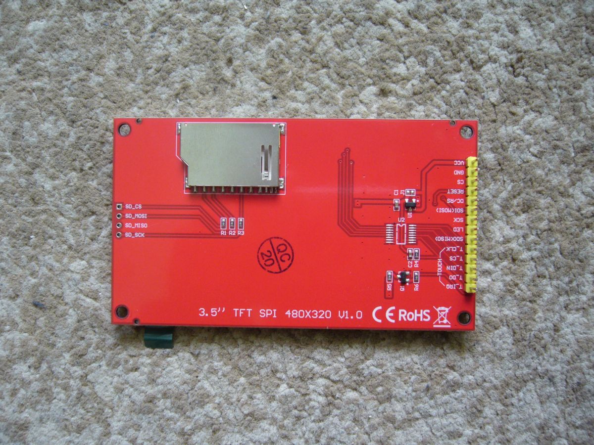

  • #2319 21842521

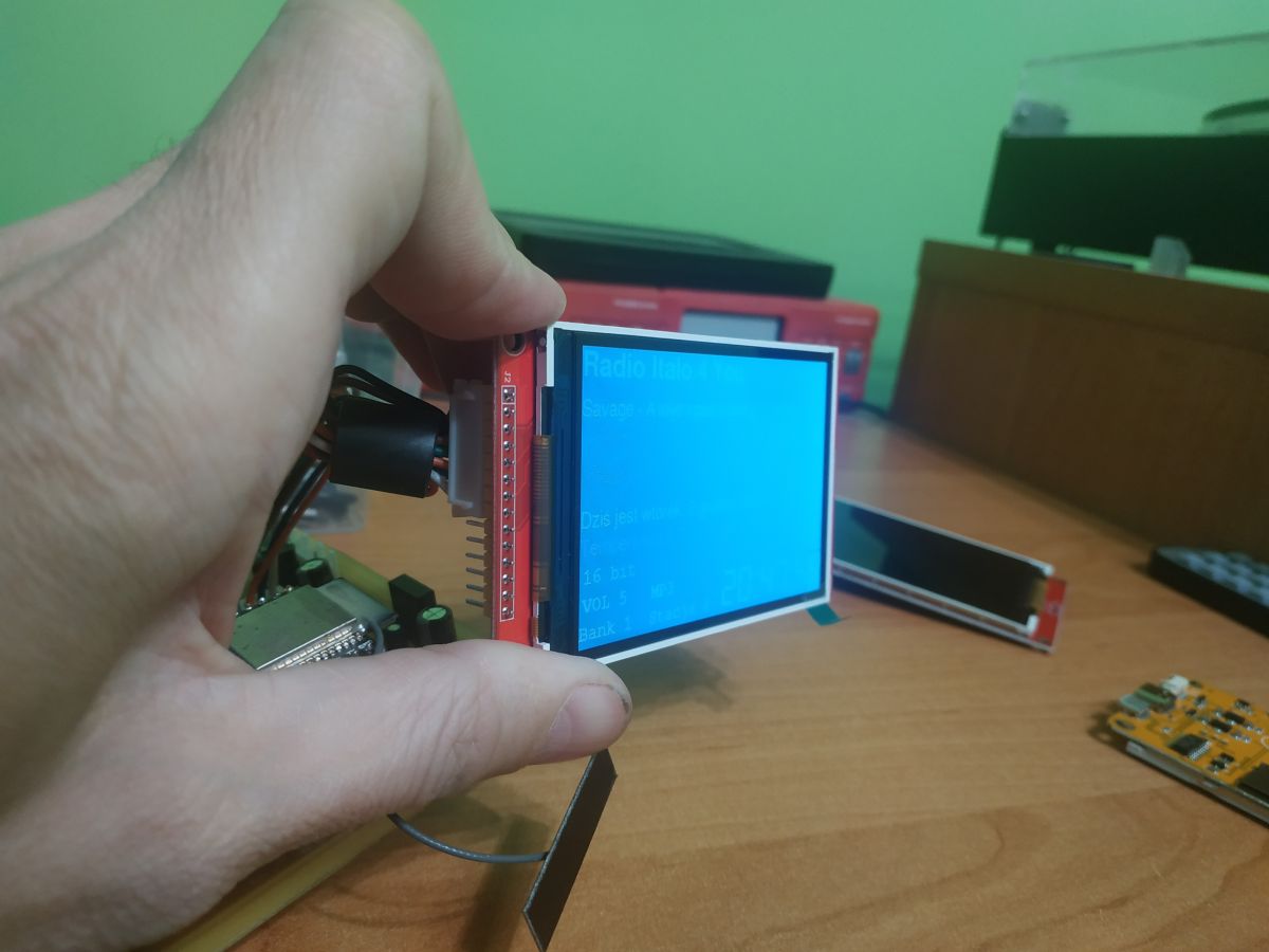

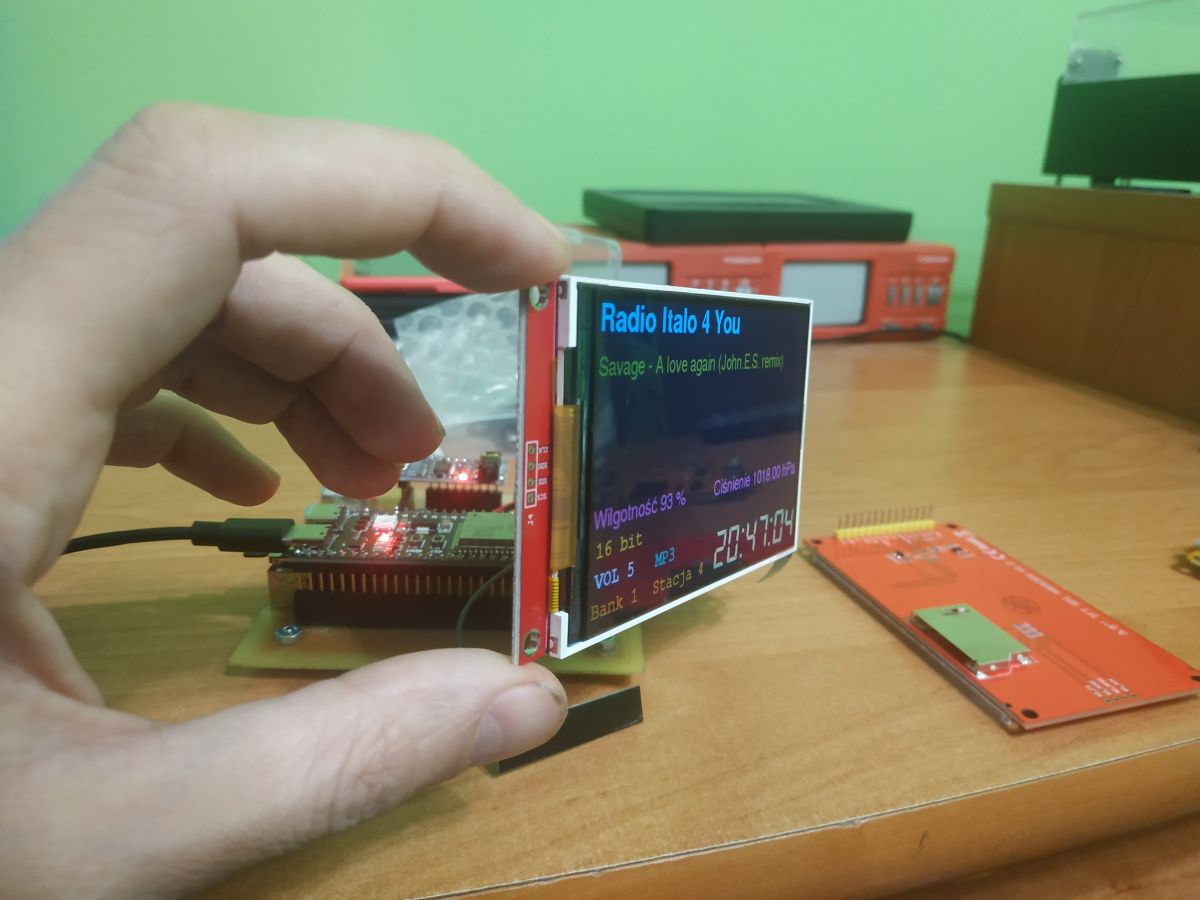

    DJCheester
    Posts: 2049
    Help: 75
    Rate: 949
    Nothing needs to be changed in the settings to work with both IPS and TN
    Hand holding a small LCD module with a blue screen on a desk with electronics in the background
    Hand holds a small color TFT display at an angle, connected to an electronic board on a desk
    The difference is in the angle of view
    Greetings....
    Added after 55 [seconds]:
    And show the back of the display ?

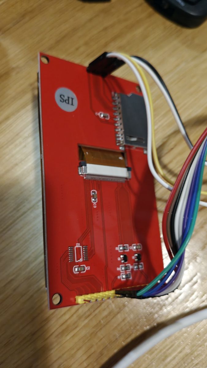

  • #2321 21842530
    dawidkosciesza
    Posts: 54
    Rate: 14
    >>21842521
    Back of the display.
    Back of a red display PCB with an FFC ribbon connector and multicolor wires on a wooden surface
  • #2322 21842546
    DJCheester
    Posts: 2049
    Help: 75
    Rate: 949
    This is mine just the same. It works without reversing the colours.
    IPS
    Red PCB on carpet with microSD slot, FFC ribbon connector, and yellow pin header on the right
    AND TN
    Red 3.5 TFT SPI 480×320 module PCB with microSD slot and labeled pin header.
    Maybe something with the screen is ....

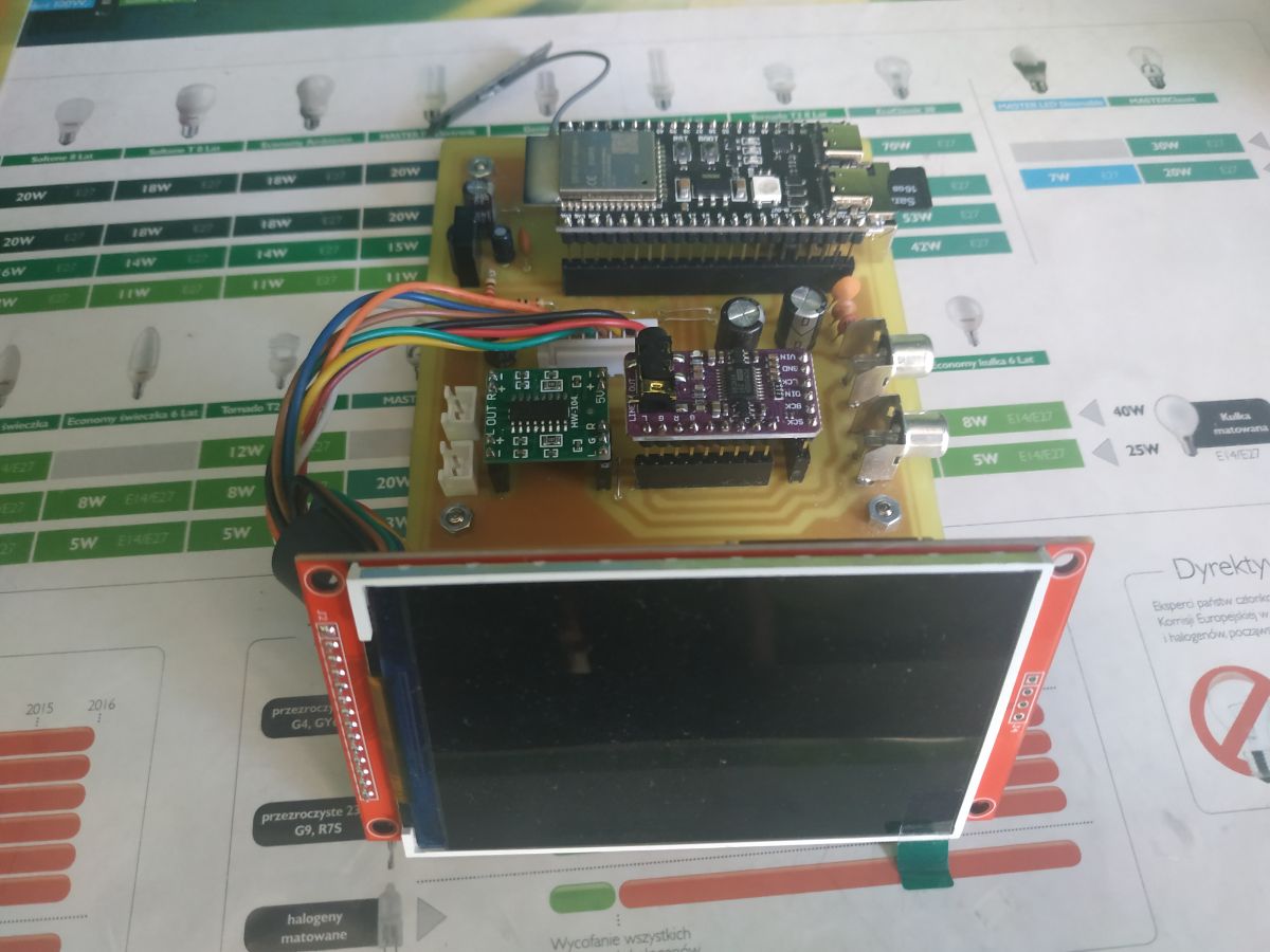

    Question, I see you have a card reader connected from the display?
    Does it work for you without any modifications?
    Because you used to have to remove resistors in these first versions?
    I haven't tested the SD connection on the LCD, in these my PCBs I use with a microSD module plugged in under ESP32.
    Prototype board with an ESP32 module, wiring, and a large LCD screen on a red PCB.
    Regards...
    Added after 1 [minute]:
    As for the sticker, I didn't have one, but I have one new display with one, I'm going to check. I'll let you know right away

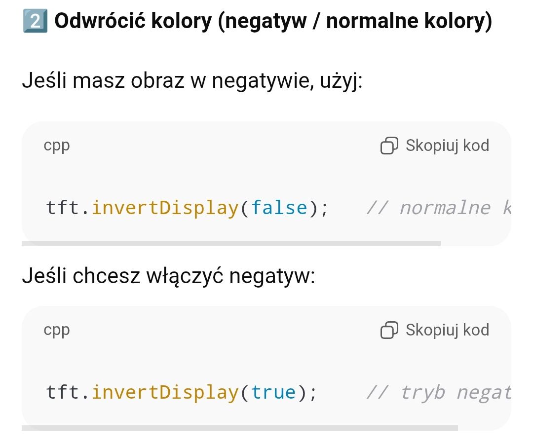

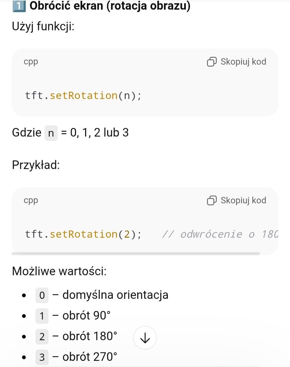

    DJCheester
    Posts: 2049
    Help: 75
    Rate: 949
    Rather, it should have no effect on the colour scheme because the card's pins are routed out only it is on the card's common ground and power supply.
    Added after 15 [minutes]:

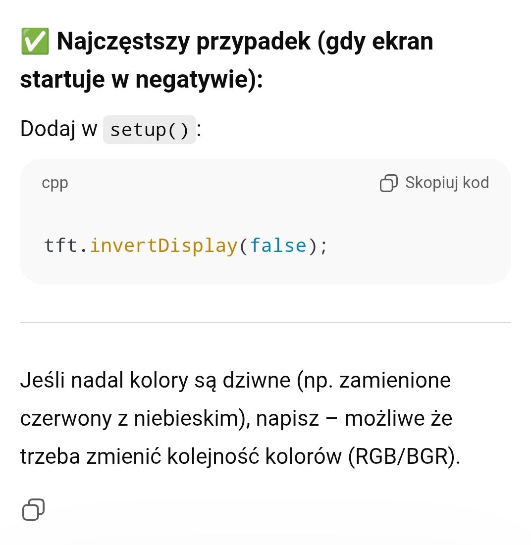

    You actually this IPS what had the sticker displays inverted the image is 180 degrees and in negative.
    There is probably a ruler in the library to reverse the image and colours
    I didn't even know, one IPS I bought and that one displays correctly like a TN and the other one I had new bought about half a year later with that sticker is just like yours.
    I'm immediately looking for the code ChatGPT hints at
    Screenshot with tip “Most common case” and code snippet `tft.invertDisplay(false);` Polish screenshot explaining display color inversion with C++ snippets using tft.invertDisplay(true/false) Screenshot showing “Rotate screen” tip with C++ code tft.setRotation(n) and values 0–3
    Greetings....

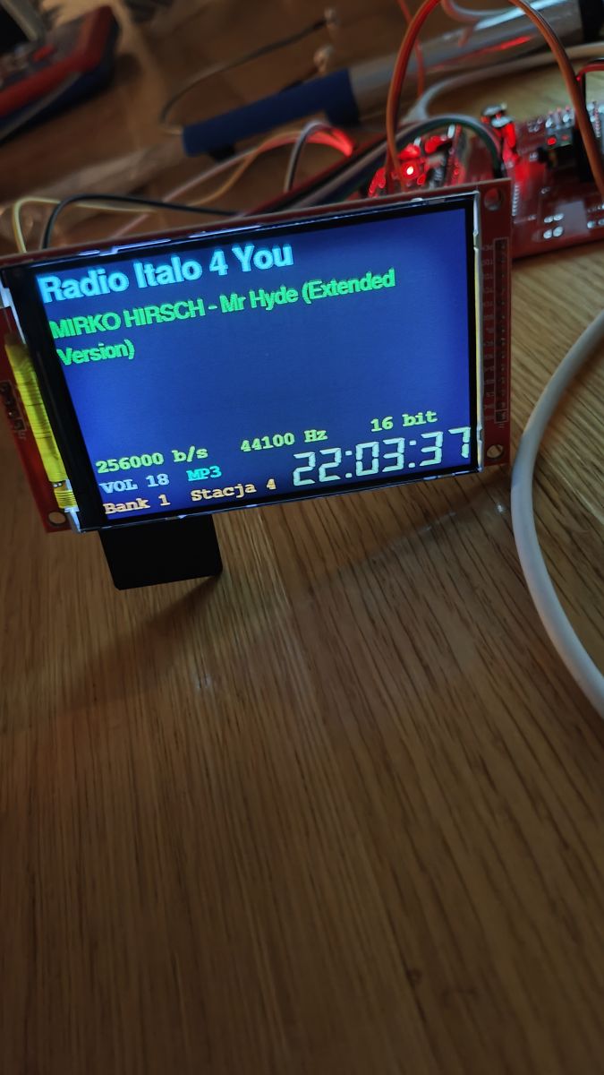

    dawidkosciesza
    Posts: 54
    Rate: 14
    Found. An entry should be added:
    tft_command(0x21);
    Jeset is a colour inversion, I added in line 869 after:
    // Image direction and orientation (MADCTL)
    tft_command(0x36);
    tft_data(0xE8); // screen orientation (rotation, reflection)
    Here it is probably possible to rotate the screen by this 180, but it doesn't make a problem for me, I simply mount it the other way around.
    Thanks for your help :D
