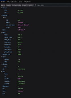

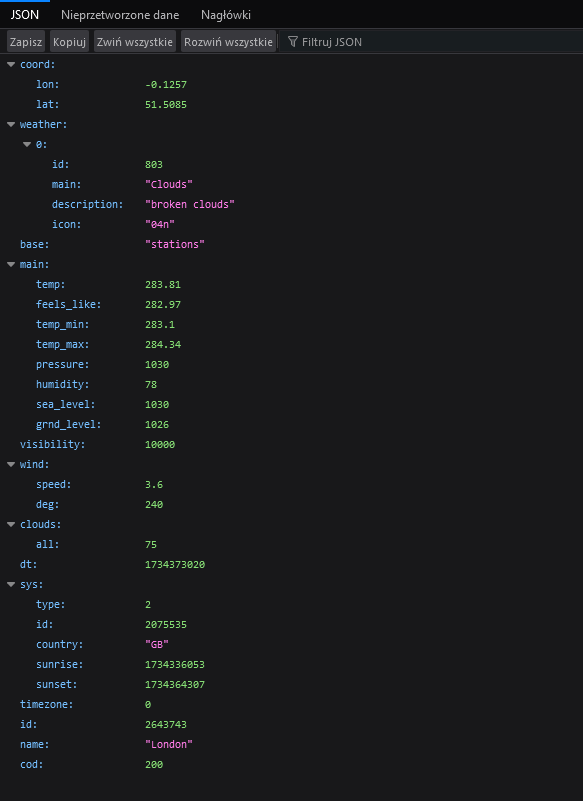

    I set up an account on openwathermap.org a couple of days ago just for the purpose of adding the weathervane to the bottom line on the radio, if the link is correct then you should see the json data in your browser as in the screengrab below. I refresh the data every 60 seconds for now. The syntax of the link under API 2.5 should be like this:
    https://api.openweathermap.org/data/2.5/weather?q={city_name}&appid={API_key}
    I entered my city and API key and it works normally.
    Screenshot displaying weather data in JSON format for London from OpenWeatherMap API. .

    Thanks for your reply. I used the source code of the author MAJSTER XXL and added my 32-bit API_key to try again.
  • #247 21353061
    gangliu2018
    Posts: 18
    I tried it yesterday, but it still gave an error.
    There is no problem with the format. After the modification, the URL can be opened with a browser. It is just that the Arduino program gave an error that it could not connect to the weather server. I will try again when I have time.

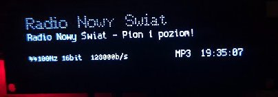

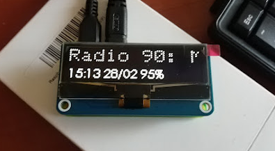

    #248 21357592
    robgold
    Posts: 726
    Help: 10
    Rate: 290
    Congrats to the author for an excellent project !!! I bow my head !
    I have already managed to run the v1 version on the current libraries. Some minor adjustments to variable declarations were required.
    Personally, I wouldn't go for any versions with a weatherman or other water features. I once made such a radio on a Raspberry Pi + OLED and scripts in Python.
    It worked nicely but the time it takes to boot up RPi vs ESP32 is a misunderstanding so the ESP version revived the desire to have this radio :) .
    Currently modifying this code for myself as for me it is missing:
    - a web server (you would need to add AsyncWeb) so that there is the possibility to edit WiFi and stream links without GitHub
    - to add support for a matrix of buttons (for modifications of current various tuners)
    - maybe I would go with the solution of a colleague from YT who describes a memory cell as P-000 and do it like this P- 1 digit bank number 2,3 digit - cell number (i.e. e.g. P-109) 1 bank, 9 station however....
    - I am not convinced that such a radio needs 15 banks, in fact 95 stations is already a cosmos listening to maybe 15-20. Factory Yamaha or Denon tuners support 50 "Favorite" stations and that is enough.
    - Get rid of the bit rate and frequency information. They may appear for a while but then they burn up the OLED pointlessly because they are static information.
    - I have already purchased the OLED for v2 - I would like to add on these new u8 libraries the "dotted" font options I used on my radio. This looks very cool. Ultimately to be fitted to the finished hardware.
    Some people will probably disagree with me, but I'll take my chances... the file player is pointless for me. Today hardly anyone listens to mp3 anymore and for music lovers FLAC is the wrong DAC. PCM is too poor in quality. You would have to use some kind of ESS and an external stabilised quartz generator (as it was, for example, in Audiphonic stremars for RPi) to be able to talk about quality. For Internet Radio it is form over content most strems are 128-256kbps in mp3 compression.
    Some pictures from my radio with the font I'm talking about
    OLED display with internet radio information and time. .
    OLED display of an internet radio showing station and time information.

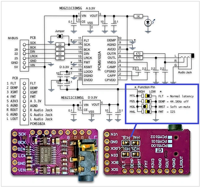

    @cubes if you are changing the 'info' data coming from the radio on the serial terminal then you should have audio output on the DAC, have you made bridges as in the screengrab below?
    PCM5102A DAC connection diagram with visible jumpers on the module. .

    MAJSTER, I have run the v2 version. It works, I didn't catch any major errors. Sometimes the display "glitches".
    For what reason did you introduce bank numbering into station files? Is this a preparation for a single file with stations in the future?
    In addition, v2 takes a very long time compared to v1 to download stations from github. Of course these are still milliseconds but it takes noticeably longer.
    There is a mistake in the schematics in the connection of the 256x64 SSD1322 display. You are using a hardware SPI with the U8G2 library and in the schematic you have swapped the physical pin numbers on the Esp32s3 board with the GPIO numbering. Please correct at your leisure.

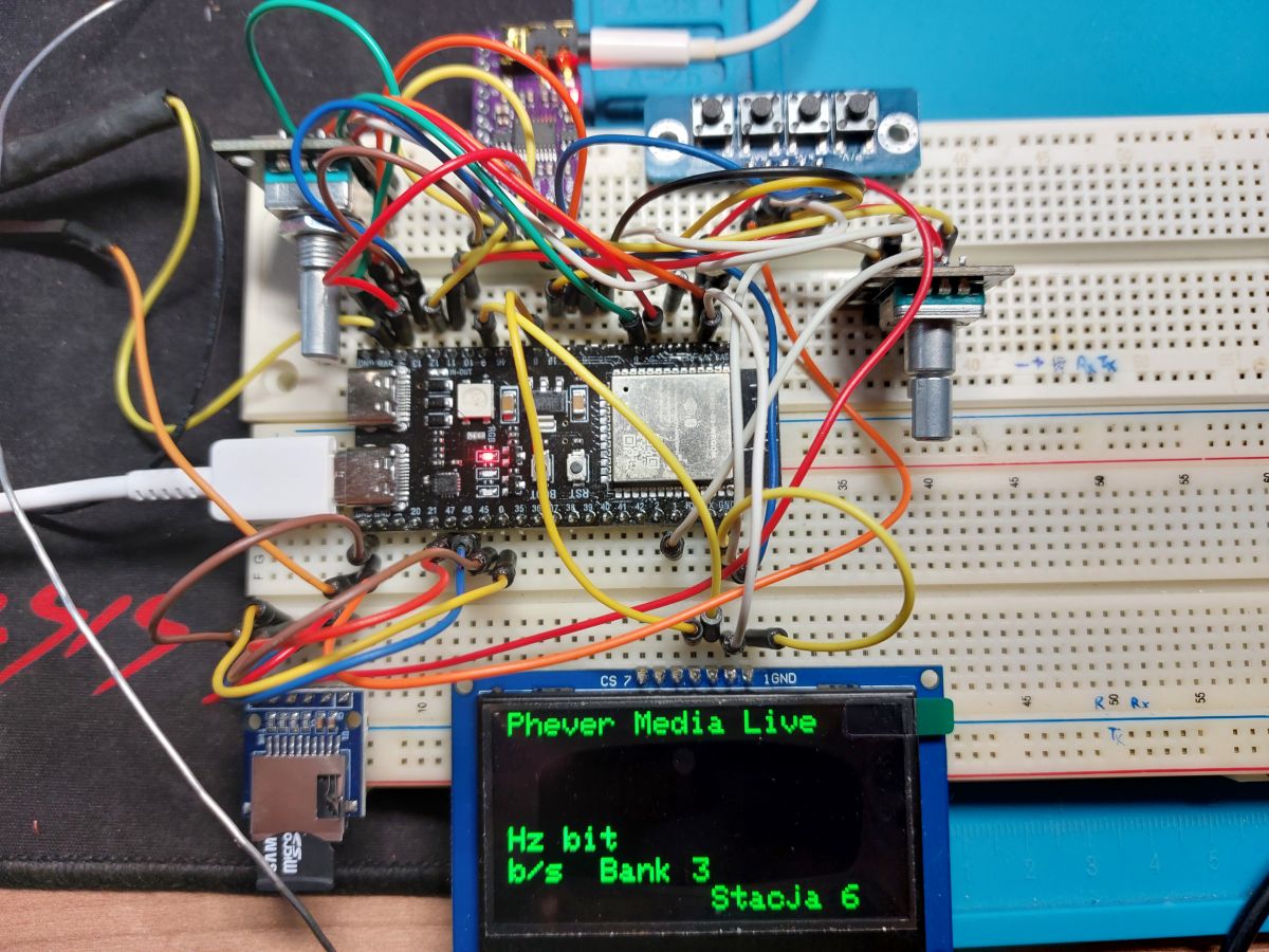

    cubes
    Posts: 111
    Help: 6
    I wrapped the display by switching to I2C mode based on:
    https://sklep.msalamon.pl/blog/modyfikacja-wy...ULuhxxuAXnFY27f95yUsC7bAbcPjjzU15wJVBAEQcx0EA
    It ran on the original code.
    @robgold - jumpers on PCM done, but still silence - no inf. on display about sampling and bit rate:
    Breadboard with an OLED display and various connected wires. .
    In the monitor I get one strange message regarding Hostaddress every time I select a station:
    Currently selected station: 16
    Station link: Radio 2.0 http://46.252.154.133:8080/;
    info Hostaddress is not valid
    The file station_nr.txt already exists.
    Update station_nr.txt on SD card.
    File bank_nr.txt already exists.
    Update bank_nr.txt on SD card.
  • #257 21358705
    MAJSTER XXL
    Posts: 2064
    Help: 164
    Rate: 429
    @robgold thanks for your vigilance, Czech mistake- I confused the GPIO port numbering of the ESP32 module with the foot numbering of the development board. I've corrected the schematic in that post and I'm also attaching the corrected one here in case you need it.

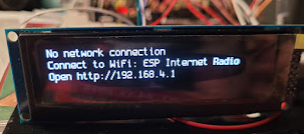

  • Check Wi‑Fi setup and network connection on ESP32-S3
    #258 21358721
    MAJSTER XXL
    Posts: 2064
    Help: 164
    Rate: 429

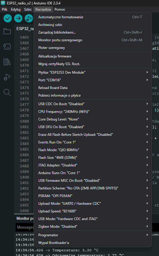

    @cubes you should have the current time on the display and info data, my guess is that you don't have a network connection, did you do the correct wifi configuration when you first started up?
    edit, in total the station names were pulling you off, see somewhere an earlier screen shot of how you should have the parameters set up in the Arduino IDE under this ESP32.
    Screenshot of the settings menu in Arduino IDE 2.3.4 for ESP32. .

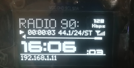

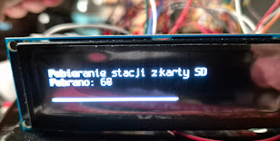

    #263 21364416
    robgold
    Posts: 726
    Help: 10
    Rate: 290

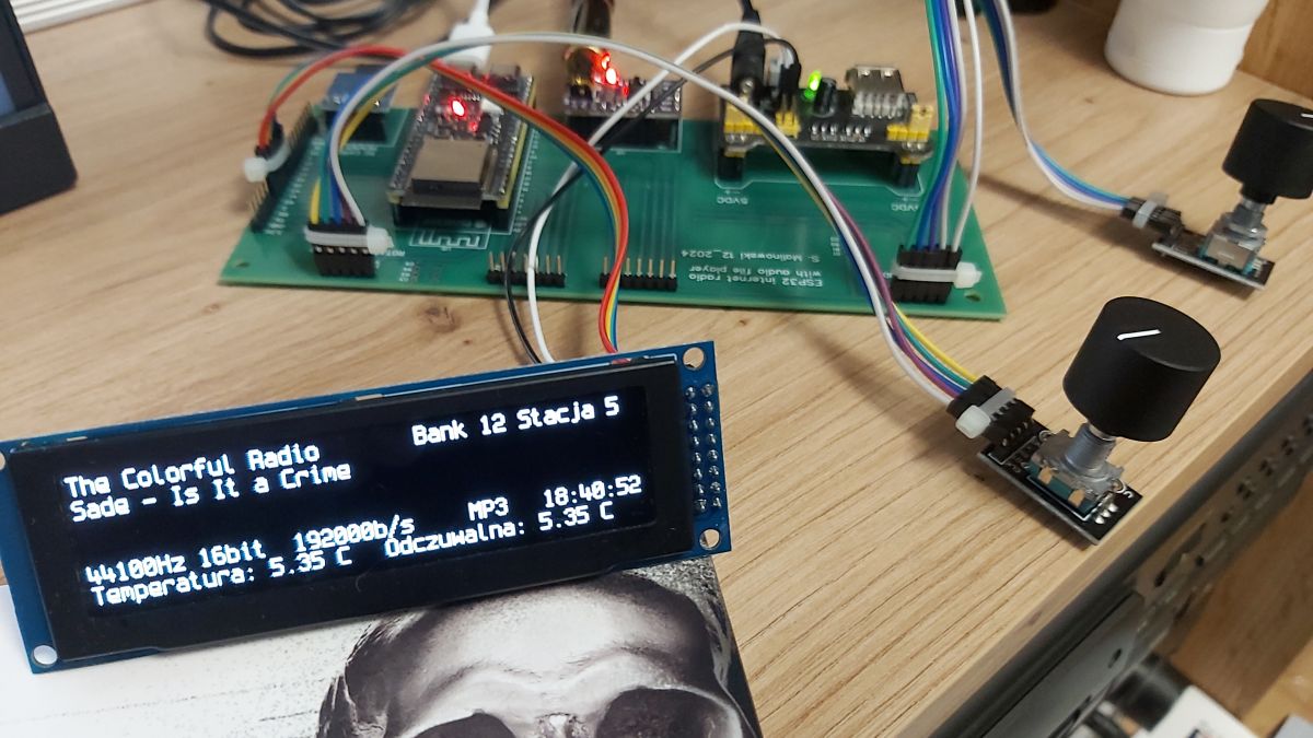

    I managed to sit on the radio a bit over the Christmas break. The project is dragging :) .
    - I added the DotMatrix font
    - I edited the Spleen font BDF file to have Polish letters and converted it to U82G format - attached if anyone would like to add it
    Admittedly, only ISO-8859-2 and Windows-1250 can be encoded in the 33-255 range, but it's always something
    Let's just say it works on most stations. The bushes are only on those using Unicode encoding
    - I have added a progress indicator for loading the station from the server
    - display of the IP number after start-up and connection to the network
    Master , trying to understand how you wanted to use the write to EEPROM. The range [MAX_STATIONS * (MAX_LINK_LENGTH + 1)] roughly exceeds the 4Kb that ESP emulates in Flash. It seems to me that the EEPROM (nvs) function will probably never write this. The only thing this creates is a large array in RAM to hold the stations. Correct me if I'm wrong.
    As a test, I reduced this size and threw myself a write test - the function started writing.
    Second thing, you keep a lot of variables like 0-255 (so one byte) as integer (2 bytes) why not uint8_t ?
    Electronic display showing internet radio information. Screen showing the progress of downloading radio stations from the GitHub server.

    #264 21364511
    MAJSTER XXL
    Posts: 2064
    Help: 164
    Rate: 429
    There's still quite a mess in the code, at the moment I've also sat on the project today, i.e. I've armed the new PCB, added the SD card reader to v2, the stations are now stored on the card so that when the power is restarted the radio goes back to the last station played. File playback from the card is also now up and running, but without the menu and display of folders and files- I need to do a lot of work here. I've also made a second encoder, in fact the first one, for now it handles the volume control.
    As for writing to the emulated EEPROM - here I haven't really thought too much about it, because somehow all the stations from each bank write and read when I request it, if I had encountered a problem I probably would have been up to something before. The fact that I'm at a resource limit, as I recently had to reduce the number of stations in a bank to 95, but extend the max characters to 110 due to the wider screen. I'll probably eventually do an SD card record of downloaded stations, but my plan is to still operate via github, as that's the most convenient way for me to update bank contents.
    I'm waiting for a new chassis to populate the v2 version, only the display and 2 encoders on the sides will remain on the front panel. I'll still upload the patches to github today, you can also look at the new banks, especially the last ones, I blew openfm because they change something there, but I added a lot of new ones, except that not all of them go either. I also did a test one bank with just FLAC, but here miracles happened including bad decoding and ESP32 reboots, so I deleted that bank for now.
    I don't think I'd be tempted to use the progress bar to load stations from the whole bank from github, as it literally takes a second.
    Overall cool that you took care of the Polish characters- I'll probably use it later, thanks!
    Electronic circuit with a display and encoders on a desk .

  • Bank payload cached to SD card for playback
    #269 21365665
    MAJSTER XXL
    Posts: 2064
    Help: 164
    Rate: 429
    I have made a small change:
    - when fetching stations from the github server with the function fetchStationsFromServer() , all payload from a given bank is saved to a created or existing bank name file on the SD card,
    - when loading a station for playback with the function changeStation() , the given station is pulled from the SD card with the corresponding bank file and with the corresponding line index from the text file.
    What remains to be done is to take the station names for scrolling with the encoder wheel, probably best from an array (42 characters * 100 stations) to make it load faster, i.e. create such an array when loading the bank payload from the server. It seems to me that reading this from an SD card is rather pointless.

    - I have unlocked the WiFi manager so that, in the event of a connection failure, it displays the relevant information on the display. Ultimately, I think it is necessary to get rid of this manager
    get rid of it and copy the SSID and password from the SD card and then delete the access file on the card. The Wifi function rewrites this to the flash itself.
    With this you could try to "fire up" a normal Web server to manage the banks via the web like JCS did.

    OLED display showing a network connection error message. Display showing a message about downloading stations from an SD card with a progress bar.
