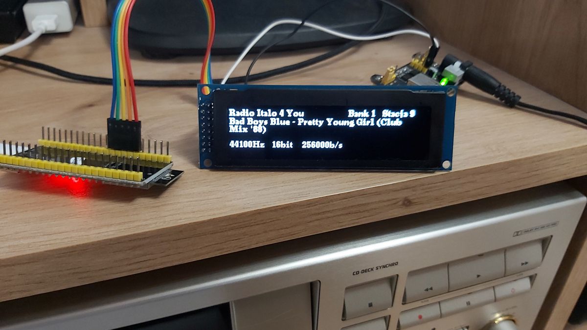

    Rate: 429

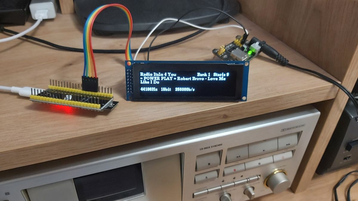

    I connected the new 256x64 pix OLED via SPI, it works fine, you will be able to fit twice as much information on it compared to the previous one, so the v2 version of the radio will already be done on this display eventually. It works based on the U8g2lib library.
    New OLED display connected to a circuit on a desk. .
  • #217 21331788
    simw
    Posts: 758
    Help: 94
    Rate: 288
    MAJSTER XXL wrote:
    I plugged in the new 256x64 OLED
    Cool. I just happen to have one, a 5 inch :) .

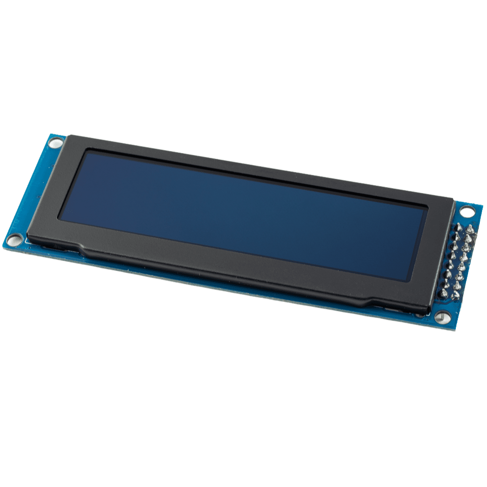

  • #220 21332497
    gangliu2018
    Posts: 18
    >>21332111
    ESP32S3 N16R8 with 8M PSRAM 16M Flash
    The new screen is SPI interface 256*64 Oled resolution

    simw
    Posts: 758
    Help: 94
    Rate: 288
    Andrzej Ch. wrote:
    Could you please provide a more accurate model of this display?
    This is probably the SSD1322 controller. On ali when you type in "oled 256 64" you can find it.
    It's interesting insofar as it provides greyscale, although I don't know if the arduino supports such a feature. Apart from that it came out in 2.8, 3.1 and 5.1 inch versions.
  • #222 21332866
    MAJSTER XXL
    Posts: 2064
    Help: 164
    Rate: 429
    Exactly right, it's on the SSD1322 controller, I'll upload the manual to have on hand. I haven't seen a 5" version and would love to purchase one.

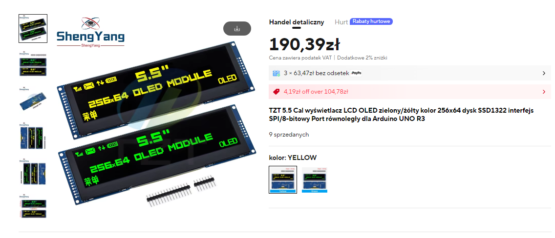

  • 3.8-inch display option found on AliExpress
    #223 21333109
    simw
    Posts: 758
    Help: 94
    Rate: 288

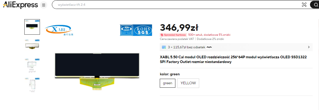

    MAJSTER XXL wrote:
    I haven't seen a 5" version, and I would love to buy one.
    There used to be such panels and even some spectrum analysers, I think.
    Screenshot of an AliExpress webpage showing the offer for a 5.5-inch XABL OLED display module. .
    I think I found
    https://pl.aliexpress.com/item/1005006048857552.html
    They have cheapened quite a lot :) .
    Screenshot of a product: ShengYang 5.5-inch OLED display. .

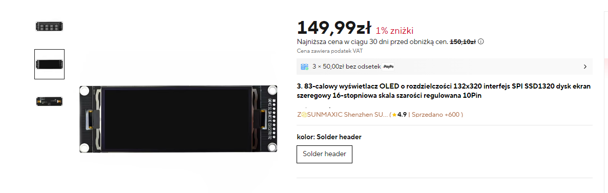

    There are also 3.8 inches with higher resolution
    3.83-inch OLED display from AliExpress priced at 149.99 PLN.

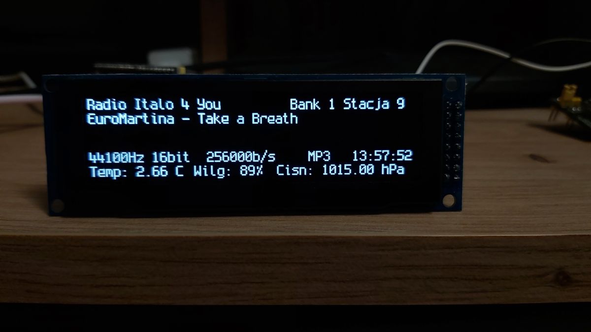

  • New display layout with station, date and weather lines
    #224 21334913
    MAJSTER XXL
    Posts: 2064
    Help: 164
    Rate: 429

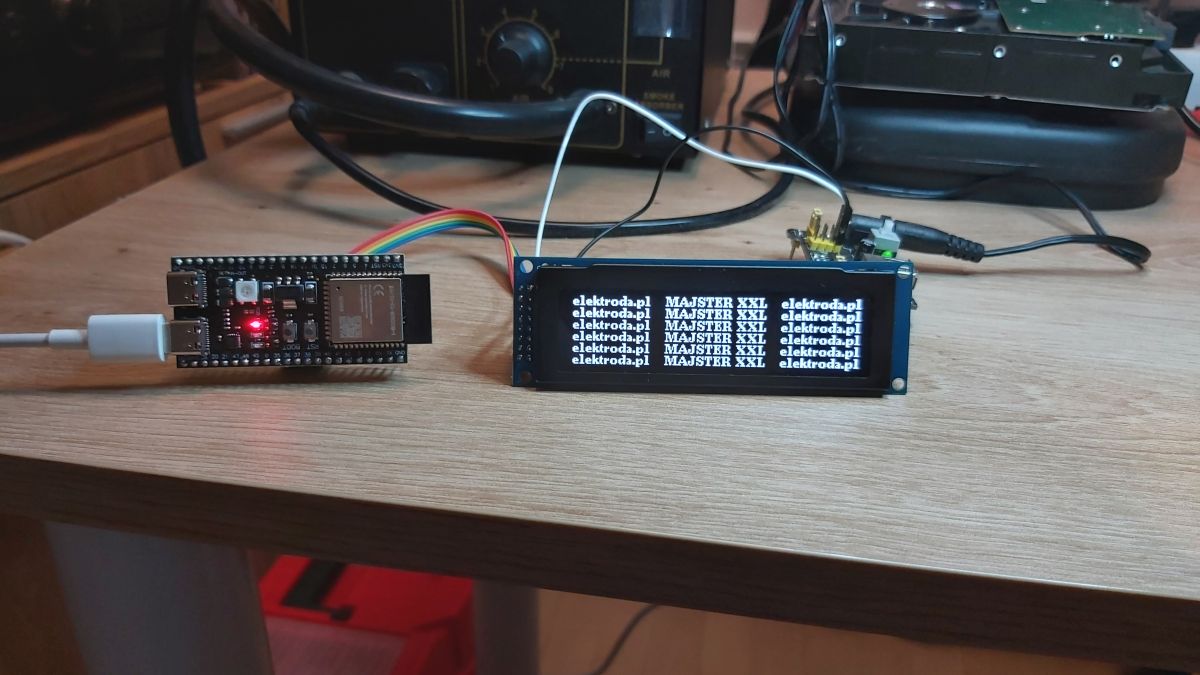

    @simw cool but bloody expensive those 5 inches, maybe one day.
    For the time being I'm slowly embracing the new display on the new library and as usual it's going clumsily, but I can already see something. So far without buttons, encoders and the DAC itself. I've got the first line display done with the station name, the bank number and station number is immediately in the name downloaded from github from the new bank- for the v2 version of the radio where more characters per line will be available. I managed to do a split of the long names on 3 lines of the screen with full words retained. Unfortunately the chosen font does not keep the same number of characters per line depending on the size of the letters or special characters- I have to choose a font with a fixed width for all characters.
    In the penultimate line I will add the current date and time at the end and in the last line the weather data based on openweathermap - we will see what comes out of it.
    Prototype electronic display on a wooden shelf, showing radio station information. .
    Small LED display showing the radio station name along with song and technical information. .

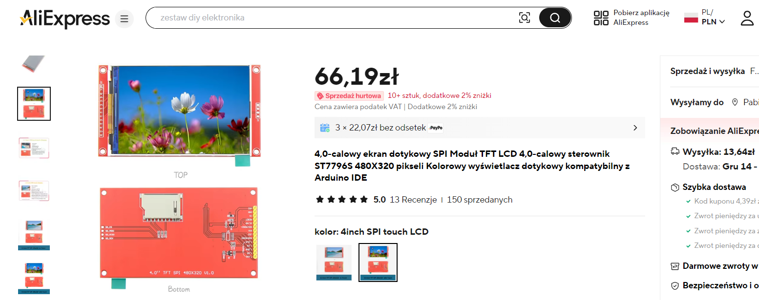

    MAJSTER XXL wrote:
    cool, but damn expensive these 5 inches, maybe someday.
    Expensive because it's OLED.
    The cheaper ones are TFT. Maybe you should have been interested in one, for example:
    A screenshot of an AliExpress product page featuring a 4.0-inch TFT LCD color touchscreen priced at 66.19 PLN. .
    It would have been cheaper, and besides, "stereo and in colour". (There are libraries for Arduino for this).

  • Hardware SPI fixed display refresh resets
    #230 21337515
    MAJSTER XXL
    Posts: 2064
    Help: 164
    Rate: 429
    Of course, it can't be too beautiful to be too good. I've encountered a strange limitation that so far I'm not managing to grasp. Namely, when the audio file format is added to the display on line 5 along with the current time, there is a screen shutdown / or some kind of reset after which it is just black. Surely this causes the need to refresh this field from the timer every 1 second. Setting it to 2 seconds also causes the screen to blackout. Only inserting a cycle for 3 seconds somehow manages this, but without some background blanking before inserting the new timer value. I can't figure it out, and so far I've tried 2 methods, drawing a black rectangle in this selected field and inserting spaces instead of data like "MP3 11:22:33". Can anyone advise anything clever? I haven't played with this library so far, I don't know if the screen driver is not working out or what else? Generally the execution of u8g2.sendBuffer(); can be seen as a slow input of data to the screen from top to bottom- it shouldn't work like that to the naked eye. Perhaps the screen driver can't cope with such a fast refresh rate? I am attaching a video of what this looks like and the source code for v2, which is on the fly for now and there are many lines commented out.
    In the setup I have in line 1594:
    timer.attach(3, updateTimer); // Set the timer to call the updateTimer function
    and then from line 1322:
    void updateTimer()
    link to v2 code on github:
    https://github.com/sarunia/ESP32_radio_player_v2/blob/main/ESP32_radio_v2/ESP32_radio_v2.ino
    Added after 2 [hours] 3 [minutes]:
    OK, I've almost got it figured out, swapping from software SPI to hardware SPI helped, the screen went right back to the correct position (previously it was flipped 180 degrees) now it refreshes every second with no reset and no screen float, just need to work out the field blanking before inserting a new value.
    Added after 1 [hour] 1 [minute]: .
    After changing to a fixed-width font like this (u8g2_font_spleen6x12_mr), everything, for me, became more readable and the problems with leftover rubbish seconds on the display stopped. It is now finally as it should be and stable.

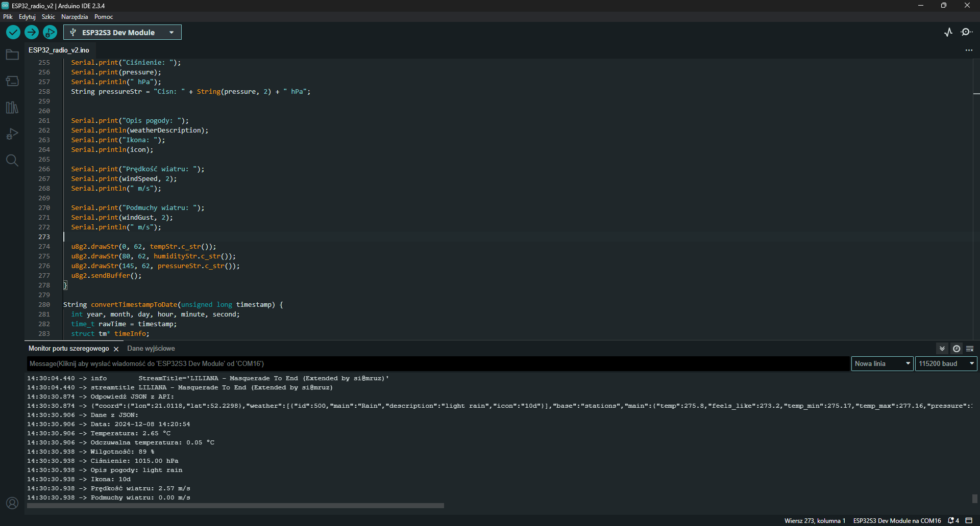

  • OpenWeatherMap weather display refreshed every 30 seconds
    #233 21338559
    MAJSTER XXL
    Posts: 2064
    Help: 164
    Rate: 429
    @ArturAVS It seems to me that the u8g2.sendBuffer() function refreshes the whole screen, i.e. spits out the contents of the buffer with the current changes. The question is how this is physically controlled by the display controller afterwards, maybe it only refreshes the changes - I don't know. Today I made a weatherman, the data is pulled from the OpenWeatherMap server from the location indicated. You have to create an account with them to generate an API number, which is then used to generate a link with the location. You then need to receive the data as JSON and format it appropriately for the terminal serial and display. For now I'm inserting 3 parameters from the weatherman, but I'll probably do a floating line with the city name and all the received data. I refresh the download from the server with a timer every 30 seconds on a trial basis- it looks promising, picture below:
    Display showing information about playing music and weather parameters. .
    Screenshot of Arduino IDE displaying code for weather display. .

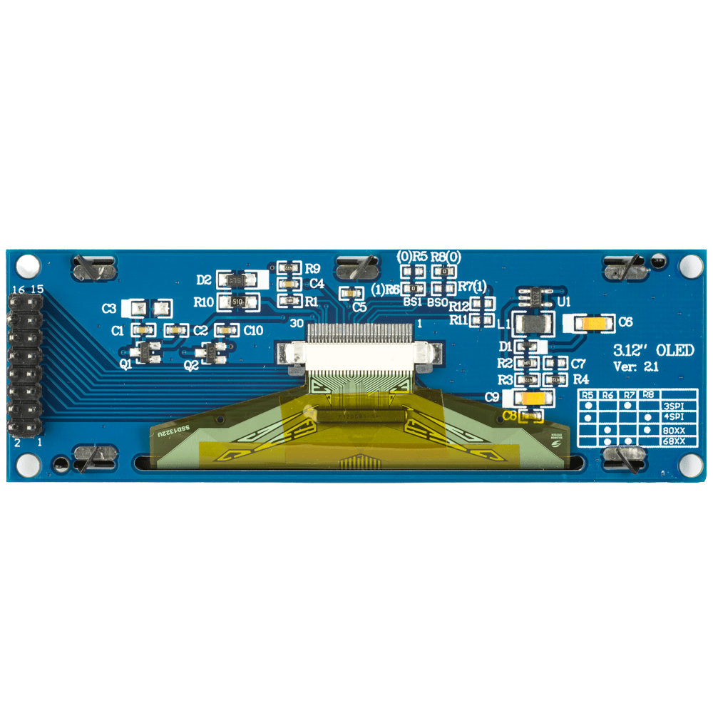

  • Bank selection and 4-wire SPI display jumper added
    #239 21348181
    MAJSTER XXL
    Posts: 2064
    Help: 164
    Rate: 429
    I added the bank selection, the entrance to the function is by holding down the encoder button for 3 seconds, then using the encoder wheel you select any bank number and confirm with the encoder button. Once the station is played, using the encoder wheel you get access to a scrolling list with the content of downloaded stations from the selected bank, the currently selected station on the list is highlighted, just confirm it with the encoder button. For now I am using one encoder, the second encoder will have the same functionality as the original v1 version of the radio, i.e. station volume control and menu function switching. You could also think in the future to include one byte in the station link at a fixed position in the array and store the volume there. Then, when switching channels, the volume parameter would be automatically adjusted to equalise the level on the line input for the amplifier.
    Regarding the display itself, I am attaching a wiring diagram and how it looks from both sides. Important, you need to solder a jumper to make it work in 4 SPI mode:
    LCD display with a blue background on a blue circuit board with pins on the right side. 3.12-inch OLED display module with visible connectors and components on a blue board. .
