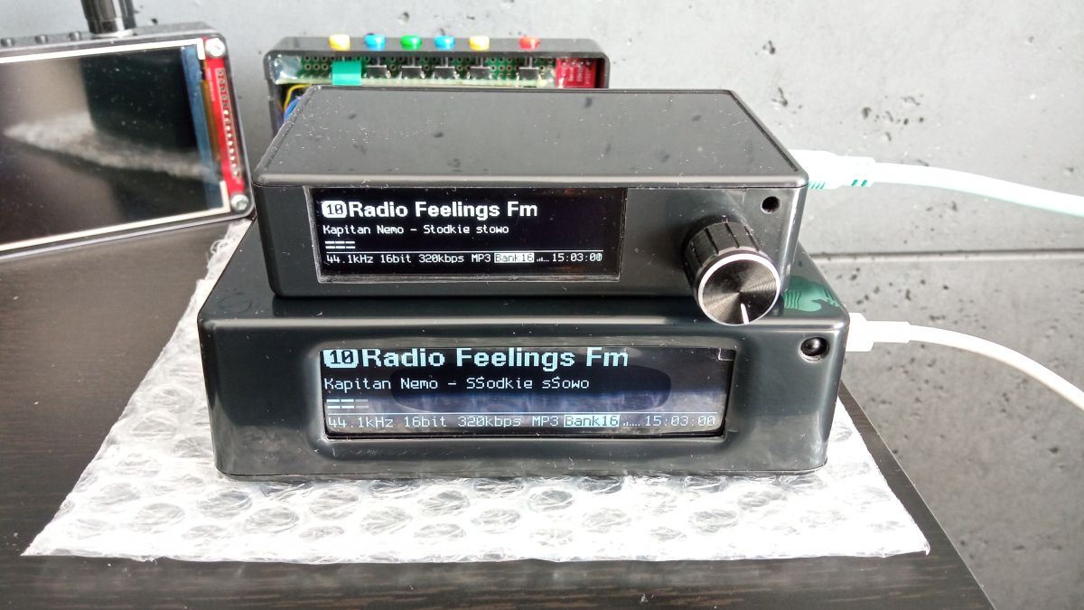

    I confirm, I also have no Polish characters.
    The small radio with soft v3.17.65, and the big radio with soft from yesterday v3.17.77
    Two black internet radio players with LCD displays showing missing Polish diacritical characters. .

    Yes, my mistake when I was testing the Scroller functions on the web I disabled the processing of Polish characters for a moment. I'll upload the fixes along with some other changes tonight.
    @hevet The problem turned out to be more complicated with this display, but kudos to you for spotting it. I've introduced a completely separate variable for web processing. This is due to the fact that WS accept text in UTF-8.
    @Lechuuu Very nice design. Like the larger display ?
    PS In the new softy you will have a problem, you have to for the second radio change the hostname to esp32radio2 or whatever. type "esp32kitchen" because the names will overlap for you. In the future I plan to make a counter that detects the host and they will number esp32radio, esp32radio2, esp32radio3, esp32radio4.... etc.

    @robgold I'll remember before compiling to change hostname to something else. The big display is cool, you can't hear the inverter and there's no junk in the audio track either. Only thing I noticed is that the pixel colour is not as white as in the smaller one (brightness settings the same for both). The housings are such monstrosities - there are no cool plastic housings on the market, you sculpt from what is there.... It would be useful to have some Bamboo 3D in the future.

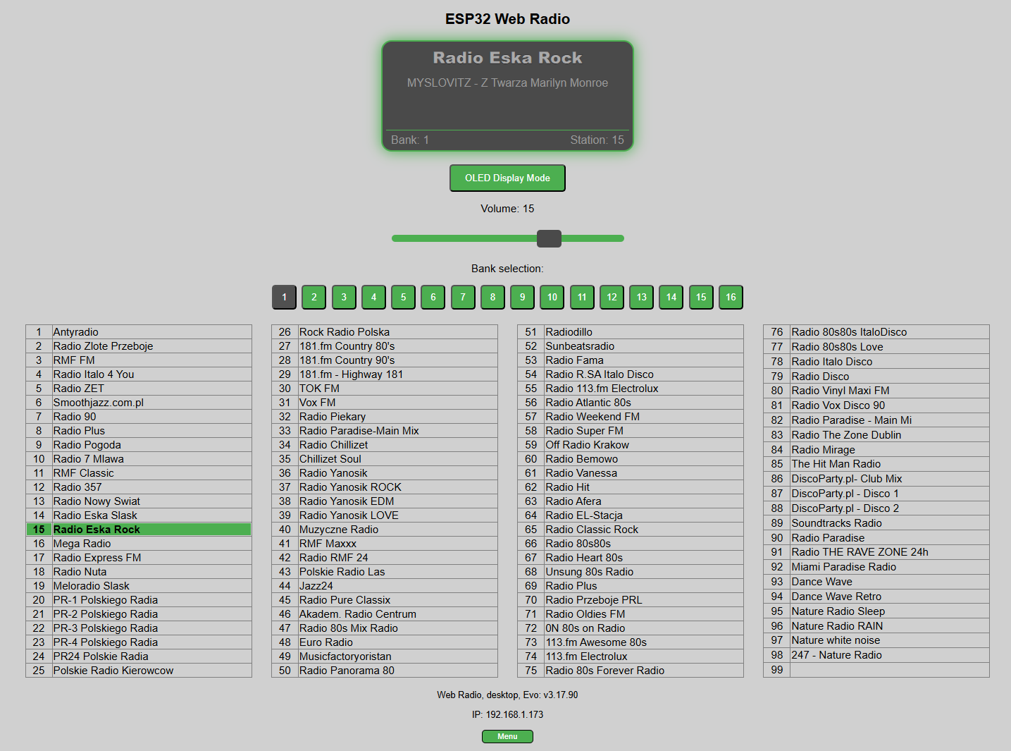

    I have uploaded version 3.17.90 to GitHub
    - corrected PL fonts
    - corrected display of station text on www page
    - There is no longer scrolling station text on a web page. Everything is displayed as text in 3 lines
    - volume slider now reacts to the mouse wheel
    - all data updates on the web page are done via websocket, I removed the whole "processor" from AsyncWeb
    - I changed the description for volume range changes in the configuration: Max Volume Extended range -> 1-21 [Off], 1-42 [On].
    - changed the display order on the web page Bank/Station instead of Station/Bank which seems natural, first the bank number then the station number
    - I reduced the font size of the station list from 1.1 to 0.95 so that the whole thing fits on a fullHD monitor in a browser without scrolling
    - the menu button at the bottom of the page is in the style of the other buttons

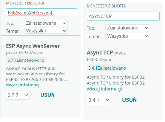

    After completing all the missing libraries, I get this error when compiling. And that I am a couple of days old in arduino :) not really know what to do next:) .
    Code: Arduino
  • #1180 21547652
    robgold
    Posts: 726
    Help: 10
    Rate: 290
    What version of the ESP Async WebServer library do you have, AsyncTCP ?
    You may have incompatible versions. I am currently using ESP Async 3.6.0, AsyncTCP 3.3.2
    Have you tried changing the h-file:

    #1181 21547665
    nouki
    Level 25  
    Posts: 1222
    Help: 28
    Rate: 98
    Code: Arduino
    after changing to another library another error occurs
    Code: Arduino
  • #1182 21547674
    robgold
    Posts: 726
    Help: 10
    Rate: 290
    Do you have these versions installed ? Because Arduino is not Platformio it will not work for you to write #define ASYNCTCP_VERSION "3.3.2".
    Show a screenshot of the library manager.
    I took a peek in Visual Studio/Platformio and there it compiles the radio with ESP32Async/ESPAsyncWebServer @3.7.2
    and ESP32Async/AsyncTCP @3.3.6 so the latest libraries also work.
  • Const-correctness error in AsyncWebServer status() call
    #1183 21547679
    nouki
    Level 25  
    Posts: 1222
    Help: 28
    Rate: 98
    The current library is
    https://github.com/ESP32Async/ESPAsyncWebServer
    same error as above.
    I have installed another
    Screenshot showing Arduino Library Manager with ESP Async WebServer version 3.7.7 and Async TCP version 3.4.1 installed. .
    now there is this error
    Code: Arduino

  • Fresh library versions compile and run successfully
    #1185 21547890
    robgold
    Posts: 726
    Help: 10
    Rate: 290
    @nouki I don't know what you are doing wrong or which library you have in the wrong version. I uploaded on a completely fresh Arduino compilation with libraries as below:
    ESP32 Core 3.0.7
    AsyncTCP - 3.3.6
    ESP Async 3.7.2
    i2s audio 3.0.13
    The rest of the libraries as on GitHub and everything compiled elegantly.
    Second attempt (latest libraries) on:
    ESP32 Core 3.0.7
    AsyncTCP - 3.4.1
    ESP Async 3.7.7
    i2s audio 3.0.13
    On both the official release ino 3.17.90.
    Also a complete success !
    The sketch uses 1933253 bytes (57%) of program memory. The maximum is 3342336 bytes.
    Global variables use 69348 bytes (21%) of dynamic memory, leaving 258332 bytes for local variables. The maximum is 327680 bytes.
    @DJCheester In theory it shouldn't. I tested this by uploading the soft via OTA and it didn't delete. I don't currently have a radio playing with SPIFFS to test this for you.

    After a battle since the last post lasting 2h went:)
    Code: Arduino
    Come on, I don't know why the difference :) .

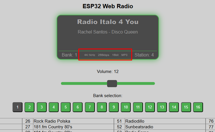

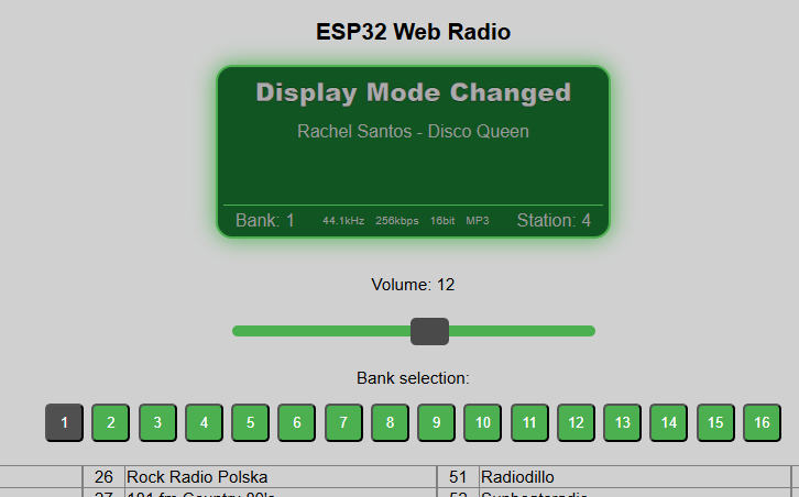

    I have uploaded version 3.17.99 to GitHub
    I improved mainly the web interface:
    - stream information in the "www display" window (bitrate, sample rate, encoding i.e. e.g. 44.1kHz, 16bit 128kbps)
    - information on www "no audio stream" if our player cannot find the URL or the stream has stopped playing for some reason
    - there is no OLED Display Mode button. Now pressing on the "display" window on the www performs the Display Mode functions.
    ESP32 Web Radio panel showing currently playing station, stream parameters, volume control, and bank selection. .
    Screenshot of the ESP32 Web Radio interface with a green Display Mode Changed message, volume slider, and station bank selection buttons. .
    For those who use OTA via the website. Please do not update the I2S library. There is a problem, after updating to 3.0.13 the ESP module can't accept the file or will accept 4-10kb and loses the WiFi connection. Tested on Arduino and Platformio. Effects are the same.

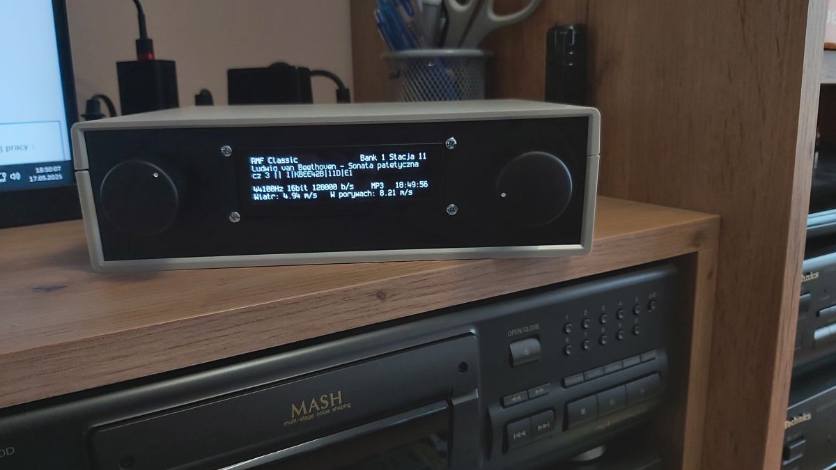

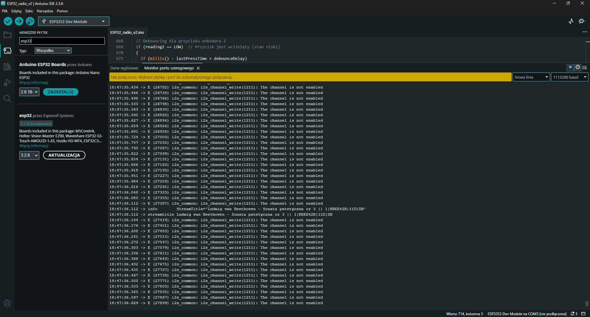

    Hello after a little break, such is my case today, I finally reassembled my v2 version into a new chassis (as it finally came on sale at TME), once assembled everything started up and played as expected. Well, I decided to run the Arduino IDE, which I haven't switched on for a long time, and rebuild the code and load what I had last time I checked (the same as on my github). What was my surprise that now I have no audio output at all, all the radio functions work normally. I did an update of the Arduino IDE to the new version 2.3.6 - no change. I did an update with the board manager as it was calling something out there. ESP32 on version 3.2 as soon as connected to wifi resets the chip non-stop- well crap to the max. I reverted from ESP32 to version 3.1.3 the module now boots normally, but still no audio. Can anyone suggest what has happened here?
    A modern DIY internet radio with an LCD display on a wooden shelf, showing track information. .
    Screenshot of Arduino IDE 2.3.6 with board manager and console, showing multiple The channel is not enabled errors from i2s_channel_write for ESP32. .
  • #1190 21552050
    MAJSTER XXL
    Posts: 2064
    Help: 164
    Rate: 429
    Great, that was it. I wonder, by the way, what kind of battered versions came out.
  • #1191 21552052
    hevet
    Posts: 347
    Rate: 47
    There is precisely an error with I2S from one of the higher ones.
  • #1192 21552069
    robgold
    Posts: 726
    Help: 10
    Rate: 290
    The DMA access in the new ESP is implemented differently from what I understand on Wolle's website, but if you take the latest ESP package and manually replace the library with the latest one from this week with the stopSong fix, both radio and mp3 player should work.
