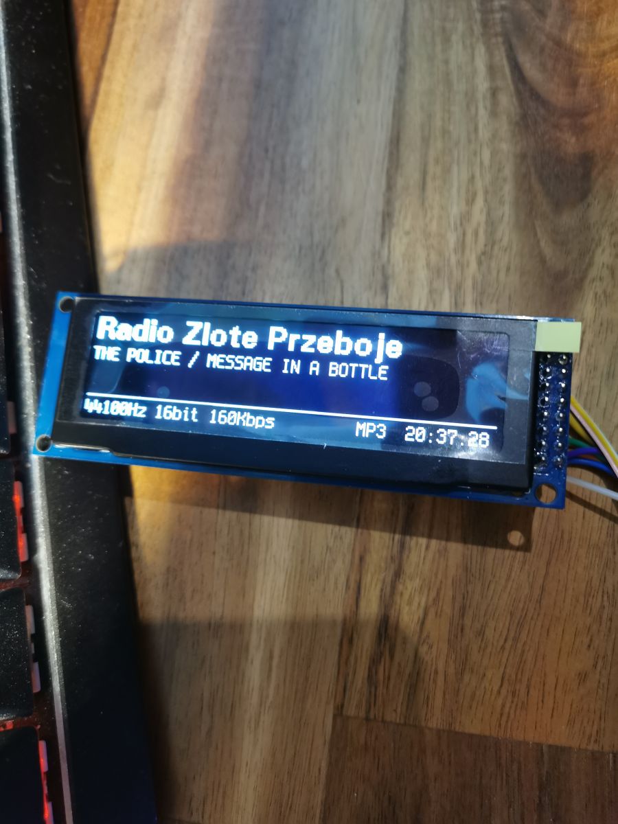

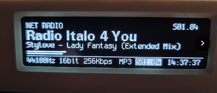

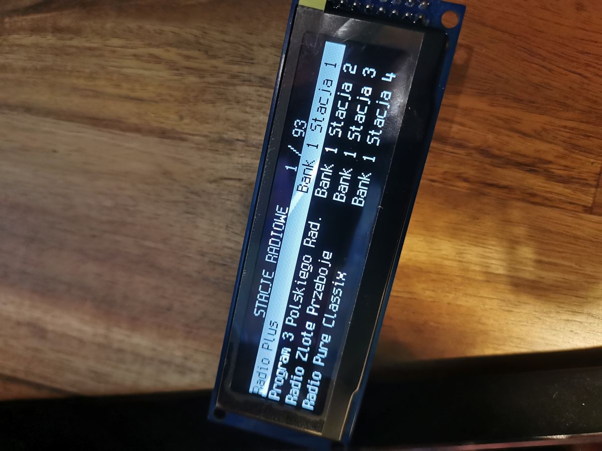

    @atu1981 show some photo's of what it looks like in your display and what spider of connections you have.
  • #302 21377259

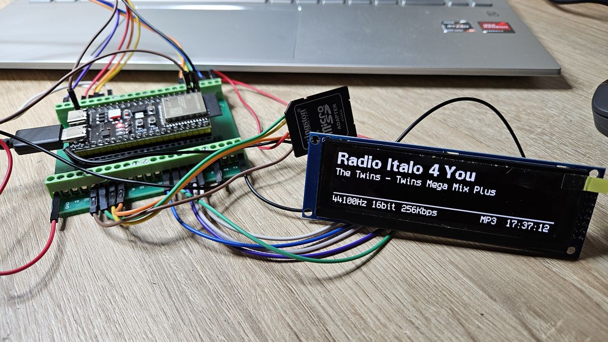

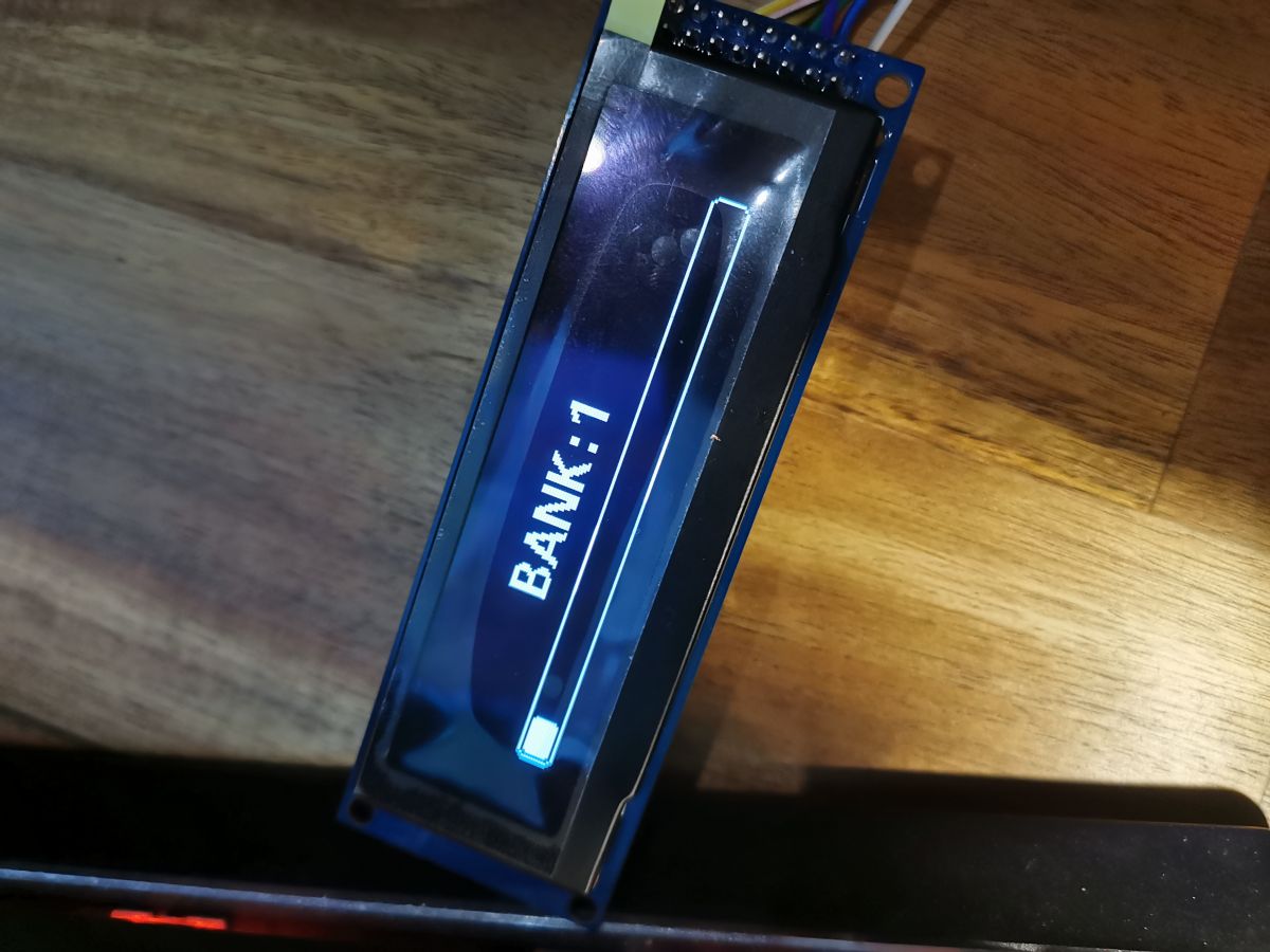

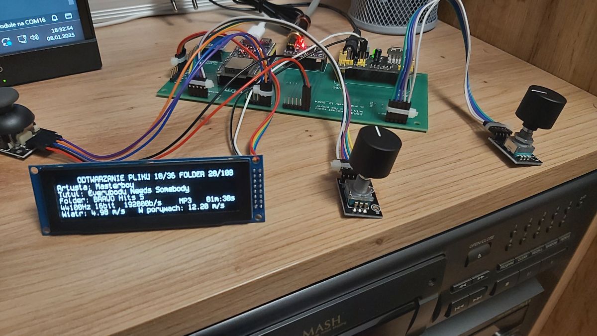

    atu1981
    Posts: 11
    the spider's web is so spontaneously woven.... and with the rest you laugh :-) but most importantly it works!!! And thanks to you colleagues @Majster XXL and @robgold!
    Complex electronic setup with wires connecting various modules on a desk. .
    Screen displaying information about the song Message in a Bottle by The Police on Radio Złote Przeboje.
    Screen displaying BANK: 1 with a horizontal bar on a wooden surface. .
    Electronic device screen displaying a list of radio stations. .
  • Missing bank file check caused bank_nr to reset to 0
    #303 21377400
    robgold
    Posts: 726
    Help: 10
    Rate: 290
    Thanks to you, I discovered that when doing a card read, I did not set the action when the station and bank file were missing.
    As a result, the variable bank_nr took the value 0 and such a bank does not exist on the server and therefore you did not want to download it.
    On the other hand, when you turned the encoder, you set the bank_nr variable to a range of 1-15 and it worked.
    New file on GitHub.

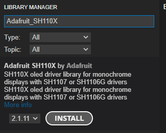

    gangliu2018 - after your advice with the libraries (on the 7th page of this thread), I received the same error when compiling !
    Compilation error
    In the file attached with \ESP32_radio_player-main\ESP32_radio_player.ino:7:
    c:c:\nDocumentsArduino_braries/Adafruit_SH110X/Adafruit_SH110X.h:27:10: fatal error: Adafruit_GrayOLED.h: No such file or directory
    27 | #include <Adafruit_GrayOLED.h>
    compilation complete.
    exit status 1
    After updating the libraries - mainly Adafriut GXF - the errors have already rained so many that I just give up. What am I doing wrong?
    Would it be possible to include on Github all the libraries at which this can be compiled ? My request is to the Founder of the thread or other users of this project. Thanks in advance.
  • Install Adafruit SH110x for v1 or use u8g2 for v2
    #309 21381799
    robgold
    Posts: 726
    Help: 10
    Rate: 290
    As I understand, you are trying to run the v1 version. And do you have the Ada library installed for the SH110x ?
    Alternatively, drop the library into the folder where Arduino keeps the libraries.
    C:YOUR USER NAME IN WINDOWSAppDataLocalArduino15 libraries_radio_playerAdafruit_SH110X
    In MAJSTRA XXL's colleague for version v1 you have all the libraries on GitHub:
    https://github.com/sarunia/ESP32_radio_player
    For version v2 you don't need support for the SH110x display at all because it's not there. It has been replaced by the u8g2 library for the SSD controller.

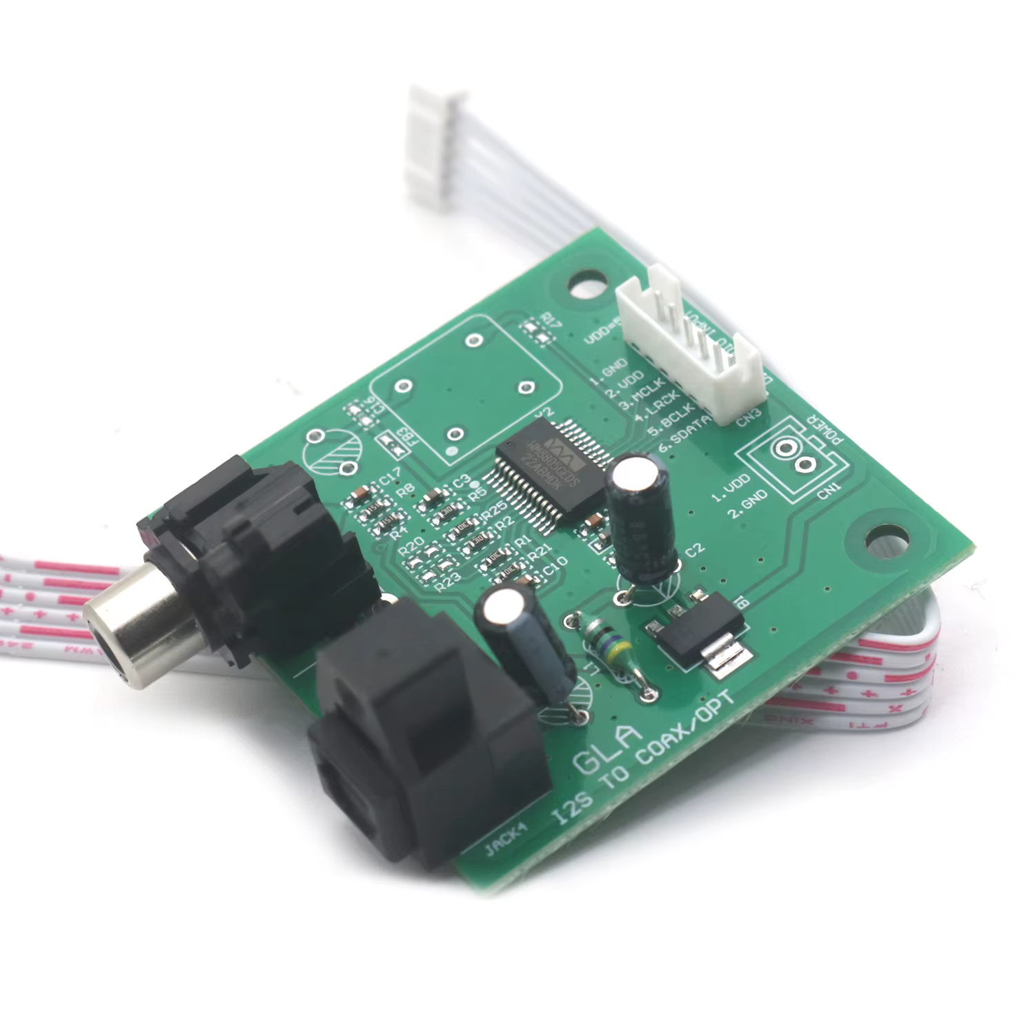

  • Suggesting manual Wi‑Fi setup and I2S-to-SPDIF output module
    #313 21383513
    MAJSTER XXL
    Posts: 2064
    Help: 164
    Rate: 429
    It looks like I'll have to work out the instructions from scratch, starting with a new installation of the Arduino IDE, installing the necessary libraries in various ways (either directly from the Arduino IDE or externally downloaded from zip files), installing tools from Espressif to support modules from that manufacturer in the Arduino IDE environment, etc.....
    Yesterday I uploaded a bill of materials with a rough estimate of parts to build the v2 version.
    I've also added a new ESP32_radio_v2.ino file for testing, which brings some minor fixes to earlier bugs.
    I'm thinking of removing the Wifi Manager in exchange for just typing the network name and password in the code, then each user would have to watch this before uploading the software to the ESP32 module. The question is what do you think of this?
    As for the Toslink or Coaxial digital outputs, you could try installing a suitable I2S --> SPDIF converter instead of the PCM5102A DAC, e.g. according to google a WM8805 type module will handle this. I can't 100% guarantee that it will work correctly, but I think it will work without changing the software.

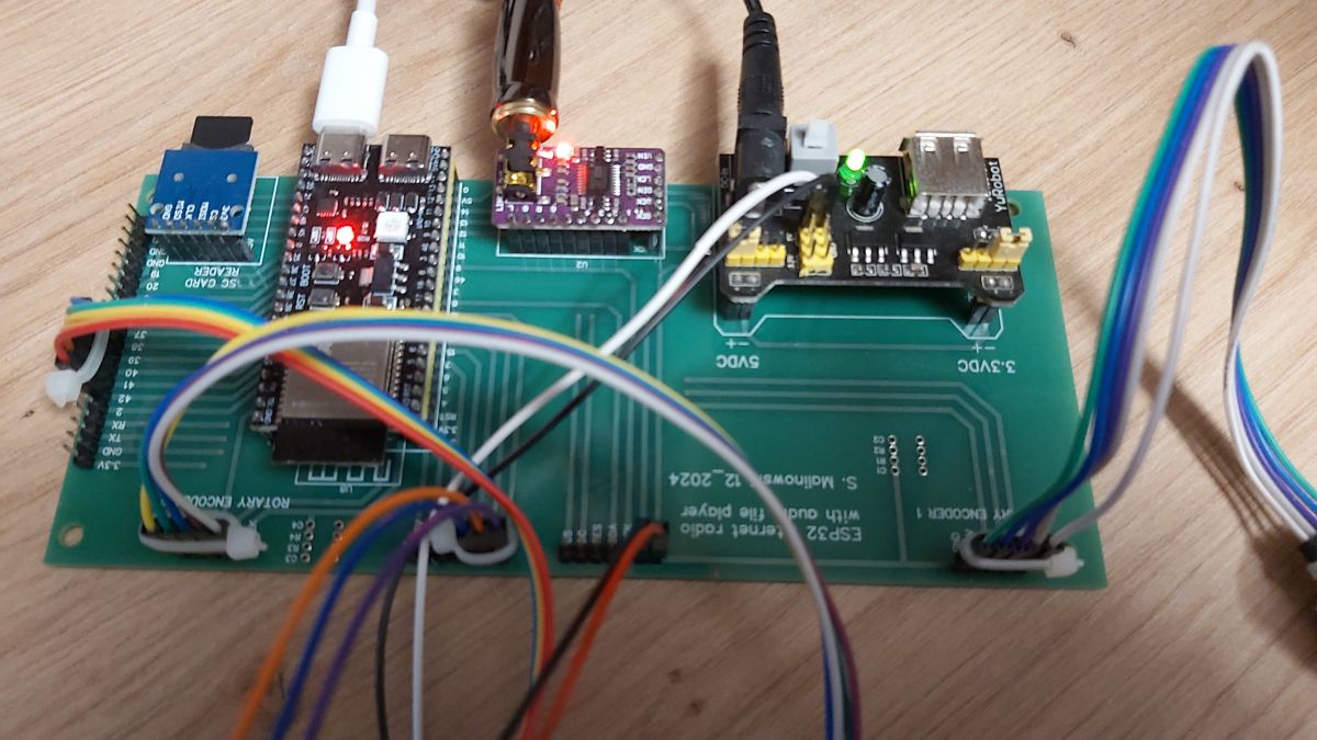

    @and32jar great, may it serve! With me in the program since a few days came joystick support, because I don't have anything cool for quick directional switching with the middle button. I have updated the schematic, so that it is clear how to connect this joystick, the file is attached below, it is also swapped on my github profile:
    https://github.com/sarunia/ESP32_radio_player_v2
    I also have the bulk without the case everything for now:
    Prototype electronic set with a display and joystick. .
    Close-up of a prototype board with various connected electronic modules. .
    • Schematic_ESP32-internet-radio_v2.pdf (53.54 KB) You must be logged in to download this attachment.

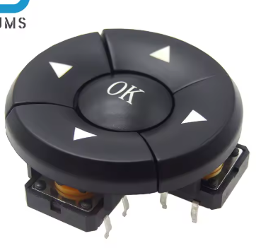

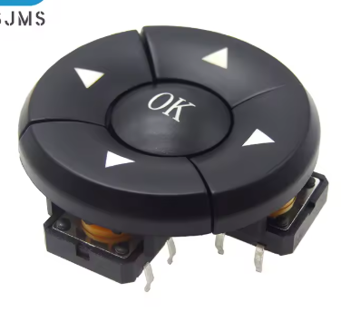

    Instead of a joystick which can be cumbersome, buttons can be implemented without changing the code. I ordered these:
    Multi-directional button with OK text and arrows on a black background. .
    Cost: PLN12.60. at majfriends

    @Andrzej Ch. agrees, the joystick works on an analogue input, which complicates the operating code to act like a simulator for such a regular directional switch. I've seen that button from your photo but its mounting on the front panel of the case will be a hassle, hard to find something sensible that isn't also the size of a regular tact switch, I was still looking at a membrane keyboard like that, it has an interesting button layout and all of them could actually be used but it's horribly expensive:

    I don't think mounting this type of pushbutton on the front panel from the post #21383807 would be troublesome. This is a boardless version, just make holes in the case for the microswitches and solder them inside the case. The panel should cover the microswitches so it should be aesthetically pleasing at the same time. It seems to me that it will be worse with the implementation of the joystick on the front panel. I have such a joystick somewhere, so I'll see what I can do with it.

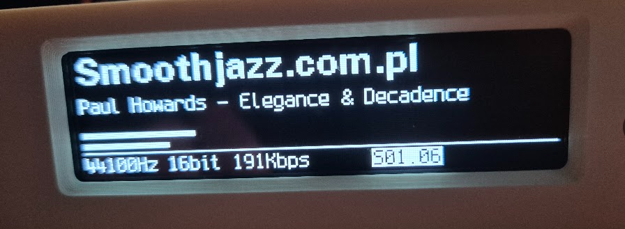

    I'll throw in a preview :) .

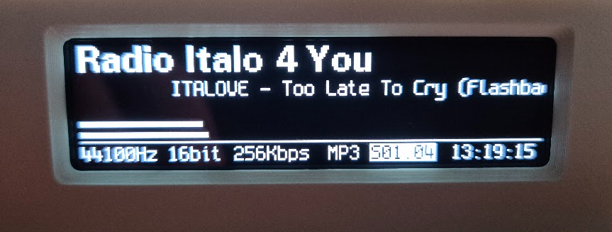

    For those who don't need a file player but just want a radio. I made a version "ESP32 Radio evo3JustRadio" .
    - operating everything with one encoder
    turning -> changing the station
    press -> adjust volume
    long press -> change of bank
    extra long pressing -> now switching on VU indicators :)
    - information about the selected bank and station at the bottom of the screen (between "mp3" and clock)
    - scrolling function for station descriptions
    If the song title, the so-called "stream title", fits within 42 characters (one line) it remains stationary, if it does not, it starts scrolling pixel by pixel.
    This required a lot of rebuilding of the functions and how the clock reading, displayRadio, displayRadioScroller(), vuMeter() functions are implemented.
    - I improved the operation of the WiFi manager. Now we get correct information on the display when there is no connection and the ESP Radio portal works CORRECTLY.
    For the "v3 Just Radio" version you basically only need one encoder, power switch, SD/microSD card reader and display to have a radio.
    If you want a player you have to add a second encoder. The player code is still there although I don't know how long I will keep it there. Or maybe I can keep one version. We'll see. Everything is basically up and running now, I'm cleaning up and putting in the code functions. In a few days the ino file on GitHub.
    @Majster XXL I wouldn't remove that WiFi Manager, because that way the device can be taken anywhere and connected to the network without compiling the code. Alternatively, you could make a wifi file on the card where ESP reads the SSID and Passwd, but this is not very safe, but at home it should not be dangerous.

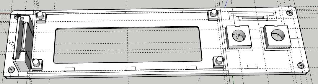

    I can't decide which screen "layout" to leave. I currently keep the one without the "Net Radio" inscription at the top because the VU indicators look nice and it's a shame to throw them away ;) .

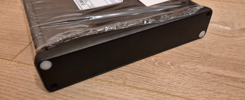

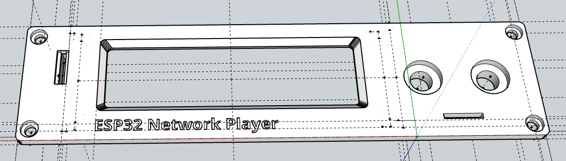

    As for the enclosure, a Hammond 1455R1601 enclosure freshly imported from Germany arrived today.
    Yes this is no joke. On TME is or in local shops is much more expensive than to buy in a mail order shop in Germany.
    In addition, I am already finishing the design of the housing for printing. I am waiting for the packages with a few small details to measure.
    The up-down-right-left arrow buttons I also ordered on Ali for 12zl - will be for testing.
    https://pl.aliexpress.com/item/1005001594194930.html
    @Majster XXL in terms of assembly, hole-punch the cheapest and gently and you have a perfect cut-out for such a navigation button.
    Anything round is easiest to mount.

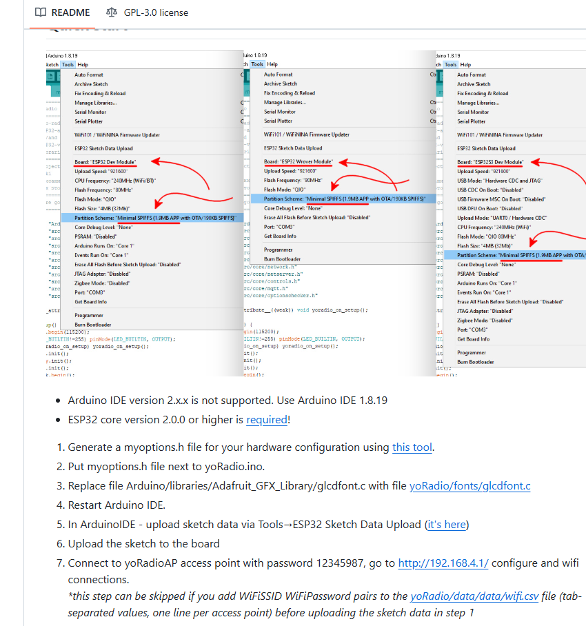

  • YoRadio requires Arduino 1.8.x and extra setup
    #323 21384487
    tytka
    Posts: 766
    Help: 8
    Rate: 1841
    MAJSTER XXL wrote:

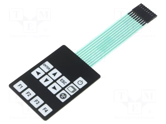

    I've seen this button from your photo, but mounting it on the front panel of the case will be cumbersome
    And why would that be?
    Honestly, I would prefer such combined buttons instead of this membrane keyboard.

    wirbud wrote:
    The same with the Yoradio project.
    The yoRadio project will not compile on Arduino 2.x, it requires the older version 1.8.x. Also, you need to add something there, as stated in the project description.
    (Personally, I have even done some customisation of this project.)
  • ESP32 board package must stay below 3.x.x
    #324 21384555
    and32jar
    Posts: 69
    Help: 5
    Rate: 15
    @tytka - Project compiles and on version 2.3.2 . Version 1.8.x only needed to upload "data" files.
    Heard something there, but.
    I mean the version of the esp32 board (board manager ) not higher than 3.x.x
    I have made several versions of yoradio, on ESP32A1, s3 N16R8, with LCD 4002 as well as ili9488.
    Edit: what they write is not always valid, read on githab what others write.
    This project is awesome, but from what I've read it will be even cooler with 4x3 keyboard control - then I'm sure I'll incorporate such a wonder into an old radio.

    @and32jar I took the information about the Arduino version supported by the yoRadio project from the project website:
    Instructions for configuring Arduino IDE and ESP32 for the yoRadio project. .

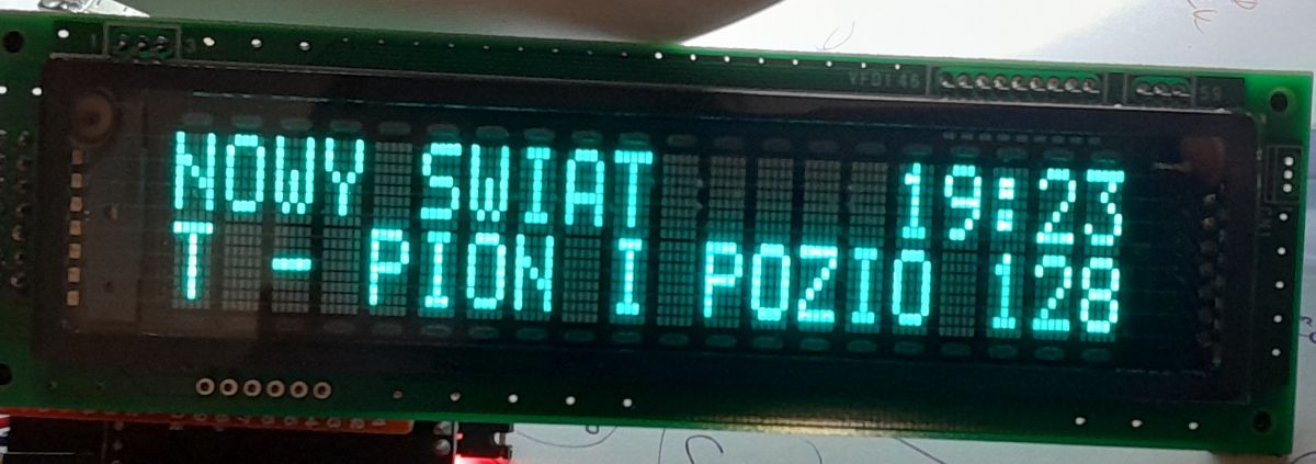

    I have also fired up this project, not only on the ESP32-C3, but also on the ESP32-S3 N16R8 and with various displays. (LCD1602, SH1106, SSD1306, ILI9341, ST7789). I even added support for the LCD2002, which the project does not normally support.
    LCD display showing text and numbers in blue color. .
    Any hints on how you write your list?
    I made my list today i.e. replaced one bank and it is ok, but......
    in the station name further down you see the letters Ba(nk ...) - the Bank comes in.
    Likewise the ordering is not nice when selecting a station from the list . (SSD1322 display)
    The second question, the banks and stations are captured from the githab and then saved to the SD where, when switched on again, it already sucks from the SD.
    Is it possible to bypass this so that, for example, it is still sucking from githaba?
    How do I disable the reading of stations from SD?
    Thank you and best regards

  • Trimming station names to prevent bank text overflow
    #330 21385931
    robgold
    Posts: 726
    Help: 10
    Rate: 290
    >>21385504 .
    The construction of the TXT file or as in the case of MajstraXXL without extension with Banks assumes the format:
    Station name [26 characters] - no matter how long the station name is there must be 26 characters ie: RMF FM + 20 spaces
    Next comes the name of the Bank and the Station. This is completely unnecessary in the playback process and only allows the Bank and Station to be displayed in the station list.
    This is all in a FIXED font width.
    If for any reason the length of this line changes, the system will read out the next character and e.g. "RMF FM B" will appear.
    @MAJSTER XXL assumes, in its code, that the display always shows only 42 characters per line and does not limit its length.
    u8g2.clearBuffer();
    u8g2.setFont(u8g2_font_spleen6x12_mr);
    u8g2.drawStr(0, 10, stationName.c_str());
    In my case, because I use a large font and in addition I wanted to be independent of the font width, the station name can be 26 characters long (now even 23 in evo3). In order to avoid the situation of the name "Bank" being dragged into the station name, I introduced trimming of this string:
    u8g2.setFont(u8g2_font_fub14_tf);
    stationName = stationName.substring(0, 22); // the value 22 represents how many letters we cut from 0 to 22 letters from the station name.
    u8g2.drawStr(0, 16, stationName.c_str());
    The file on my GitHub contains 26 more characters:
    u8g2.clearBuffer();
    stationName = stationName.substring(0, 26);
    u8g2.drawStr(0, 14, stationName.c_str());
    Example line from the Station Bank: RMF FM____________________Bank_1_Stacja_3___http://195.150.20.7/rmf_fm
    I have replaced the spaces with "_" because otherwise Elektroda will truncate the spaces and you won't be able to see what's going on.
    Whichever version of the software you are using you can enter this.
    The whole operation takes place at the beginning of the function: void displayRadio() .
