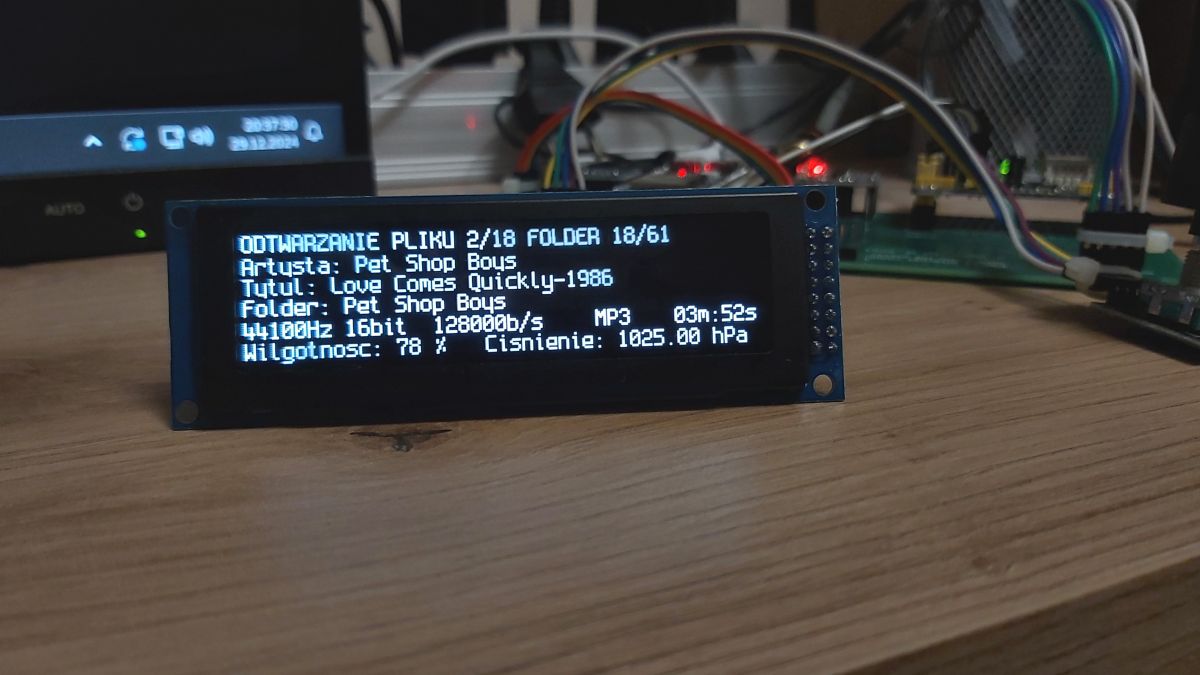

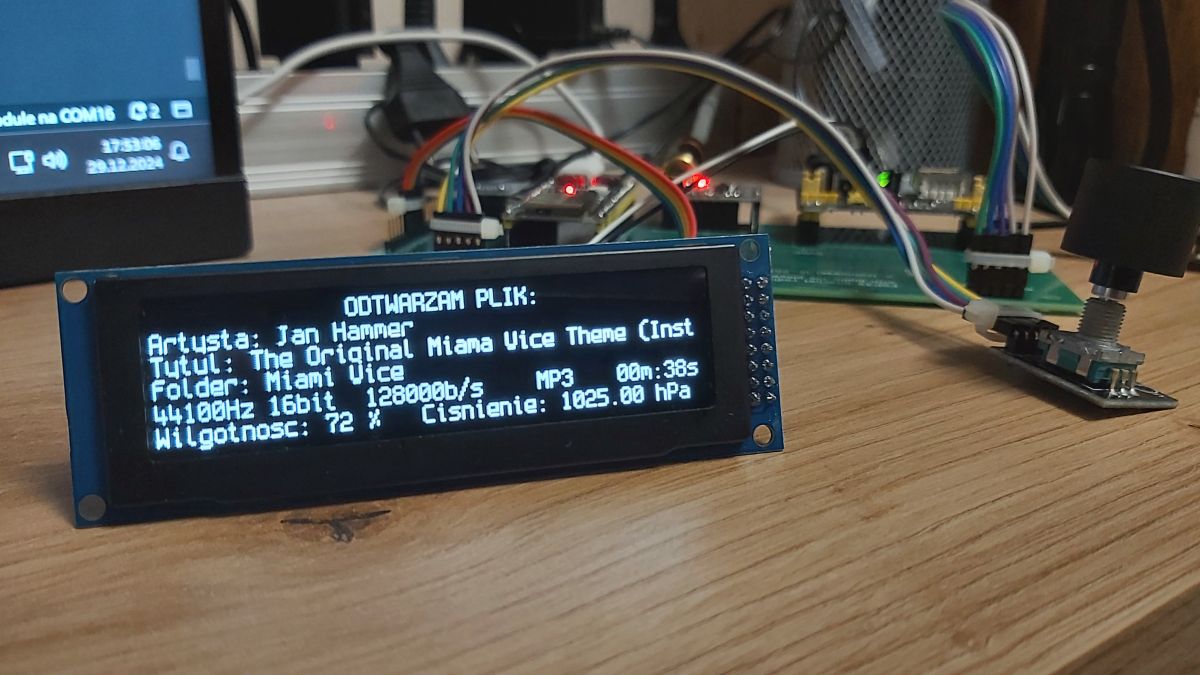

    - entering the menu by holding down encoder button 1 for 3 seconds,
    - then wheel to select "File player" and confirm with encoder button 1,
    - the contents of the main folders of the card are listed and the first file of the first folder is played,
    - using the encoder wheel you can choose which folder you want to play next
    - from mp3 files the ID3 metadata is displayed quite correctly, I attach pictures
    In the flac files I have to do ID3 chunking, because they are printed quite differently on the serial than from mp3, the creator of the audio library also seems to have a big mess in it.
    In general, I still plan to use the encoder wheel to freely select No. 1 files from the directory similarly listed as radio stations from the bank.
    LCD screen displaying information about an audio file being played. .
    LCD screen displaying audio file playback with metadata.

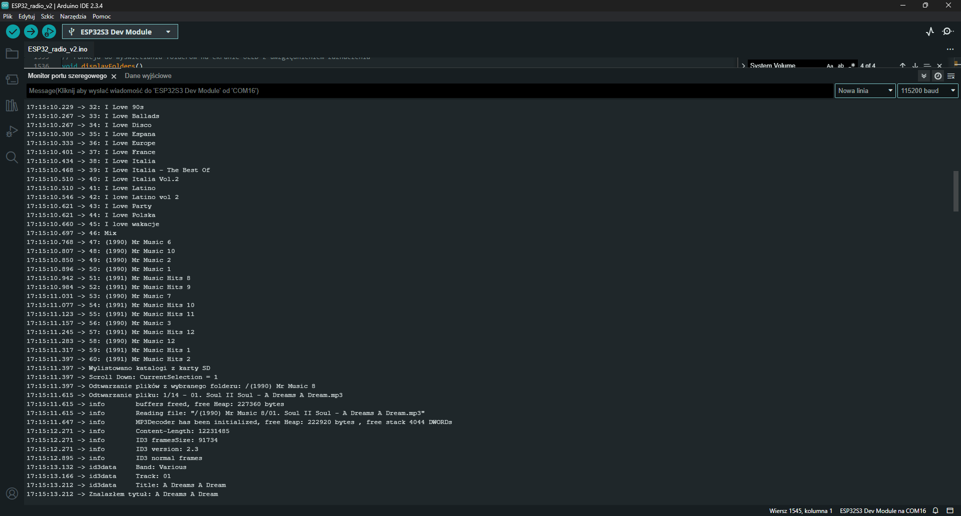

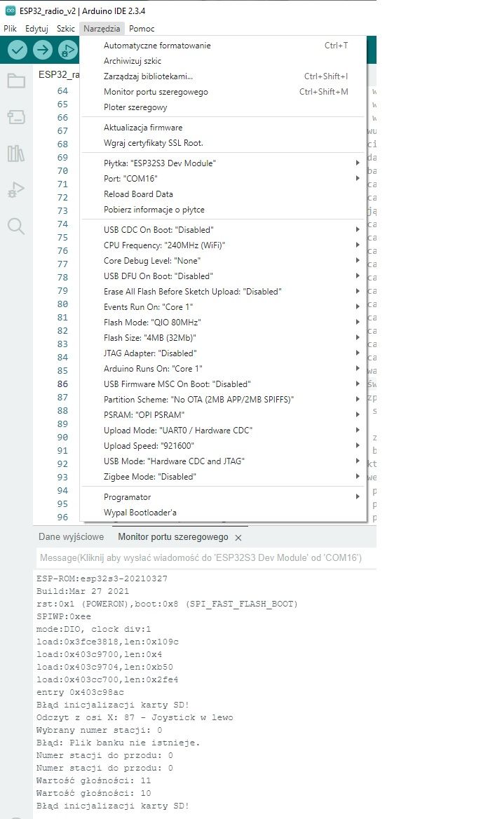

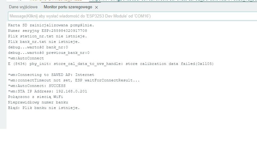

    When I go to the folder with the flac files, it resisted starting:
    Audio file read logs in Arduino IDE .

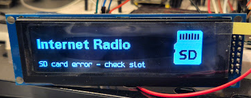

    From the series of what I did for my radio today :)
    - I improved the exit from any sub-menus
    The function "if (displayActive && (millis() - displayStartTime >= displayTimeout)) " is supposed to exit to the main screen but ....
    It does this incorrectly. If we enter the BANK selection menu and we don't select anything (by turning the encoder or not), then, unfortunately, when we return by turning the station selection - we select from the BANK on which we left the indicator "bank_nr". In other words you have to remember the variable bank_nr = previous_bank_nr; so that you always come back with the correct value of bank_nr. I hope I didn't confuse things too much.
    in addition:

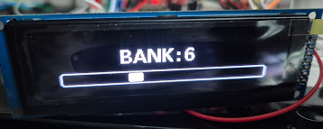

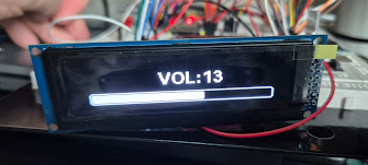

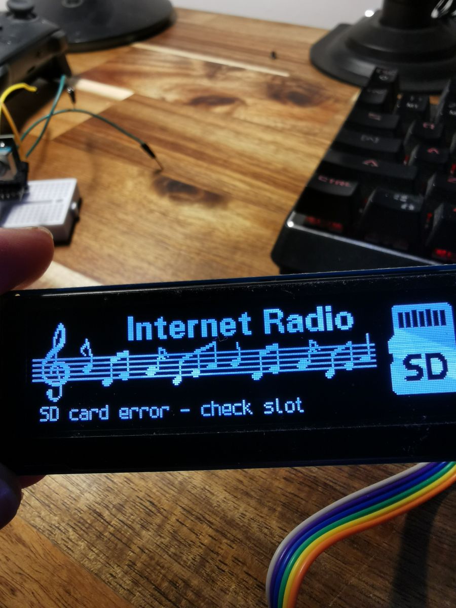

    - I introduced sliders/progress bars for the volume control menu and the bank menu. Eventually there will be an Update option in the bank selection: "NET" - "SD card"
    - slider in the bank selection menu
    - fix (described above) to return correctly from the bank selection menu
    - for beautification I added an icon and information if we cannot initialise the card, because it has become an important element holding the radio data
    - I trimmed the station name to 26 characters
    - I have created a template in excel for preparing the memory bank files
    MAJSTER XXL Code as much as possible to make available for everyone. Take what you will need. I think I'll set up a GitHub to upload it there
    Strength in community
    LCD display showing Internet Radio and SD card error message LCD display showing volume level 13 on a slider. LCD display showing the text BANK:6 with a progress bar below.

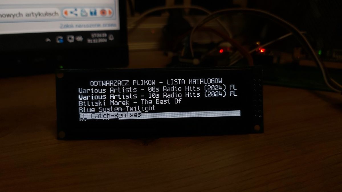

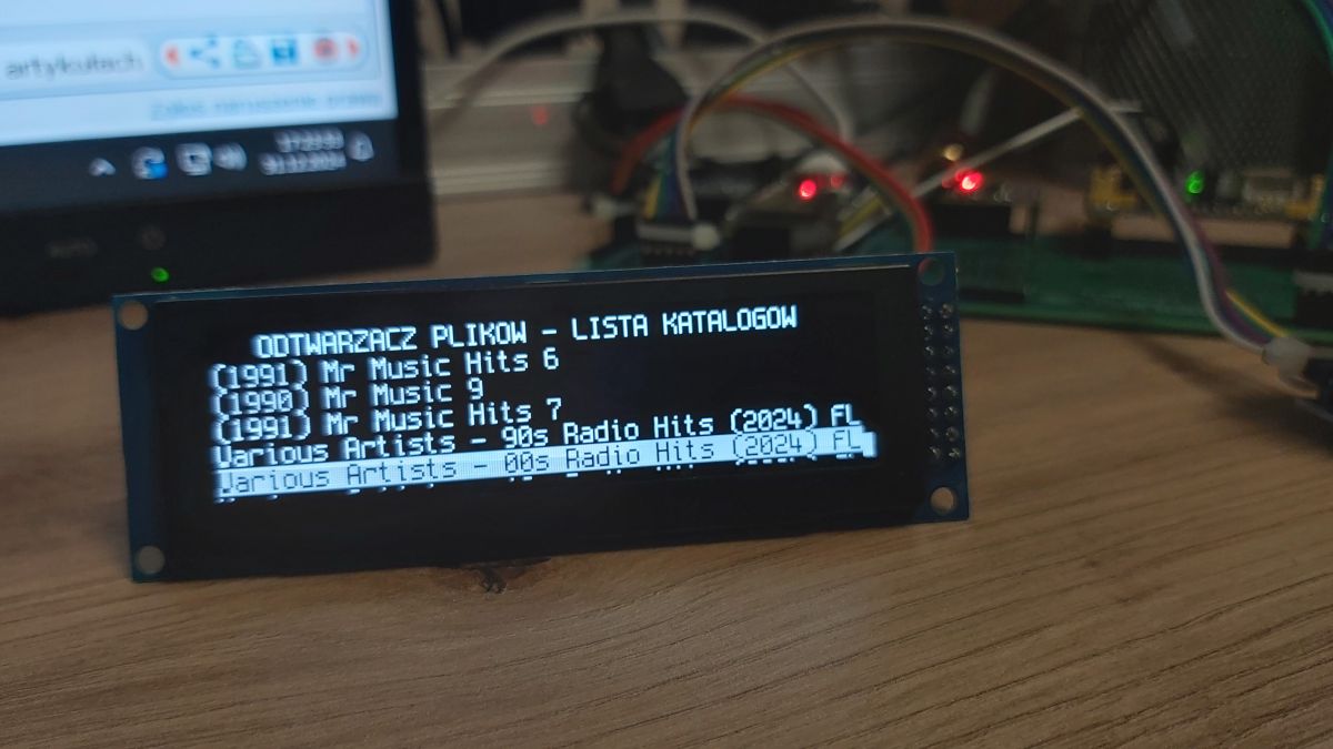

    @robgold Interesting, I don't have this problem with System Volume- it is skipped. I have spaces in all my folder names and it works normally, so I don't understand why it's happening to you- it's not by chance the fault of a substituted font?
    I have over 60 folders on my card and all the mp3s with different bitrates play correctly. I just have to figure out the right moment to put the audio file data on the display, because if I put it too early it sometimes shows up with some rubbish.
    I also don't understand why it doesn't nicely display a selected folder in a rectangle - just like a radio station - even though the function for scrolling and displaying folders has the same settings as for scrolling through radio stations. The flac files from my card play normally.
    The fact that I already had the so-called previous bank and station number in the first version of the radio, but here apparently variables were declared, but I did not assign them later - it escaped me. Yesterday, when I was working on the file player, I had the same situation with the previous folder and file numbers, so that after turning the wheel but without confirming them, they returned to the correct numbers - I have that covered.
    Arduino IDE screen showing music playback logs. .
    Display showing a list of music files.
    File player screen with a list of music directories. .

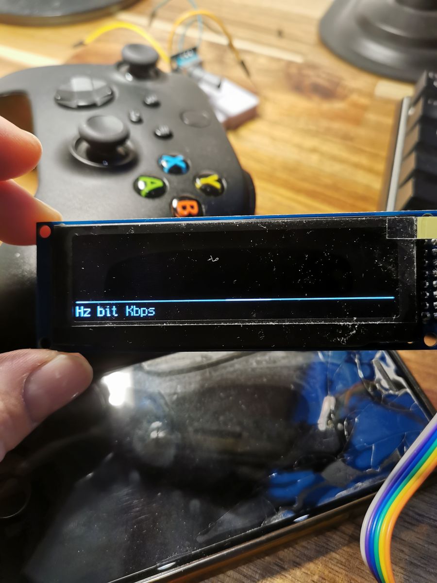

    Master , to test what cool stuff you've done in the code I always upload your entire original file to ESP. Only then I copy myself what I like there :) .

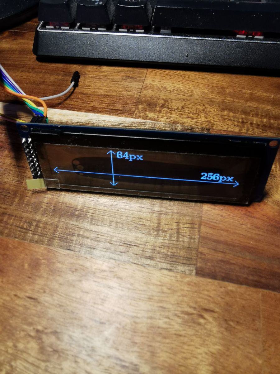

    As for the font and selection highlighting problem.
    I've had a look at the code and the problem lies in the incorrect jumping and painting of this frame. The Spleen font we are using is called Spleen6x12 but it actually has 6 boxes in the x axis and 13 in the y axis. Take a peek at the screenshot from the Fony program I use to edit fonts.
    It purposely shows the little 'y' because it is one of the critical ones that just uses the fields below the tenth i.e. it uses 11,12 and 13 to display the tail.
    In the station listing section this is also incorrectly done, but as the list fills the whole screen and the font is of type mr (not tf which means transparent) each subsequent line cuts out 1 selection pixel and you can't even see it. Take a look at the attached screenshot.
    In order to correctly display the selection in the code section below, you must always jump 13 boxes. That's why I changed the multiplier value to 13. The -2 and +8 offsets are just cosmetic to start writing as high as possible to make the last line of the list look decent because 64 does not divide by 13.
    // Limit the length to 42 characters
    String displayedPath = fullPath.substring(currentDirectory.length(), currentDirectory.length() + 42);
    // Highlight the selected directory
    if (i == currentSelection)
    u8g2.setDrawColor(1); // White background colour
    u8g2.drawBox(0, displayRow * 13 - 2 , 256, 13); // Draw a rectangle as the background for the selected folder
    u8g2.setDrawColor(0); // Black text colour
    else
    u8g2.setDrawColor(1); // White text colour on black background
    // Display path
    //u8g2.setCursor(0, displayRow * 10 + 10); // Set the cursor for the line in question
    //u8g2.print(displayedPath); // Display directory name
    u8g2.drawStr(0, displayRow * 13 + 8 ,String(displayedPath).c_str());
    // Move to the next row
    displayRow++;

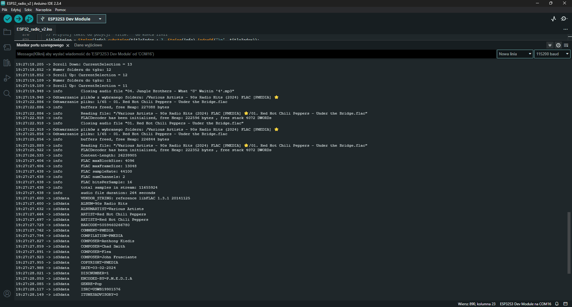

    I also analysed why my folder with FLAC files wouldn't play and it turned out that trimming the names causes the path to the files to be lost.
    It just so happened that I put the folder [Varius Manx -Z Zanim Zrozumiesz (Złota Kolekcja)] into the test, which in the terminal resulted in the
    Varius Manx -Zanim Zrozumiesz (Złota Kolekcja)], which in the terminal results in clipping the name to [Varius Manx -Zanim Zrozumiesz (Złota Kolekcja)] and because this clipped name then takes an active part in assembling the path to the file, the player cannot find the correct file.
    eof_mp3 01 - Varius Manx - Moonlight Song.flac
    info End of file "01 - Varius Manx - Piosenka księżycowa.flac"
    File playback: 2/3 - 02 - Varius Manx - Before you understand.flac
    info buffers freed, free Heap: 231616 bytes
    info ERROR: File doesn't exist: / Varius Manx -Zanim Zrozumiesz (Zł /02 - Varius Manx - Zanim zrozumiesz.flac

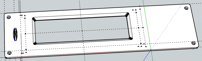

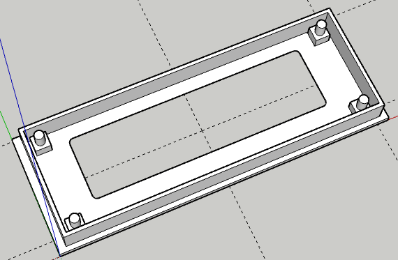

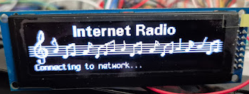

    I made myself a cool welcome screen :) .

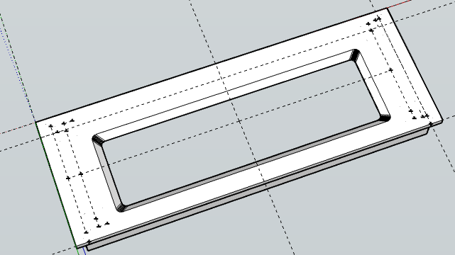

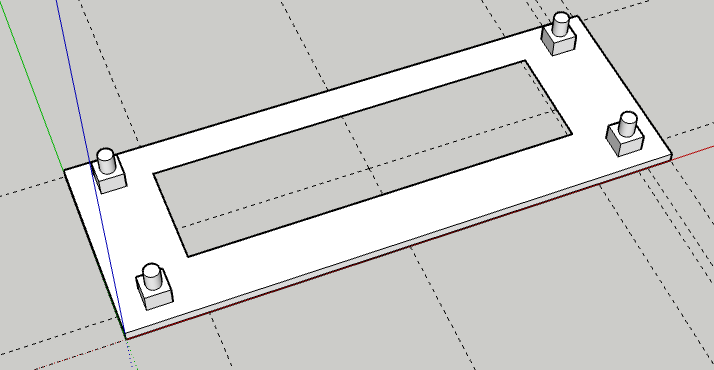

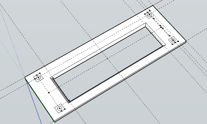

    I designed a frame for the display, which will eventually be the base for the case.
    In the v6 version, I raised the bezel-display distance to 3.8mm (according to the datasheet it is 2.8mm but that doesn't match reality)
    I am attaching the 7z file - inside the SKP file (from the online version of SketchUp) and the STL to print out
    Display frame design created in SketchUp. .
    Display frame model in SketchUp .
    3D model of a display frame .
    Display frame design with mounting brackets .
    Screen displaying the text Internet Radio and musical notes. .

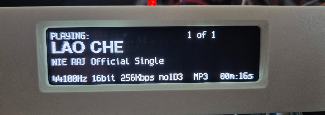

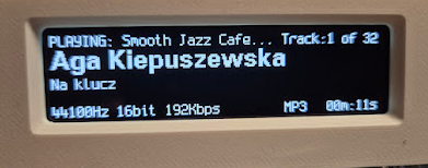

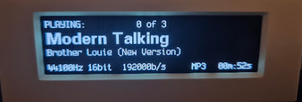

    I have changed the player screen and at the moment when there is no ID3Tag I cut out the name and title according to the scheme Artist - Title.mp3 because this is how I always "rip" CDs to the digital collection. Finally, since we have a graphic OLED, let's take advantage of its possibilities.

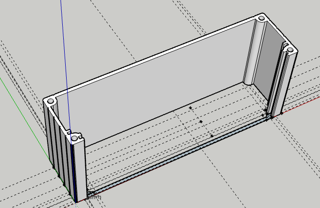

    At the moment I have made an enclosure design based on aluminium profiles (there are no aluminium profiles on the market or I haven't found any) for a large 160x160 enclosure with a height of 40mm (the 3.12 display requires a minimum of 35mm). Ultimately I want to move to a 2 inch display and Hammond 1455R1601BK case which is 30mm.
    As soon as I have printed and tested the new enclosure I will upload the files here.
    As you can see the front panel is still in the 'alpha' version.
    Prototype of front panel enclosure in alpha version.
    Front panel design for an electronic enclosure with a rectangular cutout. .
    Music player screen displaying the song Brother Louie (New Version) by Modern Talking. .

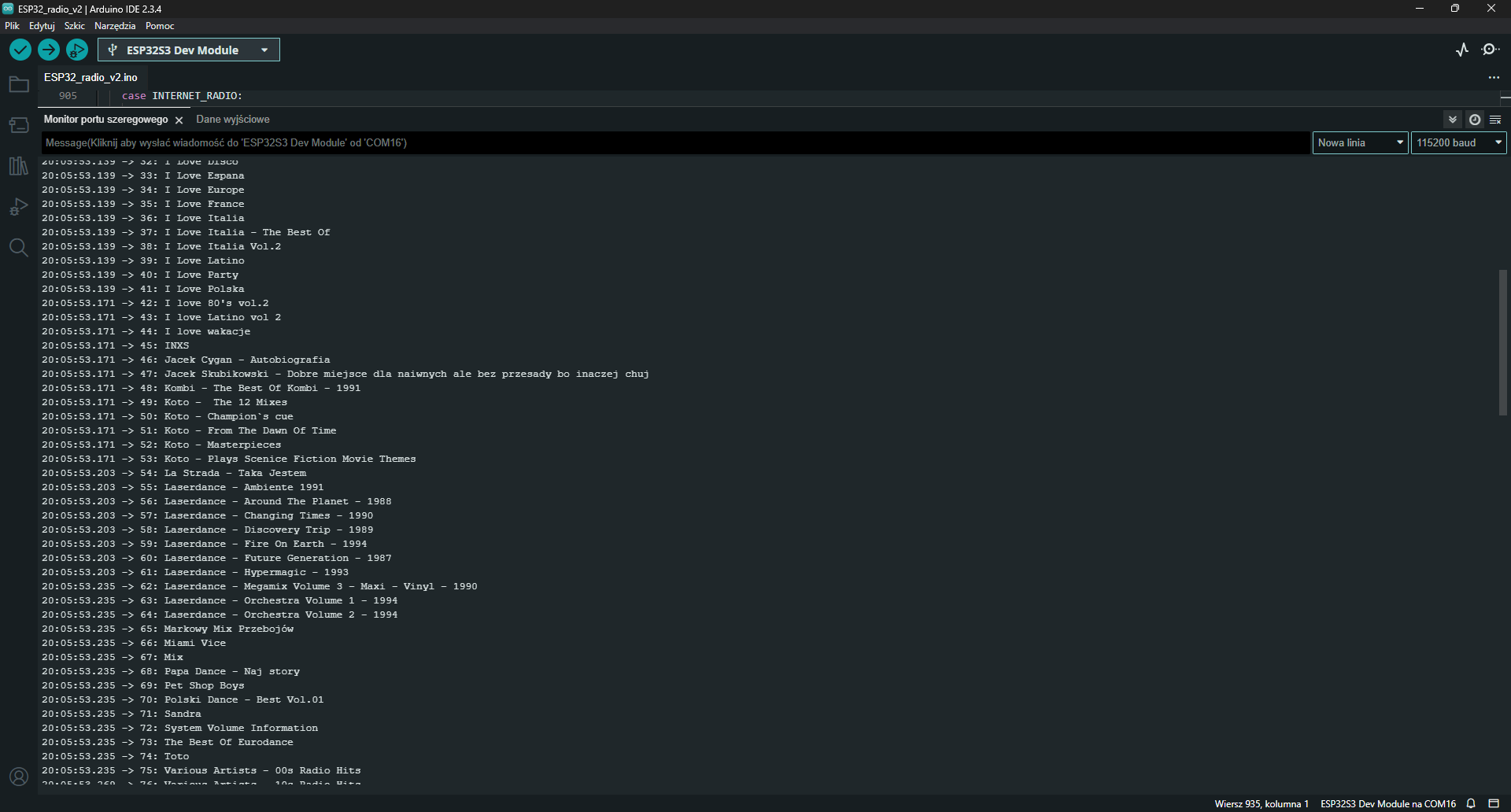

    I've today added alphabetical sorting when listing folders, as adding more to the card put them mostly at the end and the order was non-existent. I'm still working on getting rid of the System Volume Information so it doesn't list. By the way, I've made the fixes you suggested, although not everything yet, but it's working quite nicely already. I encourage those who are watching to make a kit like this for themselves to start with on a simple contactor, because it's fun. Now, during the winter, I still have the desire to work on it in the evenings, but from the spring I will have less time for it, so maybe my colleagues will polish this project more.
    Screenshot of Arduino IDE displaying a list of music tracks. .

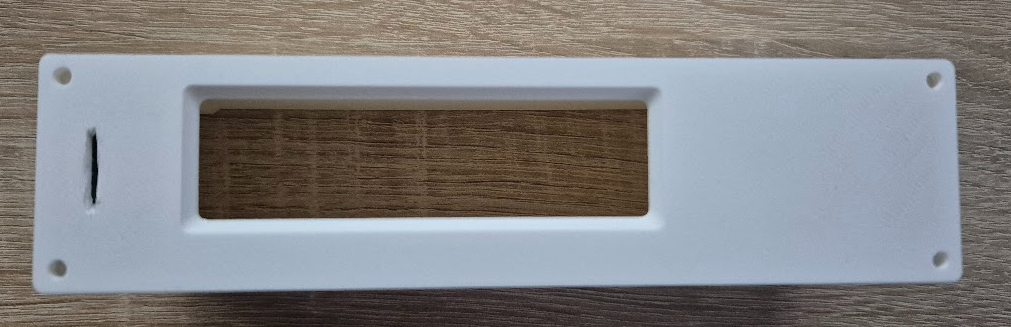

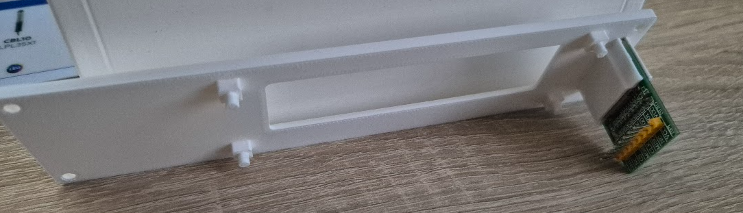

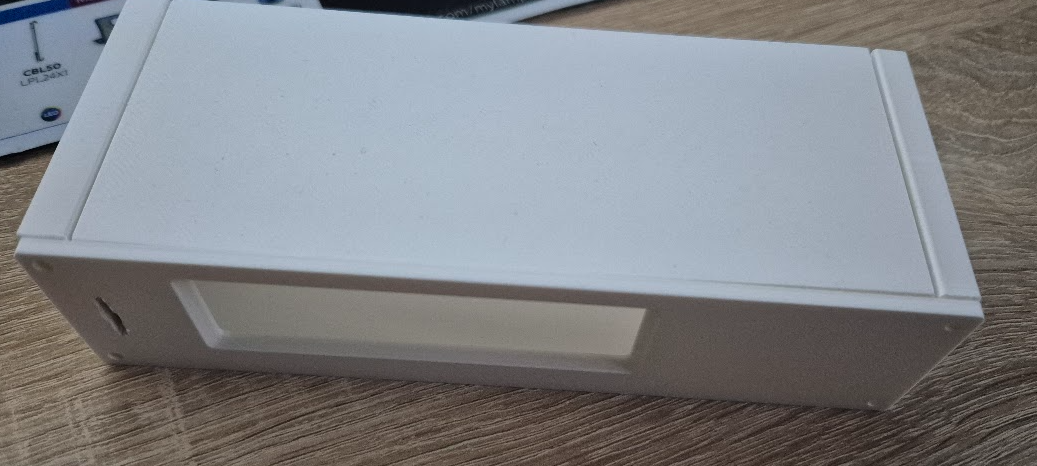

    I managed to print a prototype of the case. As it is in a prototype there are many things to improve but it promises to be good.
    On the front panel the card reader has to be moved, because on the left side there will be a physical switch and on the right a microSD card plus two encoders.
    Prototype casing with front panel featuring an opening and an attached circuit board. .
    Prototype electronic device casing with a cutout for a display. .
    Prototype housing made of white material. .

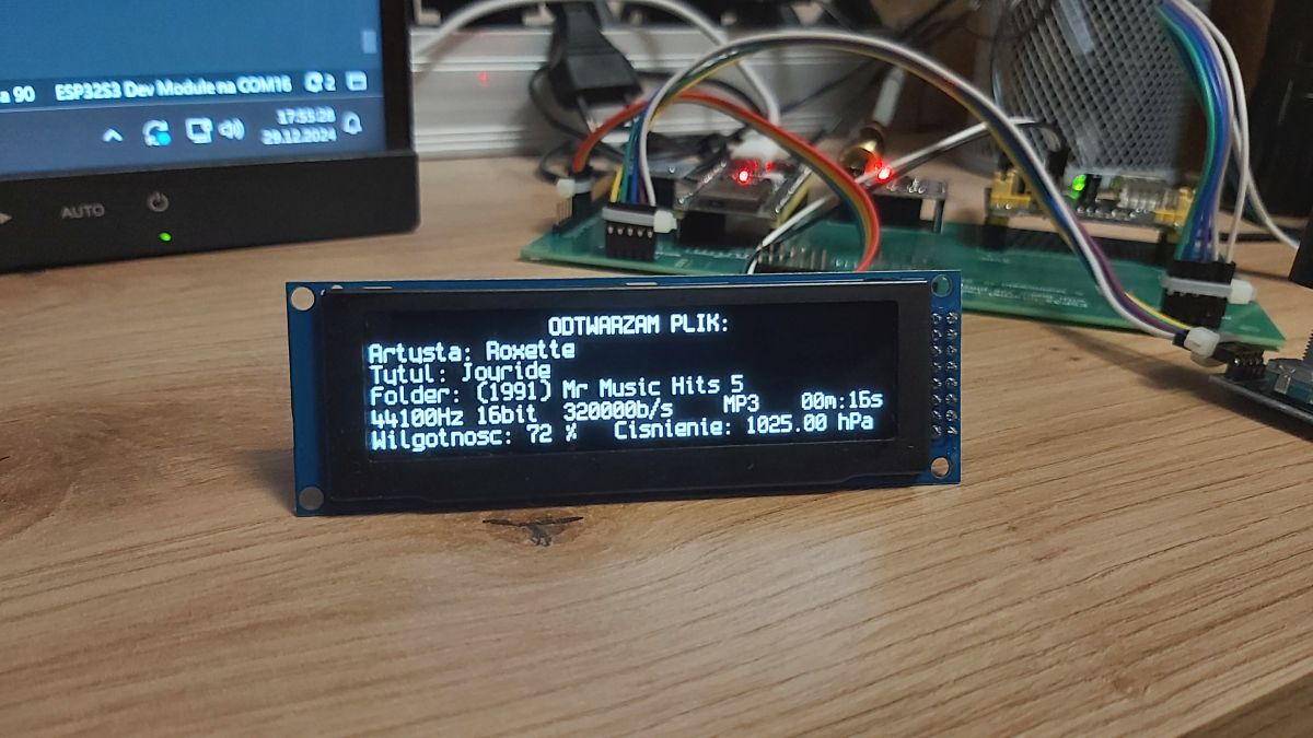

    I have added a lot of cosmetics in the player itself:
    - for a file without id3tag I put together a description from the name of the file itself
    - fonts, screens

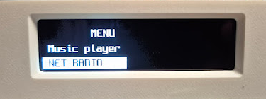

    - I threw out the Bank selection case from the menu - a remnant probably from version 1 of the radio, which caused one unnecessary click with the encoder

    debug--fileName: 01 - Happysad - Mileowy Las.flac
    Display of a player prototype showing information about the track being played. .

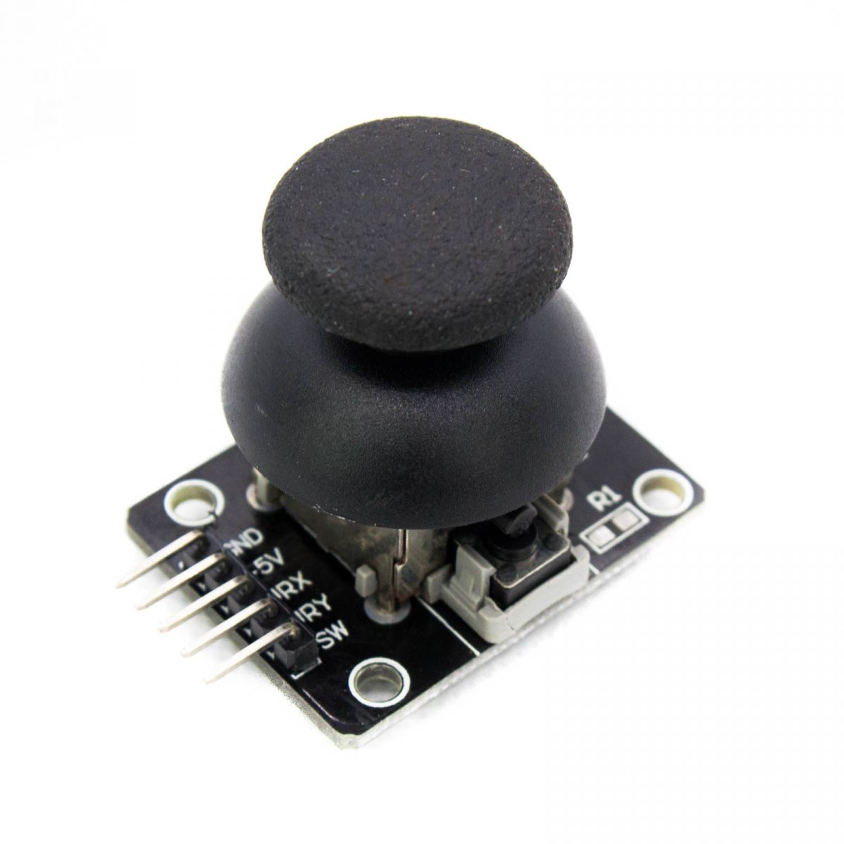

    I managed to add a joystick, I created an additional void handleJoystick() function under its handling. For now I've done switching from the extreme X-axis positions of the radio stations one forwards and backwards each, tomorrow I'll add this functionality to the file player for testing. As for the revision of the version on github, for the time being, when something comes out, I immediately synchronise it to github, the changes are then visible in the commits:
    https://github.com/sarunia/ESP32_radio_player...mmit/eba3d0c6494e286d0b3b59579d7268f65c525314
    I had a regular joystick:
    Simple modular joystick with a black knob and connection pins. .

    I changed the names to English. I have reworked the menu a little bit in the style of station selection and added the radio in the exit function after idle so that it exits the menu correctly.
    Otherwise, when you enter the menu, turn to Player but do nothing, the radio goes dead. You cannot change the station.
    currentOption = INTERNET_RADIO;
    displayRadio();
    What I have done in the player is that at the top, if the name fits, it prints the folder name plus the track number and if it doesn't fit
    I cut it off and add three dots. Cosmetic, but nice to look at.

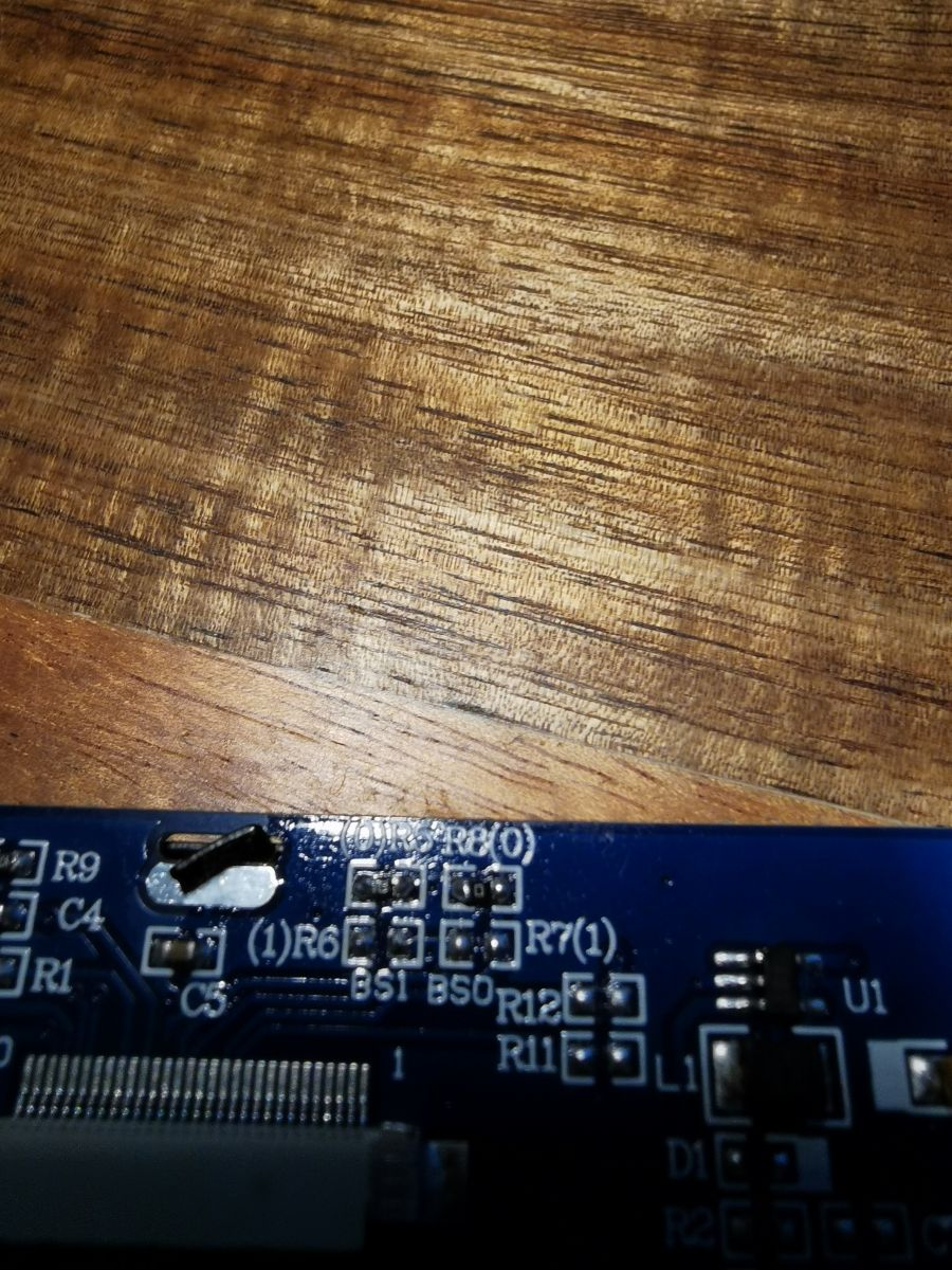

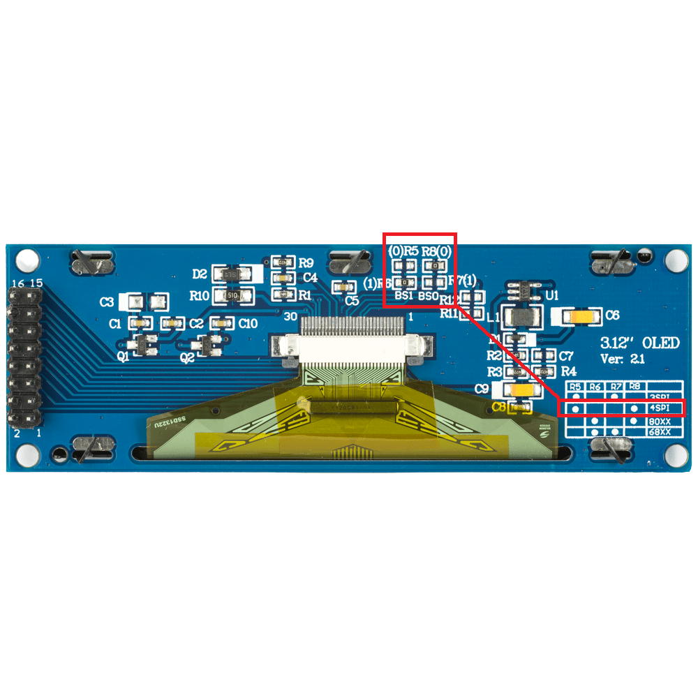

    @atu1981 Have you re-soldered the jumper to the one marked?
    3.12 OLED display with a marked jumper location. .
    @robgold Under what name to look for such a cool switch (5x tact switch), after the graphics it just sends me somewhere far east? I haven't checked large flac files, I'll look for some later and let you know. Today, I've mastered the joystick jump to the file being played one forwards / backwards. Backwards is complicated because you have to rewind the directory to the beginning of root.rewindDirectory() and in the next loop jump to the appropriate file. I have to additionally desensitise the joystick because sometimes it will flip "left" on its own.
  • #285 21376653
    atu1981
    Posts: 11

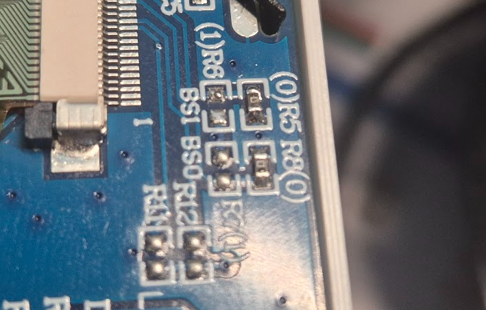

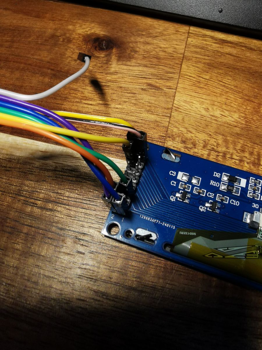

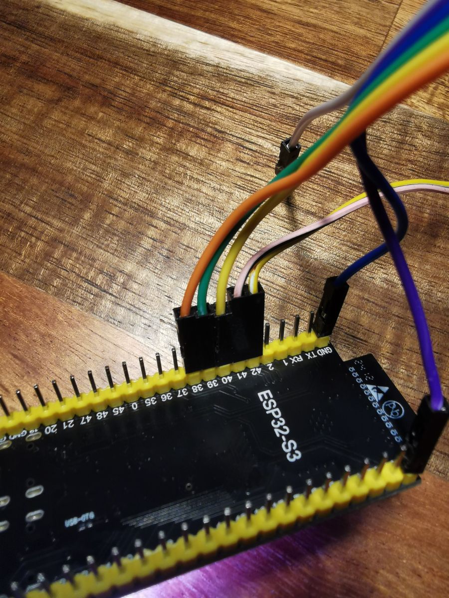

    I have the jumpers set to 4SPI. That is, the resistors at the locations of R5 and R8.
    Added after 14 [minutes]: .
    Close-up of a circuit board with marked solder points R5 and R8. .

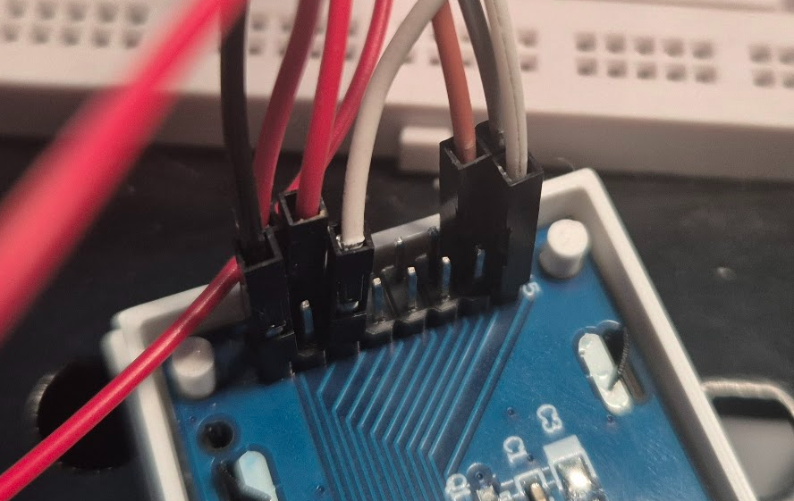

    Close-up of a circuit board with connected colorful wires. .
    ESP32-S3 board with connected colored wires. .
    This is what the connection looks like to me. What is wrong?
  • Radio firmware now requires SD card to boot
    #286 21376698
    robgold
    Posts: 726
    Help: 10
    Rate: 290
    @atu1981 .

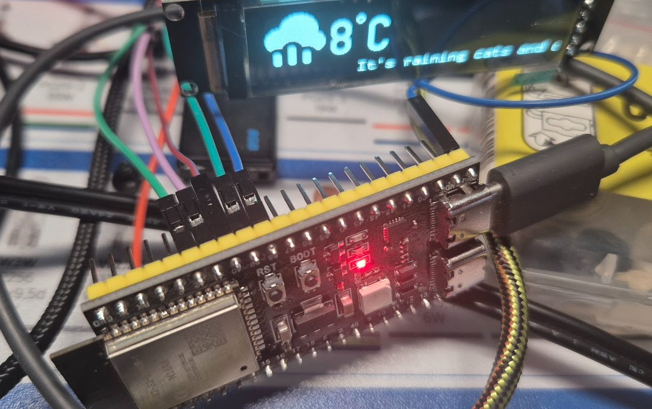

    And in the correct places did you connect it to the ESP ? The schematic is a bit confusing because it suggests the bottom of the PCB.
    Have a look at the pictures I took of it for you quickly. On the first one you have the location relative to the ESP where the display plugs in. In the second and third you have the connection to OLED 3.12 and the jumper configuration.
    By the way, I'm testing a small 2.08-inch OLED with the SH1122. It's not bad looking. It will eventually be in one of my versions.
    ESP module connected to an OLED display with a weather message. .
    Close-up of a PCB with markings BS1, BS0, R8, R6, and others. .
    Close-up of wire connections to a display module on a PCB. .
    @MAJSTER XXL .
    I have already seen these buttons a few years ago from "colleagues" from the east on Electronics. I don't even know if TME doesn't sell them now.
    Link to Ali: https://pl.aliexpress.com/item/1005001594194930.html
    Multi-directional button with OK text and arrows on a black background.
    I found a cheap 5 button "digital" joy on Botland.
    https://botland.com.pl/joystick-joystick-ardu...m-41-kierunkowy-10x10x10mm-5904422321086.html
    Square momentary push button with a black stem and four leads.
    Added after 8 [minutes]:
    >>21376653 Arthur, now I saw that you only have the display plugged in.
    From a certain version of the ino file at the master, the radio will not run without the card plugged in. You will only get a message on the serial.
    I additionally in my version initialise the OLED beforehand precisely so that the user gets a feedback message.

    @atu1981 Post a screen from the serial terminal, we'll see where you are with the program. Personally I prefer to power this OLED from 5V, it needs a bit of current, I don't know if from the USB of the computer it will go-even I didn't have the idea to test with a USB-only power supply.

  • Asking how to access the terminal screen
    #289 21376806
    atu1981
    Posts: 11
    program, downloaded directly from github without any changes or corrections. To check the correctness of the board-display connection, I uploaded a sample sketch to this display assigning the no. as from the project and as you can see it works....
    How do I get the terminal screen? - soryy i am not that advanced ;-(

  • #290 21376836
    robgold
    Posts: 726
    Help: 10
    Rate: 290
    And what configuration line do you have in this test softy ? In the original there is R2 rotation which means you should see the image correctly having the connector on the right side.

    I have uploaded this code:

    void setup(void)
    display.begin();
    void loop(void)
    display.firstPage();
    do
    display.drawXBMP(0, 0, 256, 64, myBitmaplogo);
    display.drawLine(0, 0, 255, 0);
    display.drawLine(0, 1, 255, 1);
    display.drawLine(0, 2, 255, 2);
    display.drawLine(0, 61, 255, 61);
    display.drawLine(0, 62, 255, 62);
    display.drawLine(0, 63, 255, 63);
    display.drawLine(0, 0, 0, 63);
    display.drawLine(1, 0, 1, 63);
    display.drawLine(2, 0, 2, 63);
    display.drawLine(255, 0, 255, 63);
    display.drawLine(254, 0, 254, 63);
    display.drawLine(253, 0, 253, 63);
    } while ( display.nextPage() );
    delay(15000);
    do
    // We draw two straight lines
    int x1 = SCREEN_WIDTH / 3; // x end of first line (1/3 width)
    int y1 = SCREEN_HEIGHT * 2 / 3; // y of the end of the first line (2/3 of the height)
    // first line with arrows at the ends
    display.drawLine(0, y1, SCREEN_WIDTH, y1);
    display.drawLine(x1 - 5, 5, x1, 0); // top arrow
    display.drawLine(x1 + 5, 5, x1, 0); // top arrow
    display.drawLine(x1 - 5, SCREEN_HEIGHT - 6, x1, SCREEN_HEIGHT - 1); // bottom arrow
    display.drawLine(x1 + 5, SCREEN_HEIGHT - 6, x1, SCREEN_HEIGHT - 1); // lower arrow
    // second line with arrows at the ends
    display.drawLine(x1, SCREEN_HEIGHT, x1, 0); // second line
    display.drawLine(SCREEN_WIDTH - 6, y1 - 5, SCREEN_WIDTH - 1, y1); // Right arrow
    display.drawLine(SCREEN_WIDTH - 6, y1 + 5, SCREEN_WIDTH - 1, y1); // Right arrow
    display.drawLine(5, y1 - 5, 0, y1); // Left arrow
    display.drawLine(5, y1 + 5, 0, y1); // left arrow
    display.setFont(u8g2_font_ncenB10_tr);
    display.drawStr(93, 12, "64px");
    display.drawStr(205, 38,"256px");
    delay(15000);
  • #292 21376892

    @atu1981 turn on one by one in the Arduino IDE according to the screen, set to 115200, also compare all the settings below.
    Screenshot showing Arduino IDE settings. .

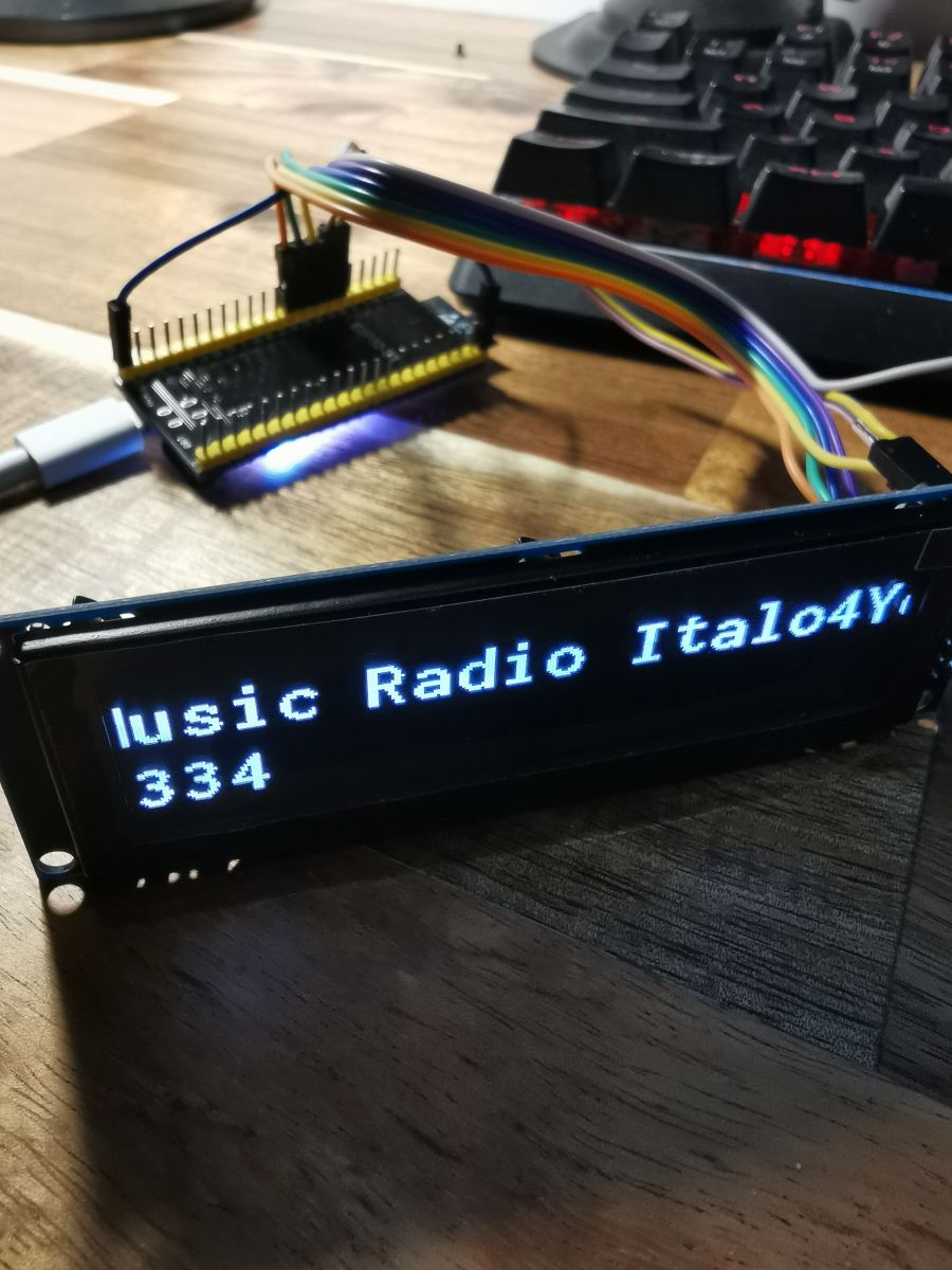

    atu1981
    Posts: 11
    @Majster XXL - screen shot of my settings and monitor data.
    Screenshot of Arduino IDE with ESP32S3 board settings. .
    @robgold - after uploading this code there is progress! The display is working. We know the connection is ok. Just why is the right program in me working? Is something missing? or do I have the wrong settings?
    LCD display connected to a microcontroller with the message music Radio Italo4Y 334 displayed. .

    Upload this:
    https://github.com/dzikakuna/ESP32_radio_evo2
    ...and paste what is displayed on the OLED. I've set up a GitHub, this is the evo2 version of my interpretation of the code for this radio.
    Info for those who are interested :) .
    As for me, you are missing the SD card and since a certain version it has become crucial. Without it, the radio won't work at all because stations and station links are stored there.
  • #296 21377059
    atu1981
    Posts: 11
    After uploading your code, what I was waiting for appeared :-) .
    Display showing SD card error - check slot on an internet radio.
    Actually I have to add a card because there is no station.
    OLED display showing units Hz bit Kbps held above a gaming controller.
    I will keep you informed. And already thanks a lot for your help gentlemen !!! And for improving the mood !

    meanwhile after connecting the card.... I obviously have another problem :-D . The stored music files read perfectly from the card, but the radio does not work:-( .
    Screenshot showing error messages after connecting the SD card. .
  • #299 21377186
    robgold
    Posts: 726
    Help: 10
    Rate: 290
    It should pull the bank file from the server when you apply power and it detects it is missing. Hold down the encoder knob and change the bank to any bank to force it to be read.
  • #300 21377220
    atu1981
    Posts: 11
    You are a champion! After holding down the encoder it pulled up the station. Thanks again for your help and time!!!
