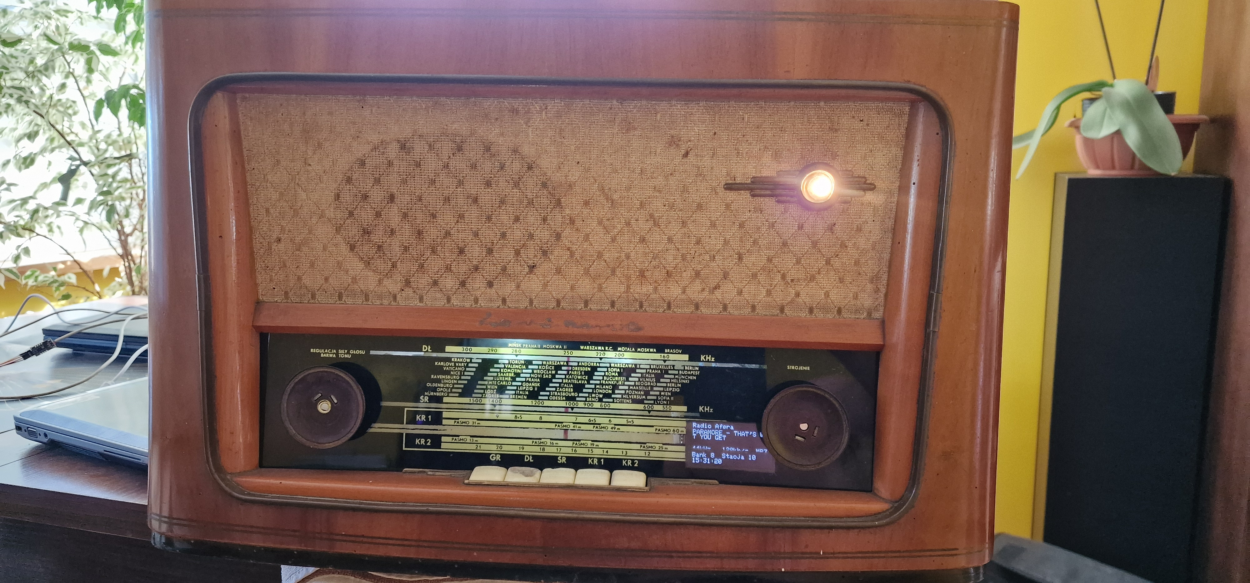

    bolszoy
    Posts: 64
    I got the radio up and running, and would like to thank the author very much for sharing the project, and my fellow forum members for their help.

    #189 21219981
    bolszoy
    Posts: 64
    My ssd1309 display didn't want to cooperate for anything so the ssd reset and esp had to be connected. Encoders have no pcb, so all pins on gnd (those going to 3.3V).
    Display pins SDA, SCL pulled up via two resistors to 3.3V.
    Power supply to ssd1309 also 3.3.
    SD card (actually an adapter), soldered directly. The batch of the colleague Hevet, because others did not connect to my Wifi. But I am curious if other batches will work for you.
    The design is really cool and I've been looking for something like this for a long time, as I won't hide that I'm only now going to get into the arduino IDE.
    The power switch (first key on the left), is a bistable button soldered into the original switch, and glued in with hot glue. 12V after the relay zaps the 3W amplifier, from the esp power board and the rest ( 5V relay). Removed key fastener plate and used original switches.
    External 12V power supply.
    The eyelet is a lens and a white LED.
    I didn't install the original mesh ( although it's really simple) out of laziness.
    And a small note of caution the wires and board must be done reliably because ESP is terribly sensitive to interference. In my case the wires to the encoders and SSD1309 are shielded.
    So thank you all once again for your help and for making the project available.
    Best regards.

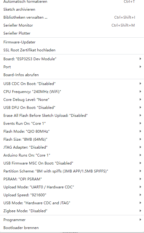

    #199 21286436
    MAJSTER XXL
    Posts: 2064
    Help: 164
    Rate: 429
    @gangliu2018 All the data needed to build this radio is detailed in this topic. Today I decided to update the Arduino IDE to version 2.3.3 - everything compiled normally.
    In addition I updated the package of libraries needed on my github, not all of them, but the most important ones.
    Show some screenshots of what you have a problem with.
    The files for ESP32 support in the Arduino IDE are best installed with the online installer - the first one from above for Windows:

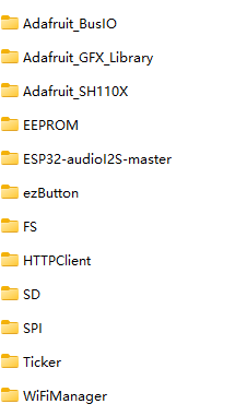

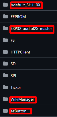

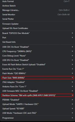

    #201 21288589
    simw
    Posts: 758
    Help: 94
    Rate: 288
    gangliu2018 wrote:
    Thank you very much for your reply MAJSTER XXL.
    I first installed Arduino 2.3.3 on (https://www.arduino.cc/en/software).
    Yesterday I walked the path to the correct "from scratch" compilation.
    You must first look here:
    https://github.com/sarunia/ESP32_radio_player/tree/main/Libraries
    You have there listed the libraries that take part in the compilation, with name and number and its creator.
    Each of these parameters is important, because there are different ones in the repository, from different developers, and it is easy to upload a bad one. However, recent updates to the latest libraries also compile.
    In the library.properties files you have the library data.
    As for the board, you should install the ESP32S3 Dev Module, not esp32s3 itself. This can be seen in the screenshots in this thread.
    In the screenshot I add to the post you have what you need to install for the project.
    Except that one of them ESP32-audioI2S-master you don't install as built-in, you have to download the ZIP and install as external. You download the zip file from:
    https://github.com/schreibfaul1/ESP32-audioI2S
    For the WiFiMAnager library by tzapu you need to edit the WifiManager.h file and line:
    Code: C / C++
    replace with
    Code: C / C++
    Screenshot of library folders, including ESP32-audioI2S-master. .
    To summarise.
    1. you install the Arduinio 2.3.3 IDE you do a full update.
    Menu Help->Check for Arduino IDE Updates
    2. you select the ESP32S3 Dev Module board
    3. you install the internal libraries:
    (a) ezButton by ArduinoGetStarted.com
    b) WiFiMAnager by tzapu
    c) Adafruit SH110X by Adafruit
    4. you install the external zip file: ESP32-audioI2S-master
    5. edit the WiFiManager.h file
    The rest of the bilbliotek is probably downloaded from the ESP Dev Module.
    Such a sketch already compiles, but is too big for 4MB memory.
    Here you have to search in the thread what the solution was, around the one in the screenshot:
    Screenshot of Arduino project settings for the ESP32S3 module. .

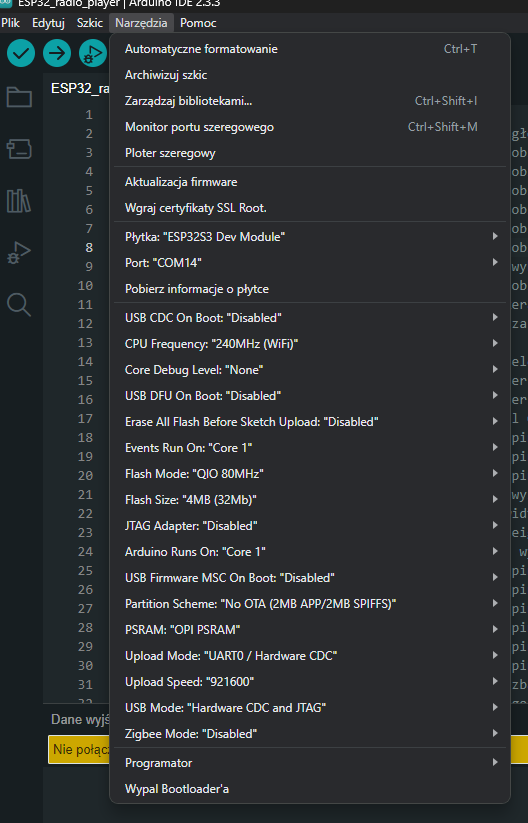

  • #203 21289387
    MAJSTER XXL
    Posts: 2064
    Help: 164
    Rate: 429
    My current settings are as follows:
    Screenshot showing settings in Arduino IDE 2.0.3 for an ESP32 project. .
  • #204 21291273

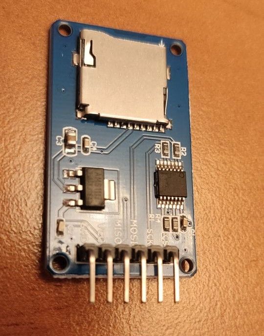

    It seems that someone reported problems with such a card reader module:
    SD card reader module on a blue circuit board with visible connectors. .
    Such a module works correctly with this project, but it needs to be powered from +5V
