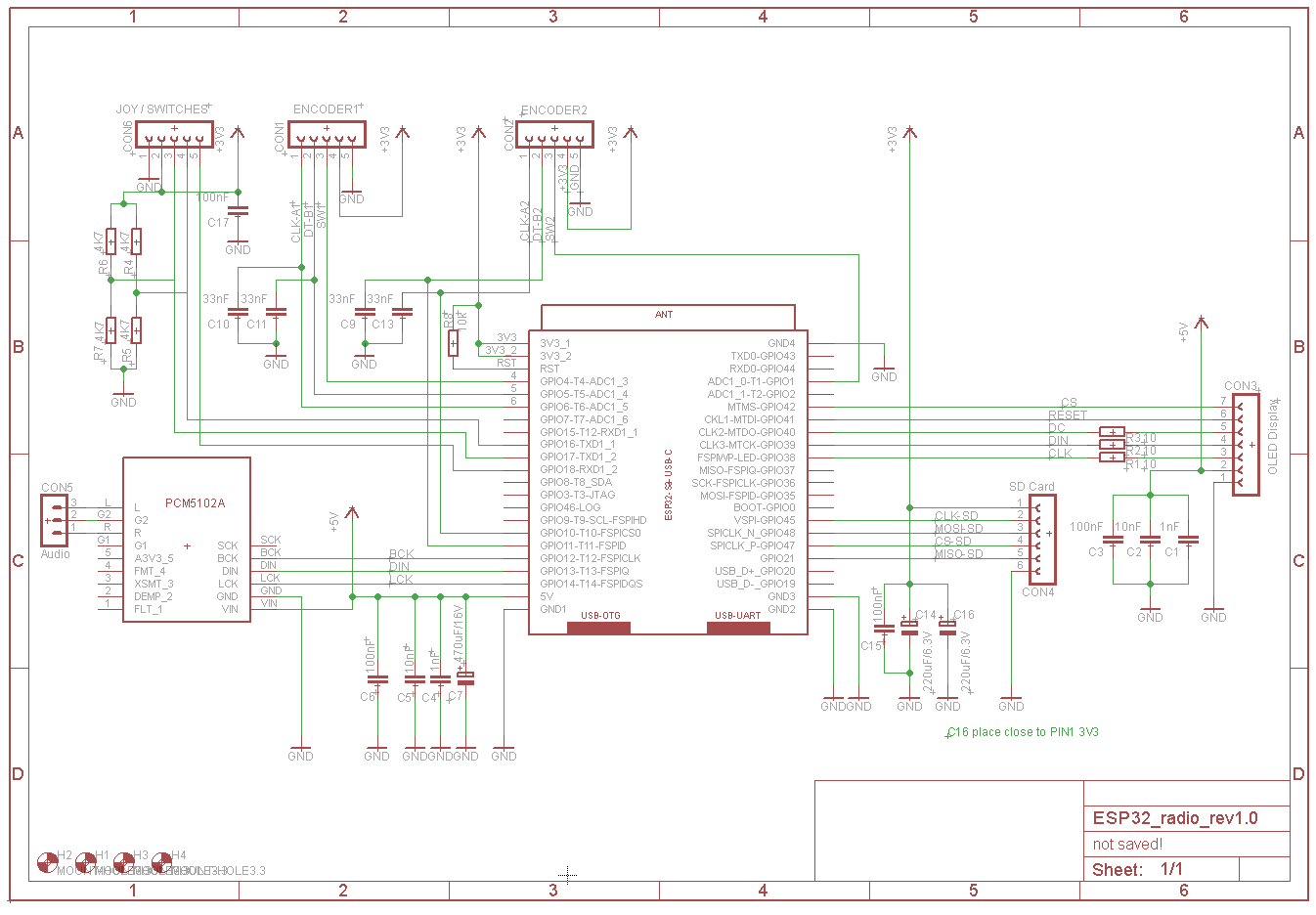

    Gentlemen I have one more small remark, in the code there is a different pin layout than in the schematic
    this is a bit confusing for others (several friends had problems with connecting the card)
    In both @robgold (ESP32_radio_evo2) and @Majster XXL (ESP32_radio_v2) there is in the code
    lines: 15-18
    #define SD_CS 47
    #define SPI_MOSI 39
    #define SPI_MISO 0
    #define SPI_SCK 38
    And further in the code it states:
    // SPI initialisation with new pins for SD card reader
    customSPI.begin(45, 21, 48, SD_CS_PIN); // SCLK = 45, MISO = 21, MOSI = 48, CS = 47
    On the other hand, in the schematic :
    MOSI 48
    MISO 21
    SCK 45

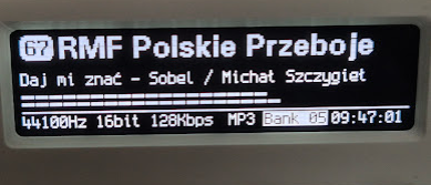

    Gentlemen, what about the Polish font?
    I'm just listening to RMF PRL and the titles are missing Polish characters ( piss them off - at least so it displays the missing letter without the Polish accent)
    Unless I something....

    With Polish characters the matter is a little complicated. At the moment it supports two encoding standards with a manually modified Spleen font. However, each radio transmits as it pleases. I tested it on "Radio Nowy Świat", as they are most fond of Polish "tails", and they displayed correctly. On RMF FM I think they convert the Polish letters to the basic alphabet. I have never encountered Polish characters there.

    I think there is trouble with the new SPI pin definitions .

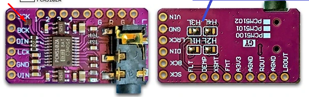

    Very interesting what you write. Today my test radio was playing on the Majster sofet and I didn't change anything. Everything worked properly. I just compile and upload.
    The only hardware change I made at my place was to add 10 Ohm resistors on the SPI lines to the OLED display.
    Admittedly there is a 1MHz ( SPI.setFrequency(1000000);) but I gave for decency.
    Check your HW well. Because the SPI pins have nothing to do with the i2s bus definition.
    In addition I have a bridge on top of the PCM to not connect the SCK pin to ground on the wires so much for the differences with the Major's schematic.
    I power the whole thing from a USB-C USB hub, the OLED and PCM powered by 3.3V from the ESP board. I don't use 5V on the radio.
    Two views of printed circuit boards with connector labels. .
    I have now uploaded:
    -> Evo2- works,
    -> Evo3- works,
    -> Soft master - works

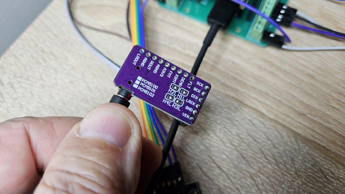

    They all boot and I have sound. Can you take a picture of your board and connections ?

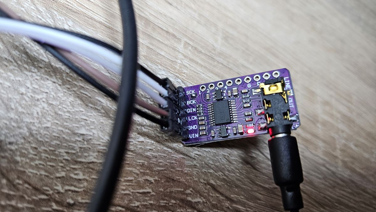

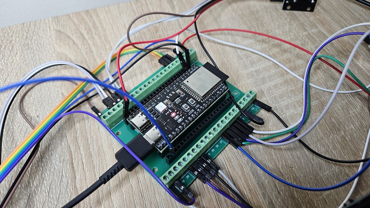

    >>21387932 .
    @robgold
    I have everything just as you describe. I solder jumpers on each new 5102 and also do not connect SCK so on top of the jumper.
    I have already tested on 4pcs and all the same.
    I only have sound on evo2 and saruni softy yesterday. No sound on the new patched ones
    See, I don't know why the sound stopped working after your changes.
    As you see now the sarunia soft is uploaded

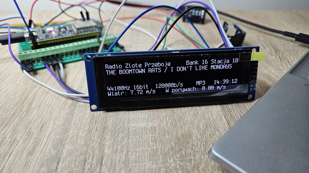

    LCD display showing information about the song I Don't Like Mondays by The Boomtown Rats, connected to a set of wires. .
    Close-up of a purple PCM5102 circuit board held in hand, connected to wires. .
    Electronic module with connected wires and a glowing LED. .
    Microcontroller with wires on a wooden table. .

    The only difference apart from the fact that pins are now defined by the "#define" directive is:
    evo2:
    #define SPI_MISO 0
    evo3, the new master soft:
    #define SPI_MISO_OLED -1
    Change this MISO to 0 in the Evo3 or the Major's soft.

    >>21387978 .
    @robgold
    change ----> MISO to 0
    Have a big beer - works your evo3 like this and will work saruni too.
    Thank you

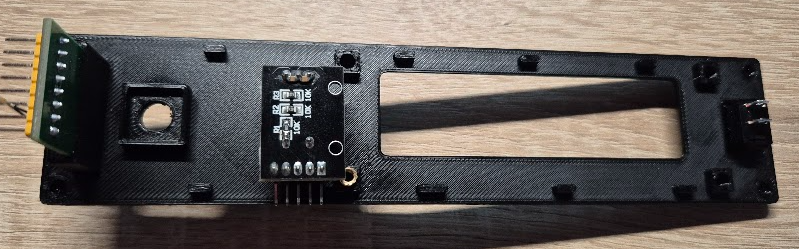

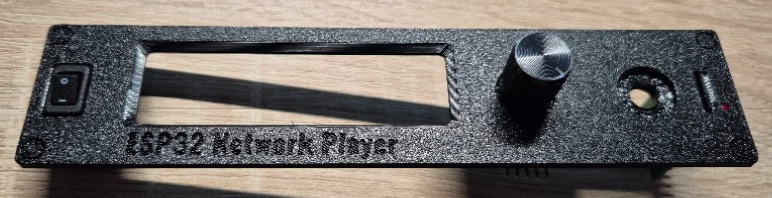

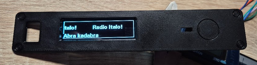

    From the "pleasures" for today it was printing the fronts for the chassis both of my own design and the first attempt for Hammond.
    As usual it turned out that Chinese specifications for displays with dimensions are nice to have but good to have my own caliper.
    Front end files (SKP, STL and 3mf under the Prusa slicer) of my own chassis design on GitHub: https://github.com/dzikakuna/ESP32_radio_evo3/tree/main/Housing/3D%20printed%20variant
    Black front panel of a device with an OLED display showing text: Radio Italo!. .

    I sat down for my morning coffee and have already changed these features a bit. Since I have the font Spleen 6x12 that we use redacted with Polish "tails" in the ISO-8859-2 Latin2 standard, Windows 1250 and, where possible, the old-fashioned DOS (who still remembers that?) CP852.
    I assigned individual characters font codes according to the standards and.... we have beautiful Polish letters on (I think) all stations. I checked Nowy Świat, Radio Pogoda, RMF PRL - it was correct everywhere.
    Assignment according to the table: https://pl.wikipedia.org/wiki/Kodowanie_polskich_znak%C3%B3w
    I'm attaching the font code, maybe you can throw in yourself and enter Spleen's 6x12PL font will have Polish letters in both versions.

    OLED display showing information about the music being played. .

    So tell me the project author has updated the schematic with a directional button module - so far this is not used in the sofet so it will be worth making a goldpi 1x5pin strip on the PCB for this too.
    Greetings ...

    The tape for the display on the one hand is a great idea on the other hand there you use only 7 wires. The rest will be redundant. Here an IDC connector of this type would probably be better: https://www.tme.eu/pl/details/m20-1070800/zlacza-sygnalowe-raster-2-54mm/harwin/ .
    Eagle library for ESP32-S3 I have, I have drawn, I can send you.
    As for the differences in the schematics, Majster's colleague added the joystick as a 5 button keyboard. His code already supports this.
    As he wrote himself there are a lot of problems because this joystick is analogue so it requires reading ADC pins.
    Eventually I will also have a keyboard, but on tact-switches, maybe to keep compatibility I will start "pretending" resistance with my keyboard.

    I understand that you want to simplify this PCB very much, but the question is whether nowadays, when you order double-sided PCBs in China, with metallization and description for a few dollars, thermo-transfer still makes sense? You have to decide for yourself.
    To answer your questions:
    Yes the display from Msalamon 3.12 is exactly that display. I also bought there myself because there is not much difference between Ali and you have it the next day - a very good shop. At my place on GitHub you have ready-made binaries. You don't even need to have an Arduino. The code there available ino and bin is just for this display on the SSD1322 controller.
    In both versions there is a WiFi manager that allows you to use your phone/computer to configure WiFi - the radio emulates an Access Point called ESP Radio - you connect to it, go to 192.168.4.1 and the WiFi manager portal starts up. The login details are stored in the ESP's internal flash memory. If the radio cannot connect to the network at the new location, it will enter configuration mode again after a while and you can once again save a new network name and password.
    Here you have my schematic files and unfinished PCB. Link .
    I couldn't find an ESP32 S3 library so I made my own symbol and footprint for the existing one I had.
    The PCM5102A library is from the web. I only corrected the signal names. I have not checked if it is drawn correctly in the raster, so I suggest to print it on a sheet of paper beforehand.
    Electronic schematic of a PCB using ESP32 and PCM5102A. .
