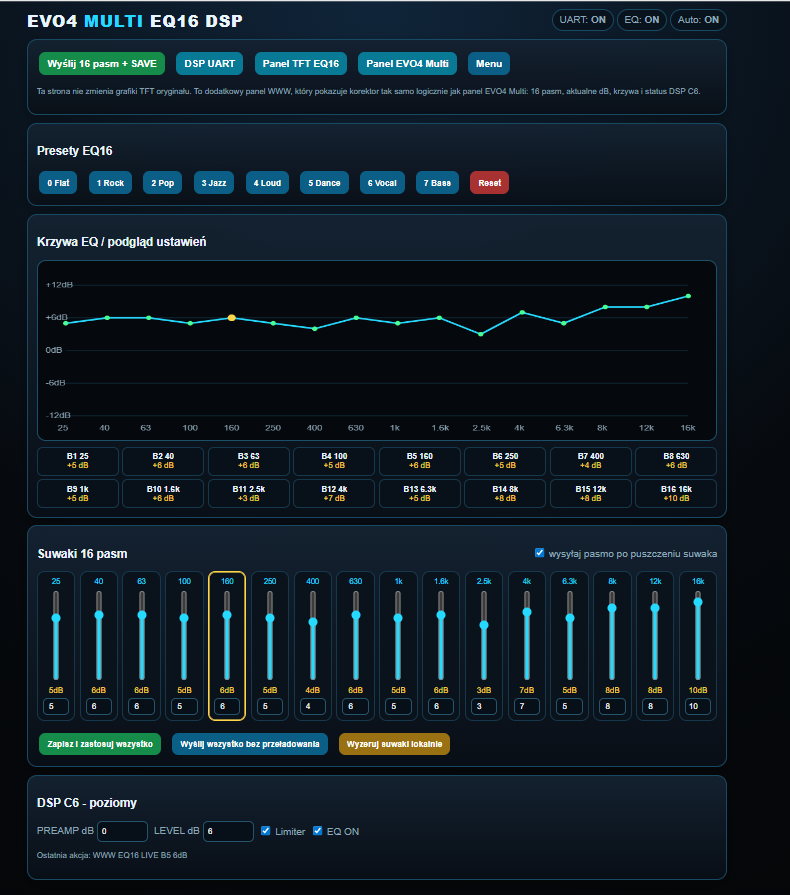

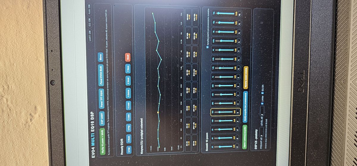

  • ESP32-C6 can run a 16-band equalizer
    #2708 21907010
    ejcon
    Posts: 301
    Rate: 68
    robgold wrote:
    >>21906412 Looking at what piece of software you need to have for such a DSP in order to prepare its configuration, it is probably simpler to have an environment from TI for TAS amplifiers. They also all have the DSP built in, but in the Evo configuration when the TAS is switched on, it is deactivated and a bypass is made only to the amplifier.
    And yet it was possible to make an equalizer on ESP32C6 EQ 16 +-12dB

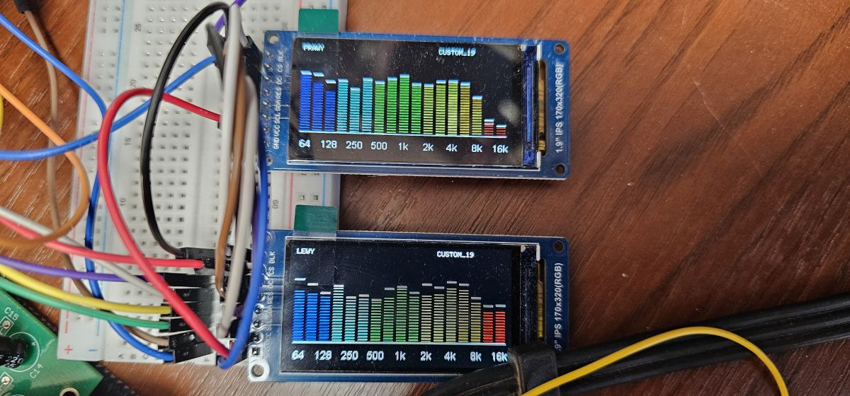

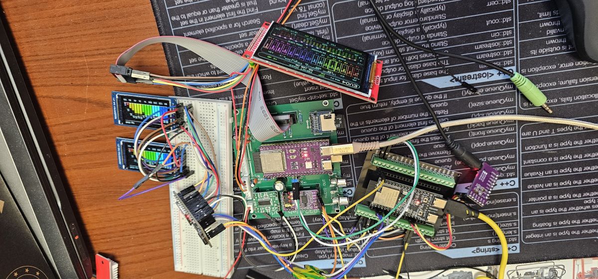

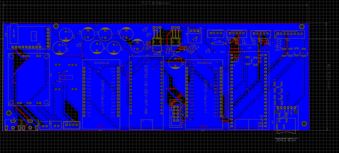

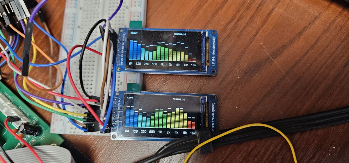

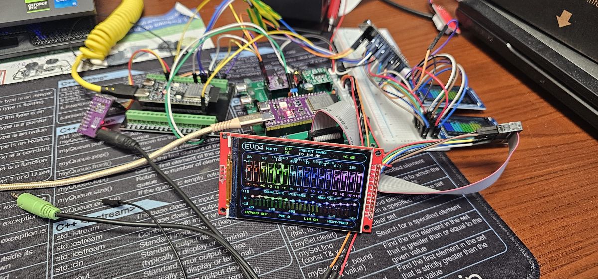

  • ESP32-S3 internet radio test version and PCB progress

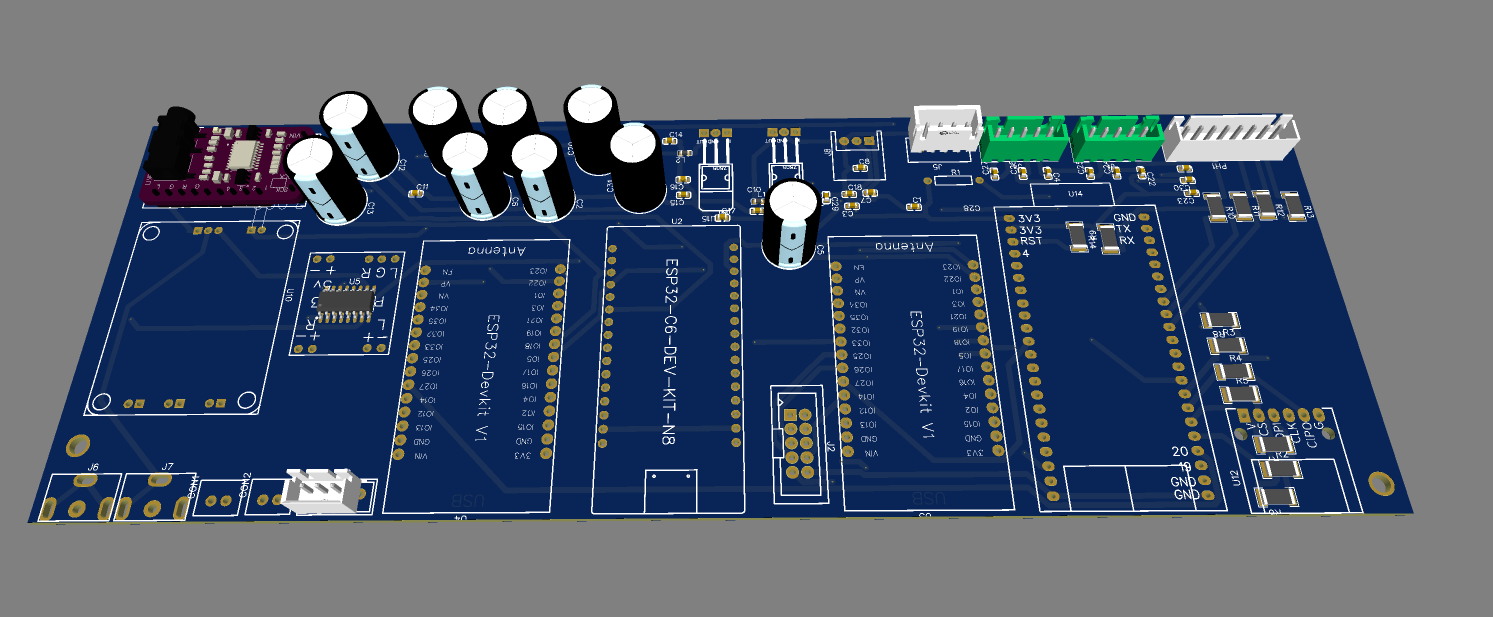

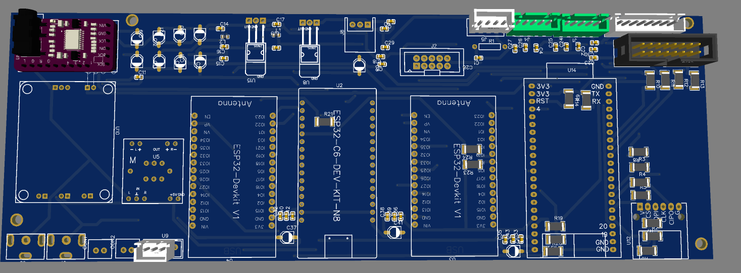

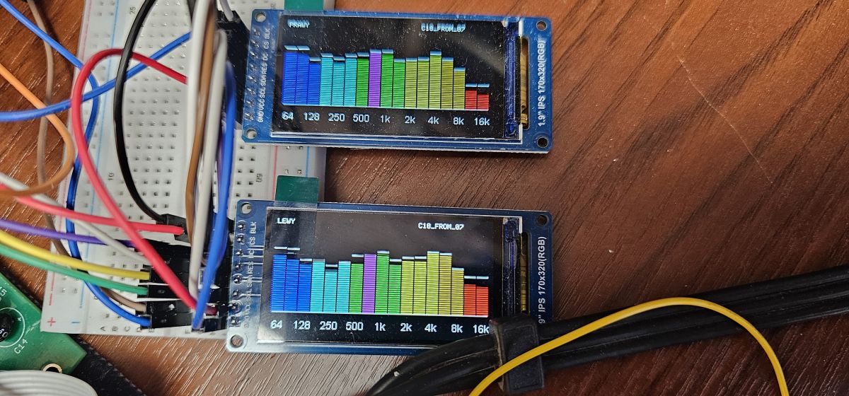

    #2709 21908278
    ejcon
    Posts: 301
    Rate: 68
    Electronics test setup with boards, breadboard, and a color display showing bar graphs Electronics test setup with PCBs, breadboard, and many wires on a desk Dell laptop screen showing EVO4 MULTI Entertainment DSP interface with a line graph and multiple sliders
    Test version
    Internet radio and audio file player on ESP32-S3 Internet radio and audio file player on ESP32-S3 Internet radio and audio file player on ESP32-S3 Internet radio and audio file player on ESP32-S3 Internet radio and audio file player on ESP32-S3
    A PCB is slowly being created for this version .

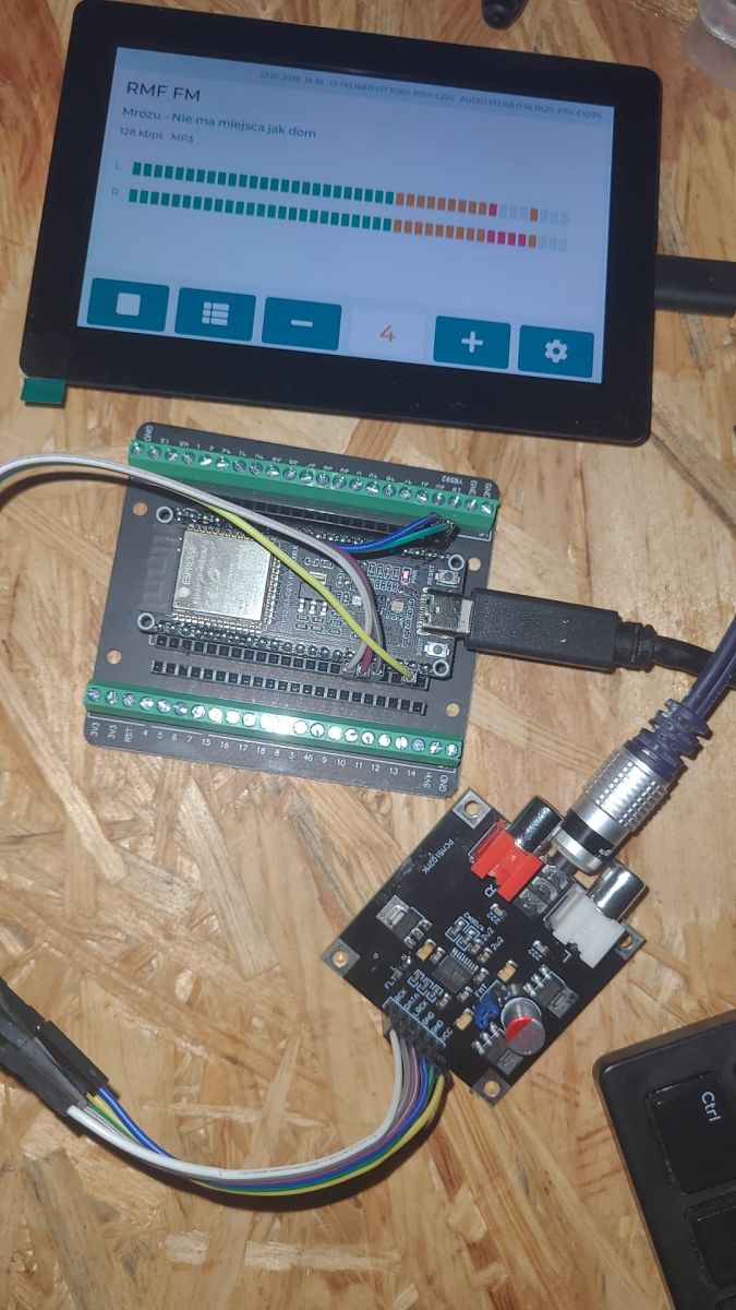

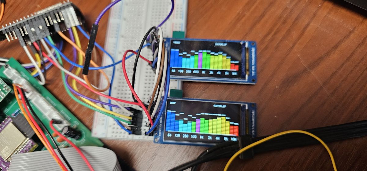

  • Second ESP32 added for UDP communication

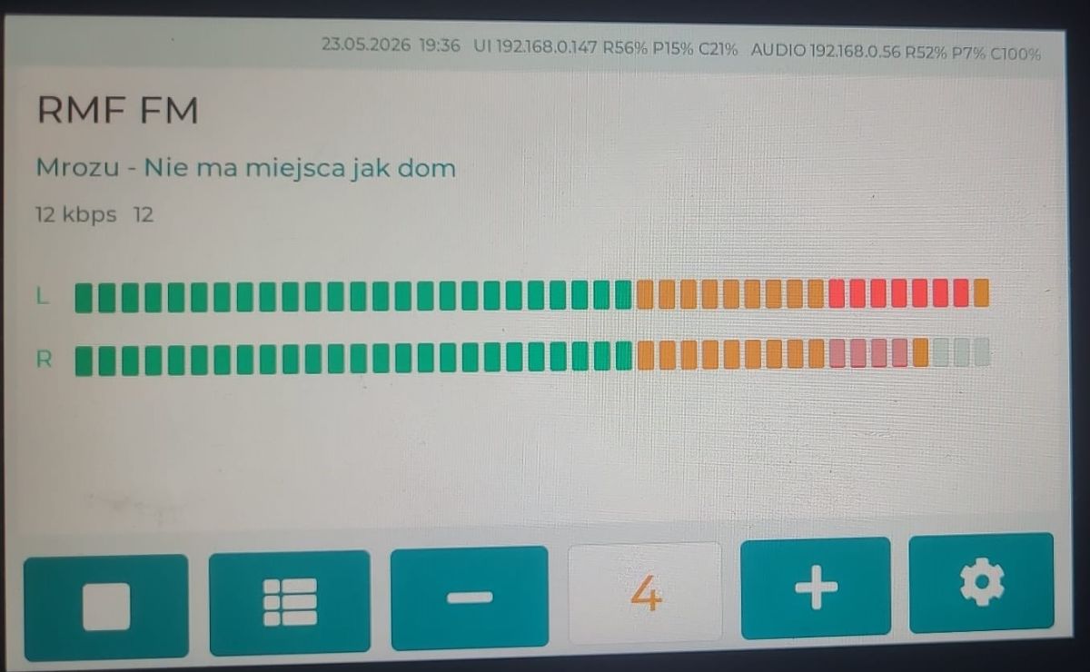

    #2710 21908871
    pawel_1980
    Posts: 16
    Brilliant!
    I bought a Waveshare 5 inch 1024×600 at a bargain price and had a problem how to solve the connection with the PCM5102.
    I read what you are doing now with the VU, and added a second ESP32. I did the communication between them over UDP.
    I already thought I would have to cut paths.
    P.S. Congratulations
    Screen showing RMF FM interface with song title and two L/R level meters in green-to-red segments Touchscreen with VU meter bars and two ESP32 boards with wiring on a wooden work surface

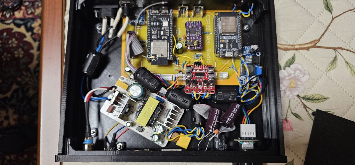

  • Adding a 22 µF cap and TPS61040 boost inverter
    #2711 21909894
    ejcon
    Posts: 301
    Rate: 68

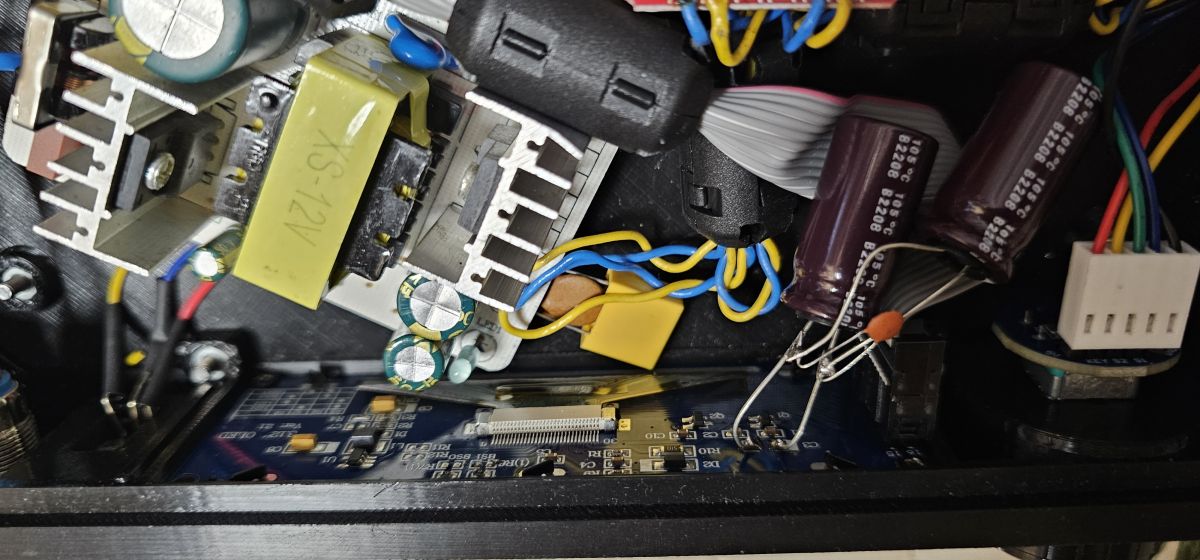

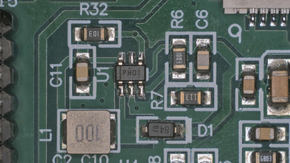

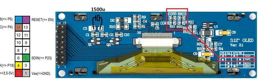

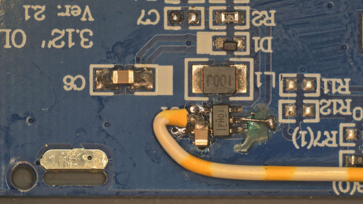

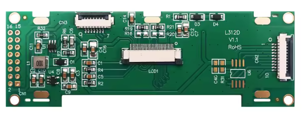

    robgold wrote:
    >>21881513 Yes, I have a 22uF/10V MLCC doped in ( could be 10uF just left over from a Dell laptop repair).
    I have replaced the inverter with a TPS61040DBVR and supply it with 5V instead of 3V. For the large OLED (the 5.5 one) I bumped its voltage up to 15V and it works stably. I will probably still bump it up to 16V.
    And here is a picture of the display PCB from Ali, where the layout is much better designed and the inverter is powered from 5V. Microscope photo:
    Here the appearance of the whole PCB:
    @kula350 you made something like a "shield" out of UTP cable - question why when there are dedicated shielded audio cables? Good, inexpensive and looks nice.
    Soldering a capacitor into this location like this reduces amp interference less heard in the speakers is this a good idea?
    This is what it looks like inside
    @ElektrodaBot
  • Large decoupling capacitor may reduce audio interference
    #2712 21909897
    ElektrodaBot
    AI OpenAI ChatGPT4
    Posts: 8880
    Help: 364
    Rate: 954
    ejcon wrote:
    https://obrazki.elektroda.pl/6259966300_1779724264.jpg
    @ElectrodB...
    Short answer
    If this capacitor is soldered parallel to the power supply of the display module / ESP / logic , i.e. between VCC and GND , and there is less interference in the amplifier when it is added, then the direction is good. This means that interference is most likely entering the audio path via common supply or common ground .
    On the other hand, I would treat the capacitor 1500 µF in such a location as an auxiliary, not a target solution. It may help, but it is still worth improving the filtering and ground routing, as a large electrolyte alone will not remove all interference from the ESP32, Wi-Fi, display and inverter.
    What you probably did
    From the photo it looks like you want to add a large electrolytic capacitor at the display module, most likely on its power supply.
    If it is connected like this:
    Code: text
    then it is a power supply buffer capacitor. It acts as a local energy store and reduces voltage collapses and ripples caused by the display, ESP32 or other digital modules.
    In circuit with:
    - ESP32,
    - tFT/OLED display,
    - PCM5102A DAC,
    - audio amplifier,
    - wi-Fi/UDP communication,
    interference very often comes precisely from the pulsed current consumption of the digital part. Then such a capacitor can realistically help.

    If you leave 1500 µF, definitely check:
    - the capacitor's operating voltage: minimum 6.3 V for 5 V, better 10 V or 16 V,
    - correct polarity,
    - that the 5 V / 3.3 V stabiliser does not heat up more,
    - that the circuit starts correctly after power-up.
    Better solution than 1500 µF alone
    The large electrolyte is worth supplementing with small ceramic capacitors. A typical filtration set up looks like this:
    Place Recommended capacitors
    At ESP32 100 nF + 10 µF + 470-1000 µF on bus power supply
    At the display 100 nF + 10-47 µF, possibly an additional 470-1500 µF electrolyte
    At PCM5102A DAC 100 nF + 10 µF possibly close to the module
    At the amplifier 100 nF + 470-2200 µF depending on power
    On the power input of the whole circuit 1000-2200 µF + 100 nF
    [/table:b2224b3b44] [/tr:b2224b3b44] [/tr:b2224b3b44] [/tr:b2224b3b44]
    The 1500 µF capacitor alone filters mainly the lower frequencies. Interference from ESP32, SPI, I2S, Wi-Fi and the display often have much higher frequencies, so there should be a ceramic capacitor in parallel:
    Code: text

    Should I leave this capacitor in place?
    If it is between power and ground, works and nothing heats up -- you can leave .
    But ultimately I would do it like this:
    1. I would leave 1500 µF rather at the power input of the module/display or the whole circuit.
    2. I would add a 100 nF ceramic directly in parallel to it.
    3. At the DAC PCM5102A I would give separately 100 nF + 10-47 µF.
    4. At the amplifier separately 470-2200 µF + 100 nF.
    5. I would separate the ground and power wires of the digital and audio parts.
    My rating
    Yes, that's a good clue, but I wouldn't take that as a complete solution to the problem.
    If there is less interference after adding the capacitor, this confirms that the problem sits in the power supply/bass. It is now worth sorting out the filtering and grounds rather than just increasing capacitance.
    The most likely set up to help:
    Code: text
    And necessarily a short, shielded DAC → amplifier audio connection.
    If you can, still show exactly between which two points you soldered this capacitor: plus/minus, VCC/GND or some signal point. Then it will be possible to say unequivocally whether it is in the ideal place or just accidentally masks the problem.
  • Capacitor slightly improves inverter, ferrite beads ineffective

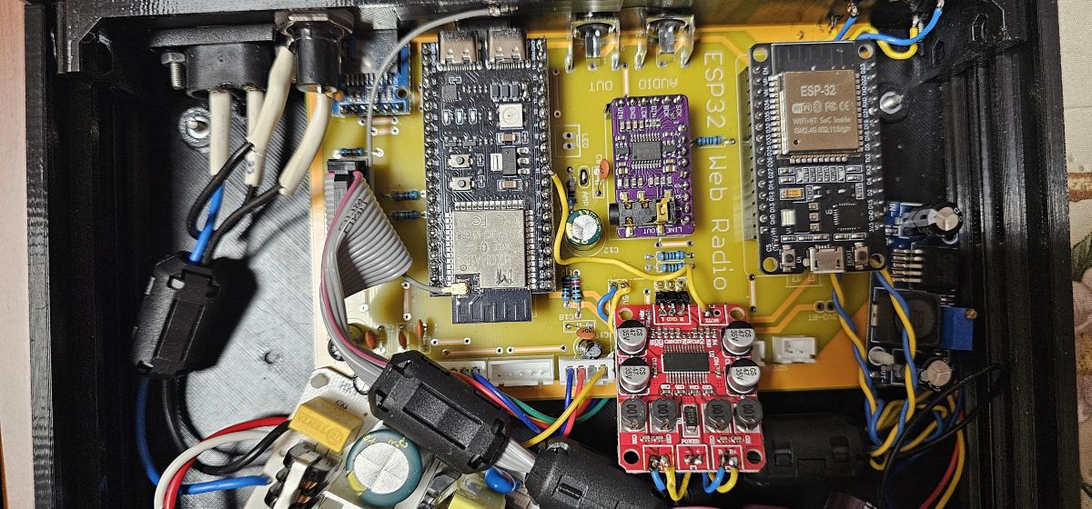

    #2713 21910027
    ejcon
    Posts: 301
    Rate: 68
    >>21909897 Thanks fetites I have put on the display cable and on the power supply of the amplifier and the radio but the beads did not give anything, only this capacitor slightly eased the operation of the inverter but it is still not perfect.
  • Ferrites ineffective; supply and ground coupling likely cause

    Code: text
    i.e. a choke/ferrite in series with one power supply wire , usually with plus, followed by capacitors to ground. A clamp-on ferrite on the cable alone is not enough.
    Capacitor at display - leave, but carefully
    If this 1500 µF capacitor is indeed plugged in between:
    Code: text
    then you can leave it in. This improves the local current buffering and therefore "softens" the operation of the OLED inverter/inverter or backlight.
    But an important note: do not give such a large capacitor in place of the charge pump capacitor/high voltage OLED inverter if this is not the module's power input. The large electrolyte should sit on the module power input, not on a random node of the internal inverter.
    Safest arrangement at the display:
    Code: text
    Capacitors should be as close as possible to the module power pins.
    Most important: separate the "dirty digital" from the audio
    You can see from the photos that you have in one enclosure:
    - 12 V switching power supply,
    - dC/DC converters,
    - ESP32,
    - display,
    - dAC / radio module,
    - amplifier,
    - lots of cables and ferrites.
    This is a circuit where interference penetration is very easy. Ultimately I would make the power supply like this:
    Code: text
    Don't power the DAC and the audio path from the same point from which the current pulses go to the display and ESP.
    Concrete filtration proposal
    1. At the amplifier
    If the amplifier is powered from 12 V, give directly at its power input:
    Code: text
    Keep the amplifier's power supply wires short and fairly thick. Do not route the amplifier ground through the ESP board or the display.
    If you want to give a filter in the amplifier power supply, the choke must be for the right current, e.g. a few amps. A small 100 µH / 200 mA choke will saturate and do nothing.
    2. For the PCM5102A DAC / radio
    Here the filter can be much more effective as the currents are small.
    Example for a 5 V DAC/radio supply:
    Code: text
    Even better:
    Code: text
    For the DAC itself, a good linear stabiliser usually gives a better result than adding more large electrolytics.
    3. For the display
    I would leave the display on the "dirty" digital branch, but with its own filter:
    Code: text
    Plus 100 nF and 10 µF at the module itself.
    If the interference changes with the brightness of the screen, it is very likely that the backlight inverter or the OLED inverter is seeding.
    Mass - probably a big part of the problem here
    Don't lead the masses that way:
    Code: text
    This is asking for interference, because the display and ESP currents then flow through the same ground that the audio track sees.
    A better arrangement:
    Code: text
    That is, one central ground point, preferably at the main power supply capacitor / power input to the unit. From this point separate wires to:
    - amplifier,
    - DAC/radio,
    - ESP32,
    - display.
    The audio path should not be current return from the display.
    Filter on amplifier audio input
    If some of the rubbish enters through the amplifier input, a mild RF filter can be added. For each channel:
    Code: text
    Such a filter cuts off high-frequency rubbish, and should not move the audio band if the values are reasonable.
    Don't put large capacitors like 10 nF, 100 nF to ground in there, as you might start clipping the highs.
    Diagnostic tests worth doing
    Test 1 - short circuit the amplifier input
    Disconnect the audio signal from the amplifier and short its input to ground via a short cable.
    - If the interference is still in the speakers - the problem goes through the amplifier power supply.
    - If the interference disappears - the problem goes in through the DAC, the radio, the signal ground or the audio cables.
    Test 2 - separate amplifier power supply
    Power the amplifier for the test from a separate 12 V power supply or battery.
    - If it gets quiet - the current power supply/inverters are sowing after the power supply.
    - If it continues to hum/squeak - look for ground and audio input.
    Test 3 - disconnect the display
    Briefly disconnect the power supply to the display or reduce the brightness.
    - If the nature of the interference changes - the display or its inverter is to blame.
    - If no change - more suspicious is the 12 V power supply, the DAC or the ground routing.
    Test 4 - power the ESP/DAC from the powerbank
    For the test, power the digital/DAC part from a separate USB powerbank.
    - If the interference drops sharply - you have confirmation of a common power supply/powerbank problem.
    Note about the 230 volt power supply
    The photo shows an open 230 V/12 V switching power supply module inside the housing. Caution here:
    - maintain clearance between the mains side and the low voltage side,
    - protect the 230 V side from touching,
    - the mains cables must have mechanical strain relief,
    - the power supply should be mounted on spacers,
    - it would be good to give a fuse on the 230 V side.
    From an interference point of view, it is often better to use a decent external 12 V power supply, e.g. from a laptop or a branded module, than to fight with a cheap open power supply in the same enclosure as the audio.
    What I would do in your circuit as the next step
    I would not add any more random capacitors. I would do consecutively:
    1. Short-circuit the amplifier input to ground and see if the interference stays.
    2. Power up the amplifier for a test.
    3. Separate power branch for DAC/radio via LC filter or RC + LDO.
    4. Ground to star - separate GND wires for amplifier, DAC/radio, ESP and display.
    5. Capacitors at amplifier and DAC , not just at display.
    6. Short, shielded audio cable between DAC/radio and amplifier.
    7. Only at the end possibly ferrites, but already as an add-on, not the main means of fighting.
    Summary
    The capacitor you added, makes sense since it improved the situation. This confirms that the problem is power supply/pulse currents. But ferrites on cables will not solve this type of interference if the main problem sits in the ground and power supply.
    The biggest improvement should give:
    Code: text
    If you throw in a simple sketch of exactly where the 12 volts goes from, where you do the 5 volts, where the ground is for the amplifier, DAC, ESP and display, you can point specifically to "this wire rewire here, give a choke here, a capacitor here, and disconnect this ground from the chain".

    If I disconnect the cable from the OLEDA, the interference disappears completely.
    It's the inverter that's sowing the seeds. Do you have any way of embracing this problem too?

    Power the 5v and gnd from a separate 5v charger i.e. the radio from one power supply and the OLED from the other, connecting the grounds only for the OLED signals.

    Maybe not the inverter but the OLED, i.e. the pixel control? It's probably a muliplex installation and the power supply interference is probably adding to it.
  • OLED inverter layout and supply filtering fix
    #2718 21910331
    robgold
    Posts: 726
    Help: 10
    Rate: 290
    >>21910317 I have already described this topic. In my opinion, the layout of the OLED inverter is wrong. Powering the OLED from a linear 14-17V source removes any interference. Correct layout to the coil, filtering also solves this problem.
    In Denon/Marantz equipment it is organised in such a way that the main inverter generates several voltages including one +18V for the OLED and on the main board itself there is additionally a linear LDO stabiliser creating +16V and this is how the pixel system is powered.
    These most popular 3.12 inch OLED displays additionally have, as it were, a "by force" inverter supply from 3.3V instead of 5V because this inverter is so "shoddy" that it cannot withstand a 5V supply. You have to replace it with the original MCP, do a good filtering, power it from 5V and the problems disappear.

    >>21910027
    I corrected the ground routing etc.
    But there was still a problem with interference, I connected the capacitor on the display as before, it helped a little but the biggest contribution was the car filter "Auto radio interference filter connected directly to the power supply of the amplifier. As someone will have a similar problem I recommend this solution.
    I am waiting for parts to improve the inverter of this OLED.
    Replacing the inverterTPS6104DBVR and diode D1 on SS14 and capacitor C8 where there was none helped 100% the interference disappeared completely;
    Thank you all for your help.

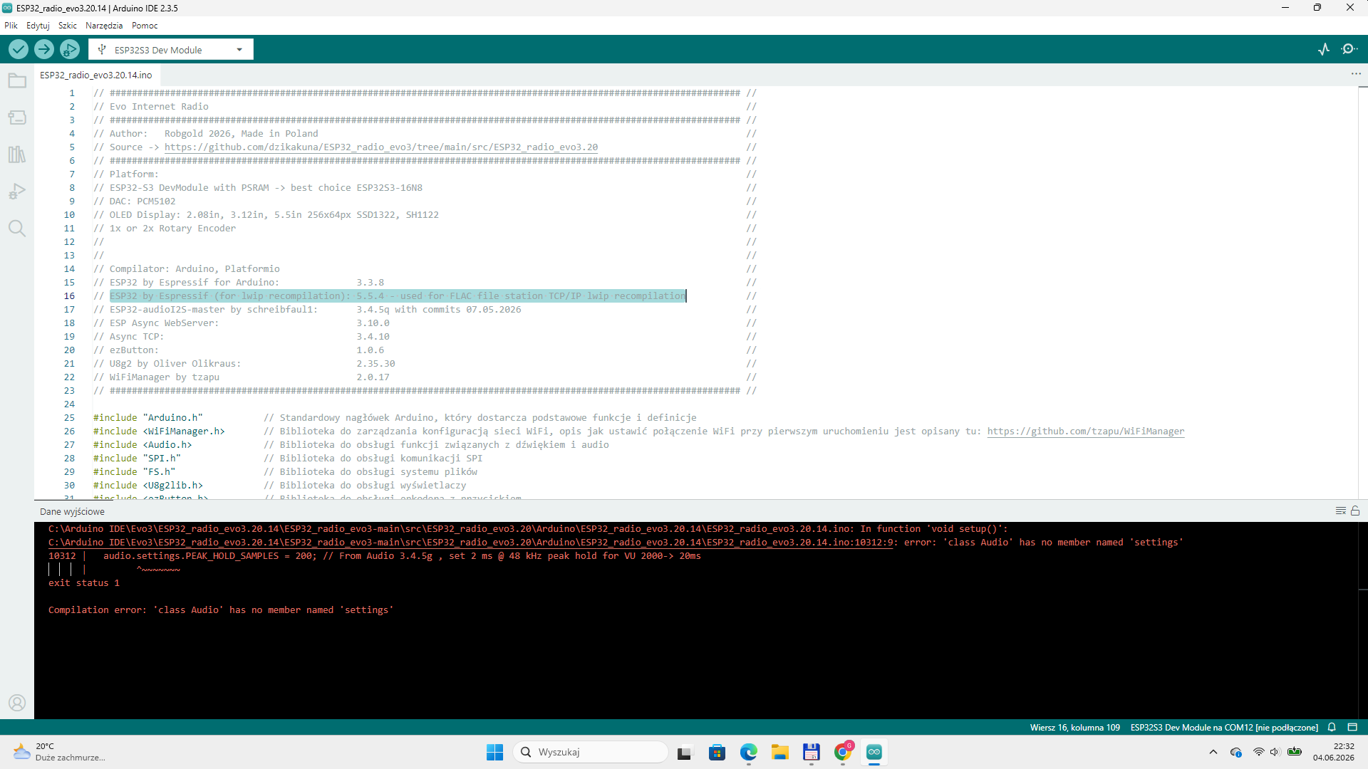

    Hi, question for @robgold when uploading the Evo3.20.14 software, libraries as they should be except for one
    ESP32 by Espressif (for lwip recompilation): 5.5.4 - used for FLAC file station TCP/IP lwip recompilation
    I can't find it anywhere and that's probably why this error below is popping up.
    Please advise where I can download this library
    Arduino IDE screenshot with ESP32_radio code and compile error “class Audio has no member named settings”.

    DJCheester
    Level 28  
    Posts: 2089
    Help: 75
    Rate: 958
    You download the original latest Audio I2S library and substitute the files that kol Robgold posted on Github, kol efi222 gave you on a tray.
    And I once wrote step by step instructions on how to do it.
    The instructions are correct only the versions have probably changed.
    Regards...

    Today's work on spectrum vu

    robgold
    Posts: 726
    Help: 10
    Rate: 290
    >>21915714 For the radio to work you need a suitable audio library. Usually the one in Arduino is severely outdated so you need to manually replace the files for the audio library from the author: https://github.com/schreibfaul1/ESP32-audioI2S
    The modified lwip (TCP stack) files on my GitHub are to increase the WiFi bandwidth on the ESP and to allow playback of high bitrate stations (mainly FLAC). At startup you can skip this. Once you manage to get the radio working and the mp3 stations are playing then replace the files in the ESP32-S3 "core" and you can also listen to the FLAC stations without stuttering.
    The information in the code is there so that you know which library the radio is currently running with and which version of the "ESP core" the modified and recompiled TCP stack libraries are running with (to increase the throughput of WiFi and FLAC stations). These are not universal and for each version of ESP-IDF core for Arduino compiles a new version.
