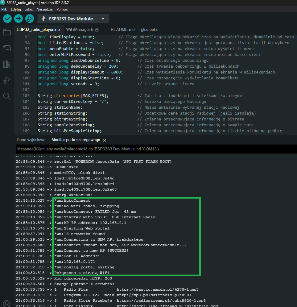

    Arduino IDE interface with code and serial monitor.
    @hevet unfortunately sometimes I have a problem with encoders, I will remove the wifi selection support from the program, which I started doing, maybe it will improve, because I noticed that after adding it something got worse and I can`t deal with it.

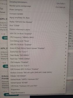

    HELP!!! I broke the radio. I tried to upload the latest soft, the one with WiFiManager and it failed because it didn't fit. I don't know how to change the partition as you write about above so I decided to go back to my previous working version. Unfortunately the radio stops at a flashing "Internet radio" and that's it, subsequent uploads with flash deletion, network changes, prayers and curses don't help. The serial port monitor periodically throws up something like this:

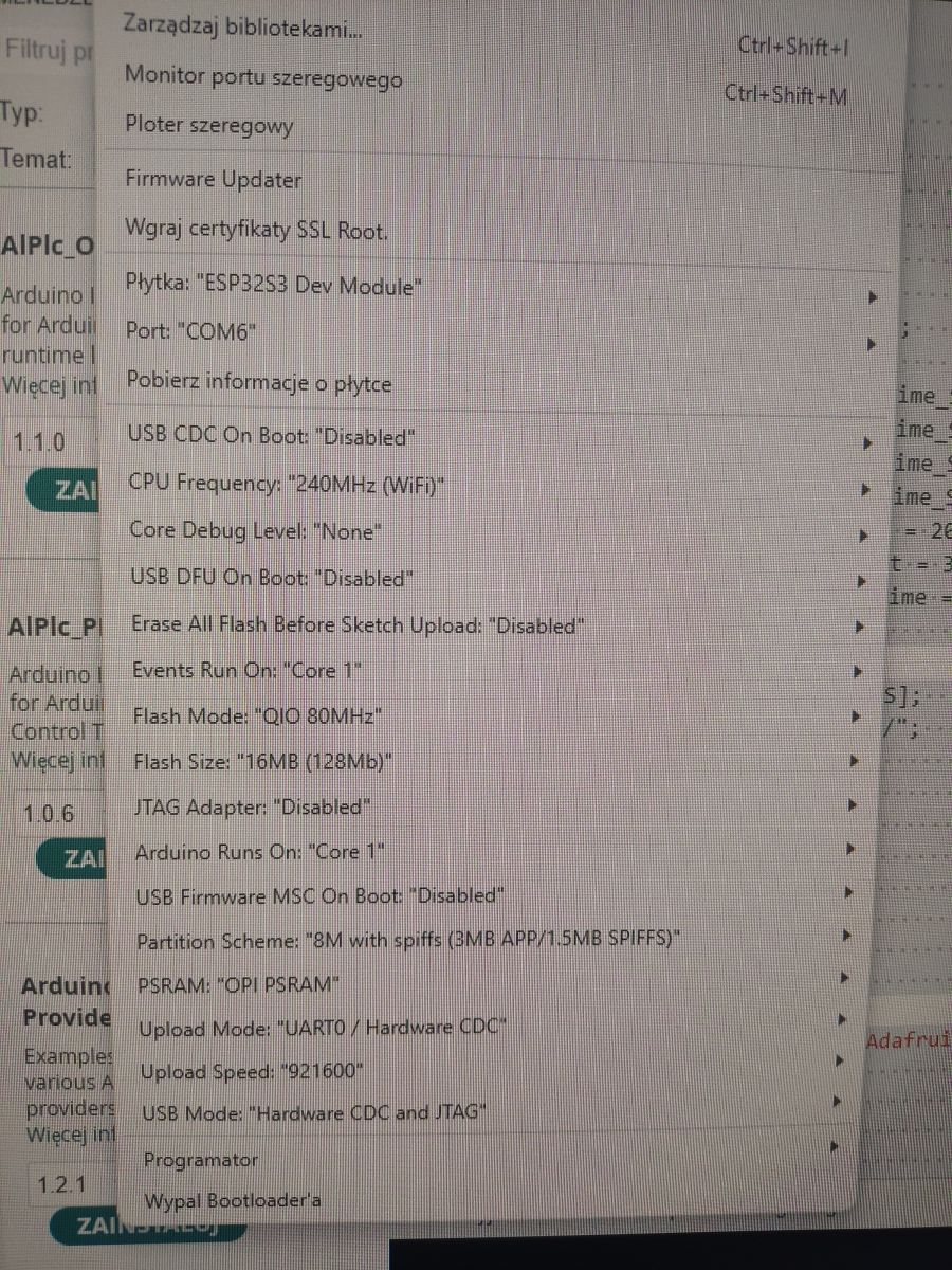

    Set the parameters this way and win the latest soft.

    Thank you for your prompt response! I did as you wrote, the soft loaded without errors but it didn't change anything. It continues as if it resets on "Internet radio", more or less every two seconds.
    I have unplugged the peripherals but with no effect.
  • #99 21052553
    hevet
    Posts: 346
    Rate: 47
    And have you erased the flash? Download flash download tools and do a flash erase.

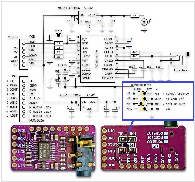

    I've screwed up this project (revelation it is) only I have a problem the sound is not coming out on the headphones and there is such an error in the port monitor (233) I2S: i2s_calculate_common_clock(1180): sample rate is too large
    E (233) I2S: i2s_calculate_clock(1229): Common clock calculate failed
    E (235) I2S: i2s_set_pin(295): ws_io_num invalid any hints?

    @paulosxc have you made the connections on the DAC module as in this screengrab?

    Encoders connected to 3.3v and there is an improvement. Sometimes the radio does not start, the internet radio message flashes, do you also have this? Does it play files from the sd card or if so, how should they be catalogued?

    @paulosxc The radio should run even on just the ESP32 with the DAC, you can unplug the rest for a trial, it should go to play the default station once the network is configured. Let us know what's up with the lack of audio.
