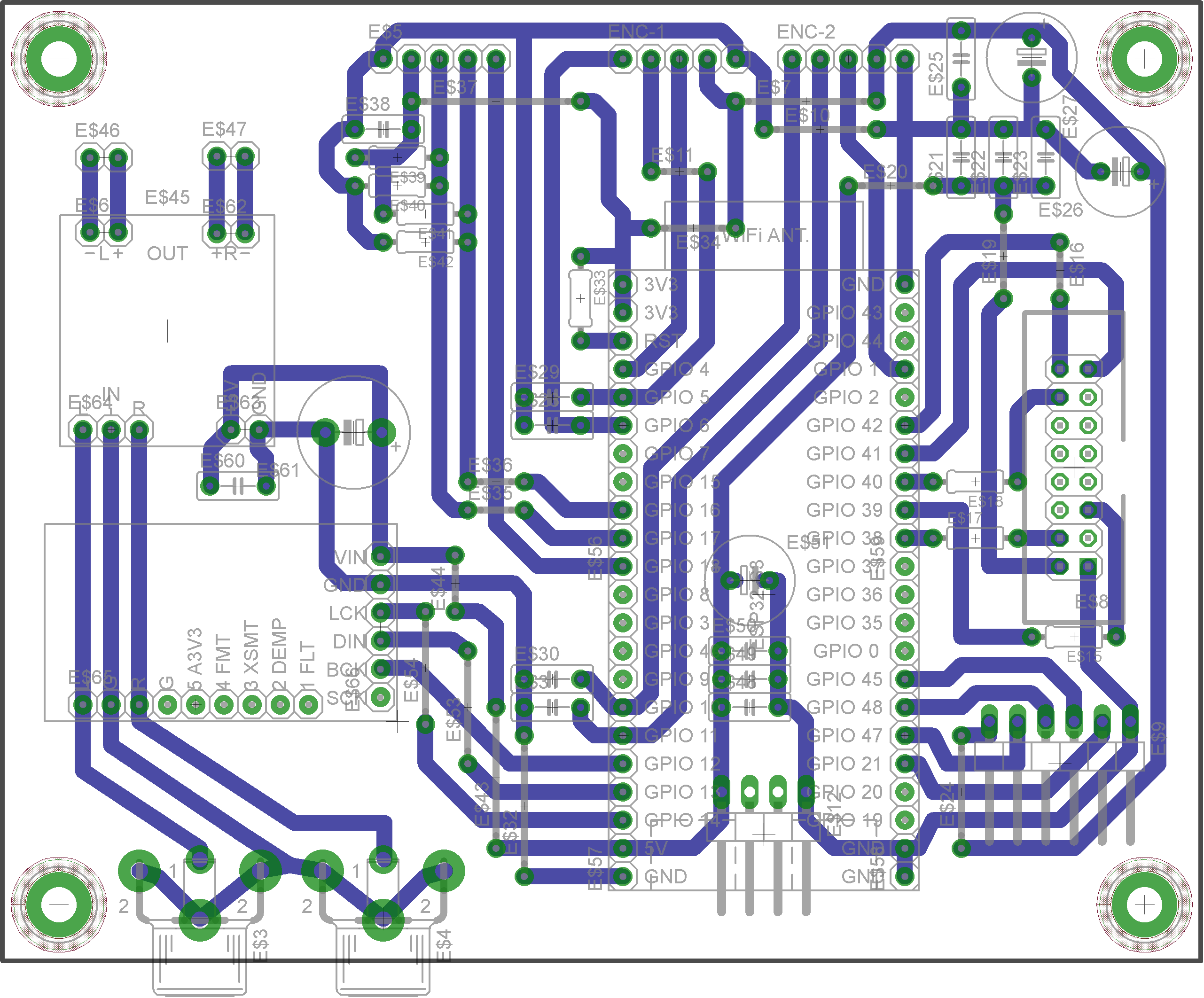

    Hello for the versatility of PCBs but this is just a figment of my imagination.

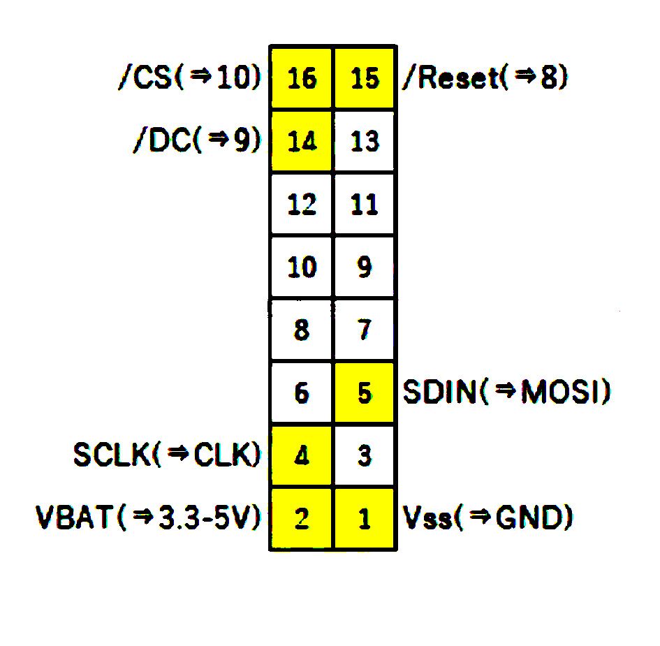

    I started comparing materials - on the author's PCB the OLED is connected to different ESP32 pins than on yours ?
    Did you change this during the modification and the current softy supports these changes ?
    On the author's there were pins 3,46, 8,9 and on yours it is from 38 to 42 ??
    As for the connectors for the OLED for the time being I put this 2x8 pin under the 3 inch screen
    Pin diagram with function description and numbers. .
    Greetings ...
    Added after 1 [hours] 11 [minutes]:

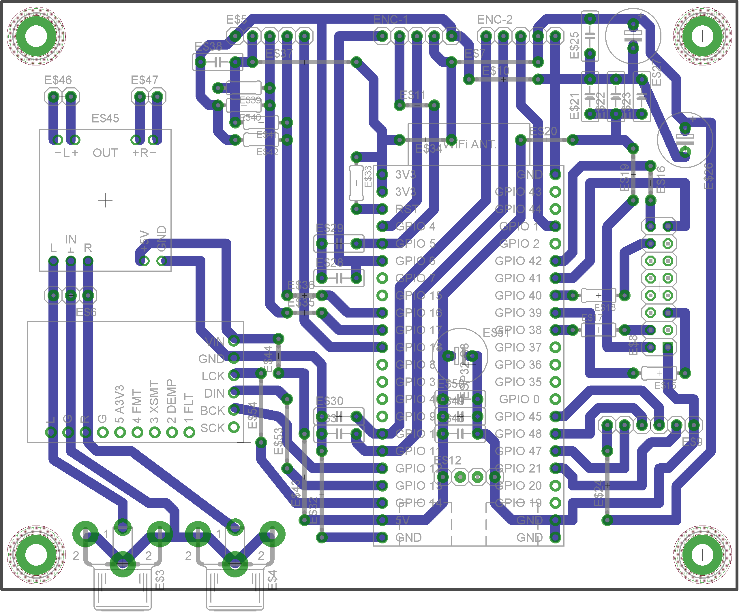

    Hello, for now a sketch of a single sided PCB without polygons - for now there are connections and this to check I will sit down when there will be a moment again - through-hole components, I have added a PAM8403 2x3W amplifier module with speaker outputs so that the radio can be used on its own 5V amplifier power supply next to it I will add some more filter capacitors. the main filtration is designed for ESP as well as a 4-pin small PCB with a USB power socket
    I made the PCB for now, first version, it is possible that there are some mistakes, I will just check it.
    On the PCB
    2x5pin connectors from two encoders
    1x5pin connector from directional buttons
    IDC16pin - for the OLED display (I have given up on one connector for now)
    6-pin - memory card module
    4-pin - under ESP power socket module
    2x chinch - audio output
    2x2pin - added 2x3W amplifier and speaker output
    That's it
    Single-sided PCB design with various trace connections. .
    Greetings ..,

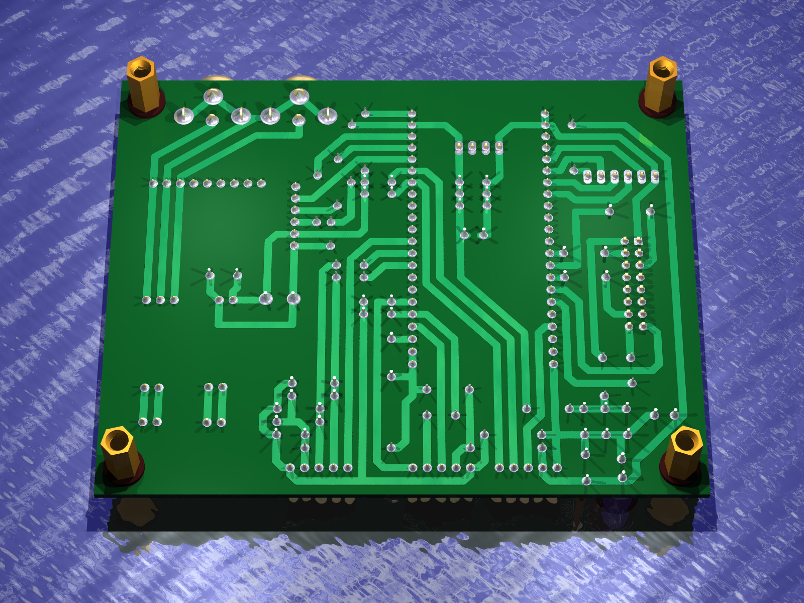

    Added after 1 [hour] 56 [minutes]:
    Board more roughly embraced from colleague's schematic, added 2x3W PAM8403 amplifier in Chinese version and two capacitors at the amplifier.
    As for the software is there the possibility of programo vol+/- ? because this would take care of the radio as a standalone device, for example after adding the speakers it would function as a kitchen radio.
    The board after my inspection - I will still check the connections tomorrow at ease (with a fresh mind) and when the modules arrive I will check the pin spacing so that everything fits.
    PCB schematic with circuit paths and connectors. .

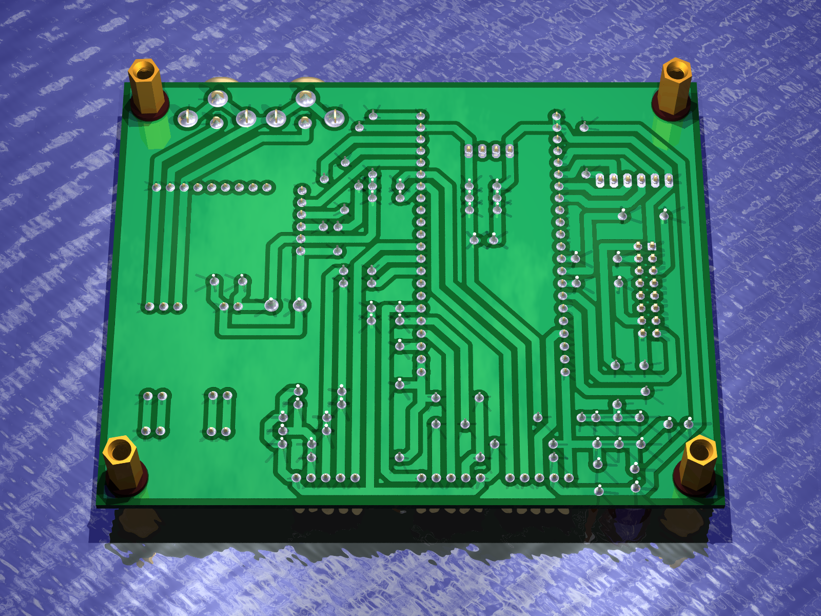

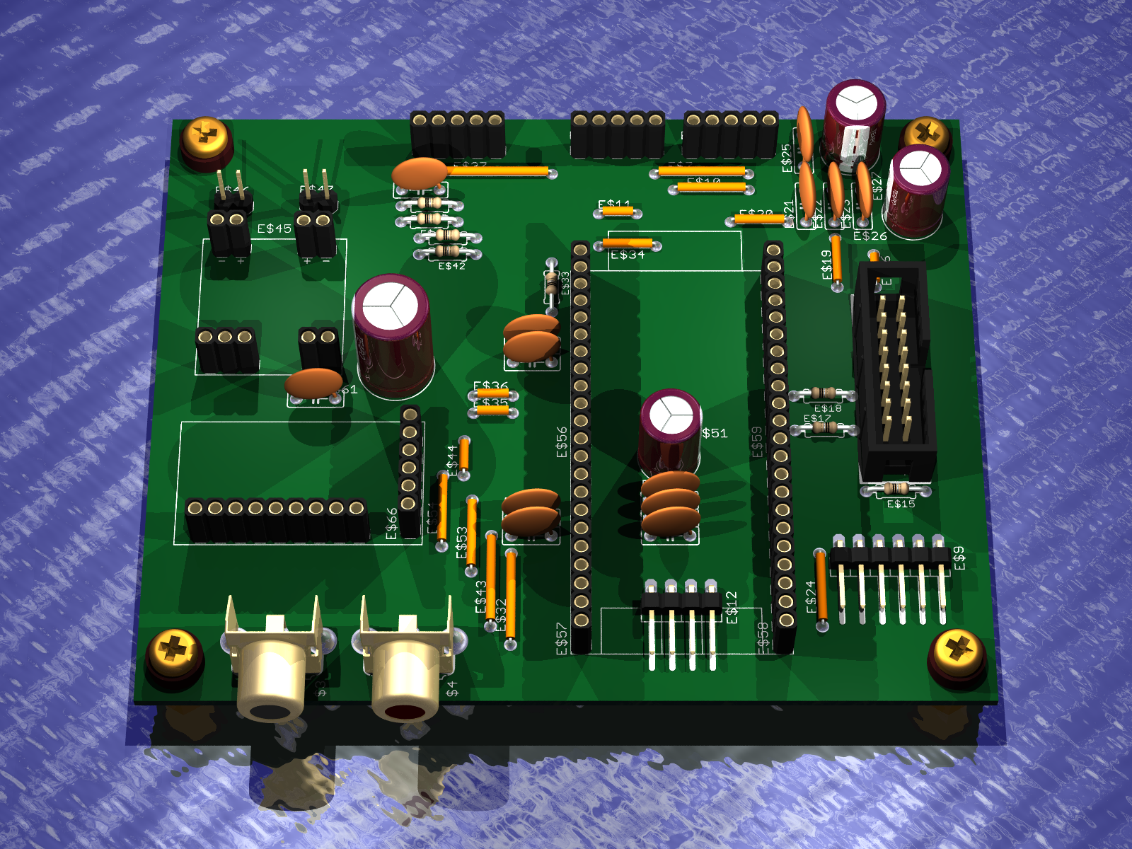

    I'll do the board, we'll see maybe there won't be too much interference (I'm not an audiophile and for me it will be important how it already plays and receives)
    The board virtually looks like this
    View of a single-sided PCB with various electronic components.
    Where the horizontal gold pins are, there will be a USB socket (4-pin) and a memory card socket (6-pin)
    For my purposes I will make a single sided PCB looking like this
    Single-sided PCB with numerous tracks and mounting holes, viewed from an angle. .
    Alternatively, you will be able to order for yourself in China with polygon
    View of a single-layer PCB with yellow mounting standoffs
    That's the end of the work for today, I'm waiting for the modules I will verify the pin spacing before etching and the correctness of the paths tomorrow.
    Greetings ...
  • PCB layout fixes for ESP32-S3 radio board
    #366 21392530
    robgold
    Posts: 726
    Help: 10
    Rate: 290
    Mate, sure on what you proposed this radio will "somehow" play but this board breaks all PCB design standards.
    I hope you won't be offended if I leave a few comments:
    - reseller capacitors are scattered all over the PCB and not at the power supply pins
    - wrong connection of capacitors on the 5V line - go ALWAYS through the capacitor then to the power supply of the circuit (amplifier and ceramic at the bottom)
    - try to keep the line length of the interfaces even, be it SPI or I2S. The 10 Ohm resistors should be as close as possible to the display connector
    - do not route the paths under the WiFi antenna. This area should be completely outlined as a "KeepOutArea" in Eagel. you will have problems catching WiFi networks
    - no filter capacitors at the 3.3V power supply output
    - components under the ESP module - they should not be there
    -electrolytic capacitors - top right corner of PCB - see point one - they do nothing when connected this way (far from the power source), you enter the power supply on the board and first connect the capacitors and only from them you get power to the ESP, DAC, OLED, Amplifier etc.
    - You do not route the paths at 90st. - risk of etching such a path
    - The 33nF capacitors should be close to the encoder connectors and preferably soldered as SMD at the encoders themselves. This is to eliminate "pins".
    As for the question about connecting the OLED, I do not know how it is on the PCB MajstraXXL. Perhaps its PCB is still under the v1 version of the radio and the display was plugged into the i2c bus.
    In the current version with the OLED SPI we plug into the SPI hardware interface. You have the schematic here: Link .

    DJCheester
    Level 28  
    Posts: 2089
    Help: 75
    Rate: 958
    Hello no offence 😀
    Comments welcome.
    Under the antenna it actually needs to be changed because I didn't think, as for other things like capacitors I'll think about it this is the first version of the PCB.
    I made radios in the past but FM and am and there actually everything mattered.
    Here the circuits in cz are only on the ESP module the rest is already digital bus speeds there are some but with e.g. I2C in Arduino it didn't matter so much here i2s, OLED etc.
    Rather, these ready-made PCM or ESP modules probably already have some filtering circuits so I wouldn't worry so much about it.
    I will remove the components from under the ESP module from under the antenna, but from the socket side I don't think they pose much of a problem.
    I'm designing the board so that it will play, a digital signal, so I wouldn't expect any significant deterioration in quality here, maybe some hums and squeaks, but I've already got used to that when listening to current Chinese products.
    It played on people's contacts without any capacitor.
    I will take a fresh look at these comments possibly tomorrow.

    - A 5.5 inch display on an SSD1322 will work. It is the same controller. Only the price is a deterrent, but if one is better for you go ahead and use it.
    - The diagram I have attached should reflect the configurations in the softy:
    // pin definition for the OLED display
    #define SPI_MOSI_OLED 39 // MOSI pin (Master Out Slave In) for the SPI OLED interface
    #define SPI_MISO_OLED 0 // MISO pin (Master In Slave Out) none for OLED display
    #define SPI_SCK_OLED 38 // SCK (Serial Clock) pin for SPI OLED interface
    #define CS_OLED 42 // CS (Chip Select) pin for OLED interface
    #define DC_OLED 40 // DC (Data/Command) pin for OLED interface
    #define RESET_OLED 41 // Reset pin for the OLED interface
    Looking at it quickly it seems to me that this is the case. We are working on GPIO port numbers not PIN numbering.

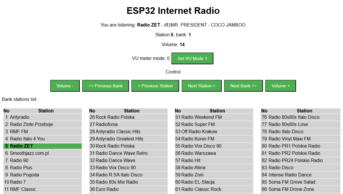

    A second addition, more apparent perhaps to all:
    In the VERY primitive version with support for 1 connection, the web server works.
    By going to the radio's IP page you can change stations, bank, volume. Such basic parameters.
    Perhaps I will convert this eventually to AsyncWeb to support this without primitive "GET" functions. For now, this is an experimental version
    ESP32 Internet Radio interface with station list and control buttons. .

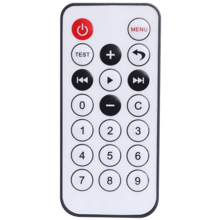

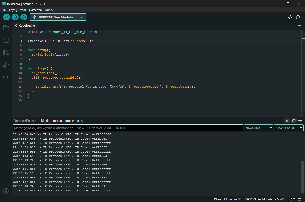

    @robgold Unfortunately I have had little time lately and a lot of work and it does not look like I will have any easier in the coming weeks, in the field of design and installation of teletechnical systems, mainly fire-fighting and related, my day often ends at 10 pm, my eyes are tired of drawing, my brain tired of programming systems and discussions on objects. Over the weekend I planned to work on making a remote control, I bought and today the IR receiver modules and a toy remote control arrived, but with nicely conceived buttons. I've even pre-prepared the code on the IRremote library, but after uploading to the ESP32 module it reboots on startup, hmmm..., I'll probably start my own so that it spits me raw data byte packets of received buttons from the remote on the serial and somehow I'll probably chunk it into a declaration in the code and assign it to execute commands.

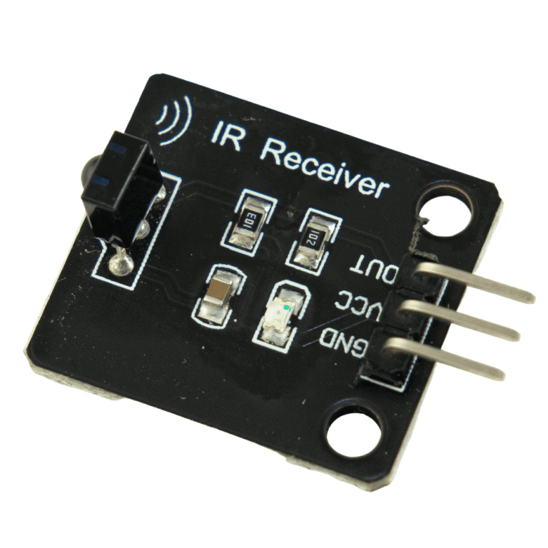

    Here's how it looks:
    Toy remote control with multiple functional buttons. .
    IR receiver module with three pins labeled GND, VCC, and OUT. .
    I have made a note at the end of the first post in our topic that a version of my v2 and your evo has been created with the corresponding links to github, so that those who are starting to read this will at least find their way around these already 13 pages.
    edit. I'm going to try based on this library, as even the example code works:
    Screenshot from Arduino IDE showing IR module code for ESP32. .

    >>21396401 @MAJSTER XXL .
    I don't envy the work situation but sometimes it happens, there's nothing we can do about it. At my place there are also such days and sometimes weeks.

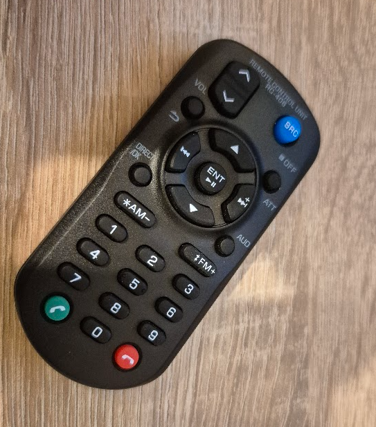

    Regarding the remote control. I once made a bathroom radio using this type of remote control on the NEC protocol. It was supposed to be built into the ceiling, so only the remote control was an option. Eventually it ended up in the mirror. It has been playing for 3 years now and zero problems. I used the library then:
    IRremote by Ken Shirriff in Arduino. I took a look at this project and the library supports ESP32.
    The remote control itself is very cool, There used to be these tiny remote controls with such a nice arrangement of buttons. Today it is possible to build a device not very different from the factory solutions.
  • Request for schematic and pin assignments
    #380 21396840
    DJCheester
    Level 28  
    Posts: 2089
    Help: 75
    Rate: 958
    Hello, there is the author of the project very cool 😀
    The project will develop again.
    Question for the author to post the actual schematic with the IR receiver connection, I am just planning a PCB, I would add that right away.
    Second question, are the pins from robgold's colleague's schematic the same, i.e. encoders, OLED, card and PCM?
    And last question to the author, are the directional buttons that have recently appeared on the schematic, will they be used?
    Regards...

    If the example that Majster gave is transferred directly to the code then you already have the PIN given:
    Freenove_ESP32_IR_Recv ir_recv(35); --< GPIO35
    @MAJSTER XXL
    By the way quite nice this library, simple but can work as a task in core 1.
    Not many standards it supports, but let's just say the NEC or base reads correctly. It's a shame that Denon is not here.

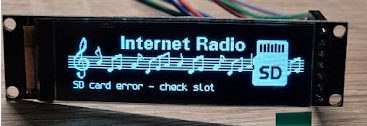

    This is exactly the PCB I have been dreaming of and is slowly being built in my PRO version for this project. I am happy to join :) .
    USB-C socket Link on PCB, SMD card reader on back panel with option to connect module on front panel. To this an ESP32 module Link with input for an external antenna, connectors for everything JST raster 2.54 and an aluminium case. The enclosure I have chosen is a Hammond 1455R1601BK. It's big but is meant to rest on top of another audio 'block'. Here you can probably choose something much smaller. Of course, this forced a 2.08 inch display (supported from the Evo2 version onwards). Encoders 30 imp instead of 20. The PCB for the 1-way encoders is already there, although I don't like this component from the library and will improve it a bit.
    Display showing SD card error message on a radio device. .
    Front panel of the enclosure with an LCD display showing the text Radio Italo! and Abra kadabra. .
    PCB layout for an encoder on a black background. .
    Electrical schematic with resistor and capacitor connections. .
    Of course, this does not exclude work on a Standard version where, however, it is easier to put modules together like lego blocks for many and we want the project to be widely available.

    I had a look at this decoder for IR yesterday. I have the impression that it feeds the bits as they fly i.e. LSB-MSB. I did the conversion the way they often give the pilot codes on the websites (MSB-LSB). In other words conversion from big endian to little endian. I used to do a Kenwood - Joy Renault radio converter and I kept this order of bits. Code below. You might use. A version with the shuffle pinned to the core. Receiver pinned to GPIO15 instead of GPIO35 for testing.
    By the way, I dug up the remote control from that project, based on which I read the codes. It turns out that it works in NEC standard, is cheap (~PLN15-20 ALi) and has rubber buttons. So, if you like such more "pilot-like" remotes, look for the RC-406
    Remote control with numeric and control buttons on a wooden surface
    #include "Freenove_IR_Lib_for_ESP32.h"
    uint32_t data;
    uint8_t command;
    uint8_t address;
    uint32_t reverse_bits(uint32_t inval, int bits)

  • IR receiver GPIO needs clarification

    Unfortunately, attempts to run operation from the IR remote control are so far unsuccessful. Tasks or functions that are supposed to capture the packet and process it into a "readable" form do not manage. The problems are as follows:
    - either the start of the task blocks further code execution
    - or the ESP32 module resets
    - or the audio is only audible when receiving data from the IR,
    I also tried to do it in an interrupt, the effects are similar, you can see that after receiving a packet and processing it, it does not release the task or exit any function.
    All other libraries, or more precisely the examples from them, cause ESP32 resets.
    Only this Freenove_IR_Lib_for_ESP32.h runs with my v2 radio code, but it doesn't work as expected. I'll get back to the topic tomorrow or tonight. Maybe I'll do a walk-through of the whole frame on interrupts to put it together. To figure it out you need to put together the bytes from the timing frames, and for that you need to be familiar with the standard of at least the NEC.
    @robgold maybe you can figure something out faster here?
