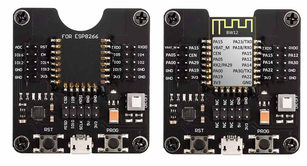

    OK. I have a few now for various modules and this adaptor

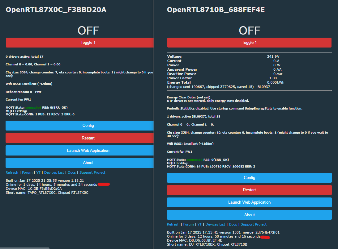

  • #158 21398104
    >>21397525

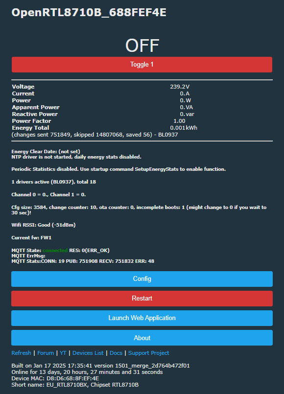

    soldered my EU RTL8710BX/BL0937 plug back up for longevity testing.
    1501_merge_2d764b472f01
    Screenshot of power measurements for EU_RTL8710BX device.
  • #159 21400797
    insmod wrote:
    But, some stability issue remains. I noticed that my plug reboots every several days.
    With MQTT or without?
  • #160 21400836
    insmod
    >>21400797 With mqtt, my rtl8711am module worked for 6 days without it, and some time after i configured it, it rebooted.
    lwip was copied from rtl8720c, so the same issue might be in it.
    RTL8711AM current uptime: 1d, RTL8710B: 1d 9h
    But, if i remember correctly, on RTL_B it rebooted without mqtt too.

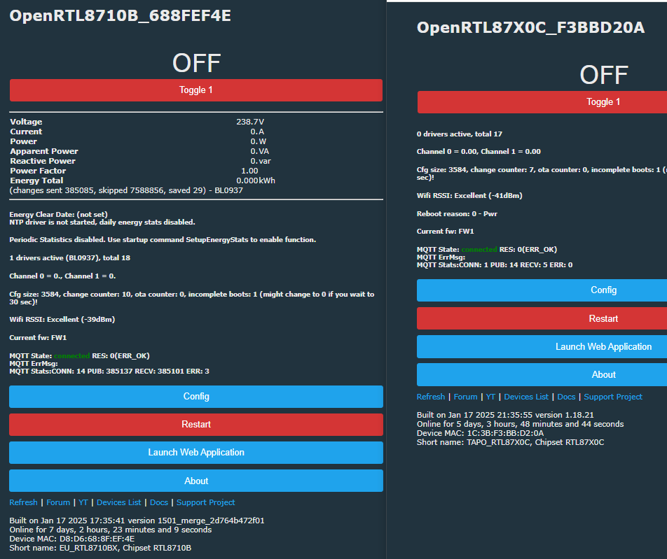

  • #165 21404013
    >>21398104
    OK so far with MQTT
    Screenshot of two control panels for OpenRTL devices showing their status and configuration.

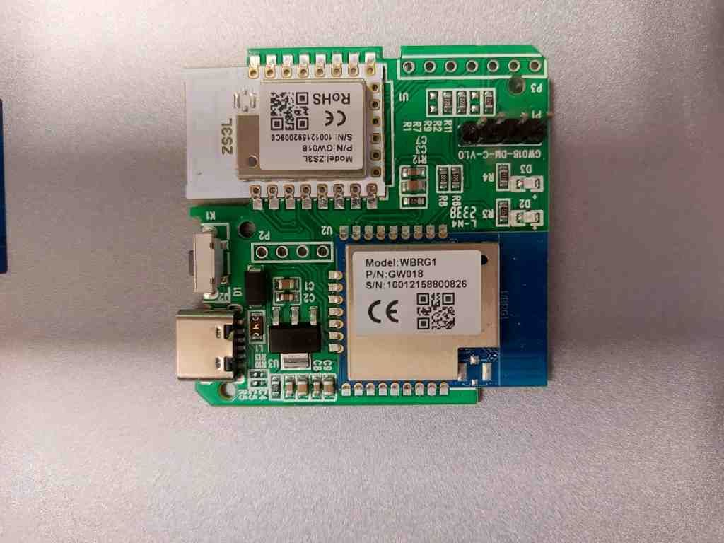

    >>21402126

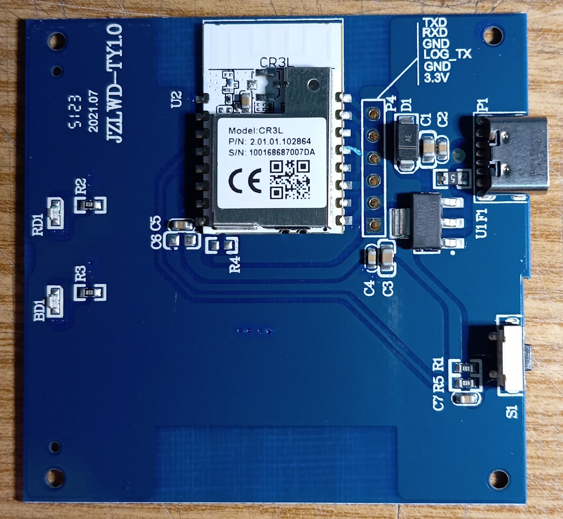

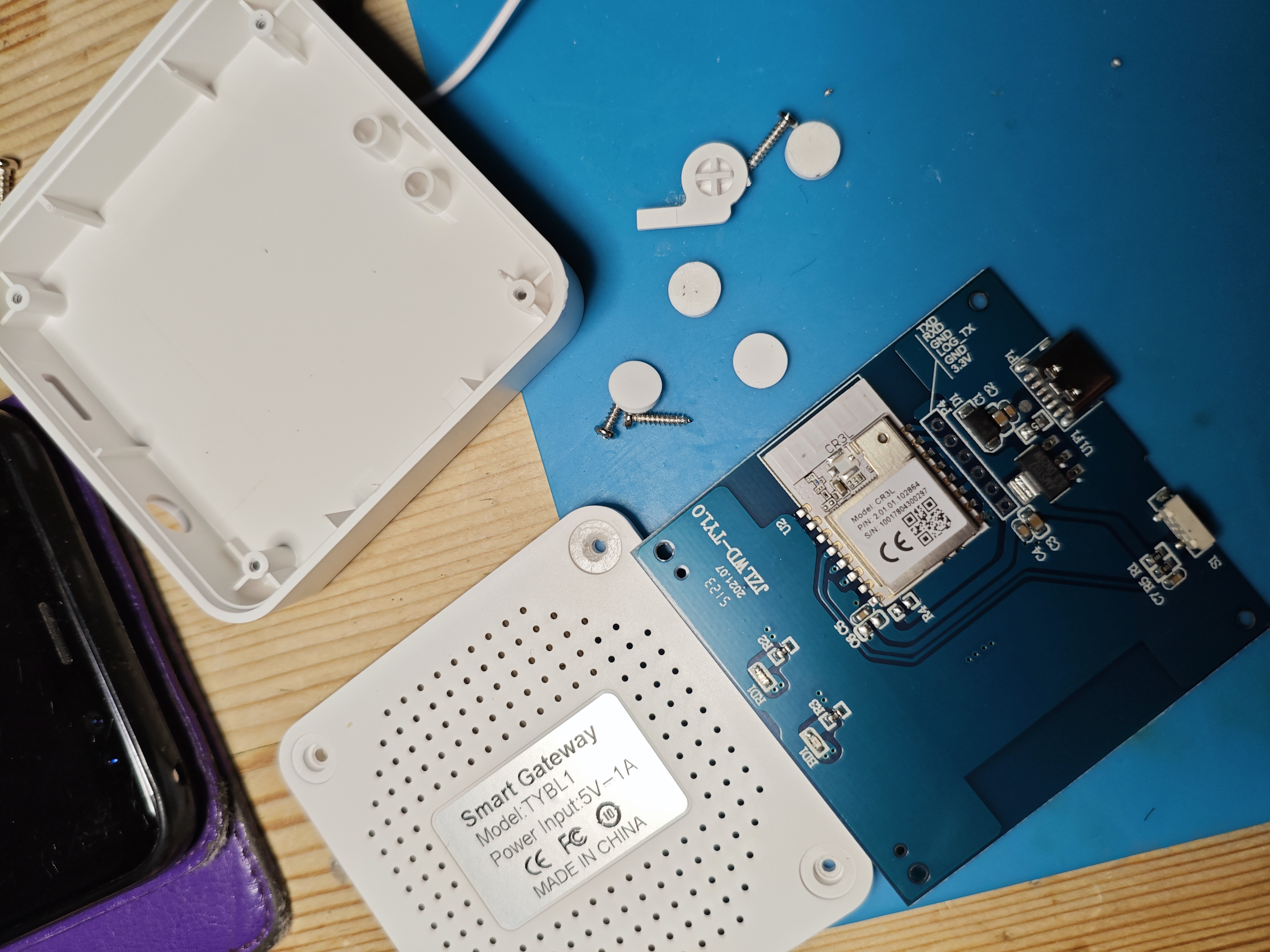

    success
    Open enclosures and components of a Smart Gateway with a PCB.
    the PCB and case would make a nice simple USB-C powered test box for other modules perhaps

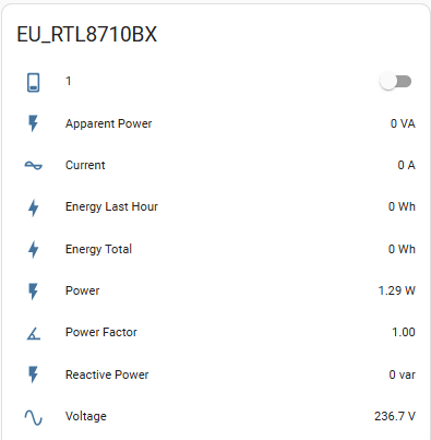

  • #177 21419411
    >>21408968
    my B is still going, no powersave at all though.
    User interface of the OpenRTL8710B energy monitoring system.

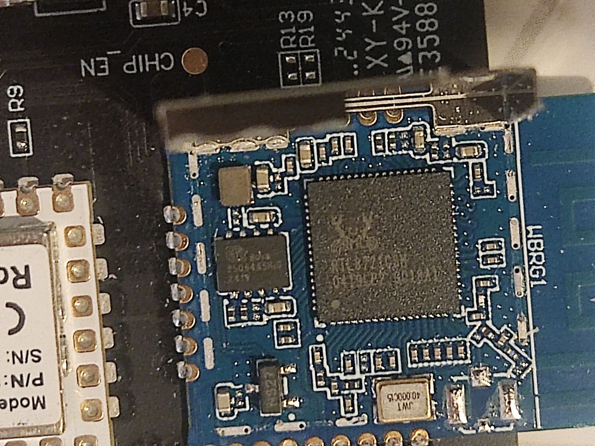

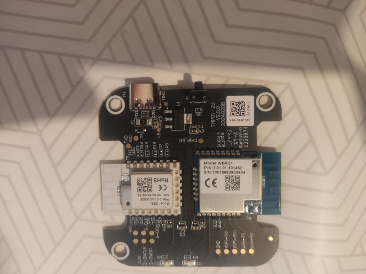

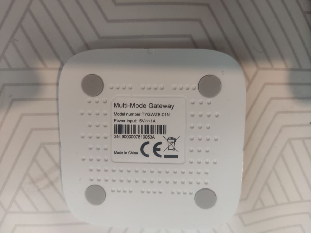

    insmod
    My WBRG1 gateway has arrived.
    Its name is TYGWZB-01N
    Zigbee module is ZS3L (EFR32MG21A020F768IM32-B)
    I don't know how to take a backup without damaging the module, flash chip is too small for SOIC8 clip.
    And if i removed it with hot air, i risk accidentally moving nearby components when soldering it back.
    Pics:
    Spoiler:
    Photo of the back of a multi-mode gateway with a model label. Electronic board with Zigbee module and WBRG1 components. Close-up of an electronic module with visible components on a blue PCB.
