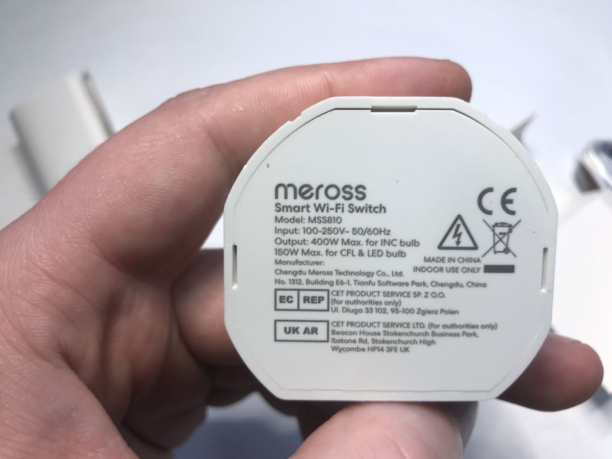

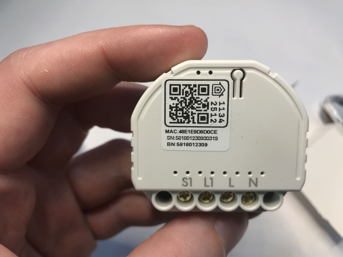

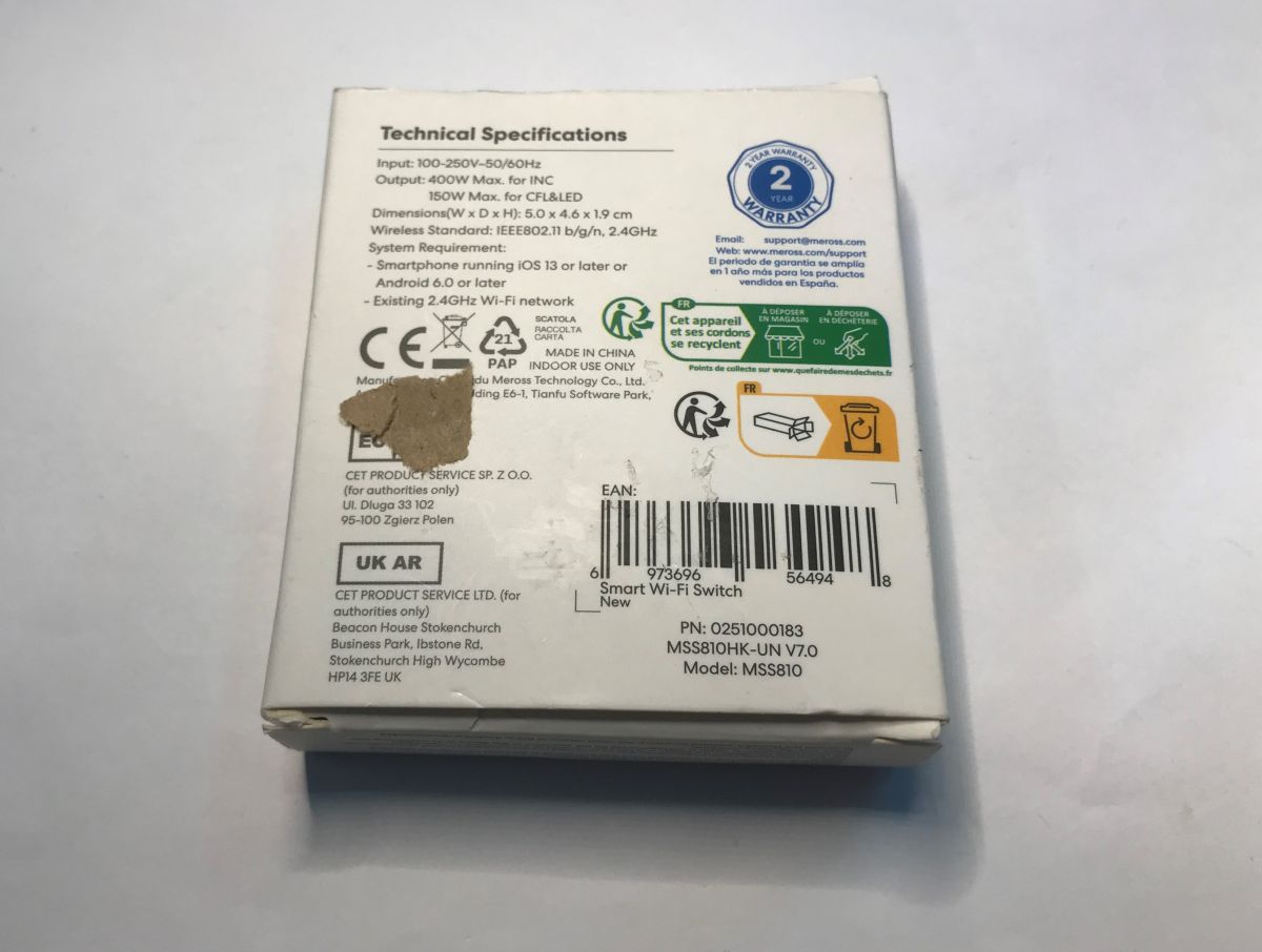

    RTL8710CM can be found in various IoT devices, but in this case we'll present a simple smart switch compatible with the Meross app, model MSS810HK-UN V7.0. It can control a single light up to 150 W (for CFL and LED) or up to 400 W (for incandescent lights).
    Meross MSS810 smart Wi-Fi switch box with Apple Home logoBack of Meross MSS810HK-UN switch box showing technical specificationsSide of a smart Wi-Fi switch box with product descriptions in multiple languages

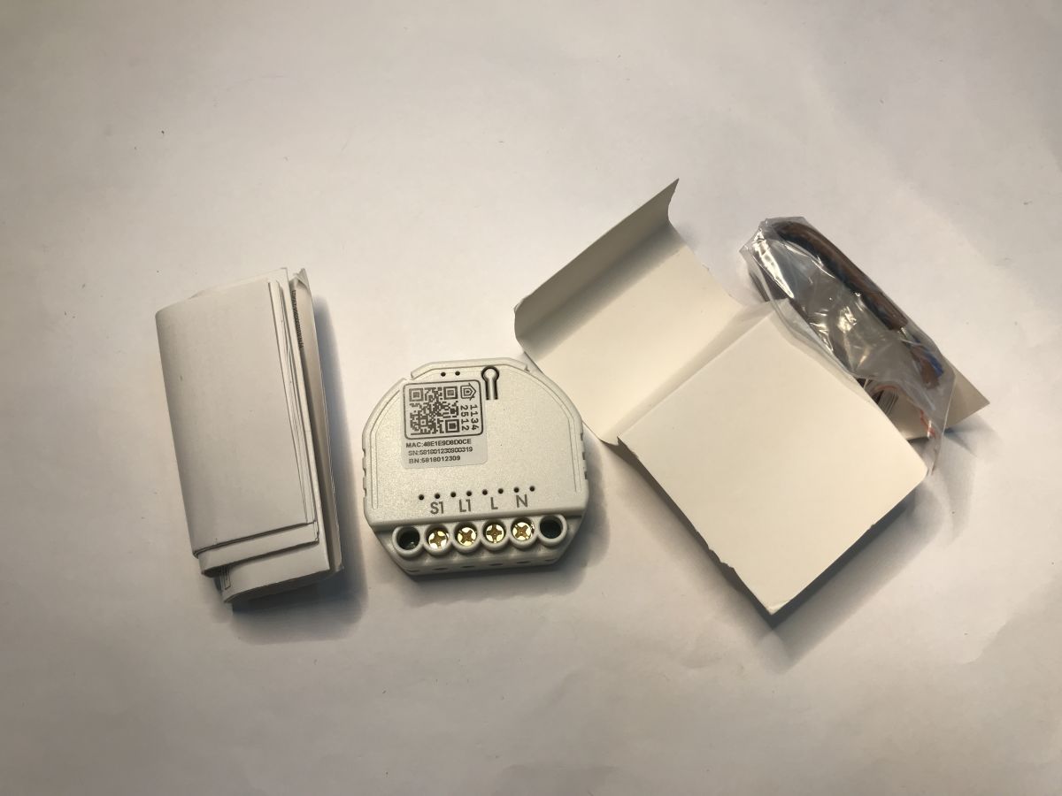

    Let's unbox it. The device comes with a set of short wires, which are useful for wiring it behind a classic, non-smart switch. The module itself has manufacturer and app info on the case, so it's not yet another no-name gadget.
    Meross MSS810 smart relay with manual and wires on a white backgroundMeross MSS810HK-UN module with QR code and terminals S1, L1, L, N visibleClose-up of the Meross MSS810 smart switch back label.

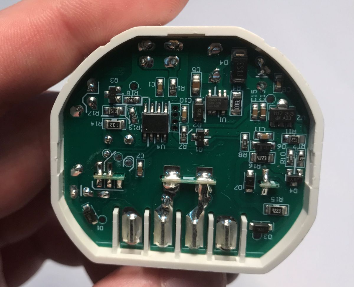

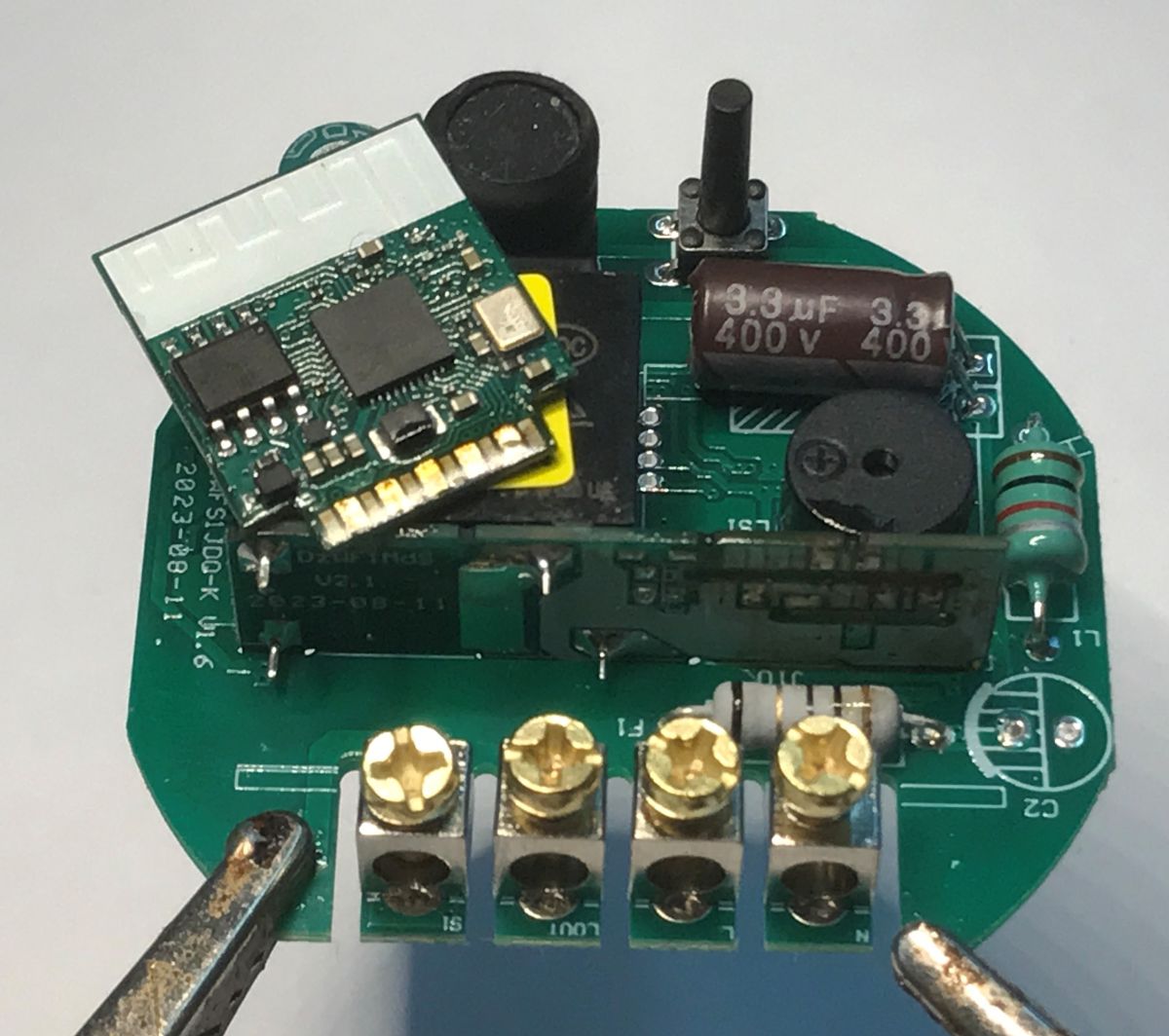

    MSS810 teardown
    Let's look inside. It's easy to remove the top cover with a flat screwdriver.

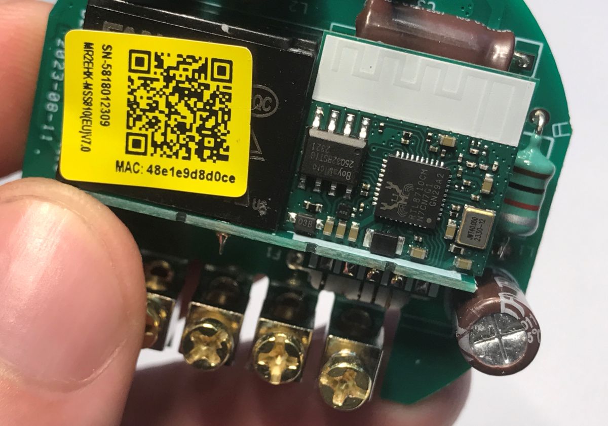

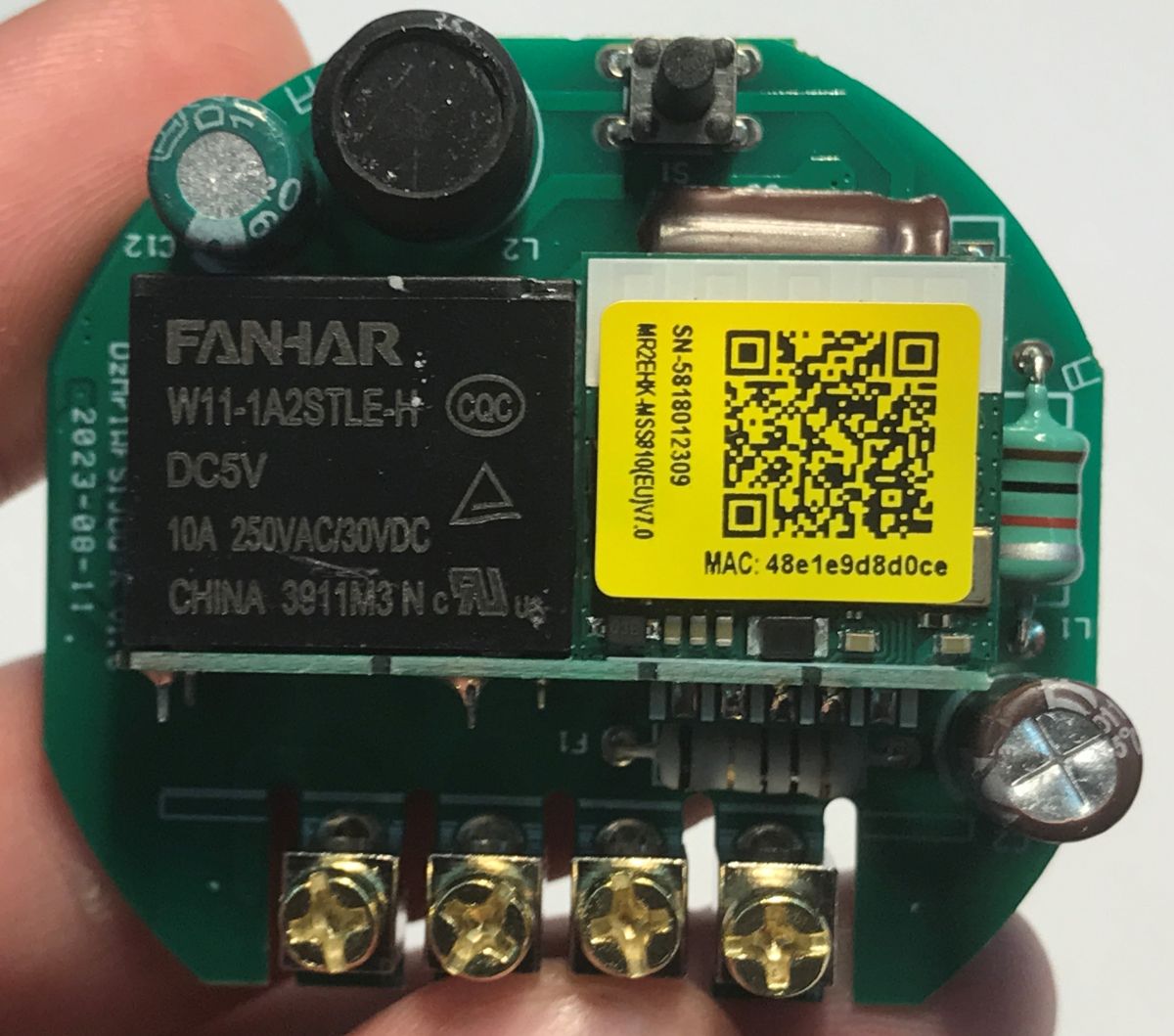

    Internal view of Meross MSS810 switch with visible electronic componentsClose-up of a circuit board with surface-mounted electronic componentsCircuit board with FANHAR relay and yellow label with QR code
    The device is powered by BP2525 step down power supply circuit, it generates 5V from mains. There is also AMS1117-3.3V visible, which provides stable 3.3V for the WiFi module. I didn't identify U4 chip, does anyone know what's its purpose?
    Close-up of electronic components on green PCB with FANHAR relayCircuit board with microcontroller, QR code label, and screw terminal connectorsClose-up of an electronic module with RTL8710CM chip and SMD components

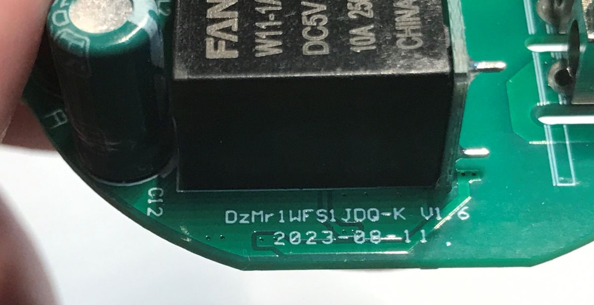

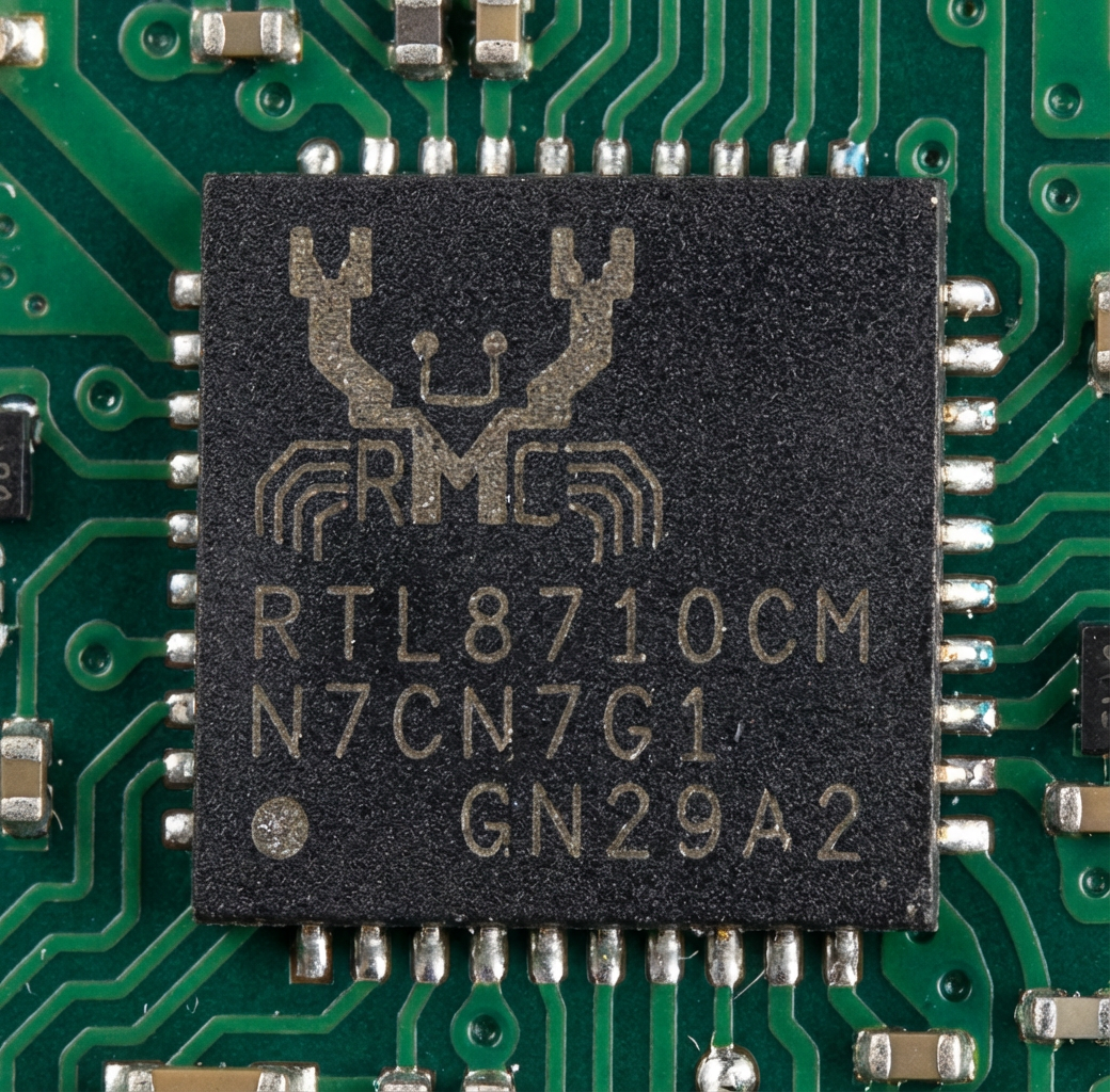

    Device board is marked as DzMrWFS1JDQ-K V1.6 2023-08-11, and the WiFi module inside is using RTL8710CM. It also has an onboard flash memory chip, just like some ESP modules do. That's where firmware is stored.

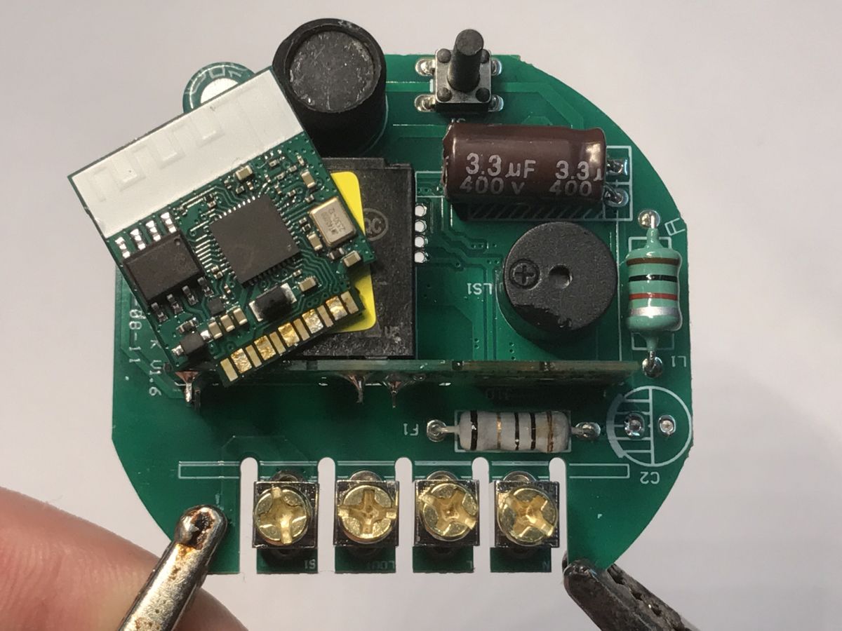

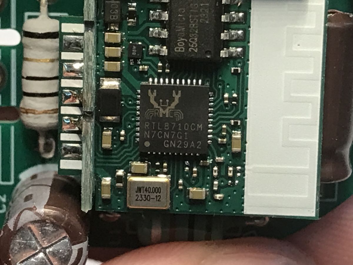

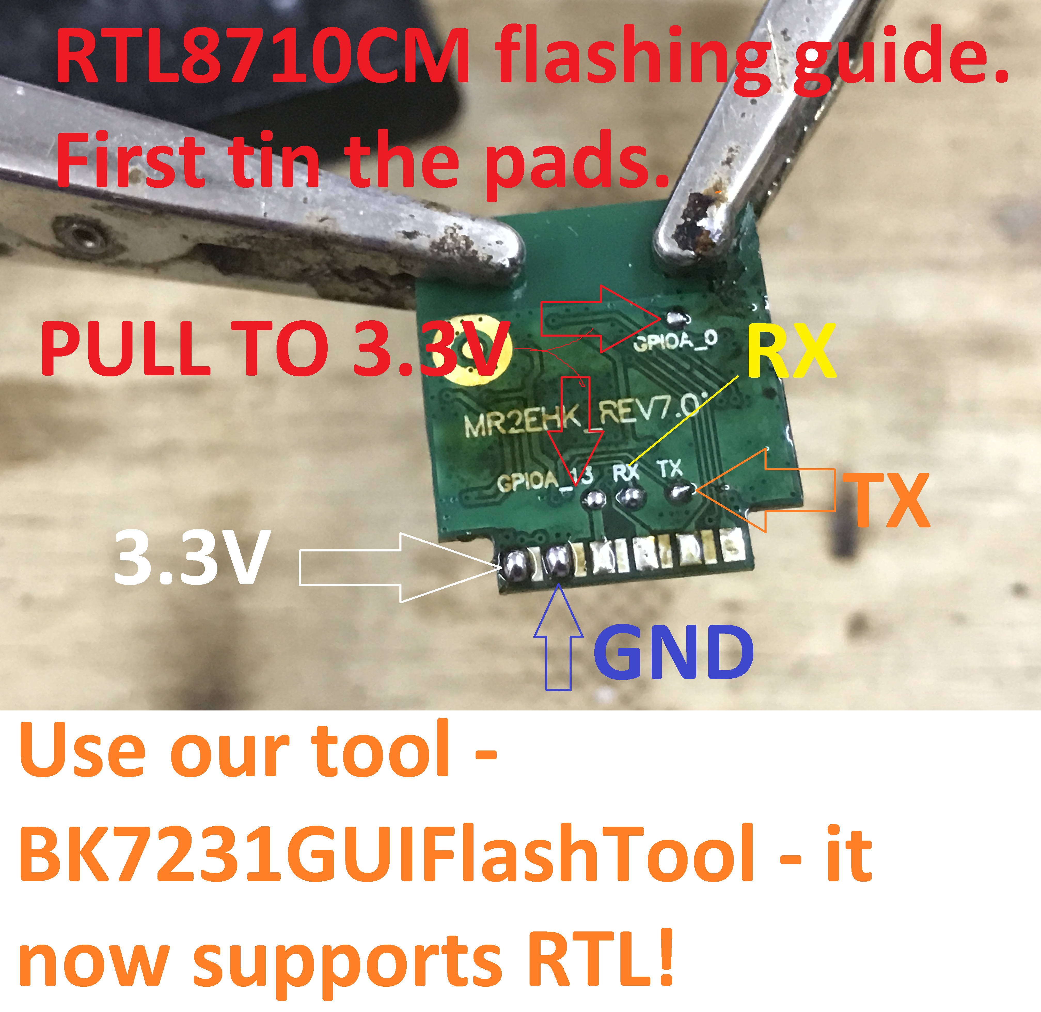

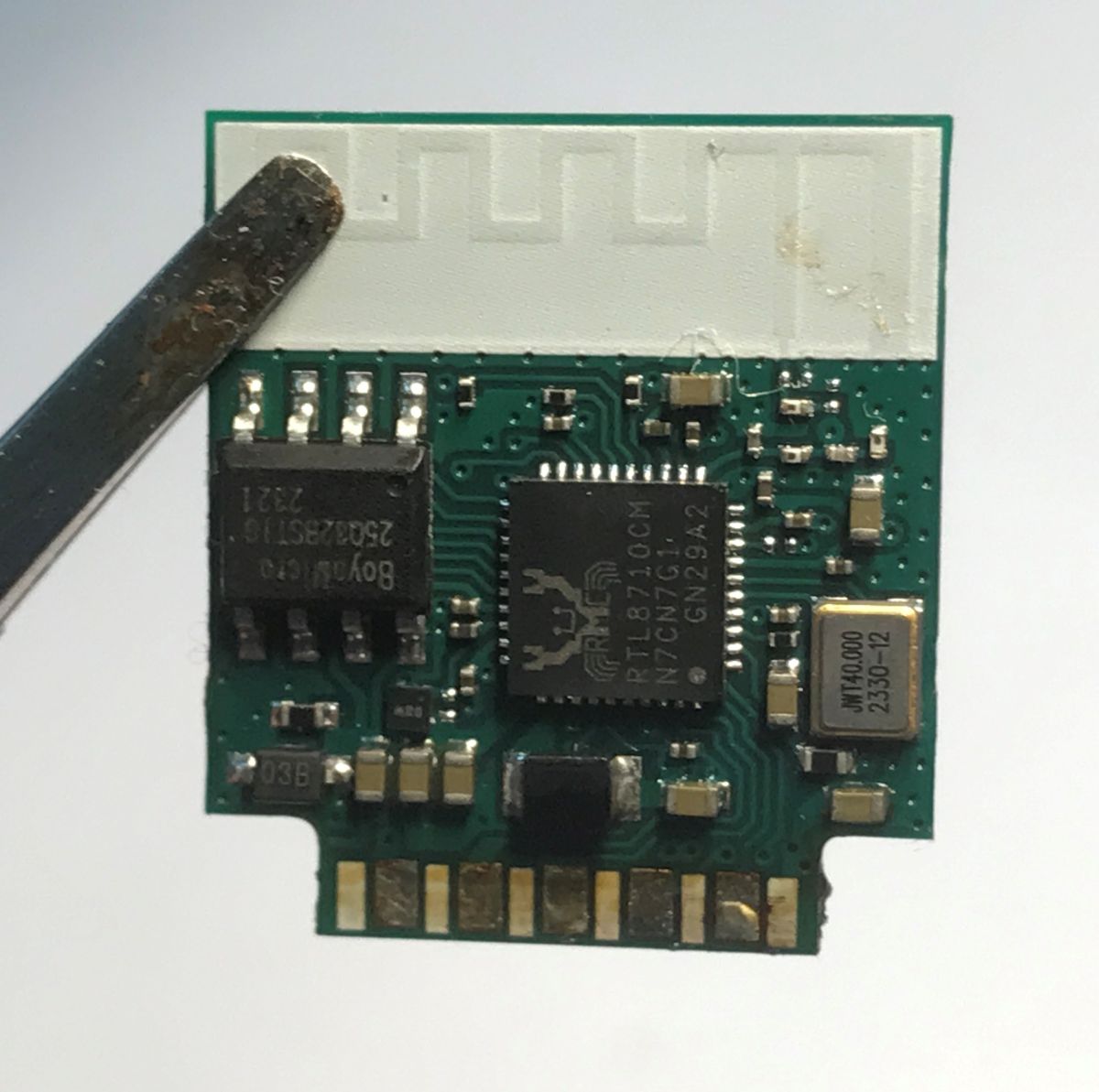

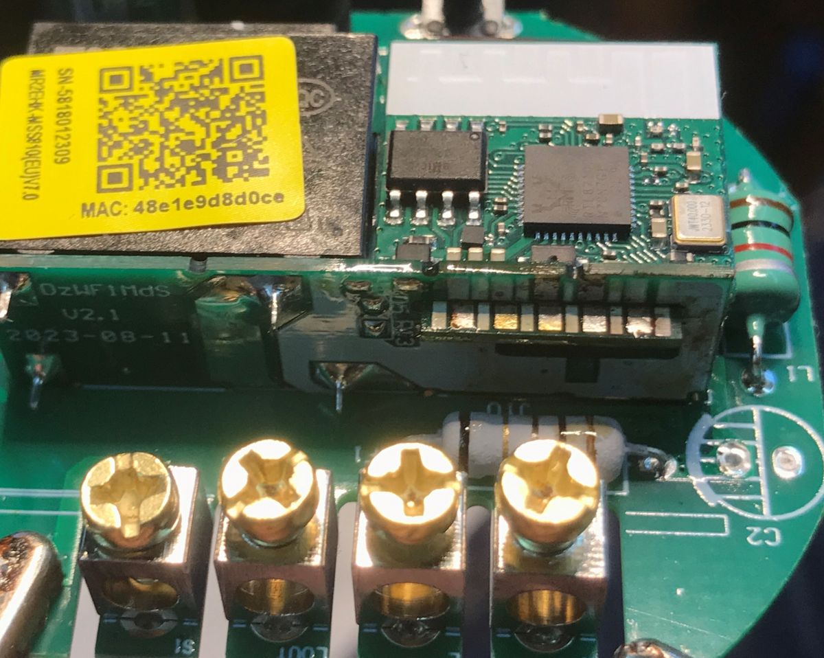

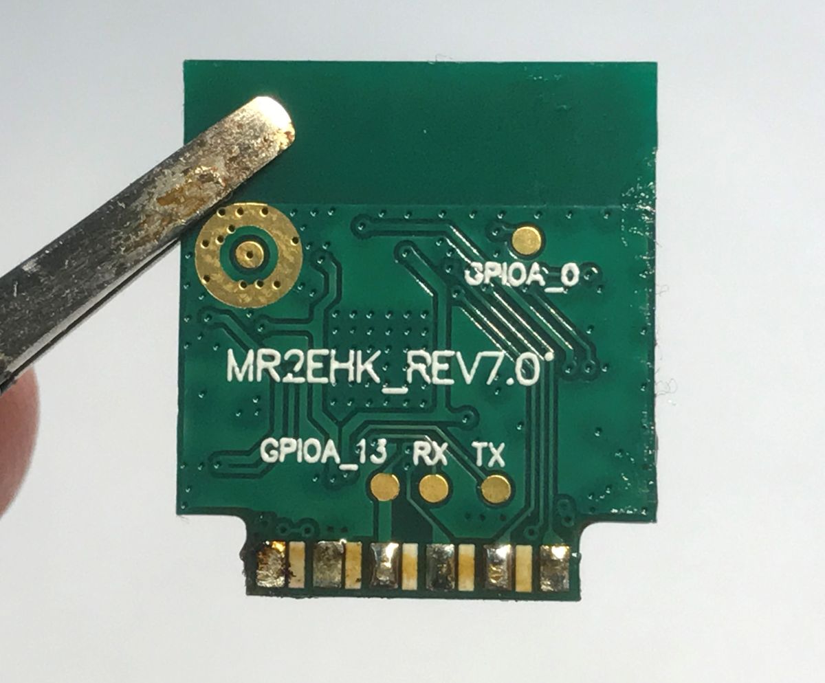

    Desoldering WiFi module
    This WiFi module has programming pads on the back, so it's not accessible without desoldering. I had to use some flux and copper wire to clean the pads and remove the module.
    Wi-Fi module mounted on a PCB with chip components and screw terminalsClose-up of a PCB with electronic components and screw terminal connectorsPCB with electronic components including Wi-Fi module and 3.3μF 400V capacitor
    WiFi module is marked as MR2EHK_REV7.0. The four pads on the back are marked as GPIOA_0, GPIOA_13, RX and TX. The bottom pads are not marked.
    Green PCB labeled MR2EHK_REV7.0, GPIOA_13, RX, TX, held by metal tweezersElectronic module with RTL8710 chip and PCB antenna held by tweezers

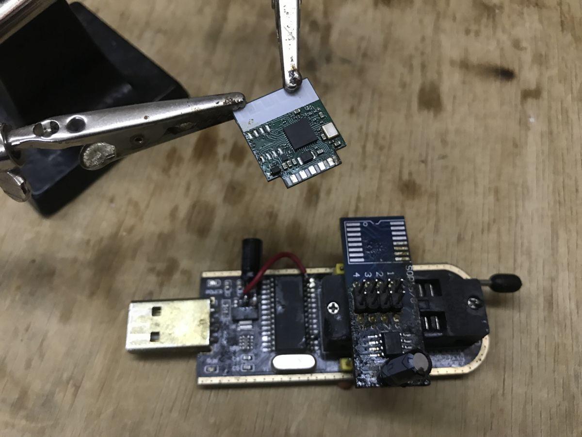

    Flash backup method - CH341
    This step is not necessary, as you can back it up via UART, but I will show it here just for reference. BoyaMicro 25Q32BSTIG on the board is a classic flash chip with an SPI interface, it can be read with CH341 in, for example, NeoProgrammer:
    RTL8710CM WiFi module in a holder and CH341 programmer on workbench
    I didn't try flashing firmware that way, as we have an UART solution for that.

    First of all, you need USB-to-UART converter, like CH340, and you need to set it in 3.3V mode by setting a jumper. You also need a reliable 3.3V power supply, I am using AMS1117-3.3V for that. 3.3V from the USB-to-UART converter may not be enough.
    You will also need to pull extra pins high (connect to vdd - 3.3V) to enable bootloader:
    RTL8710CM module startup configuration table with pin settings

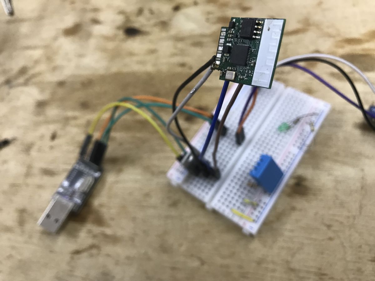

    Now, you need to connect wires to the WiFi module. Tin the pads with some solder, don't forget the flux.
    This is how the tinned module looks like:
    MR2EHK_REV7.0 WiFi module with labeled pins for RX, TX, GND, 3.3V, and GPIO.

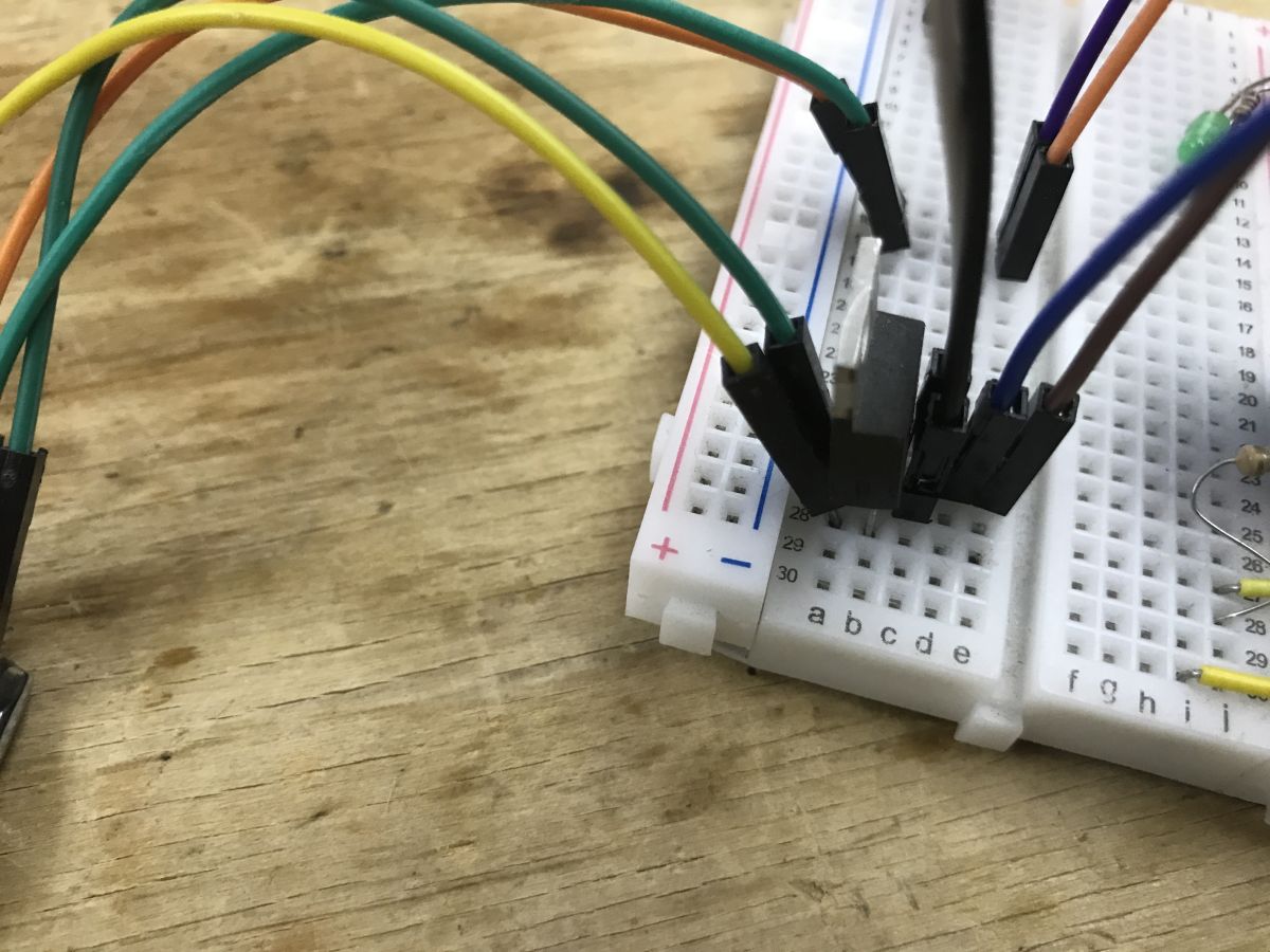

    And here is my full setup:
    RTL8710CM module connected to a breadboard via USB-UART adapter
    This is the LDO I use (TC1264-3.3V), it can be any LDO for 3.3V. It converts 5V to 3.3V for WiFi module:
    Breadboard with jumper wires connected for WiFi module programming

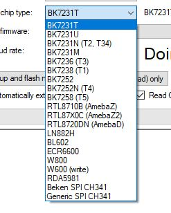

    Select the matching family in our flasher - Ameba Z2:
    Dropdown list showing selectable chip types in a firmware flashing tool

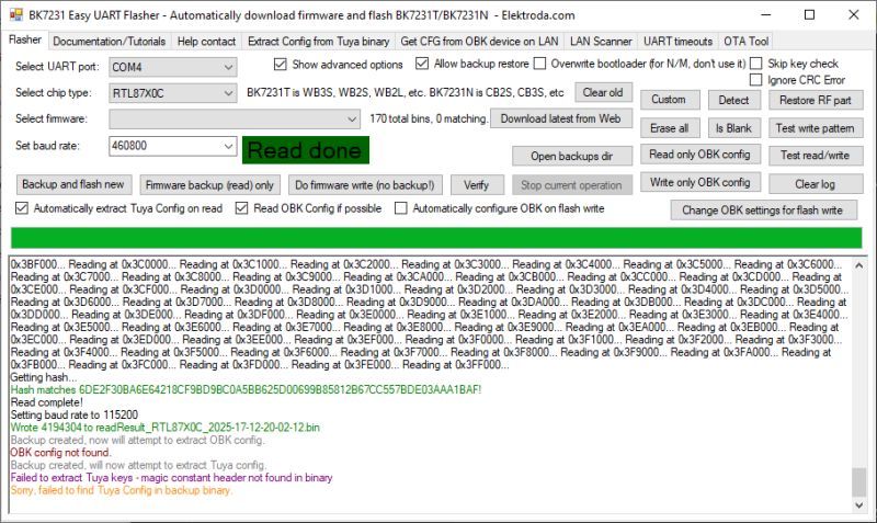

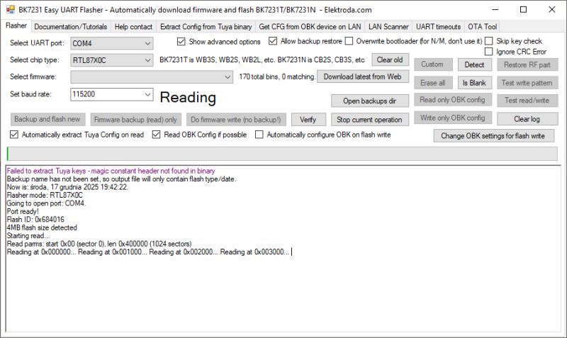

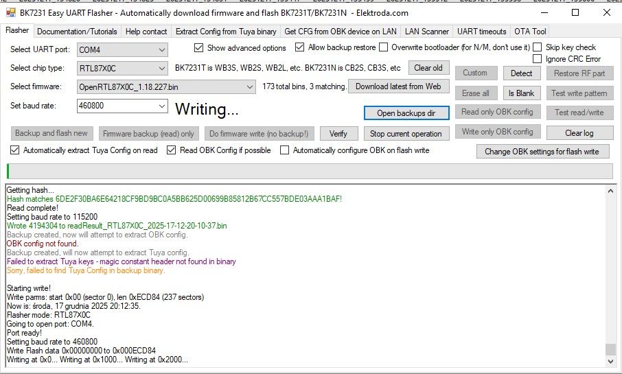

    First, do a flash backup:
    Screenshot of BK7231 Easy UART Flasher software reading flash memory contents
    Screenshot of BK7231 Easy UART Flasher software showing Read done message

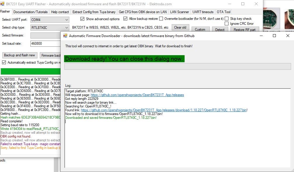

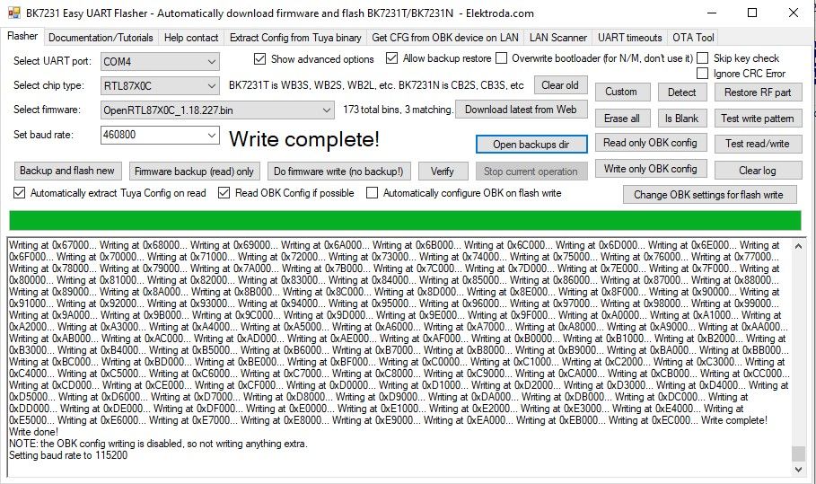

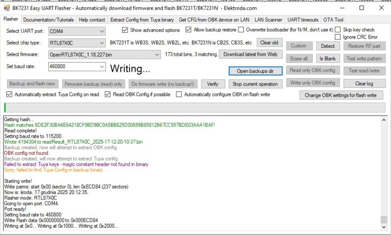

    Then, use our flasher to download new firmware:
    Screenshot of BK7231 Easy UART Flasher with download complete message for firmware
    You can also manually get it in Releases tab, here:
    Finally, flash the new binary:
    Screenshot of BK7231 Easy UART Flasher tool during firmware writing process.
    Screenshot of BK7231 Easy UART Flasher after successful firmware write process

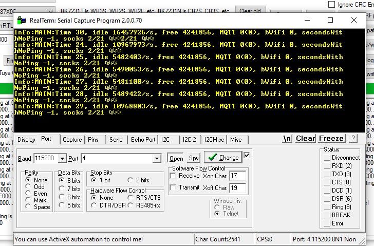

    Flashing is now done. You can disconnect extra boot GPIO pins from 3.3V and power cycle the module. Then you should be able to see OBK logs at 115200 at the same UART port you used for flashing:

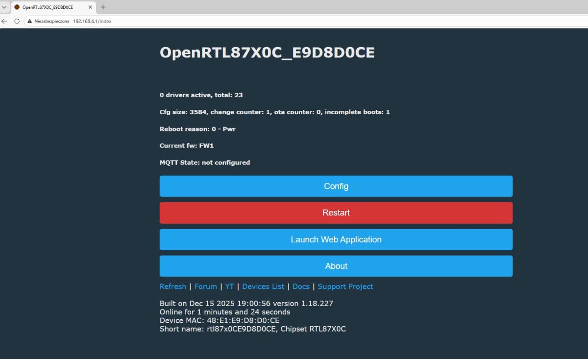

    Initial setup

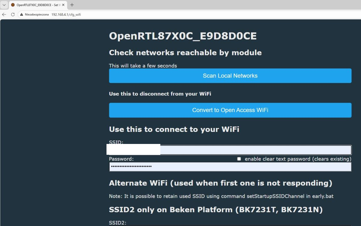

    Just like with every other OBK device. Connect to configuration AP:
    Wi-Fi network list showing OpenRTL87X0C_E9D8D0CE SSID
    Open the page at 192.168.4.1, configure the WiFi:
    Web interface of OpenRTL87X0C showing device info and config buttons
    WiFi configuration interface for OpenRTL87X0C module shown in a browser

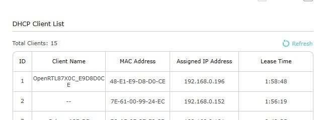

    Device should join your network:
    DHCP client list showing “OpenRTL87X0C_E9D8D0CE” with assigned IP address.

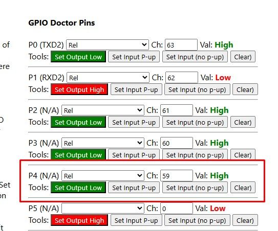

    Then you can use GPIO Doctor to figure out GPIO roles:
    https://www.elektroda.com/rtvforum/topic3976371.html
    GPIODoctor can find a relay pin quickly. Just listen and toggle each pin, you'll hear the relay click:
    Screenshot of GPIO Doctor showing pin mappings and their logical states
    For button, set pin input roles and press button and see what changes:
    Screenshot of GPIO configuration interface showing P18 set as digital input
    OBK template:
