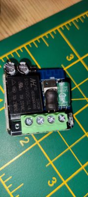

  • I grabbed this from Ali to have a play. https://www.aliexpress.com/item/1005006155824101.html
    Image of an AliExpress product page showing the Matter1CH switch module.
    It comes with a CB3S module which is BK7231N.
    The VCC was just about accessible with a pin, so no soldering.
    Short boot log:

    Assuming the CB3S module was standard hardware I used BKflasher to dump the factory firmware, attached. I also took a small risk and flashed OBK to the module to see if it would boot up with an AP, as expected with any non-Matter BK device, but sadly not. I was able to flash it back to factory though and it worked again.
    Will OBK not working be because of some other partition differences? The RF partition? Should I try "Restore RF part" in the easy flasher?
    Will OBK support Matter one day? Does it need to? I know there's a lot of other development, so maybe low priority.
    Questions!

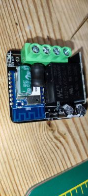

    Anyway, here are some more pics
    Matter 1CH switch module next to an open casing with a visible electronic board on a green measurement mat. Electronic module with visible components labeled RSH-2L-TDQ001-WiFi-V1.0 Close-up of a PCB with various electronic components, including a KP16051SF chip. Smart module with casing and box. CB3S module with electronic components on a green mat. Electronic module with a green terminal block and a black relay. Relay module on a wooden surface. CB3S electronic module mounted on a board with other components. Confirmation of Uascent smart plug connection with Alexa account.

    That's a very interesting and informative post. I haven't seen a matter BK7231 yet.
    Are you really sure that's BK7231N inside and not a BK7231M?
    Since you're saying it's not booting, did you try to catch the bootlog of this device after flashing OBK?
    Another experiment I would suggest is this:
    1. get any original tuya 2MB dump from supportable BK7231N device
    2. flash it to your device
    3. maybe check if you can pair it with tuya as the other device?
    4. flash OBK on top of that
    5. check again if it works or not?
    You can get any dump here:
    https://github.com/openshwprojects/FlashDumps/tree/main/IoT/BK7231N

    interesting. I had not heard of BK7231M. After spending ages flashing various CB3S and other BK7231N firmware, and even the BK7231M firmware from https://www.elektroda.com/rtvforum/topic4017870.html#20837165
    I did not get any output from TX uart log with any combination, not even OBK :( At most I got was 2 squares with a question mark in them. This didnt change with baud rates or retries.
    Finally, I tried to heat up the shield over the chip to see if I could get the whole thing to a temperature where the solder holding it in place melted. I do not have a hot air gun. I gave up and used a blade to slice into the solder. I got it off. It's a BL2028N!
    Close-up of a BL2028N integrated circuit on a blue printed circuit board. Electronic circuit board with components on a wooden surface.
    So I'm no further forward getting a non-factory firmware working but I'll keep playing. Flashing from another BK7231N factory firmware to OBK does not seem to make a difference. No sign of the device in the Tuya/Cozylife/Smart Life apps with any Tuya firmwares.
  • #4 20940857
    That's very strange, BL2028N is known to work with OpenBeken. Have you tried flashing whole 2MB of dump from a working OBK device or a flashable Tuya device?
    I would say that it has to work, because otherwise, it would mean that there is some kind of extra strange difference between your BL2028N and the old BL2028N's which worked with OBK, and that would be very.... strange.

    added SPI dump of a second 1CH white UAM028 BK7231N/BL2028N Matter CB3S to first post for the collection - CB3S_uHome_Matter_1CH_White_UAM028_SPI.bin
    Circuit board connected to a programmer with wires on a desk.

    Just thought you might’ve figured how to connect the 4gang version to the switch (if you bought one) because I can’t get it to work yet.
    It’s actually the same as this one by avatto with the same pinout except relay 2 is assigned to p28 instead of rx1.
    And it does have 5 cables including COM while mine only has 4
    WSM16-4 WiFi switch module on a black table background.
    I swapped the matter cbu with spare cbu that i have and i got it flashed. I had to add some more solder to each sides because it just wasn’t budging with hot air & flux
