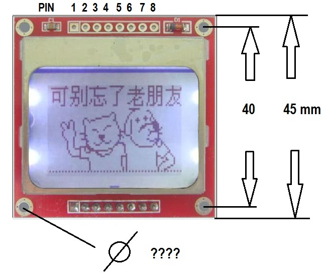

    And how will it be in the case of the first software?
    In the config file for it there is:
    11110010 uProg settings are saved in this byte
    ||||||| + ---- bit0 - file type (1 for hex, 0 for bin)
    |||||| + ----- bit1 - status bar (1 for enabled-slower programming, 0 for disabled-normal programming)
    ||||| + ------ bit2 - not original lcd (1 for chinese not-PCD8554, 0 for original PCD8544 driver lcd)
    |||| + ------- bit3 - slow SPI clock for LCD (1 for 2MHz, 0 for 4MHz)
    ||| + -------- bit4 - speed-up programmer clock (1 for max speed up to 16MHz, 0 for fabric 8MHz)
    || + --------- bit5 - show anims (1 to play animations after failed programming)
    | + ---------- bit6 - auto erase (1 to erase the chip before programming flash memory)
    + ----------- bit7 - auto verify (1 to autoverify flash or eeprom after flashing)
    bit2 and bit3 but after switching it does not give anything.

    Again ? Heh, I'm 99.9% sure it's the display's fault. It's just that this version is handled some other way. The first soft gives an image on the display, the next one does not, despite the settings in the config. Also, a program that could be uploaded to uProg would be useful to test pixel by pixel. It is possible that the handling speed is too high. This can not be set in the first software, and in the next ones, but what if NOTHING TO SEE (as if it did not touch the pins - but the matter is clear, as I will upload the first soft again, I have a picture like in the photos).

    Is the SD card read at all? Because if setting this bit does not change anything, I suspect that it is not read at all. You can check it by entering a folder to see if there are any files. Also remember that each version of the software has different files that must be placed on the card. The 3rd version of the software flashes when you start with the diode that was added on the 1.3 board. I do not remember what tile you have, but you can solder it. When it comes to LCDs with glass pads, everyone has them, and it works for everyone.
  • #276 10544841
    piotrva
    Posts: 6409
    Help: 625
    Rate: 735
    Exactly, it is definitely "Chinese" (in my case, the first soft looked the same), and in subsequent versions it was necessary to set the appropriate contrast. If it was the display's fault, you would NEVER see ANYTHING. Another reason is the lack of initialization and reading of the SD card - I had the same problem with the LCD when I had the wrong capacitor to boot the SD card.

    mlassota wrote:
    However, I would have suspected the contrast setting - see if the FF will not have the entire black display ... I tested it on several displays (5 pcs / 2 types, i.e. with metal and glass pads) If anything changed - it was the contrast setting ...
    Regards
    How to set it up in software no.1?
    PCB version 1.0, i.e. the first one.
    When I remove the card, there is Error, i.e. uProg responds well to the lack of a card.
    And you are 99% right, something wrong with the card because I put two softs into the catalog and ... dir empty :cry:
    Wait, I put it in the menu to read HEX and ... it works. I mean, you can see these two files.
    I wonder that the inscription "v1.0 BETA" is in the right place and the graphics are shifted. In this startup picture.

    In both photos you have posted, you can clearly see that you have the display described in this link: Link
    (the last 11 pixels across the width of the display are random)
    Apart from this area, after removing the card I have the same image on the display as in your first photo, i.e. shifted menu items.
    For me, the conclusions are as follows:
    The first picture shows a working programmer with a misconfigured display type (7-bit) or a badly (un-) read config.ini configuration file.
    you could have taken the second photo while booting or the processor "freezes"
    I suggest you upload the latest soft, configure the display correctly, and if that doesn't help, look at the card or read it.
    The contrast is approximately correct, i.e. you can see the subtitles and not a blank or black screen, so there is nothing to do here and after changing the software, set it as in the first version.

    I unfolded it, I corrected February and after folding it I have 1-3 lines less in the display (the situation means it has worsened). I followed the directions above and ... I had to go back to the first software. I put the second tflash card (without the SDHC inscription - uProg does not support these) with a capacity of 2GB, I put files adequate to the atmata software, but it did not help me.
    Adam-K shed some light on the matter and somehow does not fill me with optimism.
    Not the card and not the installation is to blame, but only the display. If I put it in Nokia, 99.9% would be no problem with it.
    The uProg card reads because it sees the inserted files. And since the inscriptions and graphics are in the wrong places ... it's difficult. Shit happens.

    To make sure the config.ini file is read correctly there, you can go to options, change some settings, turn off and on, and check if the settings are loaded according to what you changed.
    adam-k wrote:
    In both photos you have posted you can clearly see that you have the display described in this link: Link
    The program sends both 0x05 and 0x06, the original and the Chinese responded well to it. Setting this bit for the display type only causes the program to send additional blank data (3 spaces) after each line to fill these phantom 102 pixels. In the photos, it looks like he doesn't do that at all. And the truncated top line of text says that byte 0x05 was not sent. Overall a strange thing.
    As for the contrast - the first version of the software did mistake , the display was improperly powered (the LCD power pin was pointing up, but it was set as input, so the display was only powered by the internal pullup in the atm?re) so the contrast adjustment in this version only produces imperceptible effects. You can try to power the display directly from 3.3V, my theory is also that at startup, the voltage on its power supply grows too slowly and the display does not receive the 0x05 byte which is sent as one of the first.
    I do not need to write about it, the system must work with soft 1.3, this first version has a lot of errors compared to the newest one, just read the changelog :)

    I have the second display and I will tell you that I have miracles on each version, but not what should be displayed. It displays mostly random pixels. Sometimes it will light up to the maximum, that is, all pixels are on. But never once did I get something similar to what I get on the glass display.
    At the moment I do not have a photo, but if I have the opportunity, I will give it.
    The display is slightly different from the glass one with two capacitors, as if glued with transparent glue, and there are foil like plates stuck to the contacts. When it lights up, the shade turns purple.
    No strange coincidence. Two displays and zero success. It is possible that the system is damaged in some way. He reads the card, the LED blinks, sees the files, but I have no idea if it reads the config. Ifso that he does not read, do I have a card or will I not have the same, i.e. ERROR DIR? How can you not read the card because there is, for example, SDHC or the unsupported one, what is displayed to you? Because my card is not SDHC (sees files). Any suggestions? Thanks.

    But if it was not so black, I will say that one thing has improved. The system is functional and the rest on the PCB - it turned out when I connected the second display. At the beginning, "fries", which means he did not show anything sensible, I would say it was worse than the first one, because it was shifted there, but the menu was there. I looked closely at the display. I noticed that it has a foil with a kind of plaque. In desperation I tore it off and cleaned the contacts. I decided to make an adapter on the PCB so that I do not touch the display anymore. I noticed that the factory display has 9 pins. Through this foil, it could be connected like the one with 8 pins. I thought that there was something wrong with these contacts, so breaking the foil turned out to be justified later. I made an adapter, instead of metal contacts I gave a conductive eraser, I made the connection to the uProg PCB with 8 wires (the HDD tape was helpful). Everything fired as it should on the 1.0 software. As you can see in the photo. On others, unfortunately, nothing wanted to be displayed (which would not change in the config). So I will probably stay with the first software.
    uProg - small, fast, portable AVR programmer with SD
    LCD adapter to fit 8 pin:
    The difference is that in the LPH7366 on pin 6 we have an input for a 32K (watch) oscillator, but that there is such an oscillator inside the LCD system, we connect this pin to the LCD power supply through a small resistor - I gave 10?.
    We can omit this pin connected to Vcc_LCD, connect the rest directly as 8. Nothing needs to be swapped, just shift from 7-9 to match 6-8 (1-4 is the same as in LPH7779 / 7677).

    snapper1234
    Posts: 14
    hello and thx for the information,
    i am working on a new layout for 5110 display,
    it is better to solder and easier to buy,
    I also like the setup with the pcb !
    i add ET1117-3.3V regulator and make the pcb bigger, 50x50mm !
    how big the holes in the 5110 pcb ?
    using lcd-vcc pb7 and sd-vcc pc0 pd2+3 from the Atmega or from the 3.3V regulator ?
    what changes do I need to pay attention to?
    Please the information in english,
    the translation Polish to German language not work so well!
    regards

  • #291 10645639
    Sebastian.R
    Level 20  
    Posts: 525
    Help: 14
    Rate: 41
    LCD 5110(pin 9) - 6pin are input clock 32K , if will use internaly clock 32K put this pin connect to Vcc .
    See picture :
    For me this combination works.
  • #292 10645759
    snapper1234
    Posts: 14
    I somehow do not understand, 5110 is 8-pin!
  • #293 10645846
    Sebastian.R
    Level 20  
    Posts: 525
    Help: 14
    Rate: 41
    Oryginal LCD for 5110 has a 9 pins.
    See:
    That i see -You bought an adapter. Good! I wanted to buy this display, because the previous lcd would not work properly. Link
    He has written pinout. Now , You can connect it to the uProg using the description of the display to the Nokia 3310.
    You not sure where to connect the pin 7 (Vout) ? Leave it unconnected ensure these capacitors inside (adapter with LCD) have been placed.
    PS.
    OK

  • #298 10666153
    snapper1234
    Posts: 14
    hi
    what I generally do not understand is the power supply
    for the display and the sd card,
    SD-VCC with PC0, PD2/3 to the SD Card
    and VCC display via PB7?
    why not use the 3.3V directly from the L1117-3.3 ?
    greetz
  • #299 10666205
    Sebastian.R
    Level 20  
    Posts: 525
    Help: 14
    Rate: 41
    Right!
    Card and LCD Display draw so little current that can be directly supplied from the microcontroller PINs.
  • #300 10667746
    snapper1234
    Posts: 14
    thx, in other words:
    if I supply sd and 5110 directly with the 3v3 from the regulator ,
    save 4x uC ports and uC code!
    R2 --> PB0 is the automatic recognition whether 5V coming from isp?
    and D1 3v3 is for ...... ?
    greetz
