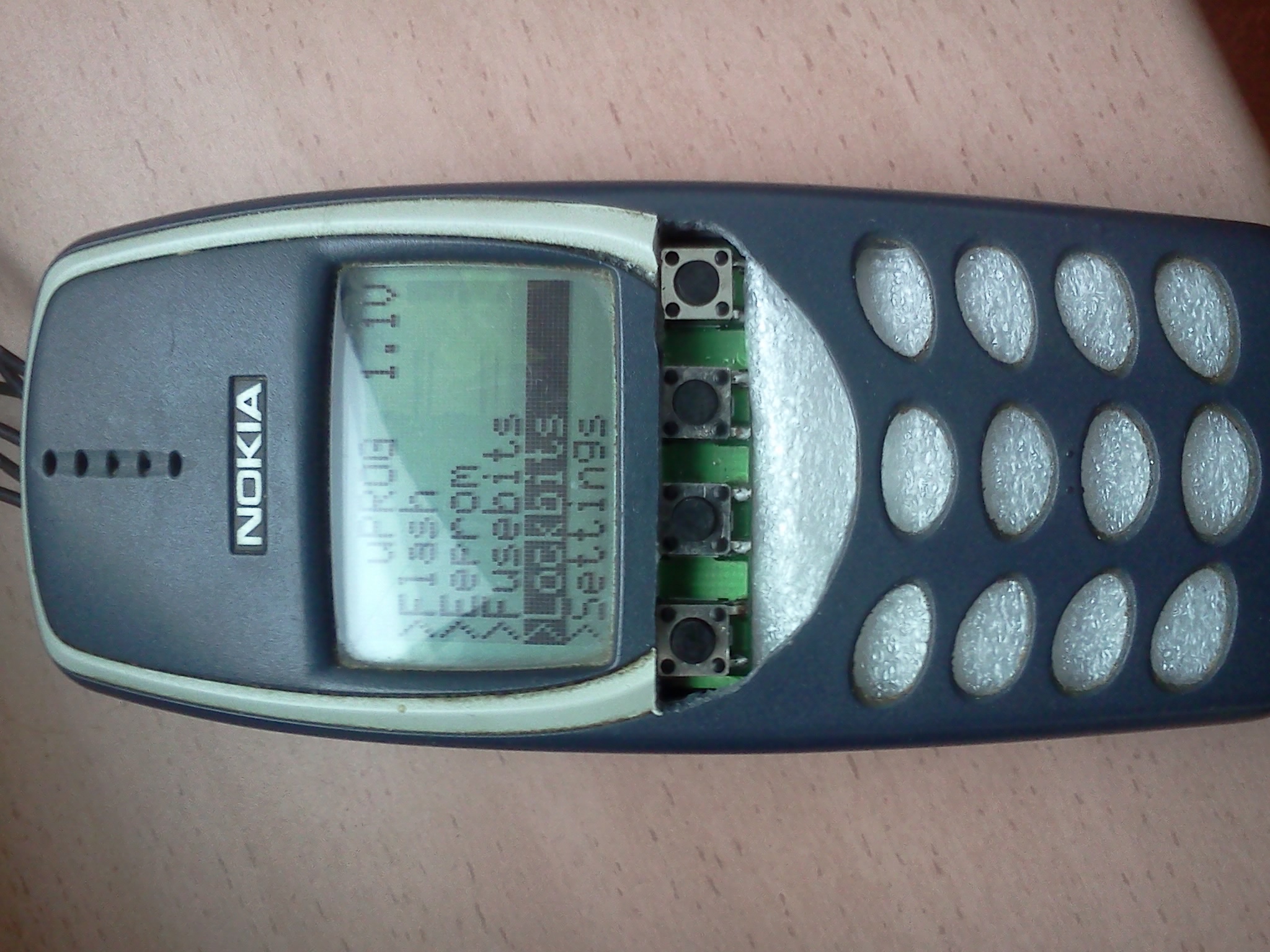

    THANK YOU manekinen
    Great project - great thing :D - I use the device "regularly" :wink: .
    I've needed something like this for a long time, so thanks again.
    For me, it's a portable device, so I stuffed it into this:
    uProg - small, fast, portable AVR programmer with SD
    Minimally difficult access to buttons - no accidental activations in the pocket :wink:
    There is "a lot" of space under the keyboard where you can add something (e.g. battery charging system etc.)
    Now the programmer is powered by the original Nokia battery, which I charge when needed in another phone. But time will come for modifications :wink:
    [edit]
    Ps.: I do not have a battery voltage measurement (waiting for update), but I noticed that when turning off the programmer with the button LE for a fraction of a second, instead of 1.1V, the voltage of 3.3V appears on the display ... is this a substitute for a change, or some "miracles"?

    mirobo wrote:
    Ps.: I do not have a battery voltage measurement (I am waiting for the update), but I noticed that when turning off the programmer with the LE button for a fraction of a second instead of 1.1V, I see 3.3V on the display ... is it a substitute for a change or some "miracles" "?
    If you look at the animation folders you will notice that this "3.3V" is just on the bitmap, both on and off :) And it looks pretty good in the housing from the 3310, but tell me why you didn't use the original buttons? After all, it was easy to use them - like a glove, up and down ok and cancel :) I also noticed in the video that the vibration of the contacts can be felt - are they just some occasional cases?
    As for the voltage measurement ... on the new board, the voltage is not measured, so it is 1.1V. During switching on, the programmer checks the voltage and if it is below 3V, it waits for additional time to charge the capacitor from the memory card - hence the long start-up.
    I started working on this PDI but unfortunately I gave it up so far due to lack of time. But I will try at least to throw in a version that will improve, among others, voltage measurement and other minor errors.
    I would like to inform you that as of today I only have 15 free tiles left for resale, and I WILL NOT order more tiles. So if anyone is still delaying and would like to build a system, let him stay awake ;)
    Heh :D - the blind are not sown :wink: - I didn't notice it on bitmaps, and the voltage was right for me - hence the "miracle".
    As for the housing - I was thinking about using the original buttons (then you have to desolder the buttons from the board, because they do not fit), but I only had the housing without the keyboard, so it turned out that way.
    However, as for the vibration of the contacts, it is probably the fault of the video itself and its quality (the programmer in one hand and the phone in the other), because there is no problem with it.
    I have one more question: Would it be possible to add 4-5 subfolders in the flash folder and then select the file?

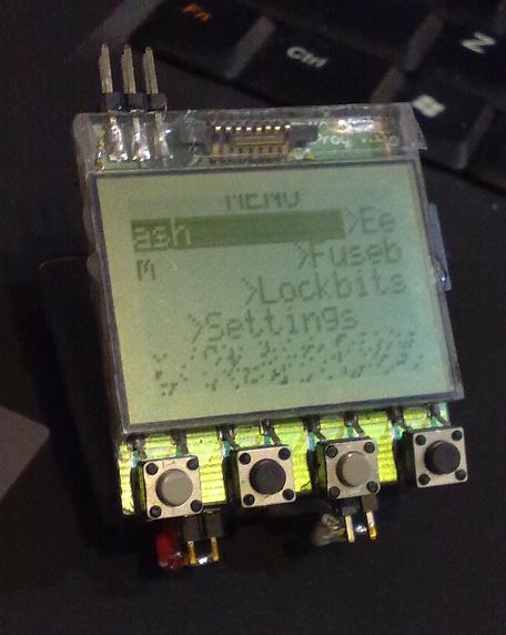

    And I have such a problem as one of the forum members.
    The only soft that causes anything visible on the LCD is the soft with the number one. You can jump around the menu and probably also program (I have not checked). The rest of the softas cause necrosis, which would not line up.
    Anyone know the reason for this? In my opinion, this is the fault of the display. Some have glass ones too, and they like it. Fusebits set as per the instructions in avrdude.
    I guess I'm unlucky. I have the parts from the author (LCD and its connector plus capacitors, PCB). I do not have a Nokia to put a display in it, also if it is not a software defect (in this case) that can be eliminated, I give up with this project. I got horny because it would make it easier for me to fumble around with electronics and so I just wasted a lot of time to figure out what I did wrong. Soldered as it should, cleaned with acetone so that rosin was gone. Anyone advise me something?
    I will not buy a display (or a phone for the display) - it seems pointless to me. In total, I have the same chance to buy the same one and waste a lot of time to find out that I have become the owner of a second LCD that somehow does not want to cooperate as it should. Pity.
