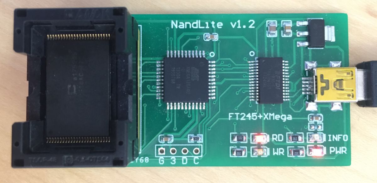

  • Built a low-cost Flash NAND Lite programmer for TSOP48 NAND chips, aimed at reading and programming memory from sticks, routers, televisions, modems, and navigation devices.
  • The board runs from USB 5.0V, generates 3.3V with a TPS781330220 LDO, and uses an XMEGA-A4U plus FT245 USB converter with a parallel data bus.
  • The design exposes four CE lines and four RB lines, while the LDO’s 150mA overcurrent protection helps prevent damage if a chip is inserted backwards.
  • Measured throughput reached 980kB/s from FT245 to XMEGA and 2.7MB/s from NAND to XMEGA, showing much faster direct NAND communication.
  • The main limitation is cost-cutting simplicity: only one permanently soldered TSOP48 socket is included.
