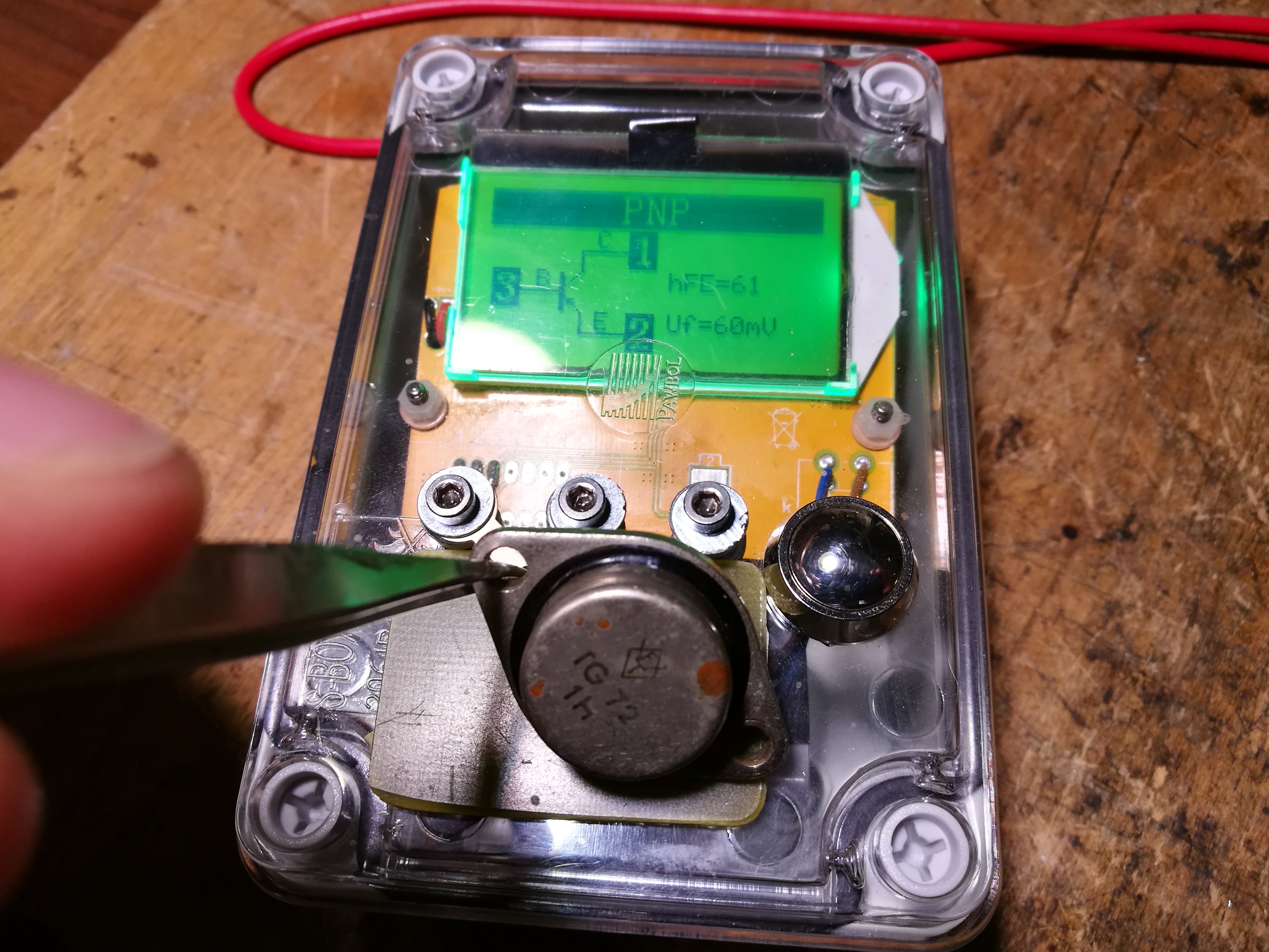

    I wonder what the tester would say on the germanium transistor, does its characteristic mean that we are not dealing with silicon?
    LCR-T4 electronics components tester ATMega328 - Test and Review
    The voltage of conduction. Silicon will never come down that low. And zero currents. Germanowe have quite a lot of them. This tester will not detect. At most "abnormally" high gain at low currents.
