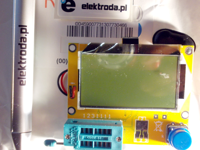

  • #93 16579391
    CMS
    Posts: 8452
    Help: 258
    Rate: 2591
    For me, the display popped out of the "backlight frame" and flew loosely in this anti-static film package, fortunately enough to knock it in place and work fine. However, stress was :) . I did not have time to test, I just checked if it actually measures the inductance of the coils. Measures, so it's great, as I check the other functions, I will appeal to you on this topic, although I think it will be better at https://www.elektroda.pl/rtvforum/topic1635313-630.html#16567613 I put something in, the rest of the package. Stickers great, it's a pity that only two, because now I have a dilemma where to put them :) and there are many places. A pen that is not practical as a pen and not practical at all as a vernier caliper, but BETTER :) Although it is terribly trashy, it will join my "pencil case" because it makes the atmosphere :P . Greetings. CMS

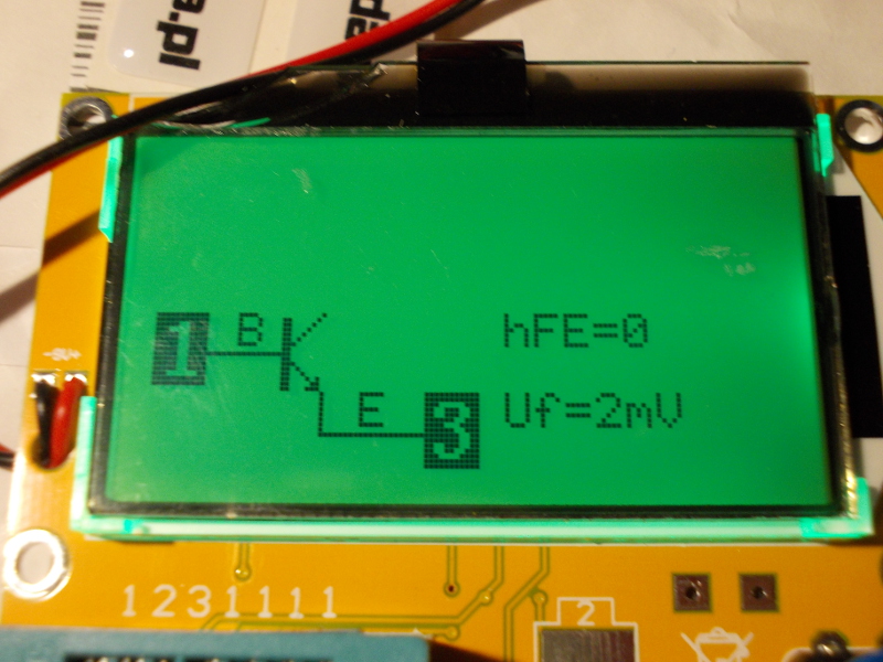

  • #97 16579581
    Dydelmax
    Posts: 3834
    Help: 654
    Rate: 963
    The tester arrived in full (although also in my display the "got out" from its mounting), passed the calibration and the first tests. Below I present the results of measurements using the M328 tester. These results, being the averaged value of three measurements, I compared with the data obtained during the measurements using the following multimeters: - UNIT UT-10A (from the Forum shop from February 2014), - DT-9208A (version from the Forum shop from April 2013), - DT-9208A (version from the Forum shop from February 2016). The devices were powered using new 6F22 (DT9208A, M328) or CR2032 (UT-10A) batteries. When measuring using DT9208A, I used one pair of test leads for both multimeters. All measured elements come from the outflow.
    Element Nominal value or designation UT-10A DT-9208A (IV 2013) DT-9208A (II 2016) M328 tester Comments
    resistor 1.5? 10W 10% 1.6? 1.8? 1.8? 1.53?
    resistor 39? 2W 5% 39.2? 39.5? 39.4? 39.6?
    resistor 6.8k? 1 / 4W 5% 6.72k? 6.71k? 6.71k? 6.83k?
    resistor 680k? 1 / 4W 5% 0.679M? 0.679M? 0.676M? 0.6846M?
    diode BYW98-100 0.365V 0.369V 0.29V 0.480V
    dioda STTA506F 0.383V 0.398V 0.312V 0.541V
    dioda 1N4937 0.458V 0.459V 0.346V 0.570V
    dioda 1N4004 0.528V 0.557V 0.414V 0.657V
    kondensator 820pF 1.6kVDC/0.65kVAC 1125 pF 734 pF 898 pF 813 pF
    kondensator 22nF 630VDC 22.31 nF 19.97 nF 23.7 nF 22.16 nF
    kondensator 1µF 50VDC 1.028 µF 0.901 µF 1.223 µF 1.023 µF
    kondensator 100µF 50VDC 102.8 µF 85 µF 101 µF 95.66 µF
    tranzystor BF459 (hFE >26) n/a on 79 84 UNIT does not measure hFE, DT9208A V1 has a damaged base
    In addition, separate measurements by the M328 tester:
    KT805IM NPN, hFE = 175, Uf = 555mV
    BC211-10 NPN, hFE = 109, Uf = 648mV
    MBR20100C 2 diodes, Uf = 310mV
    F06C20C 2 diodes, Uf = 556mV
    BF457 NPN, hFE = 55, Uf = 642mV
    STPS1545CT 2 diodes, Uf = 255mV
    SB2040CT 2 diodes, Uf = 206mV
    10GWJ2CZ 2 diodes, Uf = 212mV
    2SD1431 NPN, hFE = 9, Uf = 578mV
    TVR10471 capacitor, 131pF
    Red LED Uf = 1.55V, C = 38pF
    Despite the inaccuracy in the measurement of diodes (although in some cases the deviations in the DT9208A multimeter can also be seen), the tester works very well in component testing. After placing it in an ergonomic housing, it can be used for a long time in an electronics workshop.

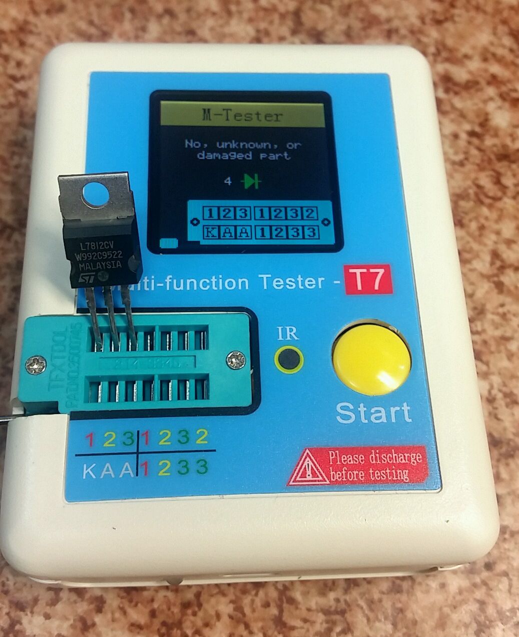

    How does this tester handle LM stabilizers have three damaged or can not recognize them?

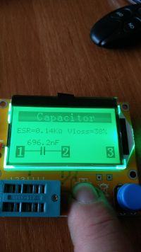

    And from the finger on the SMD test piece comes the capacitor. ;) LCR-T4 electronics components tester ATMega328 - Test and Review Sometimes it will show the capacity itself, sometimes with Vloss (what is the parameter?) And sometimes full grazing with ESR. :)
  • #114 16583696
    CMS
    Posts: 8452
    Help: 258
    Rate: 2591
    So it works correctly :)
    No, let's not demand too much from these testers. They are probably intended in the original idea for discrete elements, and LMs, although they only have 3 outputs, contain an integrated structure consisting of several or several dozen transistors. For example, here: https://www.onsemi.com/pub/Collateral/LM317-D.PDF http://www.datasheets360.com/pdf/-8576501594162910327 However, before I read your post, I did LM317 tests out of curiosity. and LM7812. My T7 on both shows "No, unknown, or damaged part" and displays the diode symbol. Regardless of the order in which 1-2-3 pins are connected. LCR-T4 electronics components tester ATMega328 - Test and Review EDIT As you can see in the picture, the diode symbol (with the mysterious code 4) is nowhere connected. I think the tester suggests that he probably detected some semiconductor element, but he can not identify it.
