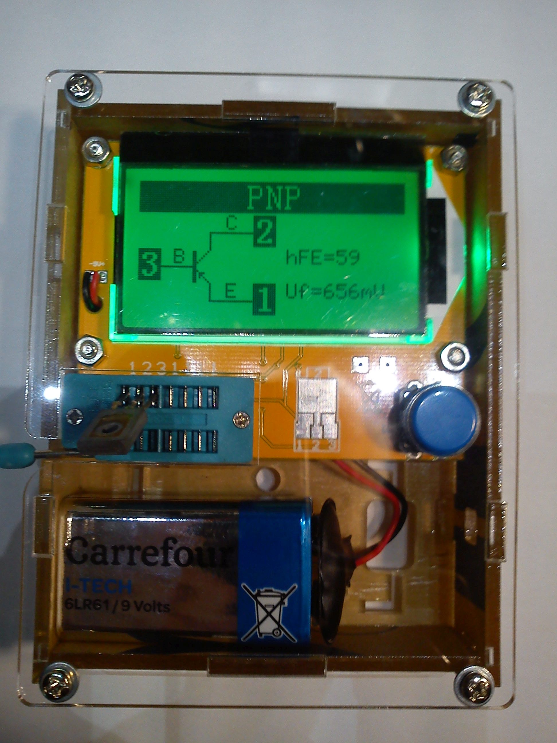

    The tester just came. I folded, I checked the guns: LCR-T4 electronics components tester ATMega328 - Test and Review THANK YOU! :please:

    I'm also waiting for you to play :) Do I have to buy batteries or is it?
  • #204 16667970
    398216 Usunięty
    Posts: 34170
    Help: 3925
    Rate: 9284
    You must buy. I recommend such as in the picture - cheaper than branded, and better (I have a comparison after a digital meter). Oh - there are still red of the same brand - also good, but blue better (I also checked).

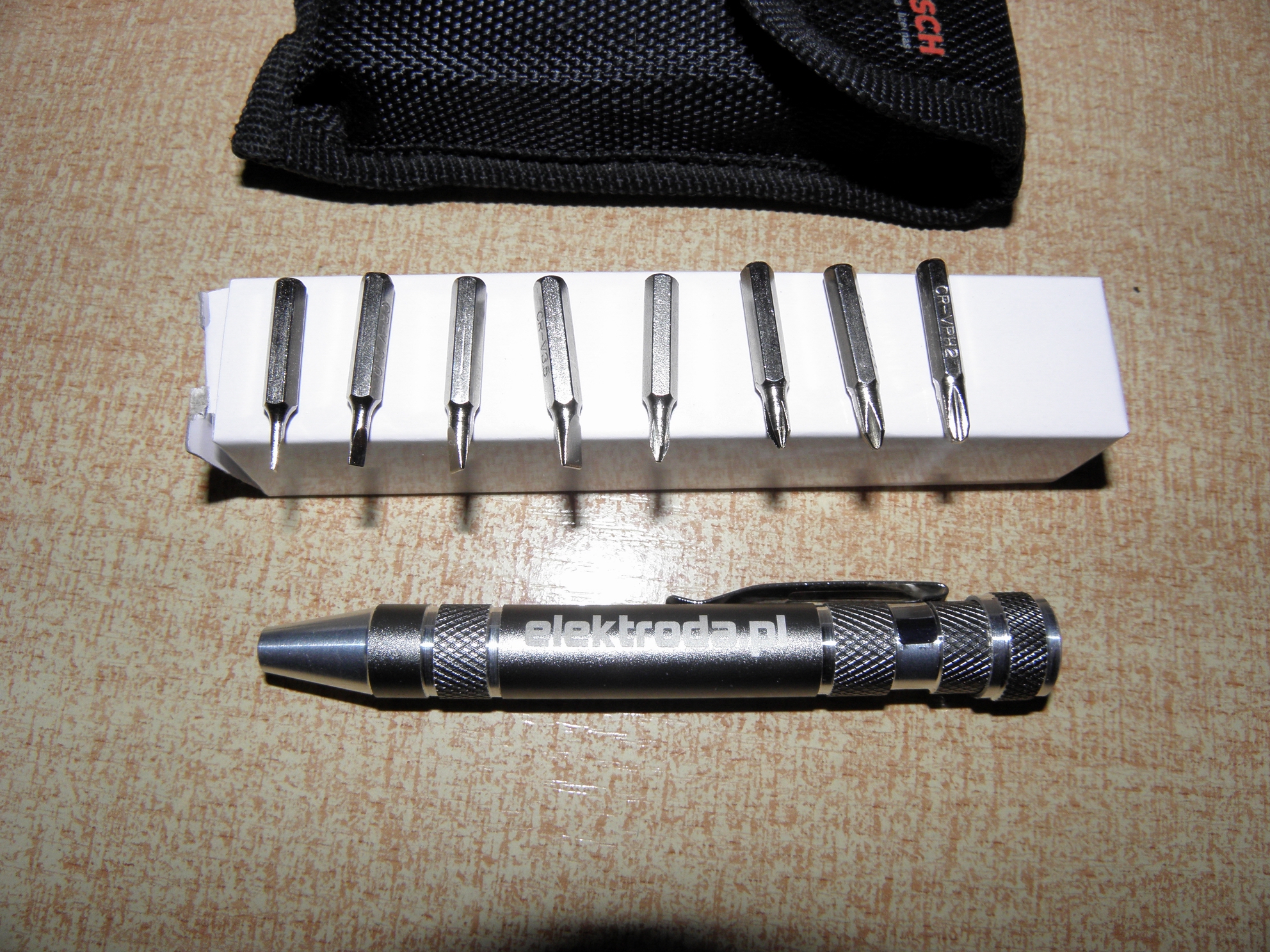

    The parcel arrived. Including a surprise, a tool useful for putting together. :D :D LCR-T4 electronics components tester ATMega328 - Test and Review Thanks to Elektrodo.
